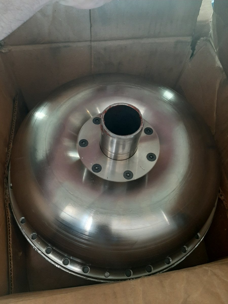

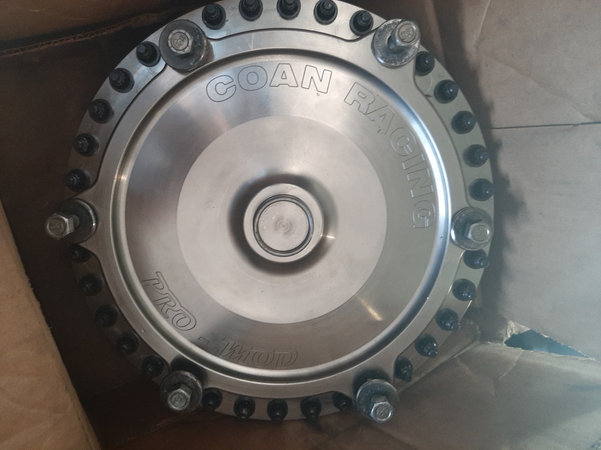

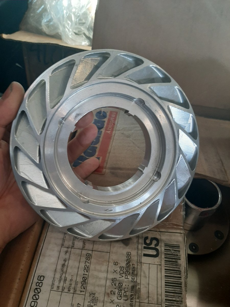

  27. I have been a little busy. After I got home from the nsra show I took the engine apart. Even after new rings and pistons and valve job the cylinders were leaking at 50 percent. To fix that a sunnen rigid stone hone was used to make the cylinders round again. The key to making it work is setting up the hone for maximum pressure. A 1/2 inch powerful drill is needed. After reassemble the leak was down to a usable 18 percent.
    The car hasn't been able to mile per hour as of late. The converter was pulled and cut apart. A bearing broke and trashed the inside locking up the sprag. Pro torque can't get me the parts I need for 3-4 weeks. So say hello to this aluminum bolt together beauty. The 60 foot times will like the 15 lb weight reduction. I got 3 billet stators with it. 20200814_073608.jpg 20200814_073620.jpg 20200814_073644.jpg

    Hi Brian, that new converter's a nice piece.
    That poster is so cool, all those race cars with a street car in the middle of them!
