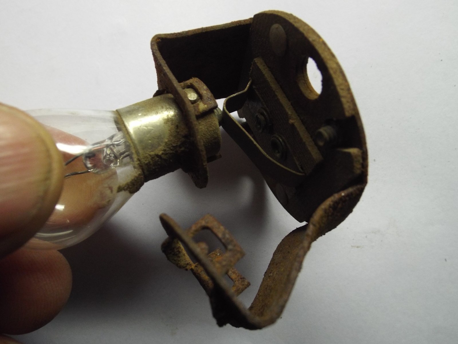

    If this got bead blasted and new sockets pressed in the old sockets would be safe to use? No idea what the odd stuff is or how it worked, gut it and run whatever the total number of wires out the center and into a conduit of unknown diameter. [​IMG]

    Some sockets like this would be easy to solder into your original bracket/bucket. You can get them at your local parts store. I'd grind the old bayonet parts out of the hole so one of the new sockets slide right in. Blast the old part to clean it all up. Then slide the new socket in to the right depth (check with a bulb in it to make sure it clears the housing and lense) and solder the outside of the new socket to the old bracket. Paint the old bracket stuff white, after taping off the inside of the new socket.
    Since the same bracket/bucket holds both light sockets, a single ground is all that's required. Maybe you could weld a short stud inside the bucket to attach the ground wire.
    I would remove the stubby pigtail wires and solder new full length wire into the new terminal ends. Less splices are better.

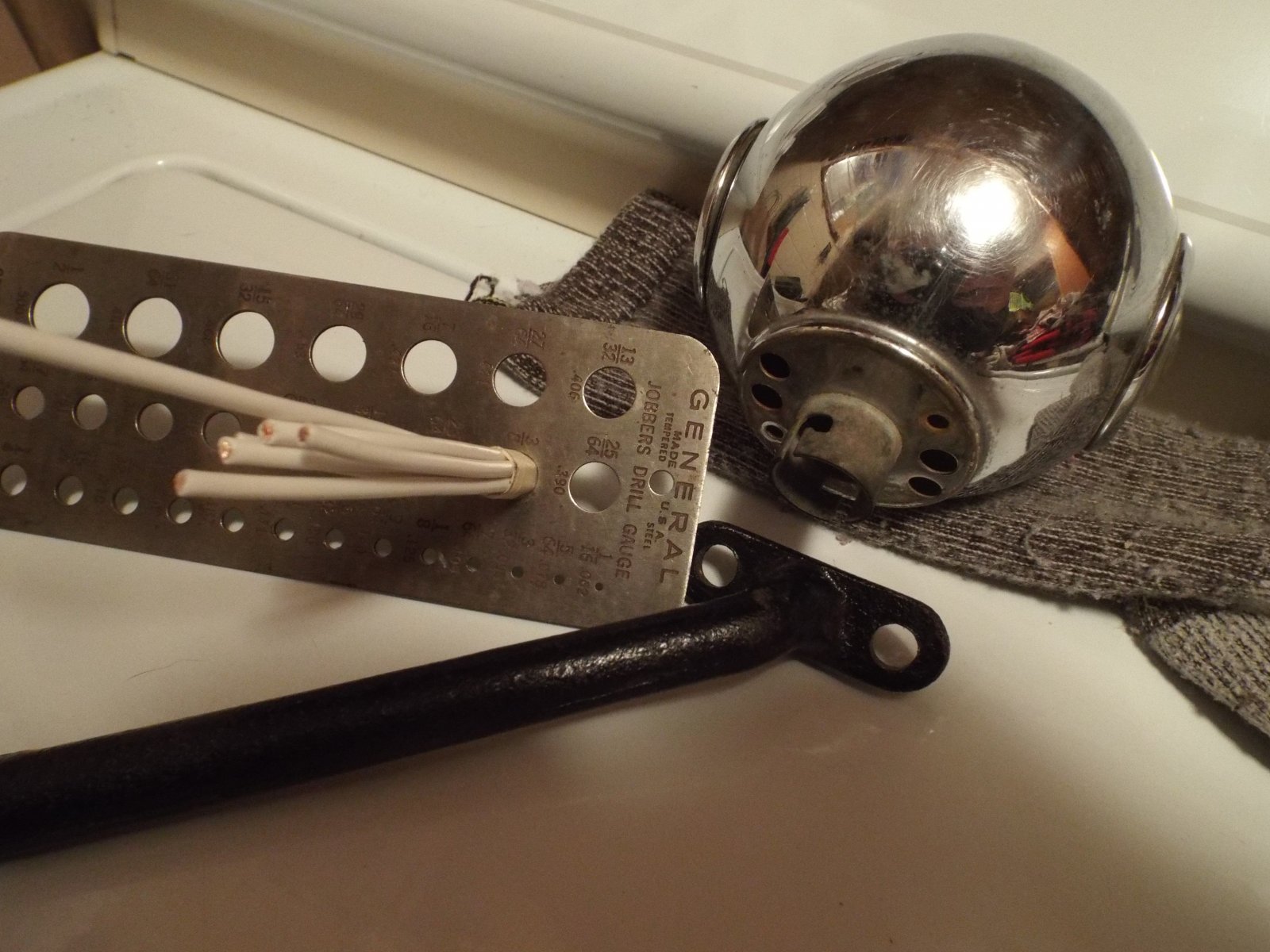

    61c7rkuD9RL._AC_SL1100_.jpg I had hoped to keep this a totally mechanical question, how many wires in a two socket tail lite will come out of the housing, and then into a conduit of undetermined diameter. With these sockets and the additional ground wire/wires we have totals of 3 to 8 total. The conduit may be a larger diameter than the forged bracket. The original socket part has to be as clean as the new sockets correct?

    This is the plan, I'm NOT the guy running the wire, that shit scares me. IF the TWO new sockets have TWO wires each and a ground wire is added to each that is SIX wires. Taped together SIX wires will run through a 3/8 ID tube, if the tube has a 1/2 OD it will look good bent to mimic the forged early 1928 Forged bracket. WILL THIS WORK? If not why, and what would be needed to correct it? Thank you.

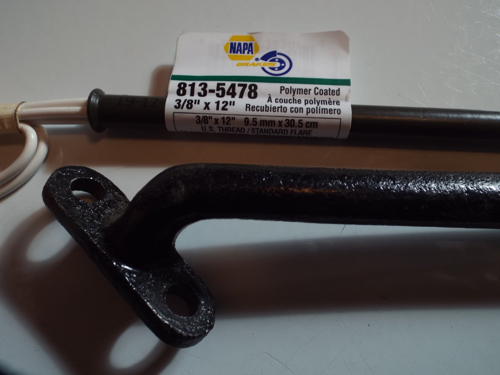

    There is a large steel brake line that NAPA caries, that was my first thought until the wire total started climbing.

    Thank you! I can fit four wires in the brake line, so I'm all set if the rules change and I need more. Bob DSCF9469.JPG
