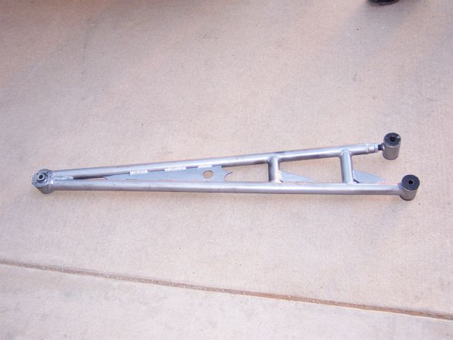

    Andy, do you have any pictures or drawings of your setup that you can share?
  10. AHotRod
    Joined: Jul 27, 2001
    Posts: 12,216
    AHotRod
    Is it like this?

  14. AHotRod
    Posts: 12,216
    AHotRod
    I'm trying to picture in my head what is being written.
    Would this design be more along the lines of what your describing?
  15. AHotRod
    Posts: 12,216
    AHotRod
    Or maybe like this, except use the Chevy II bushing in the front.... ?
  16. Andy
    Joined: Nov 17, 2002
    Posts: 5,121
    Andy
    Yes, That is pretty much exactly it for the torque arm. I have never used any webbing between the bars.
    AHotRod likes this.
