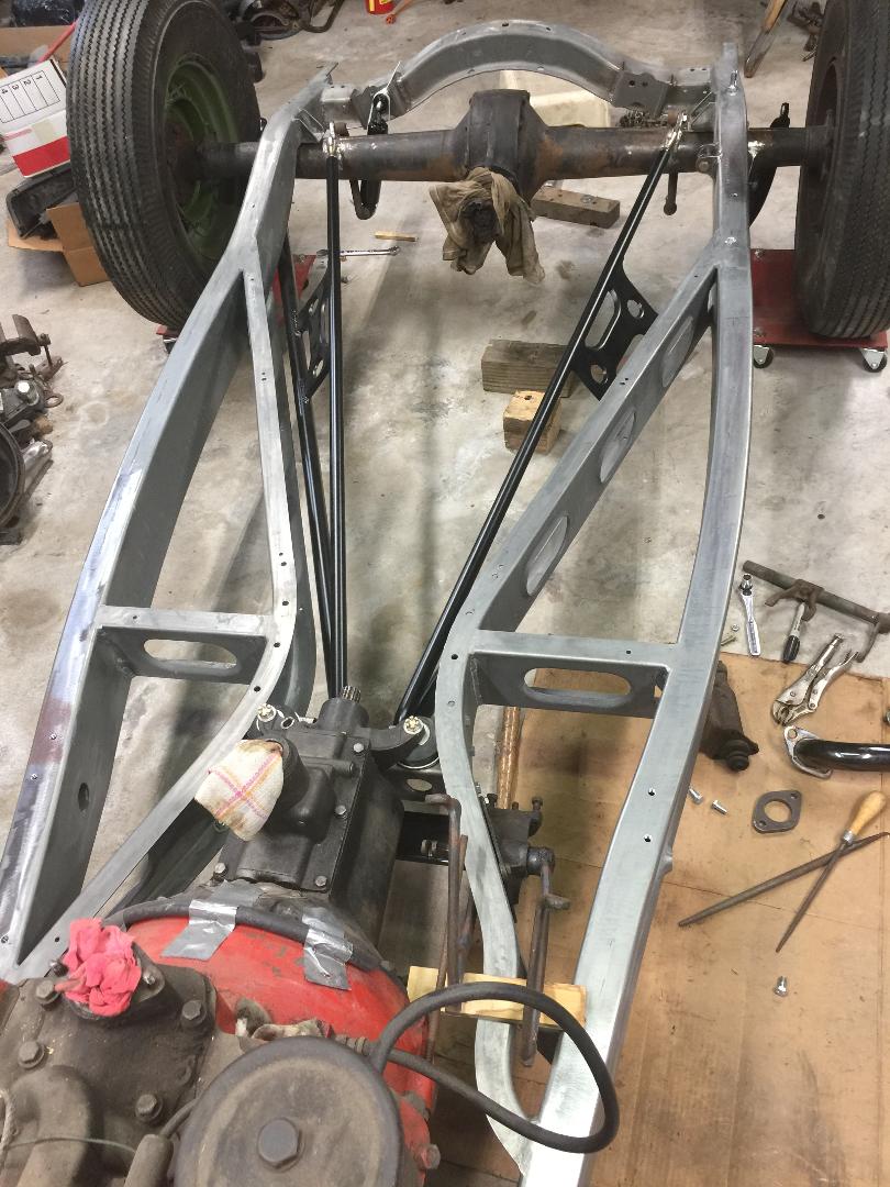

    I agree with F&J about a single front pivot point being the best (if not possible than be as absolutly close together as you can to minimize binding). Also the longer the arms the better to minimize pinion angle change (mine are stock length with the torque arms being the only new welding). I am using an open drive 47 truck rear (hope to use a quick change in the future), an open drive 3-sp, 35/36 radius rods, added 1" DOM tube torque arms, homemade brackets, Johnny Joint, and model A or T rear spring. The rear crossmember is Model A on my homemade frame (Dadgum frame). I'm using a coupling nut which will be welded on both sides of my center crossmember with the jamb nut. I still need to complete all the welding but here are some pictures so far. Bob

    Your setup looks plenty strong and well designed. I'm sure old Henry would balk, but Edsel would certainly approve.

    53FAFECA-2846-42B3-BB52-5A12CA77A115.png Considering the gusset is mounted on center of the housing I don’t think much triangulation strength is added in this setup

    As long as that front rod end has enough rotational articulation in it, I think Blake 27 has it figured out. Simple, looks strong, and adjustable if need be.
