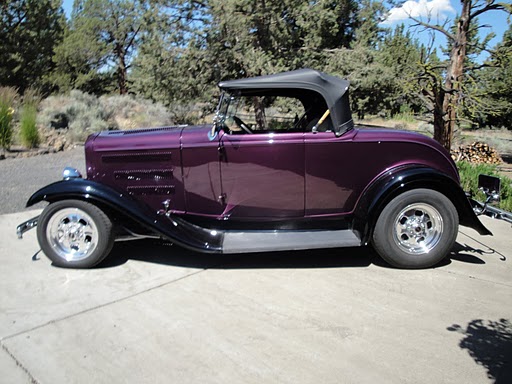

  10. My sedan has the Posies parallel spring setup and rides great. HRP

  14. My cut down panel thing has a set from Pete an Jake. I think Chassis Eng. Looks good and you cannot see them with the fenders. Can send you a picture if you want.
  15. Krylon's setup sure is nice.

  19. That 4 door is beautiful, HRP, but wow that 5 window is really the "cat's pajamas"! Both very nice examples.

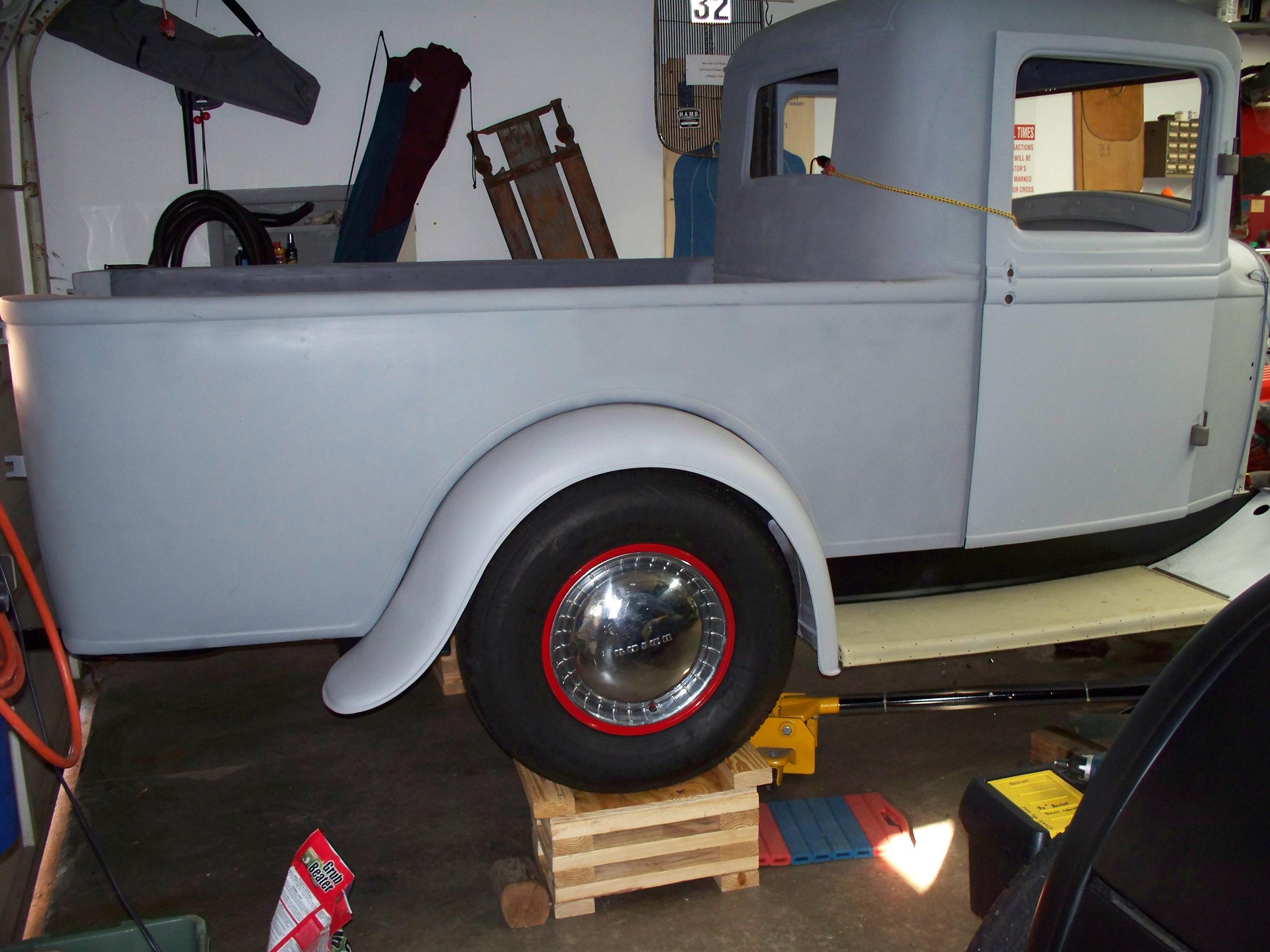

  26. Harms Way
    Joined: Nov 27, 2005
    Posts: 6,894
    Harms Way
    OK,... I didn't want to mention non 32' cars,... but sence RUBBERNECKKIN broke the ice,...
    I get a little work in on this one from time to time (in between other projects),.. I'm trying to make it a low down dirty cheap as I can build it "Beater",... I made up the rear suspension out of 1952 Ford F-1 springs,... that will be unpacked by a few leaves. A transverse front suspension with the parallel leaf rear suspension, seems to work extremely well (IMHO and experience),.. And if this bugger ever hits the road,... I want it as low maintenance, well behaved, and user friendly as it can be.
    volvobrynk, kidcampbell71 and AHotRod like this.
