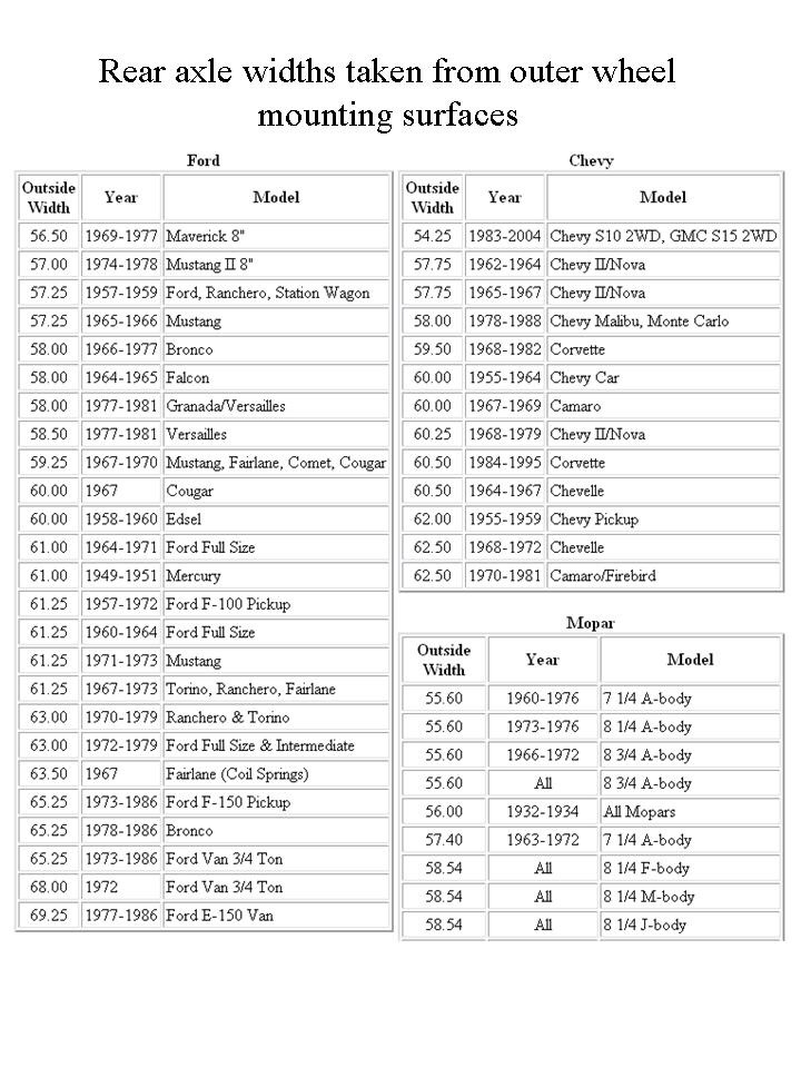

  19. Slow down
    Joined: Jan 7, 2014
    Posts: 127
    Slow down
    [​IMG]i keep this on my phone for junk yard trips
    lothiandon1940, MO54Frank and J_J2 like this.
  20. J_J2
    Joined: Jan 15, 2020
    Posts: 184
    J_J2
    That’s pretty damn handy thanks, now its on my phone as well
