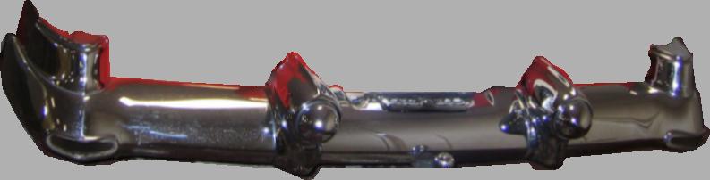

    heres a better pic
  6. johndanger
    Joined: Nov 30, 2003
    Posts: 524
    johndanger
    bumper only
  7. johndanger
    Posts: 524
    johndanger
    heres a crappy photoshop. take off the uppers on the ends , take off the guards , theres seams under there cut into three pieces , narrow the center piece by cutting a little off each end till the three pieces fit the curve of your 51 chevy rear , weld them back together fill the hole where the liscence plate holder / light thing was , rechrome , put on the car.
