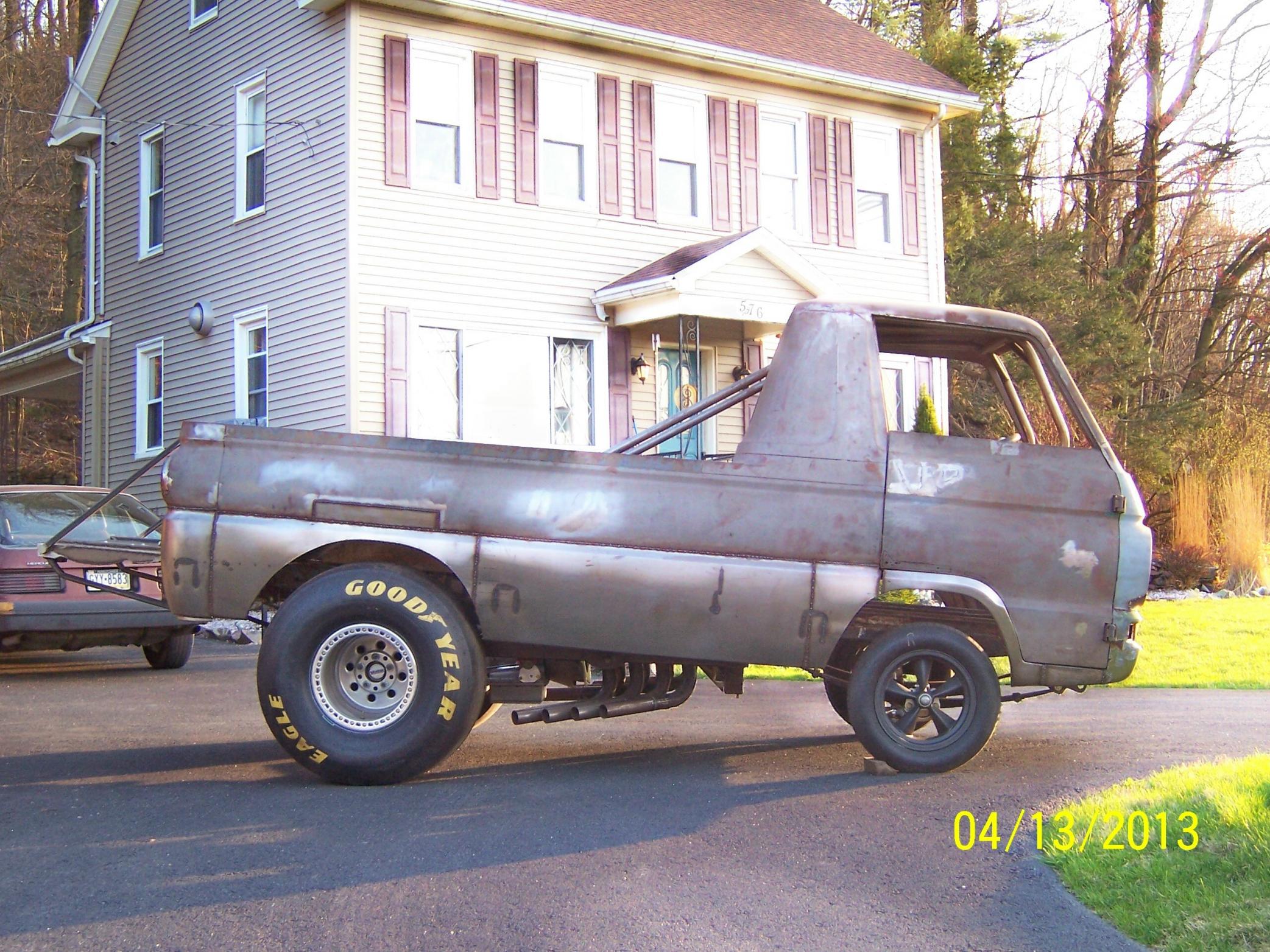

  5. hemiwheelstand
    Joined: Sep 29, 2012
    Posts: 101
    hemiwheelstand
    Good evening all,some spring cleaning so I pushed the truck outside today.This is the first time the truck has been outside with the actual rear wheels and slicks because I had to make my shop doors 3 inches wider.It would not fit through with the slicks on it:(Now it does:DAlso so I can turn it around so it weathers evenlly like the USS Constitution.But more so I can work on the front end for a while,she sure does look pretty.

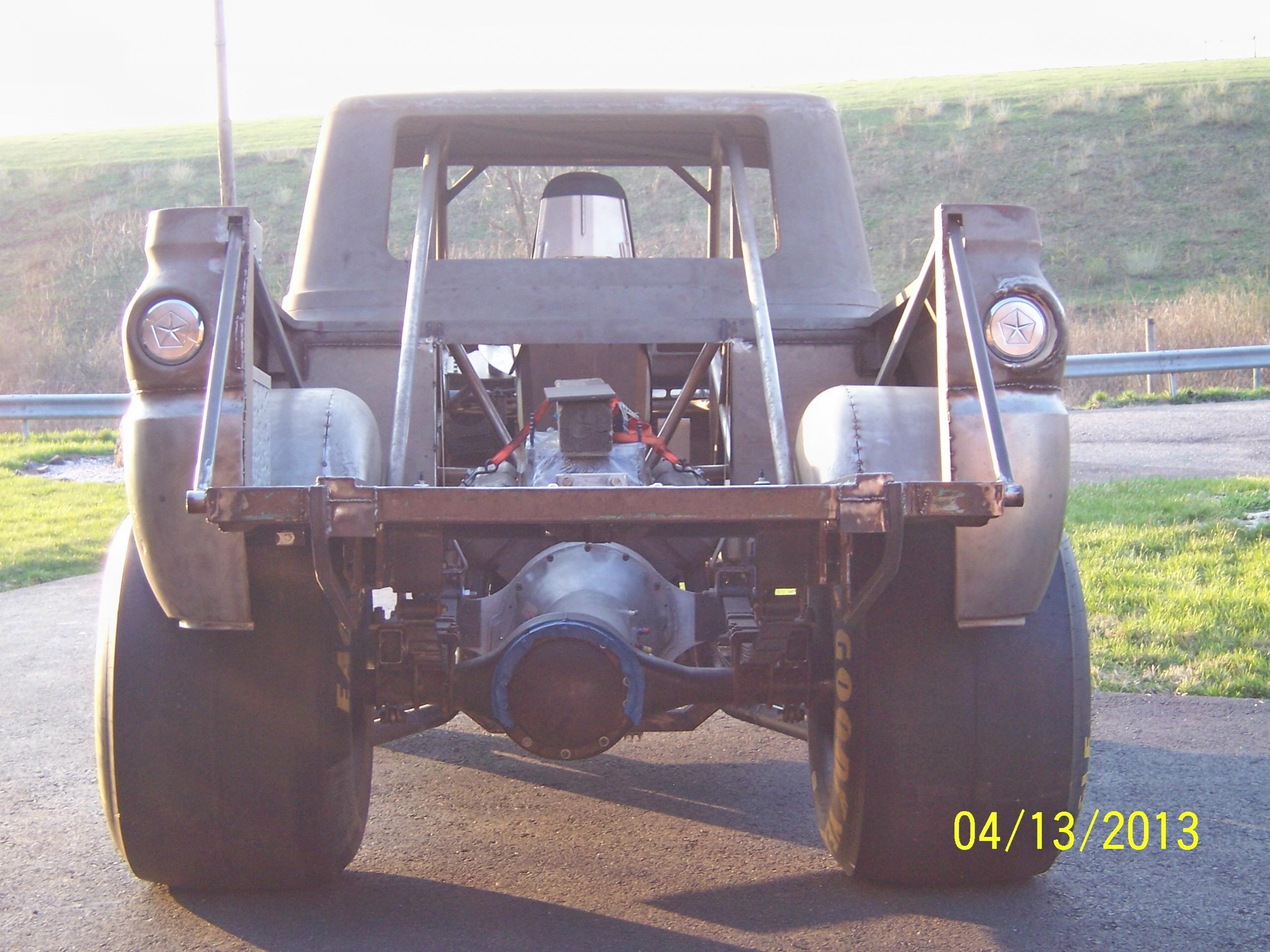

  10. 1971BB427
    Joined: Mar 6, 2010
    Posts: 8,766
    1971BB427
    from Oregon
    Looks very cool! I especially like the picture from the rear!

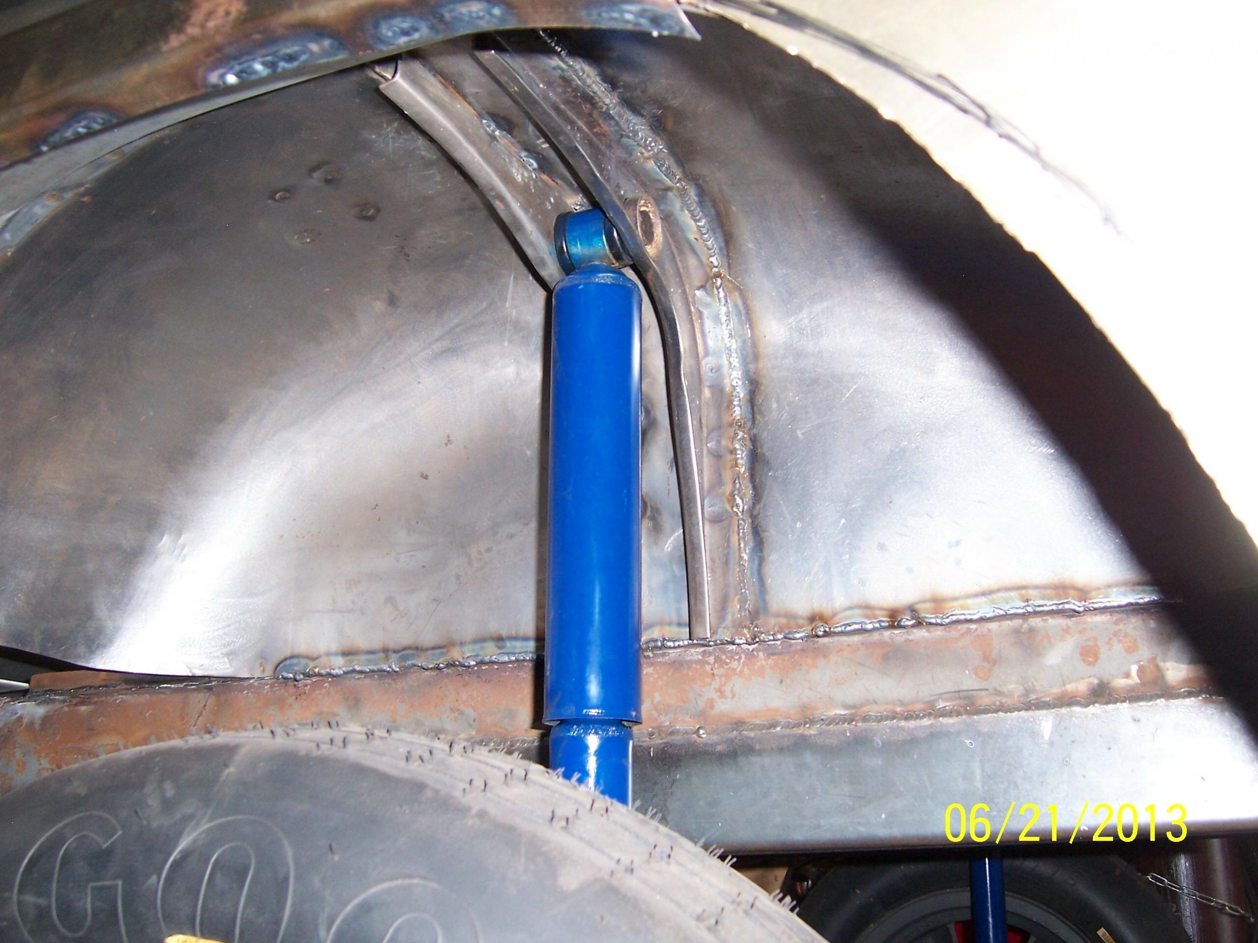

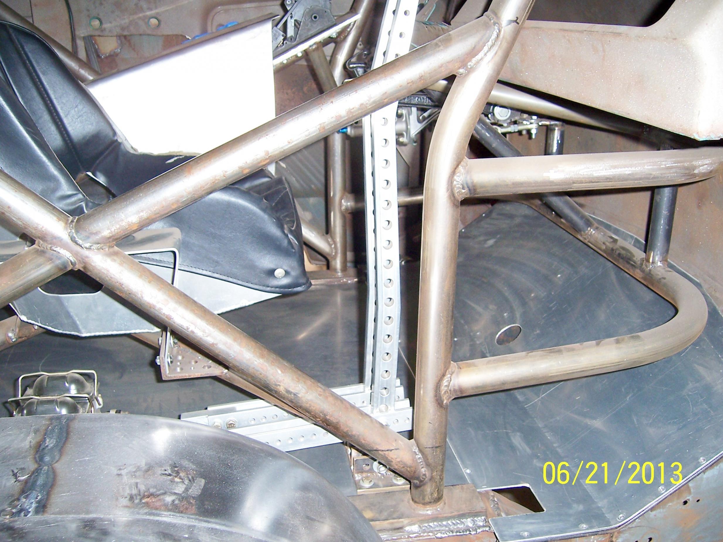

  11. hemiwheelstand
    Posts: 101
    hemiwheelstand

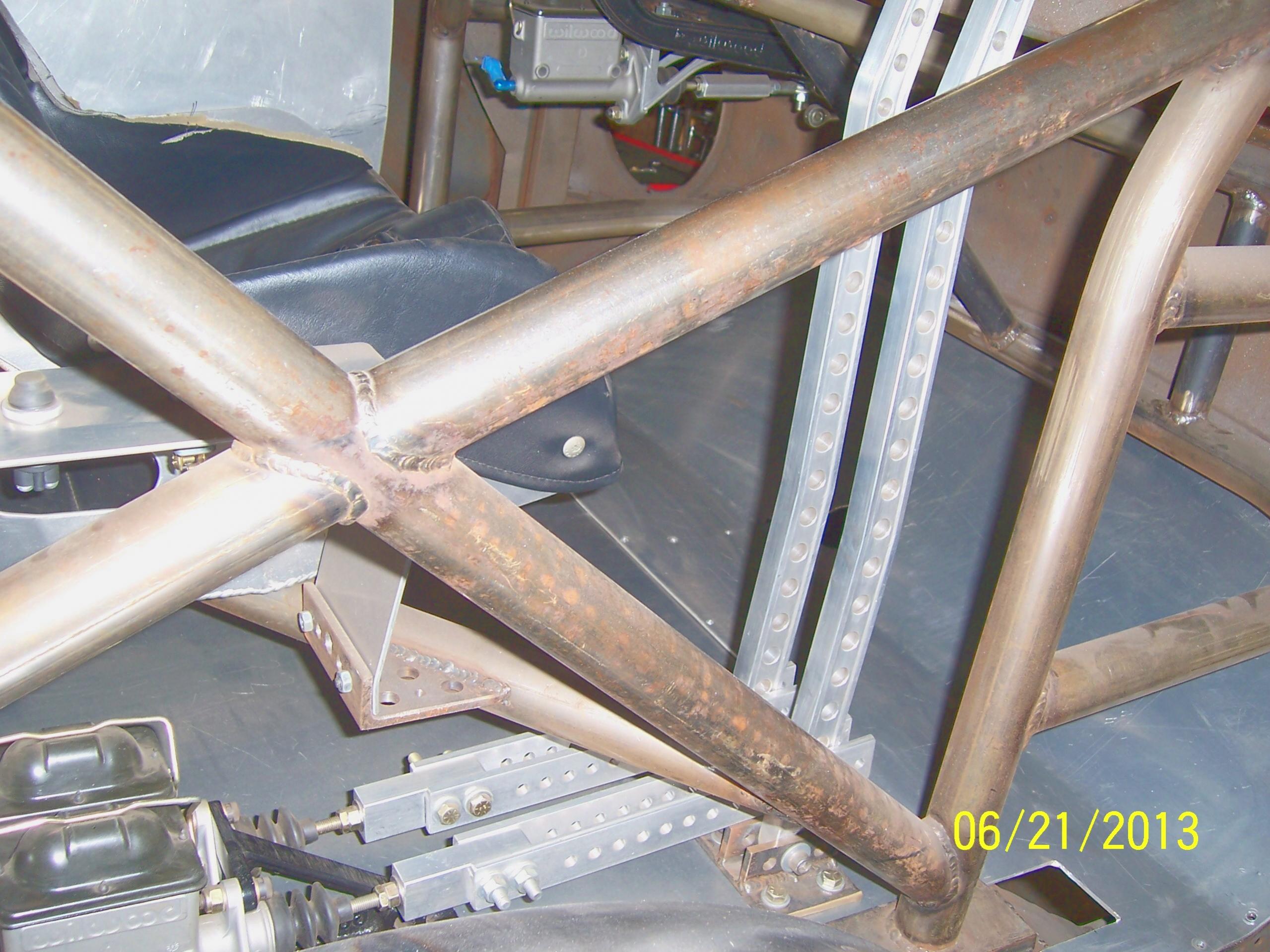

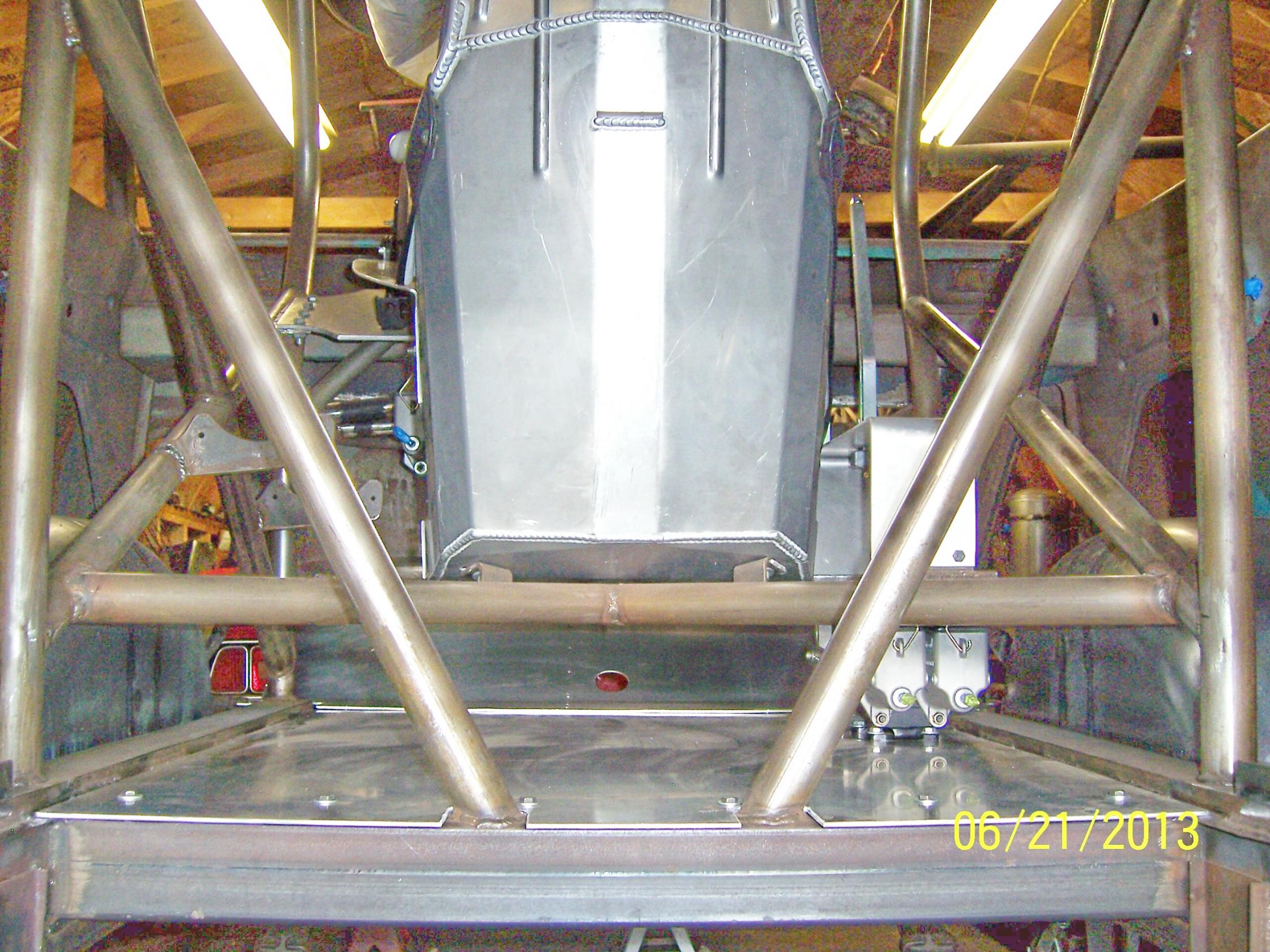

    Hello everyone,it has been a while.But progress is being made.I have finally installed the front wheel houses and shock mounts which had to be cut out of another truck, stripped brackets cut off and smoothed,shock brackets taken of ,sheetmetal fixed and rewelded then fit to the truck.
    1/8 in aluminum on the floor.Made front toeboard floor same materal.(So for anybody thinking that I will be looking through the floor you would be wrong).Also have the steering brakes built and installed and have made a frame that is welded to the hole in the back of the inside of the cab to built the firewall/box that will cover the front of the motor (NHRA spec,has to be there)
    Chris

  12. 1971BB427
    Joined: Mar 6, 2010
    Posts: 8,766
    1971BB427
    from Oregon
    No hole in the floor to see where you're going? That's a gutsy move! :)

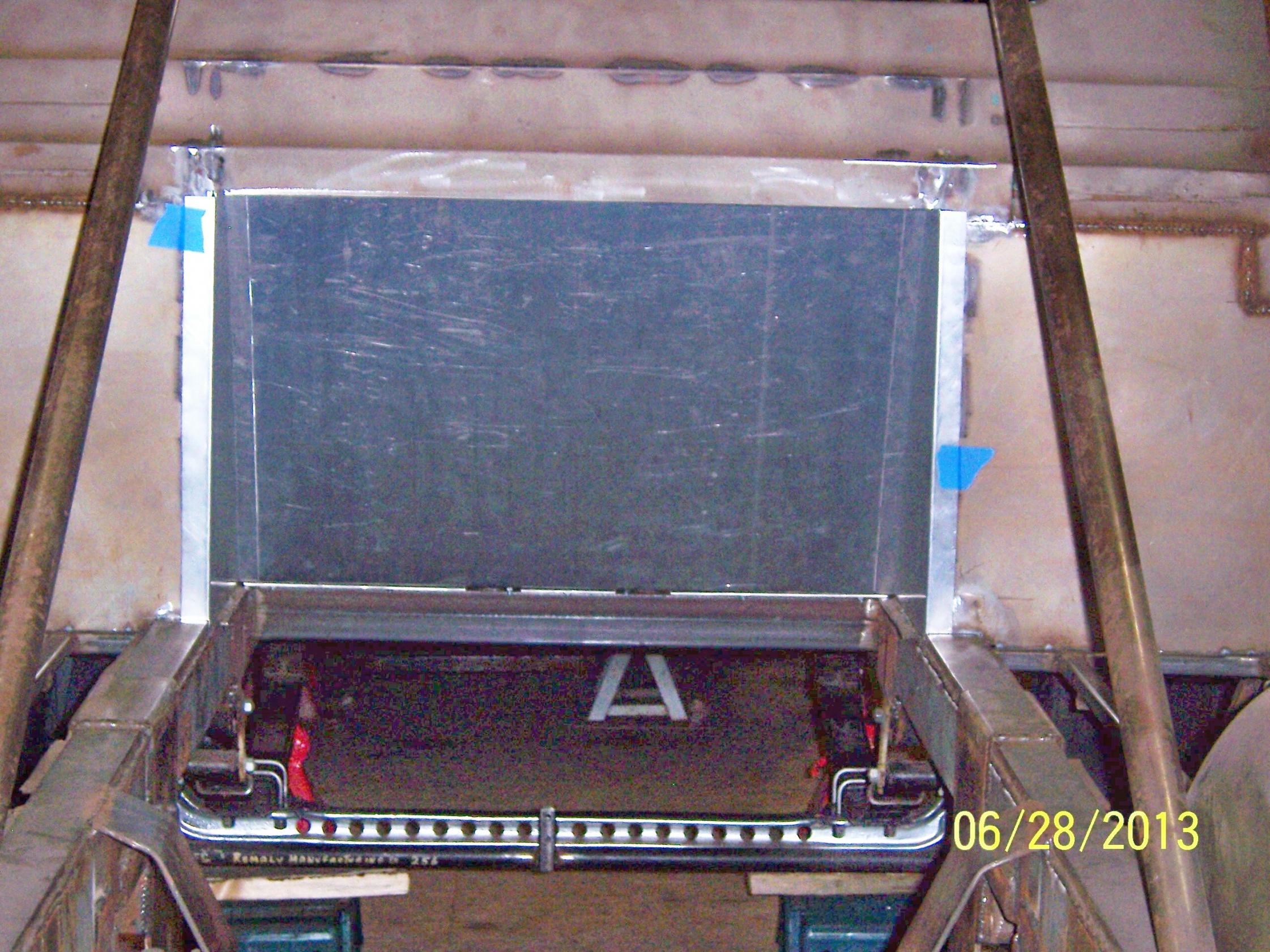

  21. hemiwheelstand
    Posts: 101
    hemiwheelstand

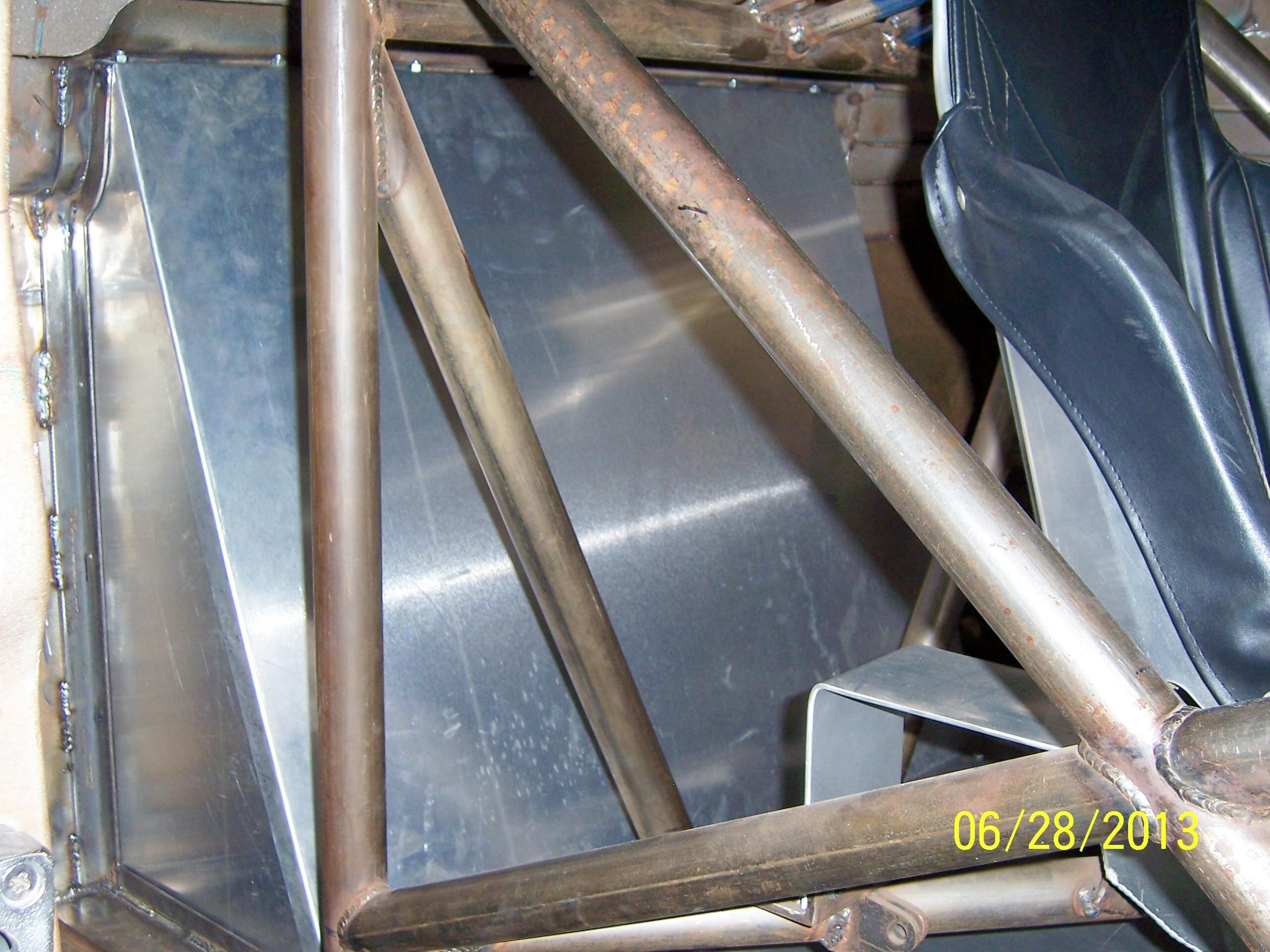

    Hello everyone once again,I have a quick post this morning,but it a big checkmark off the list that I am rather proud of.It is the engine box/fire wall that closes the big hole in the back of the cab.Constructed of 5052 aluminum,0.040 thick(NHRA spec alum fire wall is .032) the front is bolted top and bottom the sides will be riveted to the truck and the front during the FINAL install after paint.All bent by hand as I do not have a brake.
    Now I can finally build and install the puke tank and I have been thinking about paneling the inside of the cab and doors in aluminum or vinyl any thoughts??????
    Chris
  22. 1971BB427
    Joined: Mar 6, 2010
    Posts: 8,766
    1971BB427
    from Oregon
    Nice looking divider, especially without a brake to bend it! Maybe go aluminum panels, and cover them with vinyl if you decide to dress the interior out.

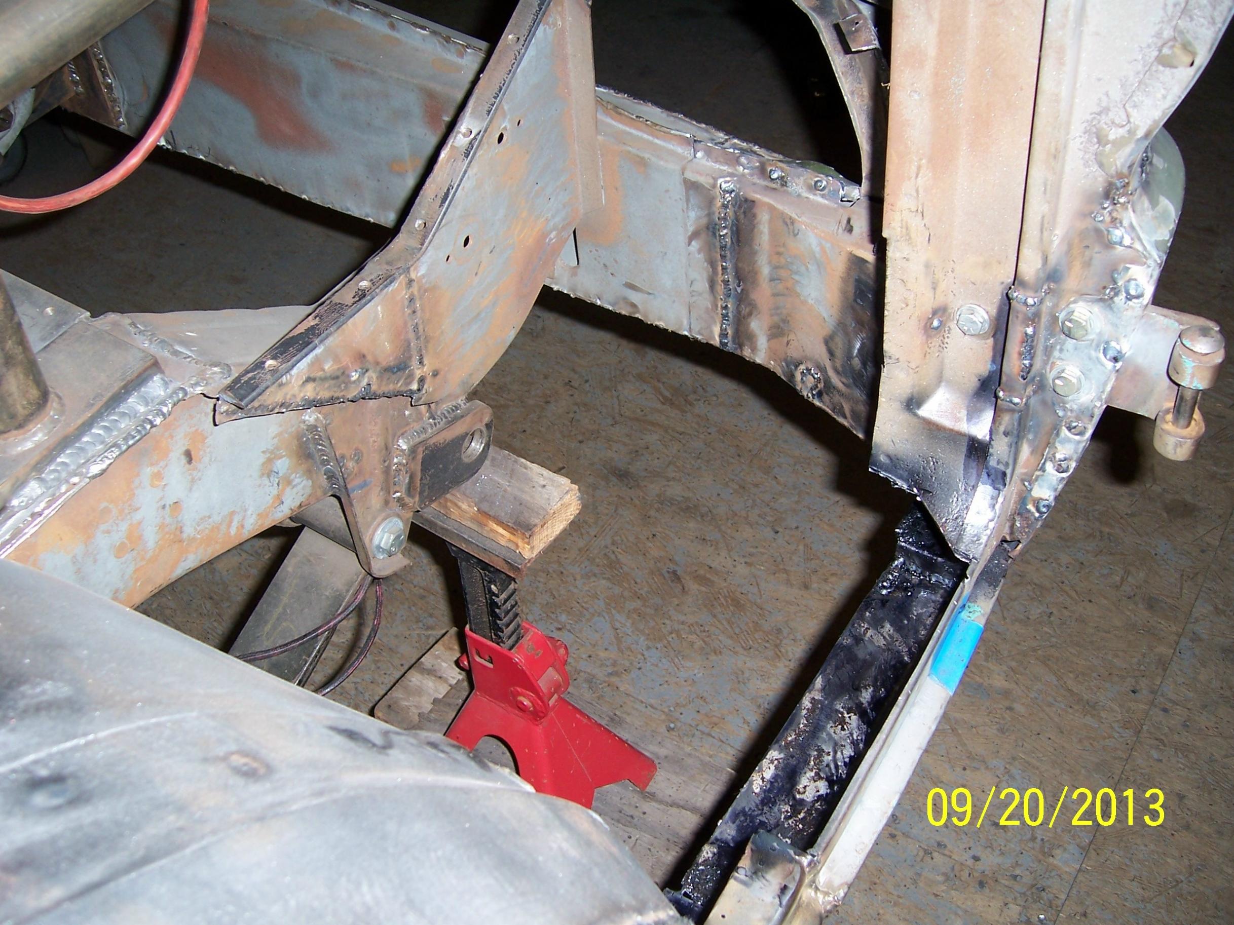

  28. hemiwheelstand
    Posts: 101
    hemiwheelstand

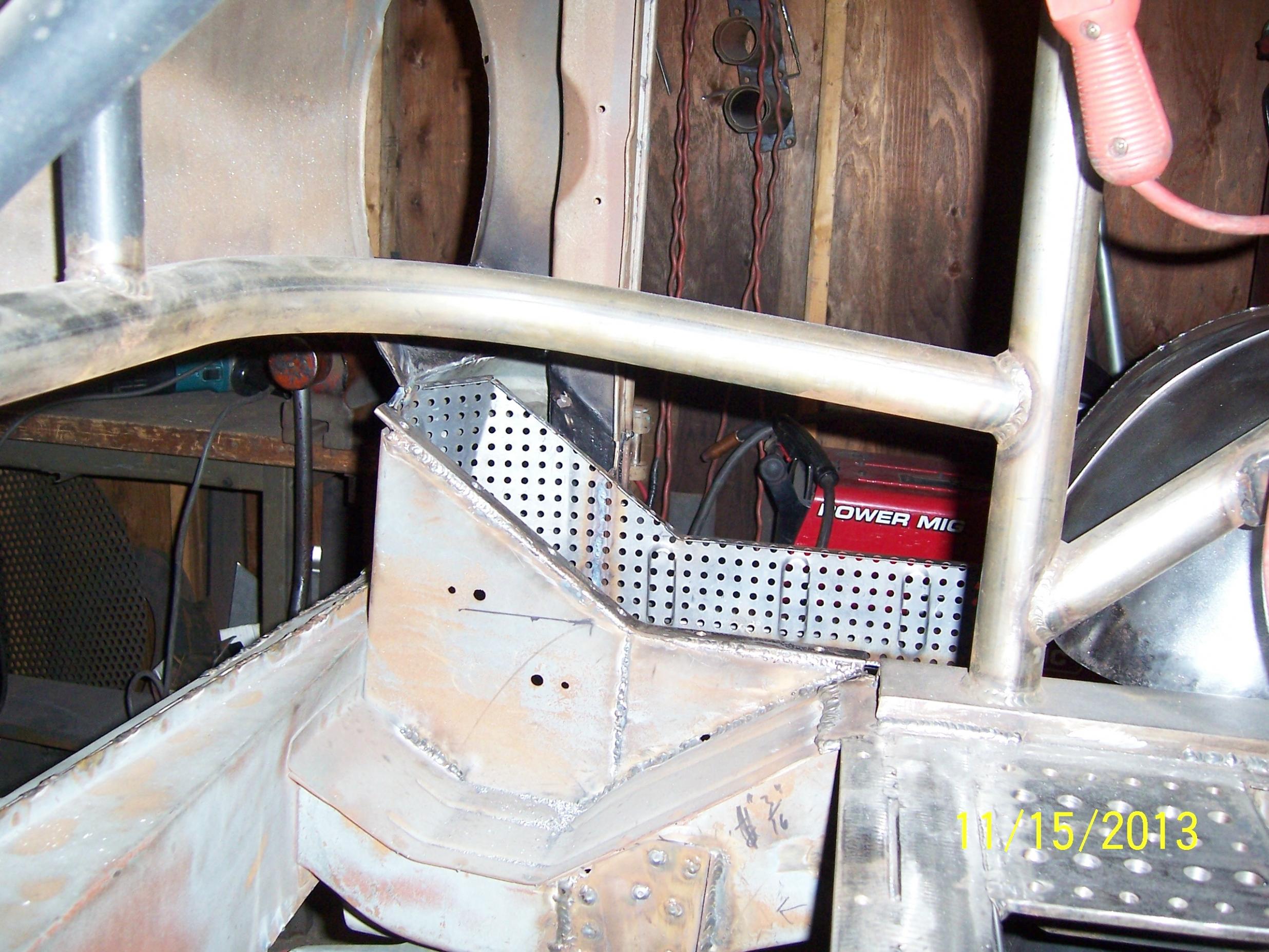

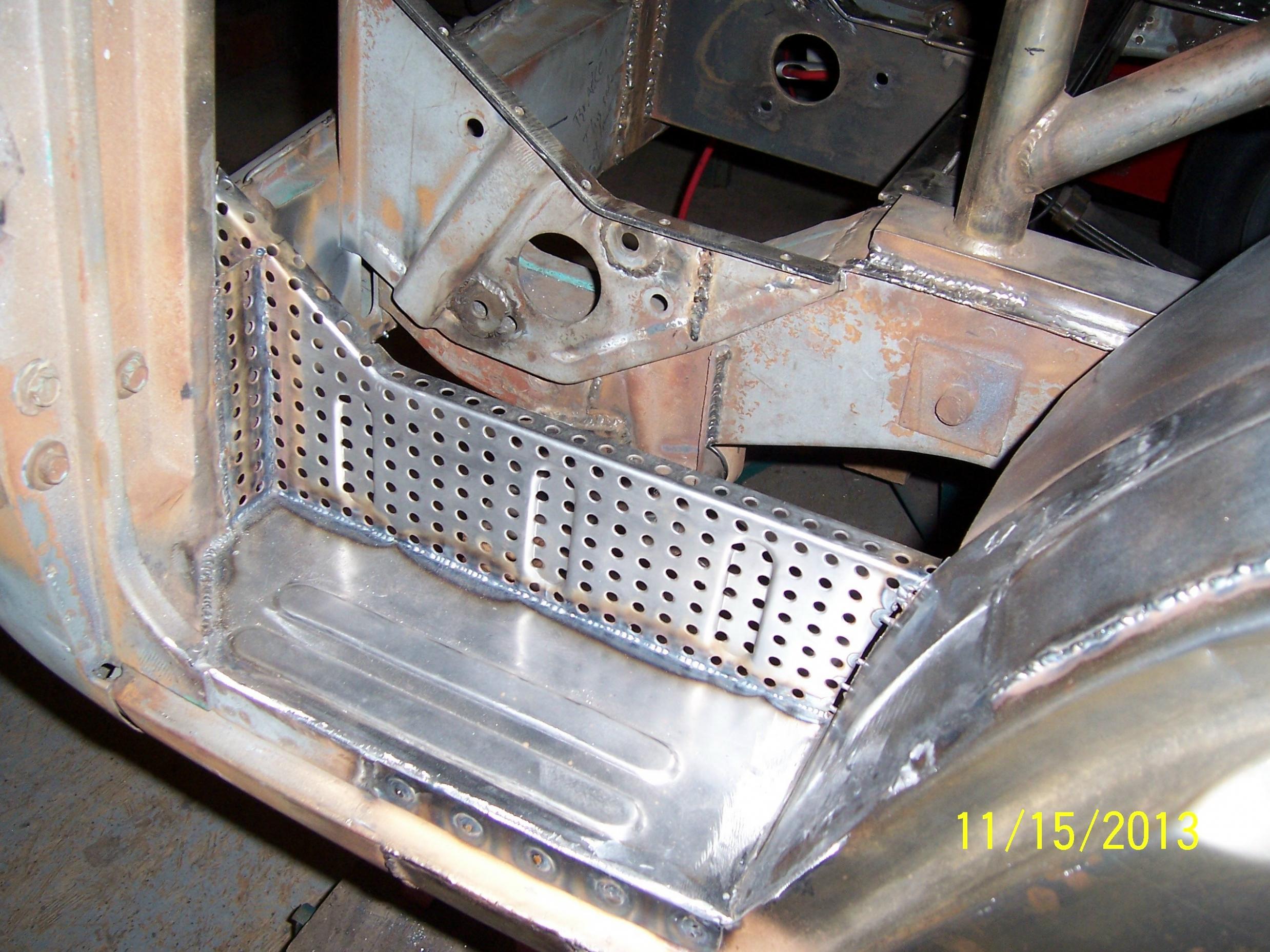

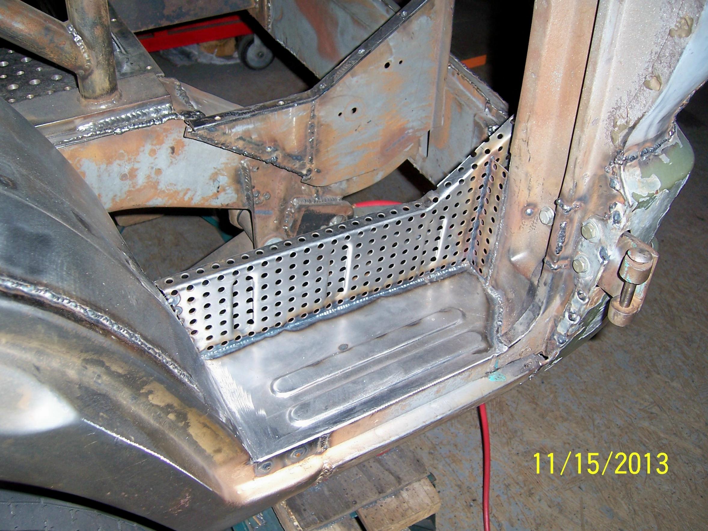

    Hello once again,It has been a while since I have updated on here,due to a unintended Sciatica problem that has really put the screws to me and life as of late.Even a trip to hospital:Dat the end of May.
    The past couple weeks I have been slowly starting to move forward again on the truck.Cutting out what was left of the door steps,making a plan and making it happen.I had to make a set of dies to stamp the ribs for the steps to make the new pieces.Made exact reproducton of factory stamping,replace bottoms of both wheel wheels to meet step.
    Made new floor risers out of perforated 18g steel,stamped ribs in them like factory,had to rebuild entire pass front corner door post bottom.I will be making the floors out of the same material that the risers are made of.I also sleeved the bottoms of the frame between the front rear spring shackles to the subframe mounts with 1/8 3x3 tubing.
    I hope to get some work done this weekend on the floor maybe some updates.
