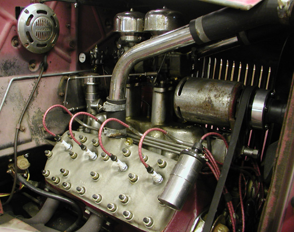

    I had 4 97's on the hemi in my vintage modified and originally ran the little chrome ones that everyone says are no good. Made me real nervous, so after one time out, I did what Bruce suggested. I bought a couple of pieces of aluminum plate the proper size; one 1/4" and the other 1/8". I used the thicker plate as the base and cut 4 2 5/8" holes in it for the carb tops. I bought an oval paper filter (yes, I think it was for a 406 Ford tri-power) and cut both plates to be about 1/4" larger than the filter perimeter. I tapped two holes on the base and used two full thread bolts that went through the top and used wing nuts to hold the top on. I really don't remember how I attached the filter unit to the engine; I think it was with worm drive hose clamps. Anyway it worked great, I never had any trouble with it. I liked it so well that the next year I bought 2 longer full thread bolts and another element and ran one on top of the other.

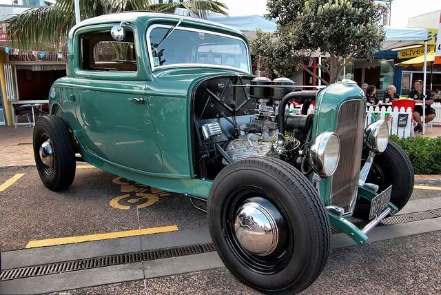

    Cadillacoffin has already posted a pic of our 32 above but as you can see on a regular dual we had to offset the bases to make it work.
