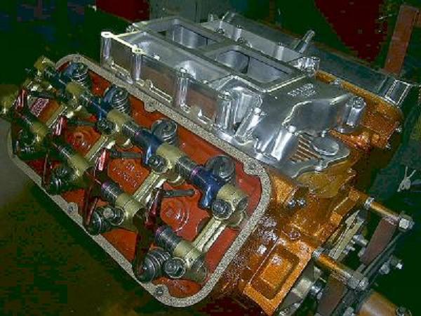

    Man George, you are providing me with some much needed information on hemis that I was not aware of. So how does the valvetrain get lubricated while the engine is running? Also, what's the point of applying sealer on the block side of the valve cover gasket if there's no oil under the VC's? More unusual is that my hemi engine builder painted the base of the heads where the valve train is with Glyptal to increase oil flow throughout the engine.

    Didn't say there was no oil, just not a flood of it. Value of gyptol is debateable, probably more usefull for keeping oil from sticking to surfaces than the speed of recovery. Have you put "Hemi Tech Index" in search? if not you need to.

    I just copied this info from the Hemi Tech thread and will refer when purchasing the valve cover studs: try, clipsandfasteners.com for various grade-8 studs, go to sub heading studs, then exhaust and manifold studs, they have double ended studs for rocker covers 5/16 coarse thread at base 5/16 fine thread at top, 3" long that suit the aluminum rocker covers i manufacture, they have quite a few different lengths available, various other diameters as well, cheap too.

    Everything was done at the engine shop - unfortunately, we're not on speaking terms. He did mention that the paint was baked on, using some kind of heat treatment. How it was done so wasn't discussed. I was blown away on the color when I first saw the hemi in his shop with the supercharger bolted up!

    Thanks. I assume the engine would see at least 250 F and maybe even 300 F is some spots. Not sure standard automotive paints can take that much temp. I think they normally bake automotive paints at about 140F in the paint booth. Of course that may be more for protection of the cars rubber and plastic parts and upholstery.

    I feel it's easy to say that I will see problems at the exhaust ports on the heads. How this paint will hold up, we'll have to wait and see. I might have more success if the headers are thermo-coated inside the tubes and out.
