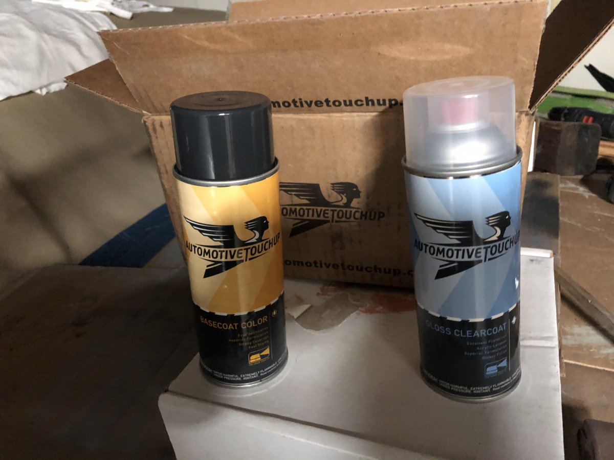

    I found a company on line to match the paint code on my 2011 F350 as I had to replace the mirrors and wanted to paint the caps to match the body. They took the code, mixed the paint, and had it to me in about 2 weeks and it matched really well. www.automotivetouchup.com was their site. I got adhesion promoter, paint, and clear gloss. It worked out well in my opinion.

    Automotive Touchup. Any color by name, year, and code. Base coat and clear. Small bottles too. About 2 weeks even now..this from a 1981 color

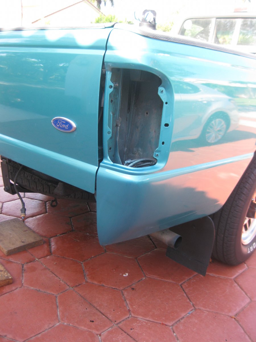

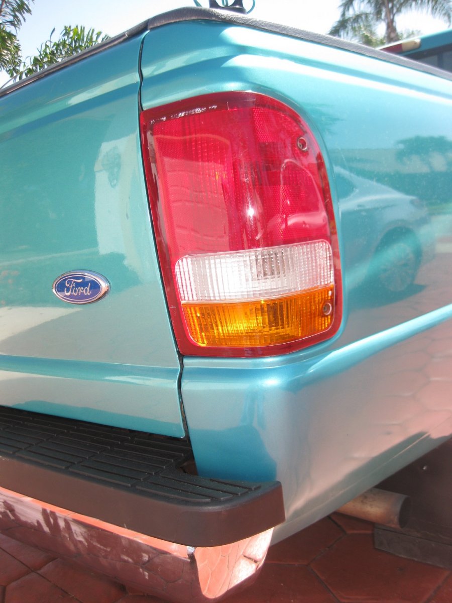

    Here's a list of what I bought from Automotive Touch Up. I purchased enough to paint
    tail gate but decided not to as the dent was so small. One body shop wanted $1200 to do the repair and another wanted $550. My cost was $185.
    1.I first back taped taped off area around dents and scuffed up the dented area with 180 grit. I didn't go down to bare metal.
    2.Then applied Bondo, and feathered it in.
    3.Then applied 2 to 3 coats of sandable primer and sanded it smooth with 320 and 400 grit.
    4.Then, where needed, applied thin coat of glazing putty and sanded it smooth to blend in.
    Then, let this sit for 2 days to allow for shrinkage.
    5.I then removed the tape, making sure it was nice and clean with no paint line ridges or adhesive.
    6.Then applied 3 to 4 super light coats of base coat (green) letting it almost dry between coats. It came out nice and smooth so I didn't sand it with 600 or a finer grit. If it had been a little rough or a large panel I would gave sanded the color coat with 600 grit or even finer. It won't harm anything to do this.
    6.After green base color coat was thoroughly dry, I applied the high gloss clear coat lacquer to the repaired area pulling spray can away from the original green metal on the panel so as to feather it in with no paint line.
    7.I let this dry for about a week and then lightly polished it by hand.
    There may be better methods but, this worked for me and has been on the truck for over a year with no problems. Be patient and give the Bondo and primer several days to shrink before apply color and clear coat.
    To gain confidence, FIRST practice making a repair on a scrap piece of metal.
    PS: Even though I had only a small dent in the tail gate, I would have made the repair
    and repainted the entire tail gate surface as the tailgate is removable and easy to paint.
    Good luck.

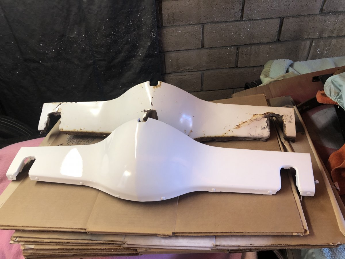

    I’ve finished my part. It’s off a 1940 Chevrolet below the grille tying the fenders together. I followed 19Fordy’s way. I’ll show the beat up one and no I didn’t repair it. I purchased another one off e-bay about 10 years ago that needed a little tlc but nothing like the bent up one. I have yet to do any rubbing or polishing. It’s a hard part to see installed. The paint match is close, the car was painted in 1985. My son says it will be going back to black some day. 927BC7EC-E6ED-4392-8CD5-1F52356C686D.jpeg 41D36FB0-6998-494C-B5D6-87961592CB31.jpeg
