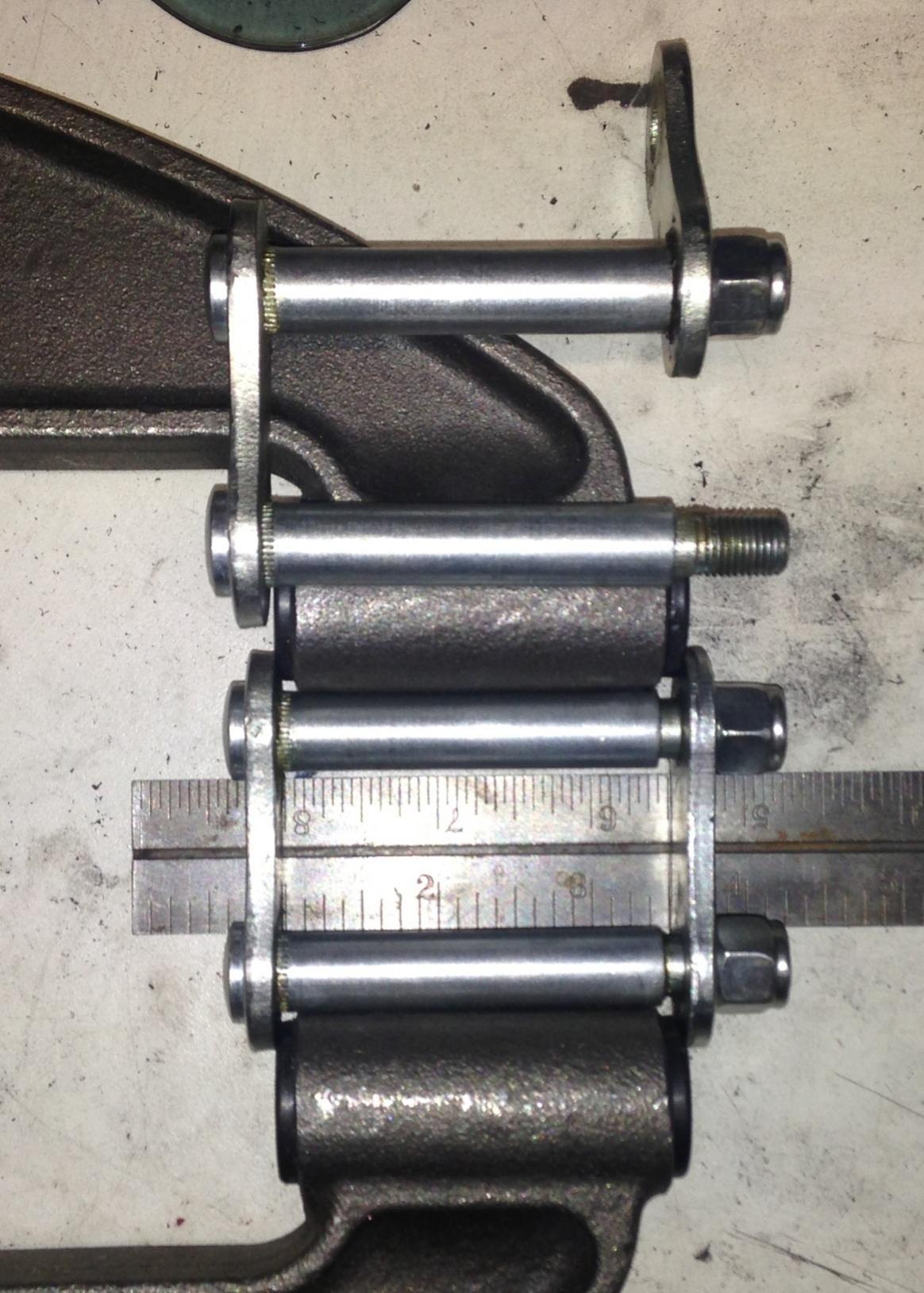

  28. Now that I have it apart for some good pics, and before I throw them in the toilet for a week- here's the problem with their 2-1/4 shackles.
    Per the phone conversation with the expert, and I quote :
    "These shackles are what we sell, and we've been selling them for a long time. Other people seem to be able to use them"
    "They are the same as Posies and everyone else's"
    they are not the same as posies confirmed by posies and the pin is 2.5" to the shoulder
    "Just leave the nuts loose, they are nylock nuts"
    I asked him if he had the parts there in front of him and he said "yes and a set a calipers too, I don't see a problem, I don't know what to tell you"
    I was expecting to hear something like "oh darn, we sent you the wrong part" not that "these are the correct parts"
    In the pic- the top nut is tight and you can see the face of the nut is a fuzz from being flush with the threads. Not 1/2 thread, not 1-1/2 threads but a fuzz sticking out.
    The rest of it ought to be self explanatory.
    With the shackles parallel, the threads don't engage the nylon,
    The shoulder on the pin is 1/8" short.
    You can make your own decision on if its correct or not.
    Bottoming the shoulder on the 2-3/8 pin will prevent any movement until the bushing shoulder is destroyed.
    If the pin were 2-1/2" like everyone else's there would be no problem.
