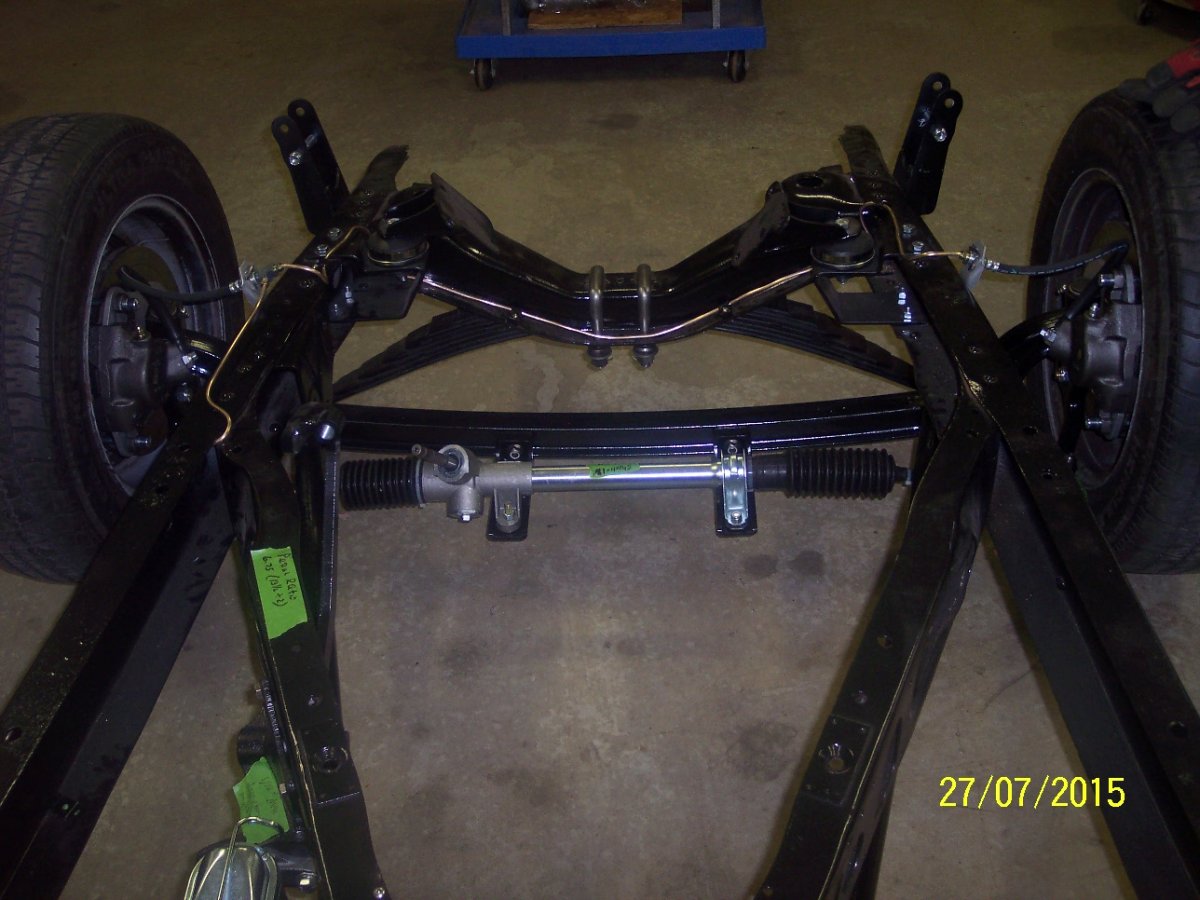

    The best driving hot rod I have ever driven is a 39 Ford coupe with a rack on a dropped axle. An old school machinist built it and I am copying it on my current 40 tudor build. Several 40/46's around here have been using them for years.

    Here ya go Gary. Still have to bend dropped steering arms up about 5/8" and take about 1" off each end of rack threads 100_9230.JPG 100_9231.JPG 100_9232.JPG 100_9233.JPG
    40 Coupe Since 69 likes this.
