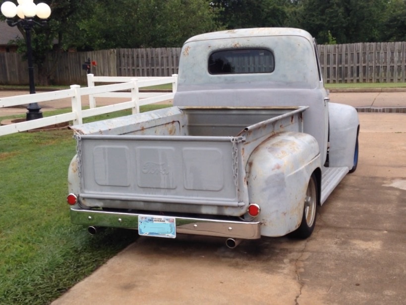

    I put the Flowmaster Hushpower 2 on my 49. They are small and don't have the off-set ports so they fit well. I wanted it quiet and these are a little louder than I would have liked, but they aren't so loud that the exhaust drone is bothersome. It also helps that they go all the way the back of the truck and past the bumper.
    For the Hushpower 2s from Flowmaster, I don't know that I necessarily recommend them for a 1920-40's vehicle, but for a late 1940s and newer I like them cause they flow well, don't take much space, and aren't too loud. Ill probably use something different on my '34 Ford Sedan.

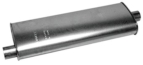

    Walker 17197.jpg I took the whole system apart yesterday and forgot I had Meineke Muffler install two new center pipes a few years ago. We were all dressed up and far away so I couldn't fix it myself. Sure enough they didn't push one of the pipes all the way into the muffler and it was loose.. I tightened everything up and no more banging around but it's even more quiet lol..
    I ordered a pair of 17197 Walker SoundFX mufflers. These mufflers are 4.25 X 9.75 X 36.5 They have a 28" body, they are big! I'm going to run them without tail pipes but with a pair of turn downs. I always liked the way those old 454 dump trucks sounded down the hill from me so this should sound similar..
    I have to get a pair of down pipes swaged on one end so the pipes fit male to female all the way to the back...

    I also always think of the Flowmaster’s as the original Flowmaster 40 series which are super loud and very 1980s Muscle Car sounding. I had a set of those on a 91 Pontiac Firebird while I was in college and I had them taken off because they were so loud. The Hushpower 2 mufflers made by Flowmaster are much different. I have the 18” long ones on the 1949 Ford F1 PU.
    This is a video of the ’49 Ford PU leaving the house. It gives you a good idea of the sound of them.
    This is a Video of my 1934 Sedan and it has a muffler that looks like this picture, but Im not sure what brand they are. They are way louder than the Hushpower mufflers.
    Also, on my 34, the tailpipes end and have a small down-turn right in front of the rear axle. On my ’49, the tailpipes go up and over the axle and end at the back of the rear bumper. This is what I think makes the 34 sound louder because the sound echoes off the ground and under the car vs being set free into wide open world. I hate having them dump under the car on the '34 and plan to change them to exit out the back like the ’49 Pickup does.
    A few people on here are saying the 17197 Walker SoundFX mufflers are a pretty good choice. When I re-do the exhaust on the '34, I might try a set of those. The Hushpower 2's were pretty expensive compared to how much the Walker's cost.
