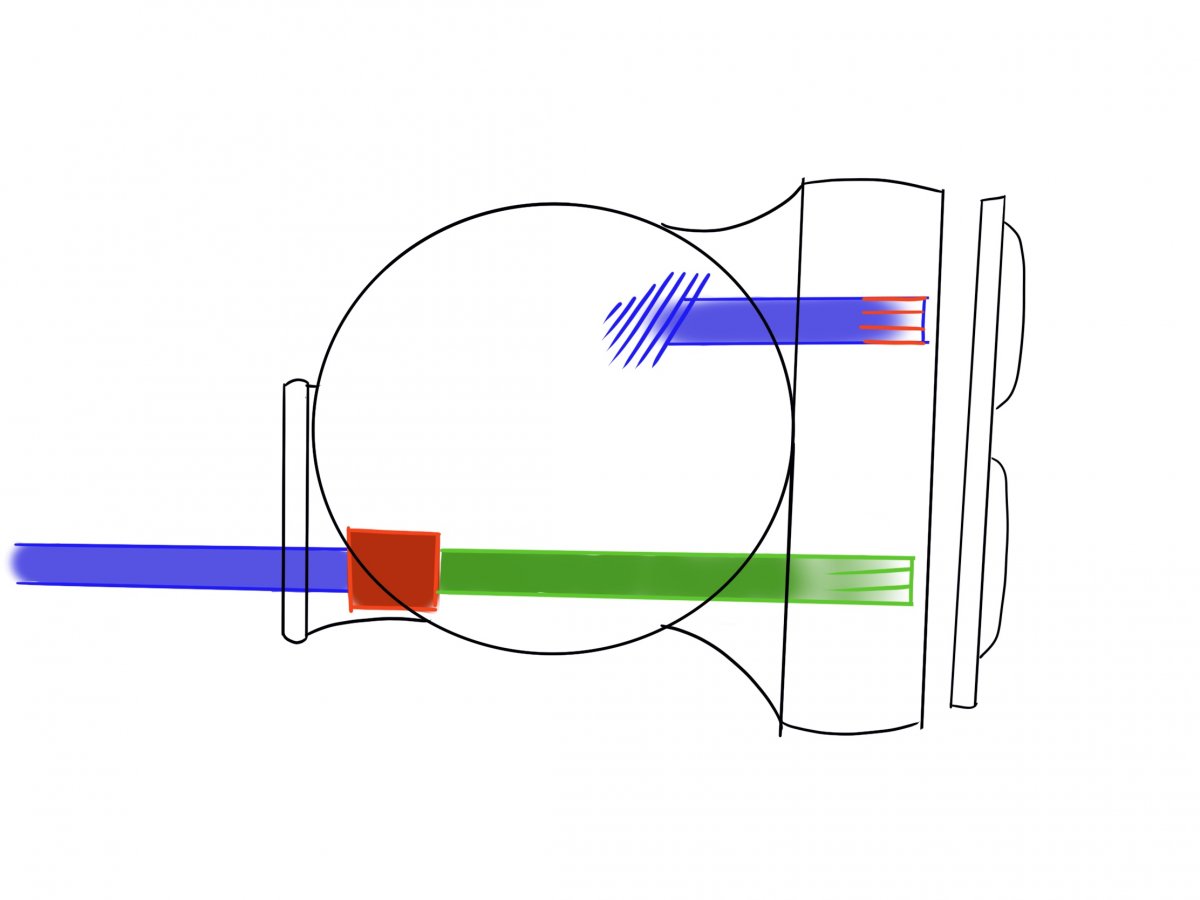

    Ok I drew this quick to make sure I was understanding.
    The blue is the stock model A drive shaft.
    The red is the added spines and coupler
    The green is the lower shaft.
    348C384F-7690-4FCA-B6D6-6AD73F285778.jpeg That all look right?
  4. alchemy
    Joined: Sep 27, 2002
    Posts: 22,319
    alchemy
    The green shaft sticks out the front of the housing. The coupler is out front.
    Tim likes this.
  5. Tim
    Joined: Mar 2, 2001
    Posts: 19,622
    Tim
    from KCMO
    Ok cool. I can change that easy enough. Thanks :)

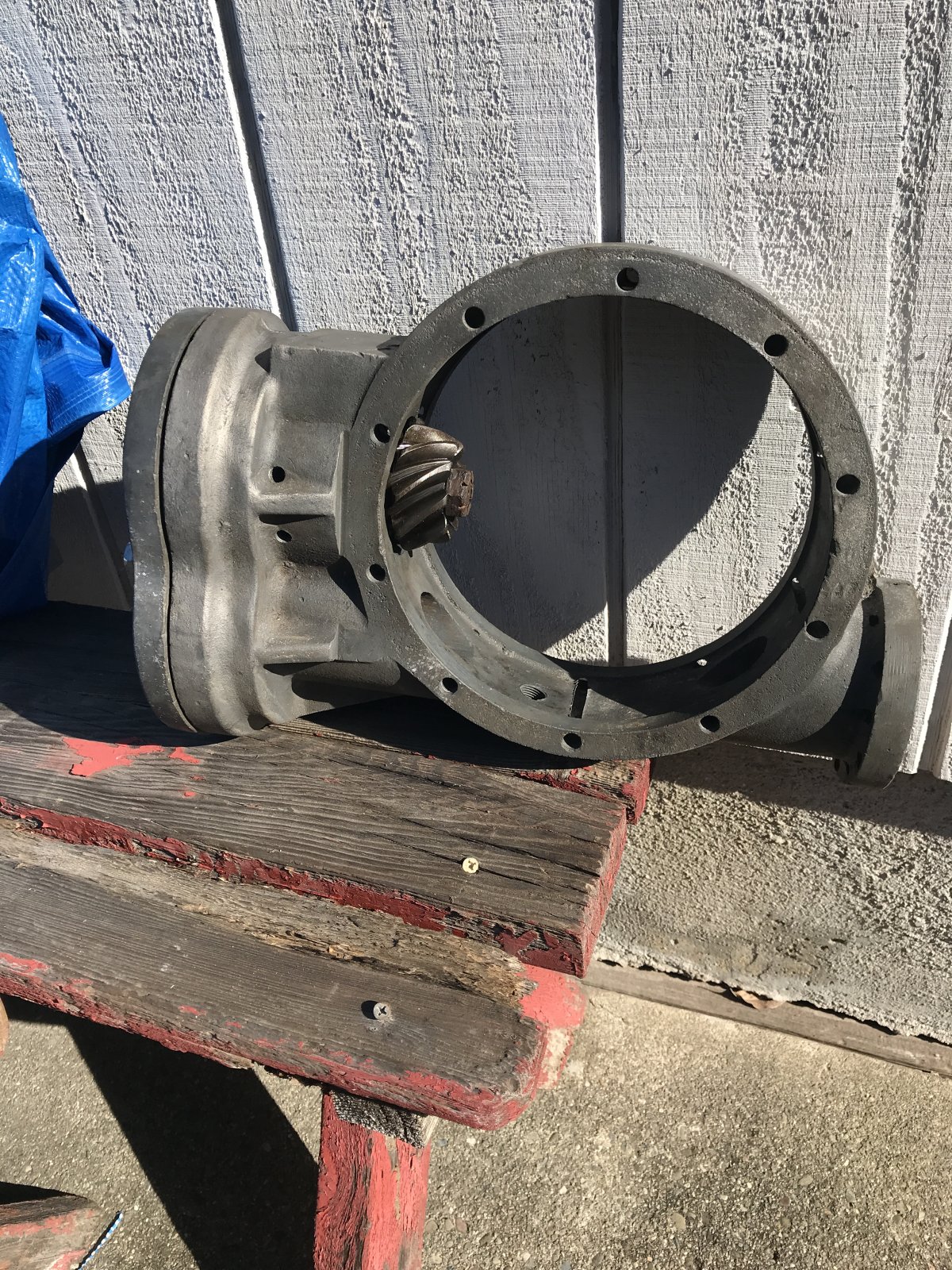

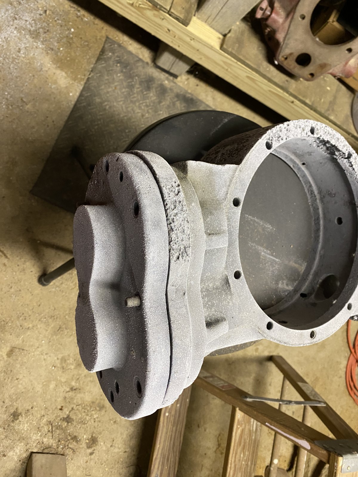

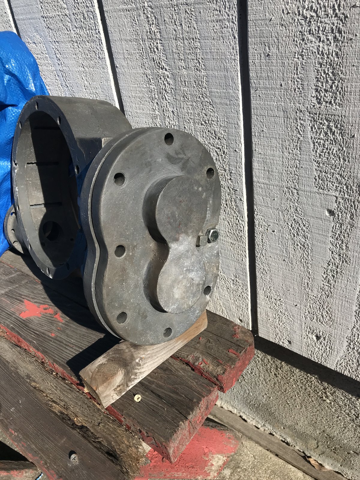

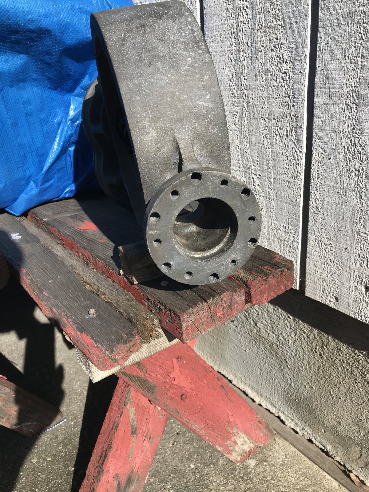

  14. briphaeton
    Joined: Dec 29, 2011
    Posts: 49
    briphaeton
    from cal

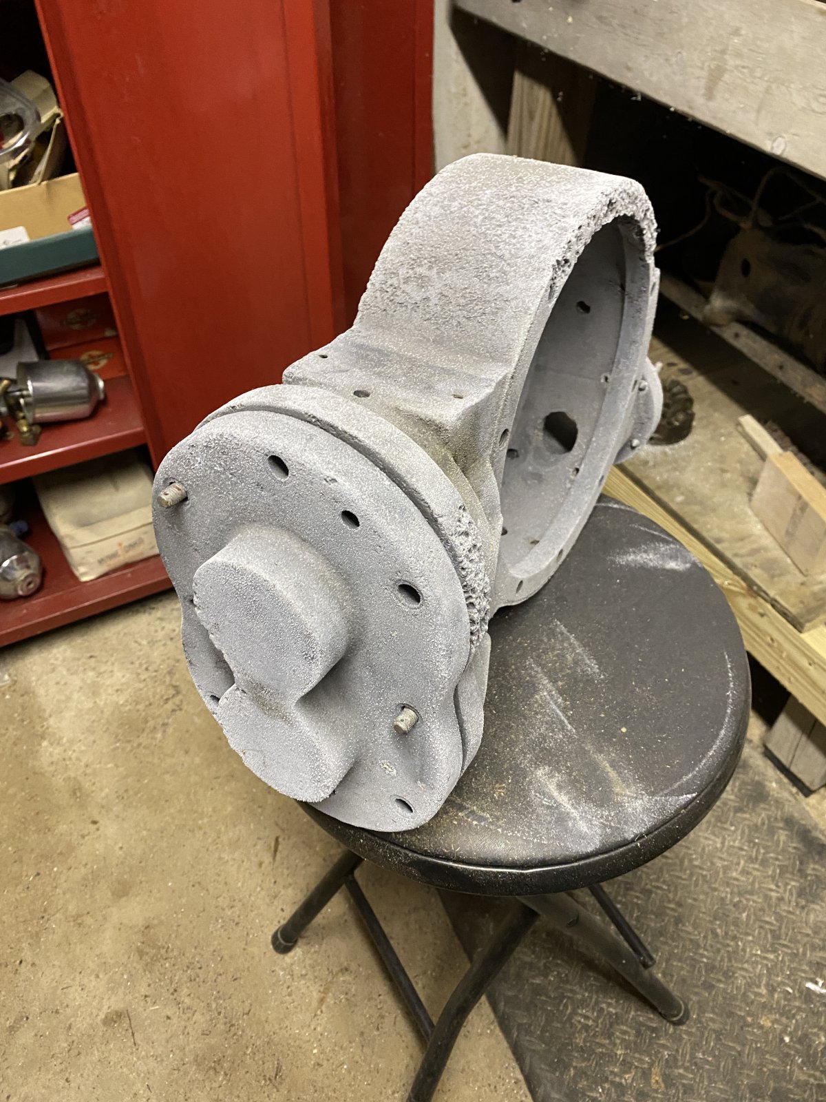

    I would appreciate help identifying this Model A no name QuickChange ? It's uses the same bearing as a Halibrand V8 QuickChange
    Thanks, Brian

  15. alchemy
    Posts: 22,319
    alchemy
    I’ve got one of those too. No idea who made it either. Mine has been eaten by the magnesium worms a bit though.
    stillrunners and Tman like this.

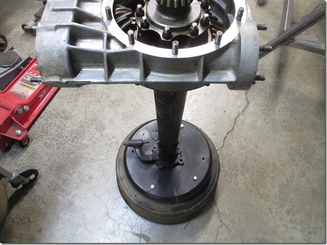

    I set up this rare Halibrand 101, that used the wider V-8 change gears, with safety hubs for this belly tank. Ed 2.jpg IMG_7647.JPG IMG_7649.JPG
  17. wrenchbender
    Joined: Sep 5, 2007
    Posts: 2,463
    wrenchbender
    That’s odd that those don’t have a pinion support bearing did they early ford 3/4 rear that these were based off of have a support bearing I can’t remember it’s been a long time since I had one of those rears apart

  18. GearheadsQCE
    Joined: Mar 23, 2011
    Posts: 3,670
    GearheadsQCE
    Alliance Vendor
    @wrenchbender,
    briphaeton's unit is based on the Model A not 3/4 ton. All the the 3/4rs used the pinion nose support.
    I went through all the pics I have of older/unusual QCs and none of them look like that.
    stillrunners likes this.
  19. briphaeton
    Posts: 49
    briphaeton
    from cal
    Thanks Gearhead and Alchemy. It's based on a Model A. I know they made a ton of different Quickchanges.
    We know there at least two of them. I need to make the lower shaft.

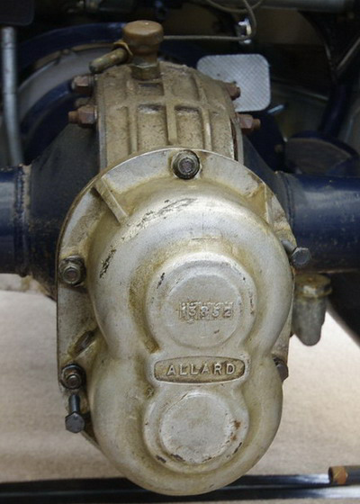

  27. DDDenny
    Posts: 21,649
  28. GearheadsQCE
    Posts: 3,670
    GearheadsQCE
    Alliance Vendor
    @DDDenny,
    Cool!
    I hadn't seen that variation before. The Allard's I've seen are not finned like that and resemble a Halibrand.

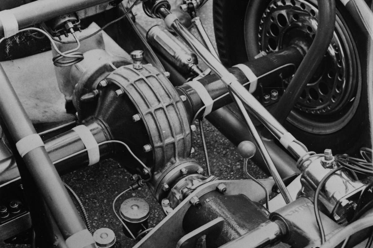

  29. DDDenny
    Posts: 21,649
  30. Model A Mark
    Joined: Apr 30, 2008
    Posts: 1,319
    Model A Mark
    from dallas
    1. Holley 94 Group
    lol omg I see now, thats the seat, nut pad sitting vertical behind the rear qc cover
