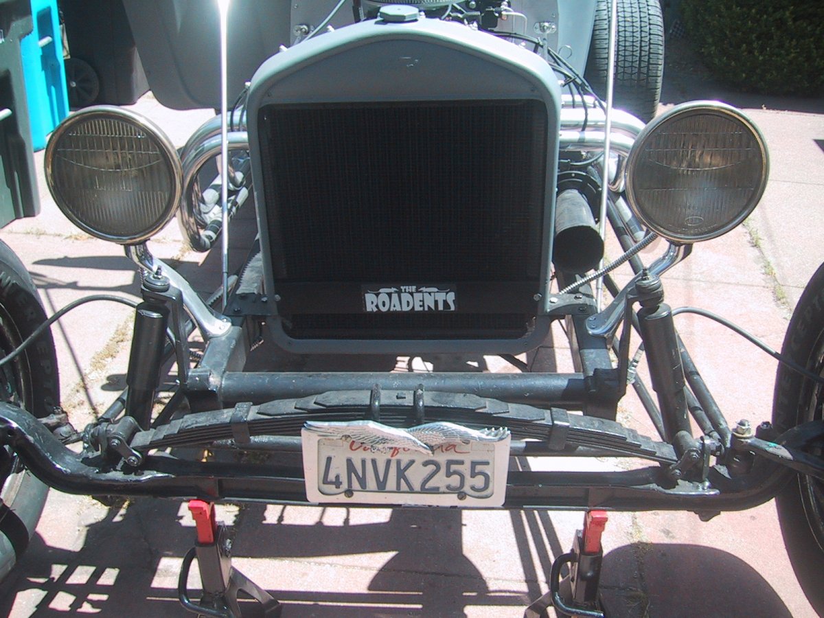

    Here's a bunch of photos. As you can see, it has no crossmembers other than that flimsy thing supporting the tranny. I also have no idea how well the suspension is adjusted, the alignment, etc. If anyone can steer me to a rough guide to how to set that stuff up, I'd be very grateful.

  29. Marty Strode
    Joined: Apr 28, 2011
    Posts: 8,912
    Marty Strode
    It could use a center crossmember, with some diagonal legs, and a caster check.
    need louvers ? likes this.
  30. Happydaze
    Joined: Aug 21, 2009
    Posts: 1,933
    Happydaze
    From the pics the only thing that immediately gets me is the big meats on the front and the huge scrub radius. OK you can get away with that but the toe (in) has to be right. Wrong and that could easily have you being dragged all over the place by the road. Check toe in. If that doesn't help that much trty substantially skinnier front wheels / tires.
    Chris
    hipster and modified like this.
