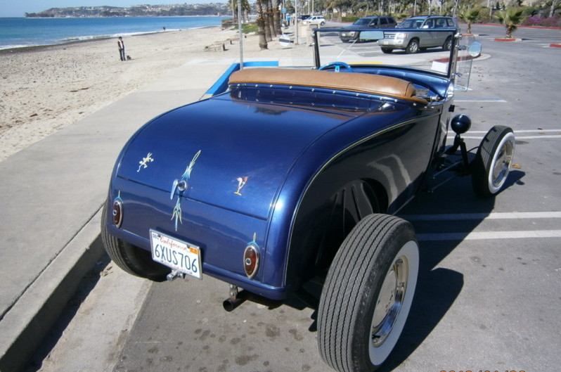

  10. I think I cut mine out with a torch then filed the hole down then drilled out the mounting holes. I also didnt bother measuring anything, I hung the bezels on bent pieces of coat hanger and moved them around until they looked right. As I recall it was two fingers of spacing on the sides and three on the top.
    They look pretty crooked in the pic above but they don't really stand out to me when looking at the car.
    Farther down and to the side
    Fogger, Welderboy60 and jmiller1918 like this.

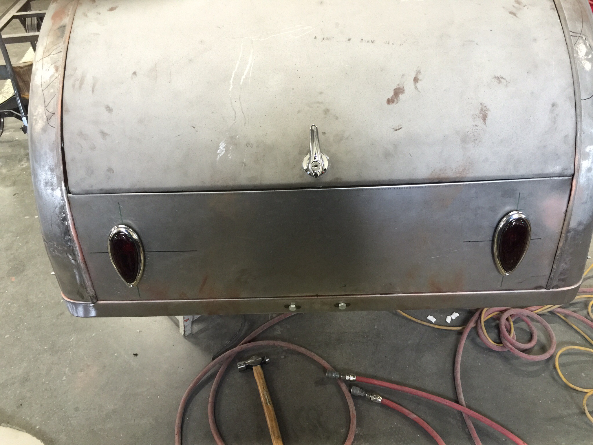

    Honestly, I wanted this to go super easy for me so I simply ordered the rubber shit that goes under the light from Macs. It has a tear out hole that's the same size of the bucket part that sticks out on the back. Comes in pairs. Measure the center lines of your lower panel (left-right and up-down) and draw lines across. If already painted then just cover in painter's tape. A piece of tape on top of the rubber and put them where you like them. Then measure their centers so you can make sure they match up. Trace the holes from the rubber. Cut with a hole saw to get the bulk of it out of the way then either a an air saw or cutting wheel, and a file to clean it up. Took me literally 15 minutes... If that. Rubber pieces were a few bucks... Also, the two studs (if repopped like mine) aren't always perfectly in line so keep that in mind. I just eye balled it and made their holes a tad oversized. They both went just to the sides of their respective vertical lines in the pic. They're straighter than they look in the pic, haha. Worked out great. Easy peezy.
