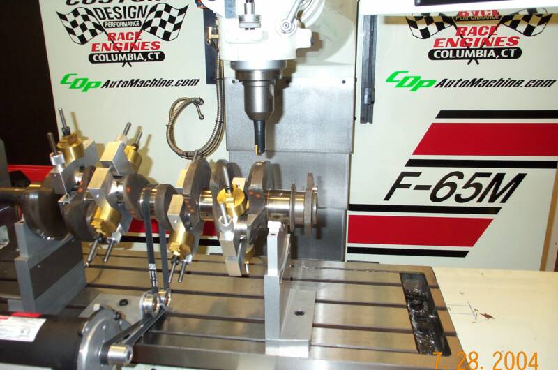

    When they balance the crank they use bob weights that mimic the weight of your rod, rod bearing, piston, pin, rings, possibly a thing coating of oil. If ANY of those items are changed, they crank needs to be balanced accordingly. CDP-D.jpg
