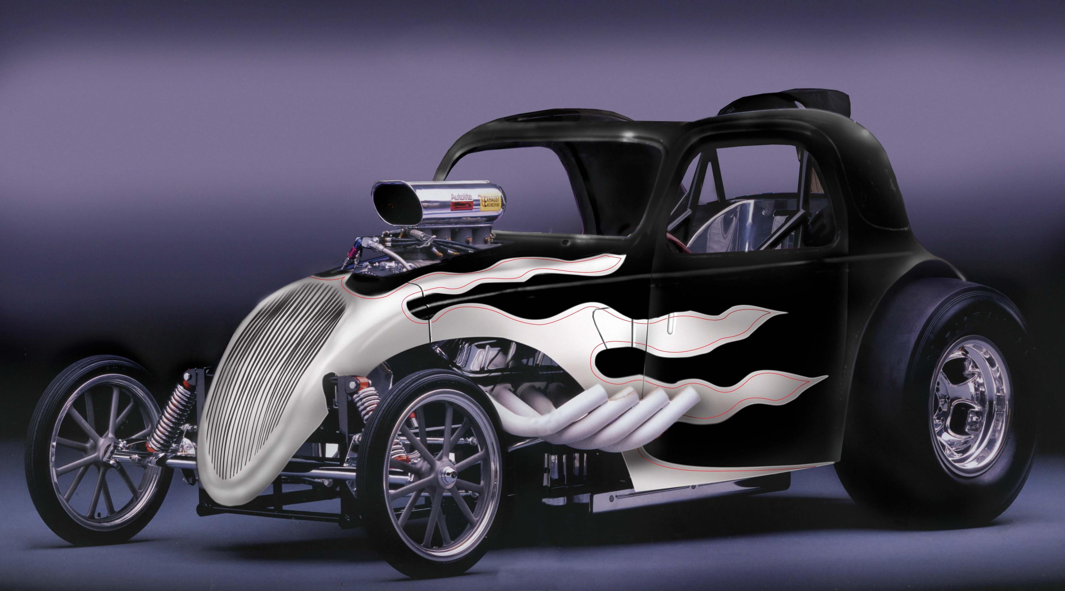

    I have a Hilborn style scoop, so the tunnel ram setup would go nicely with it.
    It's funny you mention the shark fin scoop, I originally pictured the car with an Ohio George style fin scoop. Below are the before and after mock ups. By the way, I'm still to design the final signwriting, I need more planning and research and sort my mind out from the hundreds of images I've collected.
  28. I love both mock-ups above - BAD ASS!!
    Things to consider:
    Hilborn scoop looks good on an injected engine - Not as good on a carbed one. With the low hood of the Topo, the carbs, linkage, fuel lines, etc. would be well above the body and might not look so great. I had bought a tunnel ram for my car but decided not to use it for this reason. Also, alcohol carbs are kind of expensive (2 = big $$). The tunnel ram will also kill off some low-end torque which you were concerned about when you mentioned the zoomies.
    The shark fin scoop can be used with a single carb. This will save you some $$ and make the car easier to tune. Most racers will tell you that a well tuned single carb car will out run a tunnel ram car any day of the week. It would be ideal if you could find an intake that was low enough to keep the carb under the body so that just the scoop protruded through (like in your pic above).
    I'm sorry if I took this thread off on a tangent, but I'm excited about your project and just wanted to share a few thoughts, opinions, ramblings...

    Perhaps I'll stick with the Edelbrock intake I have, get a single, larger alky carb and make a shark fin scoop.
