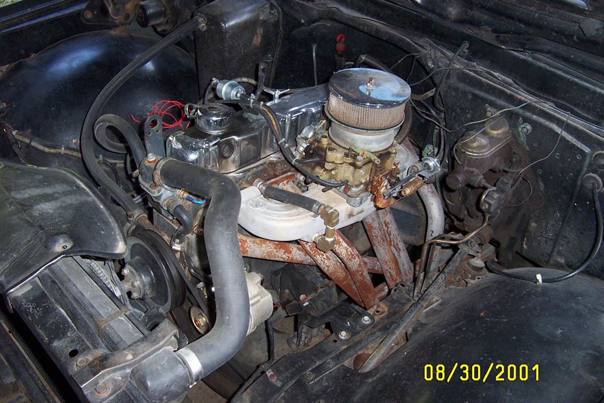

  3. I think my son bought a Q-jet for an 85 Monza 262 cu in. for his [my old] 292/700R4. Not sure what the TV cable and bracket is. 68chevypu.jpg
