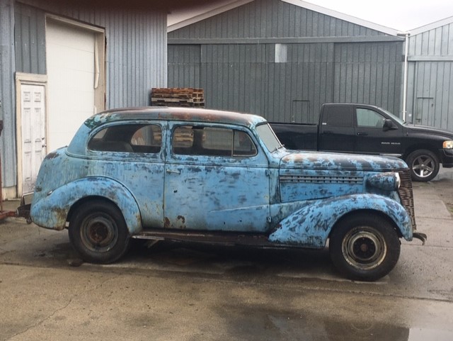

  3. Looks like a '38 Chevy, they make nice drivers.
    A friend of mine had a '37 and it road great. HRP

  5. oldiron 440
    Joined: Dec 12, 2018

    If it is a Master and has "knee-action" front suspension, it's probably worn out. As far as I know parts for these are almost imposible to find. When I was in college in the early '60's, a friend of mine had a real nice '38 Master coupe. The knee action front suspension was shot and he couldn't find parts even back then. I spent almost an entire summer with him removing the entire front suspension and replacing it with a straight axle from a Standard. It was held on by lots of rivets, and all we had were hammers and cold chisels. Lots of fun, but it turned out well.
    Seriously, check the front suspension to see what it is; a lot of them were replaced.

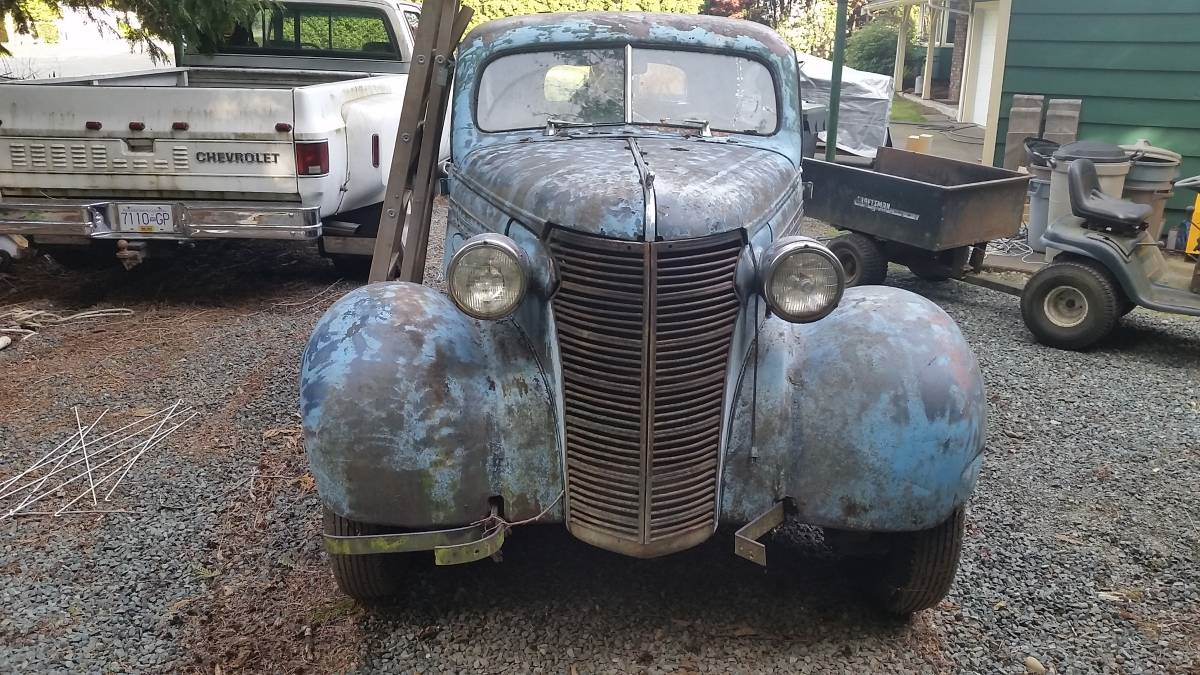

  10. It’s original.knee action

    My dad said those knee action front ends were problematic with just a few years on them. If you went over a rise at speed and unloaded the front end, it would go over center and stay there until you jacked it up got them back in position. I would seriously consider a straight axle from the "lesser" Chevy model.

    Early Chevys are a little harder to find parts for but yours looks pretty solid. By the time this car was manufactured most of the wood was gone out of the inside. I like to see early Chevrolets come back to life just because there are fewer of them still around than Fords (I like em' all though). It looks like a great start!

    I like your 38 and it appears to be pretty solid. It's a bad name around here, but a Mustang II is a great option for your front suspension. Heitzs, Fat Mans, even Chassis Engineering (now Heitz), has good swaps for the knee action front end. Chassis Engineering (Heitzs) has what you need for a rear end swap, as well as a few others. The engine swaps are endless---- GO FOR IT !!!!!!! Bill

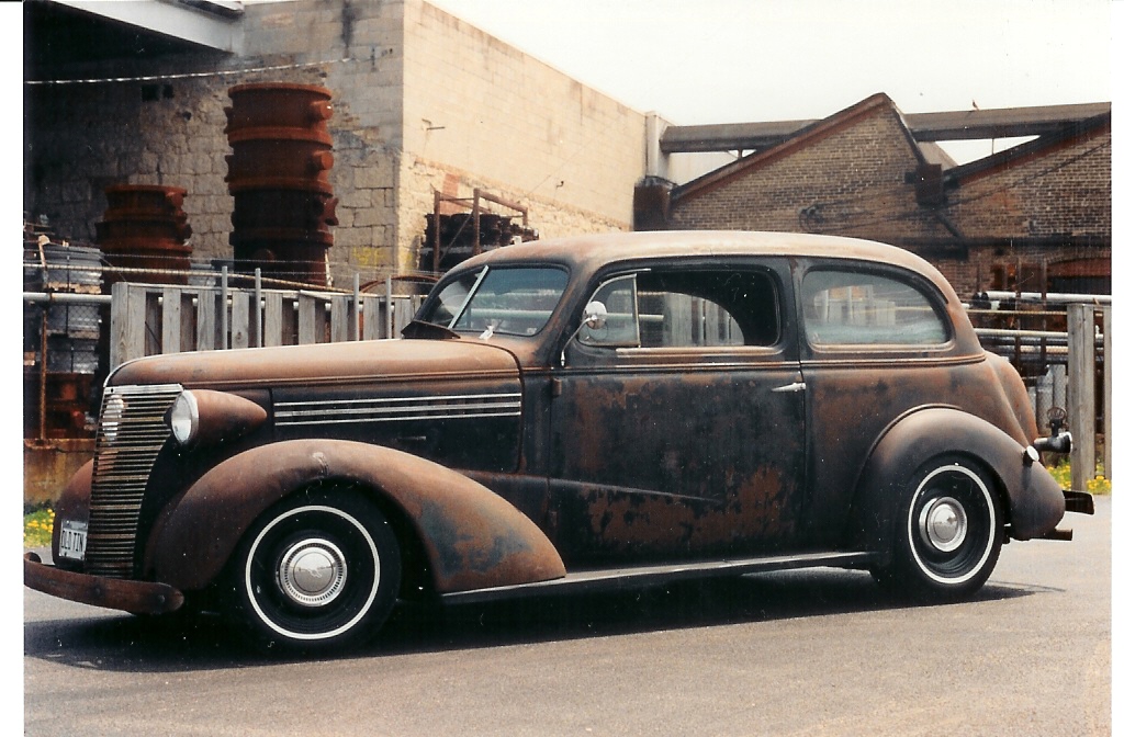

  26. ...a lot of these guys are wrong, you can build an enjoyable ride out of that car economically if you really want to;..build it like this one I had years ago;...for about $3000 or less, drove it everywhere...lot's of fun per dollar.

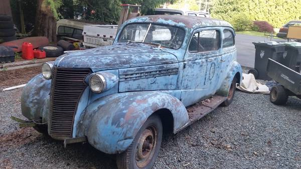

  28. thumbnail_IMG_2513.jpg Getting transfer papers and the reggie done today.
    Changed the flat tire, on the rear with a new tire 650 16. Popped the drum, brakes looked good as well as the drum.
    Here's a pic of the other side.
