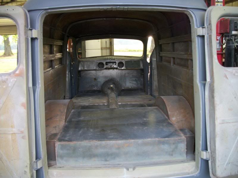

    Finally pulled the 48 out last week and stared to get to work on it. I have had this project for about 5 years now and haven't done anything with it yet. Just has not been the right time until now. It all ready had a lot of work started when I picked it up. The first pic is what it looked like when I got it.
    I pulled the Chevy running gear out and installed a MOPAR 360 and a 727 tranny that I freshened up some with new gaskets, oil pump, cam and bearings,waterpump and a few other things. I was going to build it but once I got inside I could tell it had been rebuilt not long ago.

    This what it looked like when I got it. You can tell how long I have had it by looking at how clean the walls are in the background compared to now.
    Removed the rust inside and under it then painted it black after etching it. I forgot to wear a hat and had jet black hair for a couple days after.
