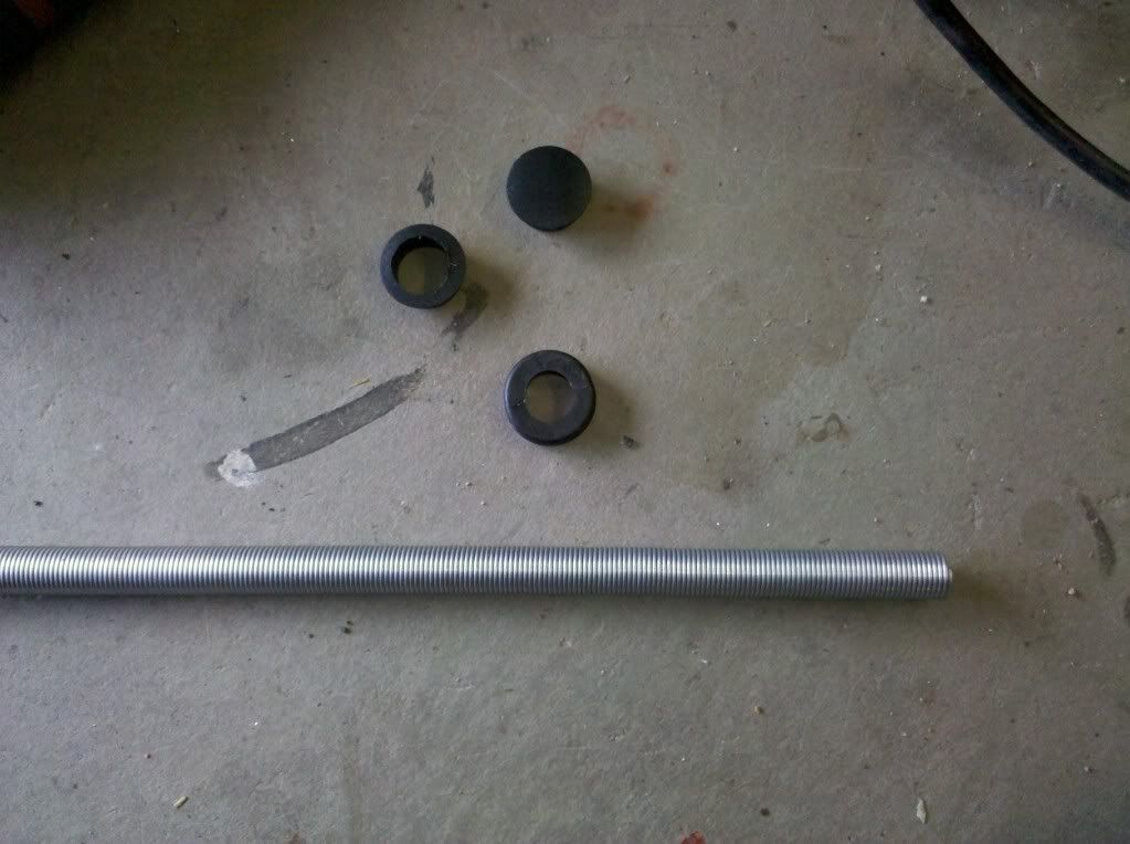

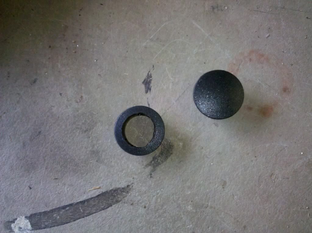

    Wow, what a great weekend! Fixed a couple more little issues and got to put another 5 miles or so on the truck and helped Alex get a bunch of stuff done on his truck! It's too fun cruising this thing around! I'm still working on the interior and stereo stuff, so it's not a driver just yet. I was trying to figure out how to run my speaker wire without it pinching the wires as the door closes. I saw a friends truck and the kit they used but me being the cheap-ass did the same thing with very little money. Went to the hardware store and picked up a (1) Screendoor spring 16"x9/16" (2) 7/8" plastic hole plugs and a couple of rubber grommets. [​IMG] You'll notice I took my die grinder and made a hole in the plastic plug, this is where the spring will slide through. I cut the spring in half so I have an 8" chunk for each side. I should have taken more pics, so I'll have to explain. I drilled a hole in the door jamb about 3" up from the lower hinge hole 3/4" from the inside edge of the door. After taking the die grinder to open the hole up to fit the plastic plug, I got inside the truck, closed the door and reached through the access hole to use my sharpie and trace the hole I drilled onto the door jamb. Now the holes line up. I took my plastic plug that I'd drilled out [​IMG] so the spring slides smoothly through it and glued it to the door hole. I then finished opening up the door jamp hole to fit the rubber grommet that has a 9/16" ID (same size as the spring diameter) and installed the grommet. I wrapped a couple turns of electrical tape around the first 2" of spring so it would fit snug into the the grommet and put the other end of the spring into the door. When you close the door the spring stays tight in the jamb, [​IMG] [​IMG] but glides smoothly into the door so the wires don't pinch! Less than $10 in the whole deal and it works great. I actually trimmed the tape so you couldn't see it and put a little dab of weatherstrip adhesive on the grommet and spring so it wont go anywhere. Here's how it works and I'm sorry about the compressor noise! VID_20111002_131939.3gp - YouTube

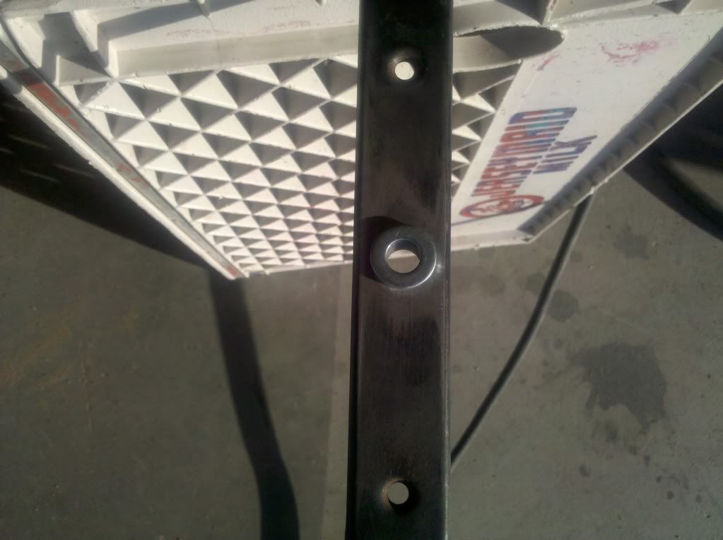

    Here's another little no money deal I just finished. I installed my new/old distributor and coil after yanking out the HEI. I couldn't find the plug wire looms I was looking for, so I whipped up something to get me by until I find what I want. I took some 1/4" washers, welded them together and then flattened the weld with a sledge hammer [​IMG]. After painting them black I installed them on the bottom 2 bolts of the valve covers. I routed my wiring before cutting the wires to fit and separated them with black zip-ties. I cut a couple small chunks of 3/8" fuel line, split it and put the wires inside before zipping them to the washers bolted to the covers [​IMG] [​IMG] It's very simple and pretty much free!

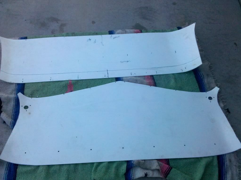

    Now for the interior... I used some really cool sign plastic for the door panels and headliner [​IMG] [​IMG] that my friend Joe hooked me up with. This stuff bends and cuts great and I used a propane torch to heat it up for holding it's shape on the headliner! Alex and myself bounced around some cheap interior thoughts and he had a great idea about doing a race collage and using it for the headliner. Awesome idea, but how would it look with my mexican blanket colors idea I was thinking? So now LOTS more idea swapping about how we should do it and how the 2 ideas will work together. I started collecting pics and put the whole collage thing together in Photoshop and tried to give it the old sepiatone (kinda beige and black instead of grey) look so it would have an vintage feel to it. Once I had it layed out how I thought it would work, my friend Joe printed it up on vehicle wrap vinyl. Here's how it came out... [​IMG] [​IMG] [​IMG] My friend Brian sewed up the seat with some brown vinyl and the blanket I gave him (it looks soooooo cool!) and Alex made the kick panels to finish it up! I scored some old Cal Custom door handles to really give it the vibe! I need to finish the carpet trim pieces at the door jambs and get some arm rests, but the interior is pretty much done!
