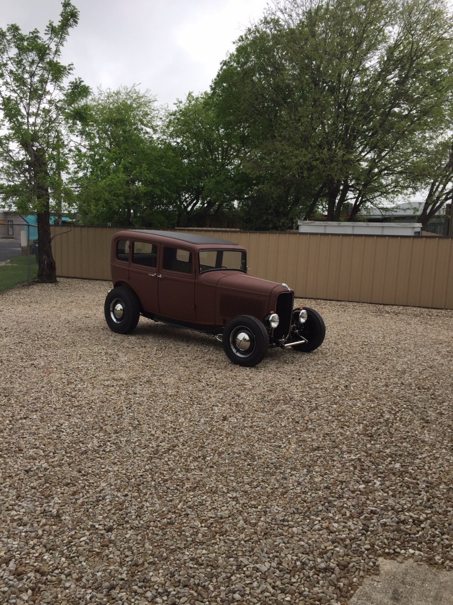

  1. I almost said Low (er) Buck 32 since I keep throwing money at this thing. Still, it is a budget build and it didn't completely break the bank. So, I guess it works.
    Some may remember I bought this chassis as a pile of parts a few years ago and paid the speed shop here in town to build it. I quickly got overwhelmed with it and other things and tried to cut some corners just to get done, which of course never works. Anyway, it's back on the road and burning gas.
    It's not anything you real Hot Rod guys are in to but for a poser like myself it's about the best I can do.
    But, hey... we're having fun.

  4. Somehow I managed to get the whole body in the bed of a LWB truck, believe it or not, and off to be blasted.
    Nice paint is not in the cards right now so I just did some light blocking and sprayed it in my own custom mix of Rustoleum red primer with a little flat brown mixed in.

  6. A few interior pics. Front seat is a 3rd row bench from a Ford Expedition I bought off of Craigslist for $5o bucks. I had to cut about 4" out of it and tack it back together to make it fit. Rear seat is plywood that I had the trim guy build to match. A full interior is not in the budget so the seats are all the upholstery we have at the moment. Fabric is outdoor Sunbrella fabric with vinyl backs & sides.
    The crossmember in the chassis interfered with a floor shifter so I went with a column shift to keep things easy. I think it works being that the car is basically a wagon anyway.
    Column mount and dash bezel are billit cheepo units I bought off ebay. I had them powder coated black so they wouldn't look so Street Rodder-ish.
    Rubber mat is from Tractor Supply cut to fit.

  8. The chassis came with the coil overs and disc brake kit so I just ran them. I had the whole chassis and running gear powder coated in 80% gloss black to give it all a more old school vibe.
    There's something about blacking things out makes them appear more vintage looking even when the parts are new. A few chrome pieces keeps it from being to dark though.

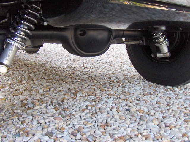

    Rear end is an 8" Ford out of an old Maverick that a buddy rebuilt for me. It's painted in Rustoleum satin black.
    Taillights are a leftover set of generic stainless re-pops I had on my 66 C10 truck.

  10. I rebuilt all the old latches and window mechanisms with new springs and everything but I don't trust the rear latches to keep the rear suicide doors from flying open on the highway. So, some brass chicken coop latches give a little extra insurance until I can figure out something else.
    Top is a Juliano's kit with a 1/4" plywood underlayment.

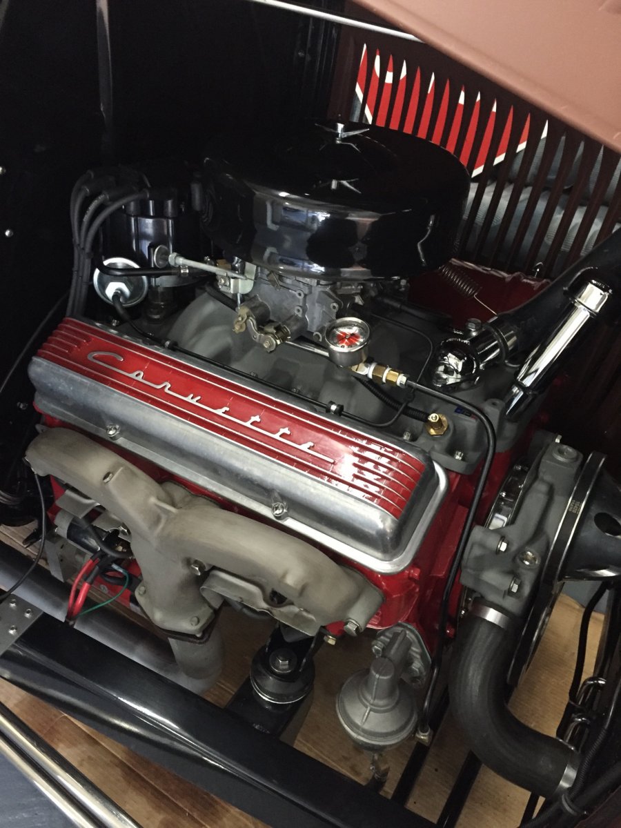

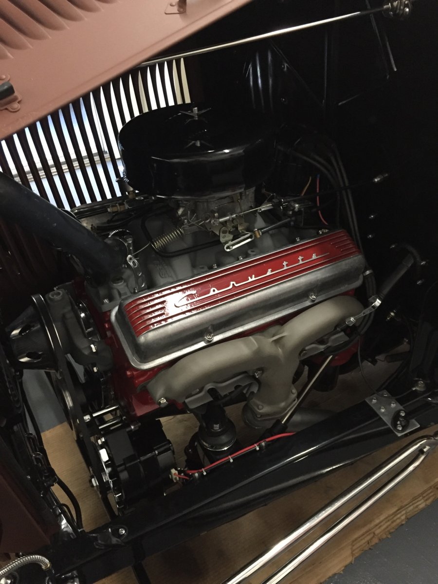

    Motor is a rebuilt 283 with re-pop Corvette valve covers and a single Carter 600 carb. Bought a new Taiwan HEI distributor off of eBay and a black cap for cheap and paired them up with a set of Corvette plug wires. The HEI makes plenty of spark and is cheap & reliable but they're pretty big in size. The plain black cap helps it blend in more.
    Air cleaner is one of those re-pop mushroom deals that I had powder coated to mimic an oil bath air cleaner. Bought a $10 fuel pressure gauge just cause it was the right color and it made the motor look a little more Hot Rod.
    I actually have a nice Edelbrock dual quad intake and carbs I thought about running on this car. But, with the hood and sides hiding most of the motor I'll probably just save it for another project.

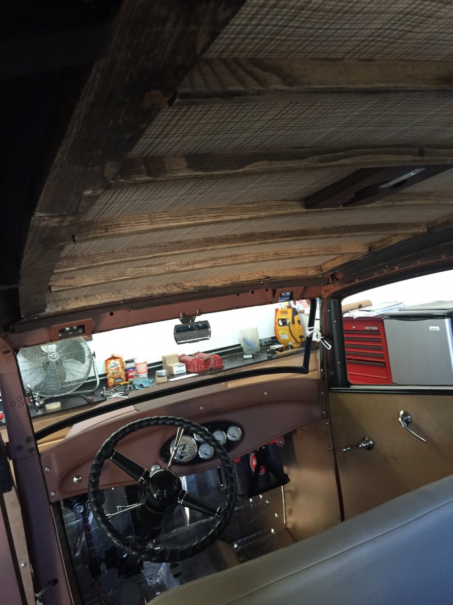

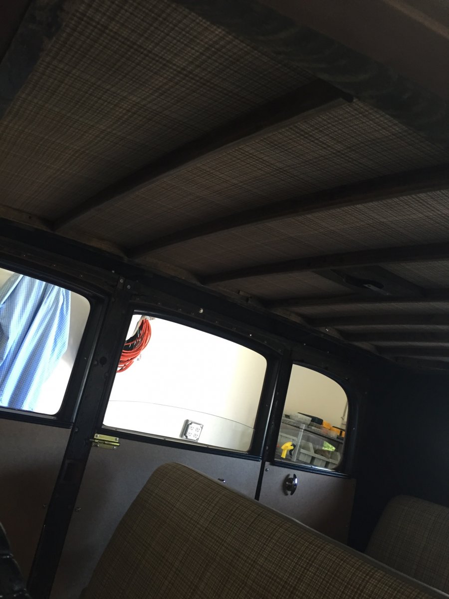

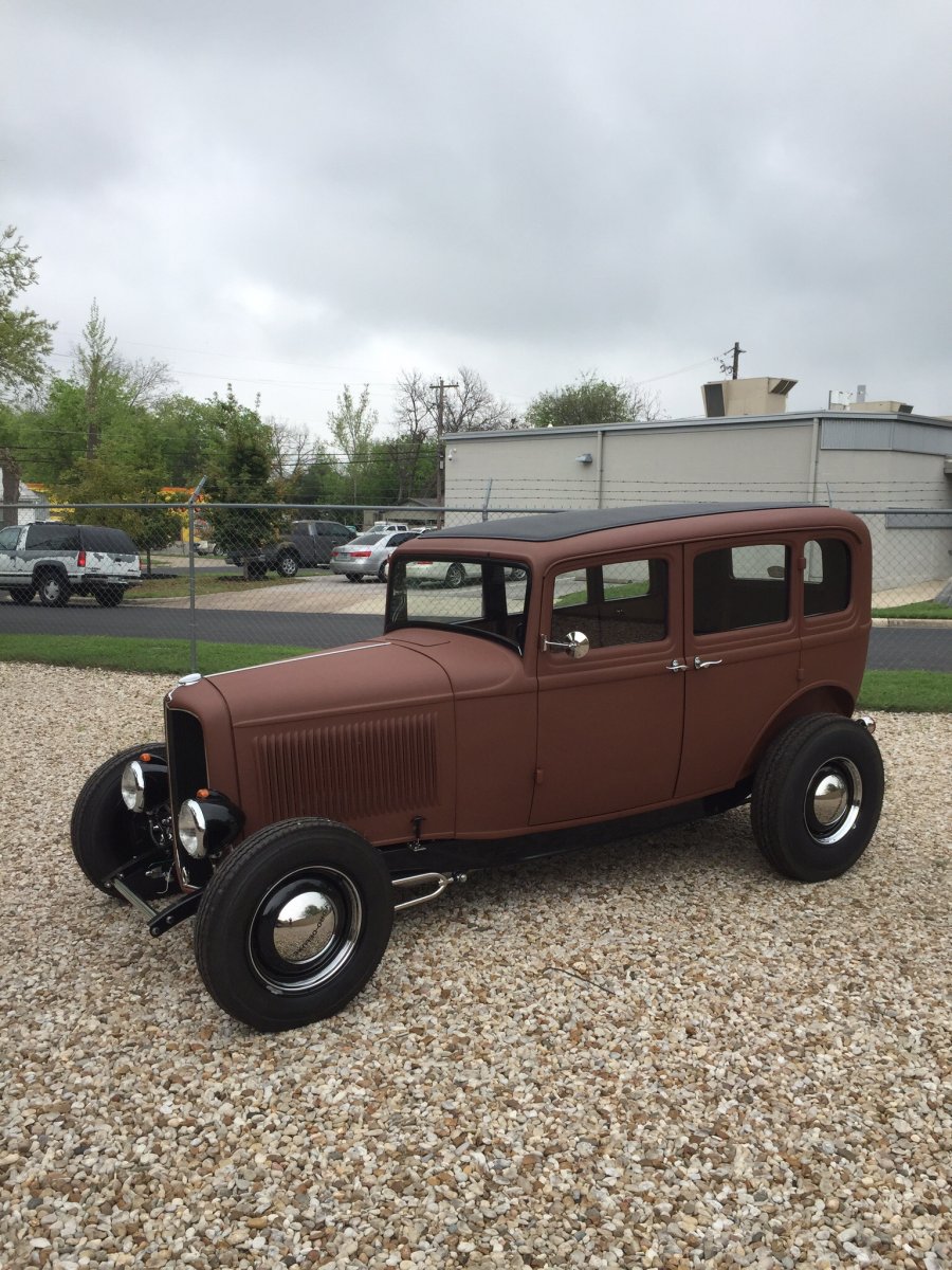

  29. image.jpeg image.jpeg image.jpg image.jpg image.jpg image.jpg A few more shots.
    The wood kit for the roof is new but I stained it and then sanded it back down to match the original wood in the rest of the car.
    Some extra fabric makes a neat headliner.
