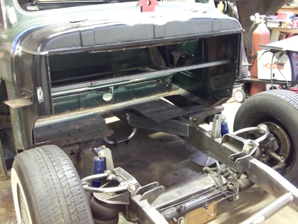

    I thought i would share with you what i did to my firewall recess, i took the outside corners off inline with the fenders as it was wasted space under the dash and cleaned up the bulky square look of the firewall, in my opinion.
  2. I thought about removing the rain gutter things but decide not to, Once i get the inner fenders made you wont see much of the firewall. I mostly just wanted it to be smooth.

    If you look at the last picture i posted, you can see i did not remove the gutters, i actually cut and moved that part of the firewall back and reused the gutters amd made a new center gutter to cope with the height of the engine, i liked the look of the original gutters to much to get rid of them, plus the fact they are totally functional still is a bonus.
    Your Dodge is very impressive and i love your choice of hubcaps too.
    Do you have any other trick plans for the interior at all ? Maybe custom tin door panels ?

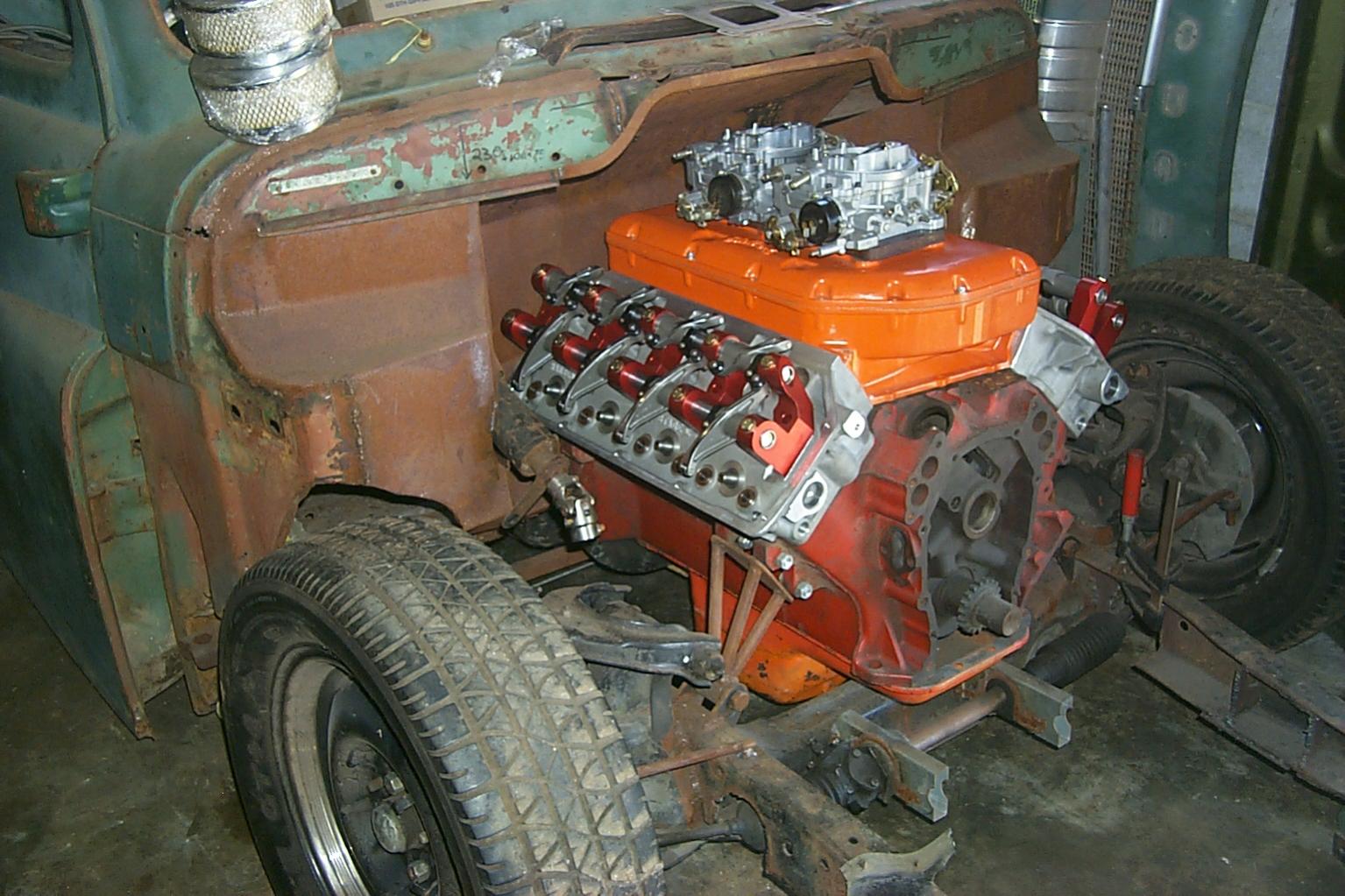

  4. Nice to see another Hemi going into a Pilothouse.
    Tell me about that intake...never seen a box style intake like that for a Hemi.

    Hi Dan, the intake is called a "Rat Roaster" they are for 426 Hemi engines, they come in different configuration tops too, do a google search, they are a cool intake.:cool:
