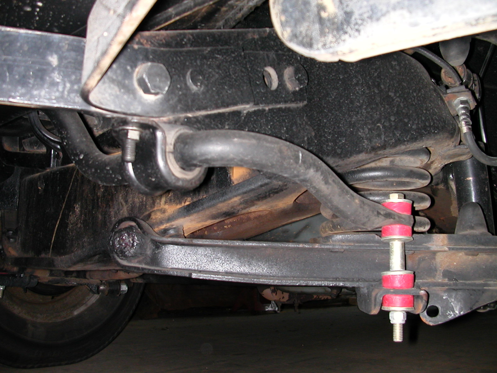

  18. gimpyshotrods
    Joined: May 20, 2009
    Posts: 23,333
    gimpyshotrods
    Absolutely NOT necessary. Don't over-think this, you'll just end up spending a ton of unnecessary money.
    I have two very satisfied customers who drive these daily, with the above mods (one still with manual steering), and both regularly see 100mph. I have a third very satisfied customer that just sees 75mph, as he still has the stock 6. Stock alignment, and not a ball-joint to be found.
    The only thing added to improve handling was a 1" anti-sway bar, with poly bushings, and the shock relocation, in the front of each.

  20. gimpyshotrods
    Posts: 23,333
    gimpyshotrods
    I like the one that comes stock on a 1996 Jeep Grand Cheerokee, along with Energy Suspension mounts, and the shortest end links they make. Drilling 4 holes as far forward on the frame as possible gets it hung. Two tabs, 1/4" thick, one on each control arm, gets it hooked up.
  21. honeyman
    Joined: May 24, 2010
    Posts: 330
    honeyman
    from Steiner
    YO, "gimpyshotrods"...any pictures available on the anti-sway bar installation? Also, what are your recommendations on front shock re-mounts? Any detailed explanations on both these mods appreciated.

  23. gimpyshotrods
    Posts: 23,333
    gimpyshotrods
    That's the one. As it has been said, it makes a drastic difference in handling.
    I will post the ant-sway bar pictures when I get back to work on Monday.
    If you look here (not my photo), you can see the bar, and where it would mount on the control arm. Note: in this picture, the end link is NOT in the mounting tab.

  25. gimpyshotrods
    Posts: 23,333
    gimpyshotrods
    I could not find the original pictures, but, as luck would have it, one of the 1949 Special Deluxe's I care for came in for an exhaust leak.
    Show here is a 1996 Jeep Grand Cherokee anti-sway bar, mounted upside-down. This one uses the OEM pillow blocks, and the end links are Energy Suspension (shortest, or second shortest ones they make).
