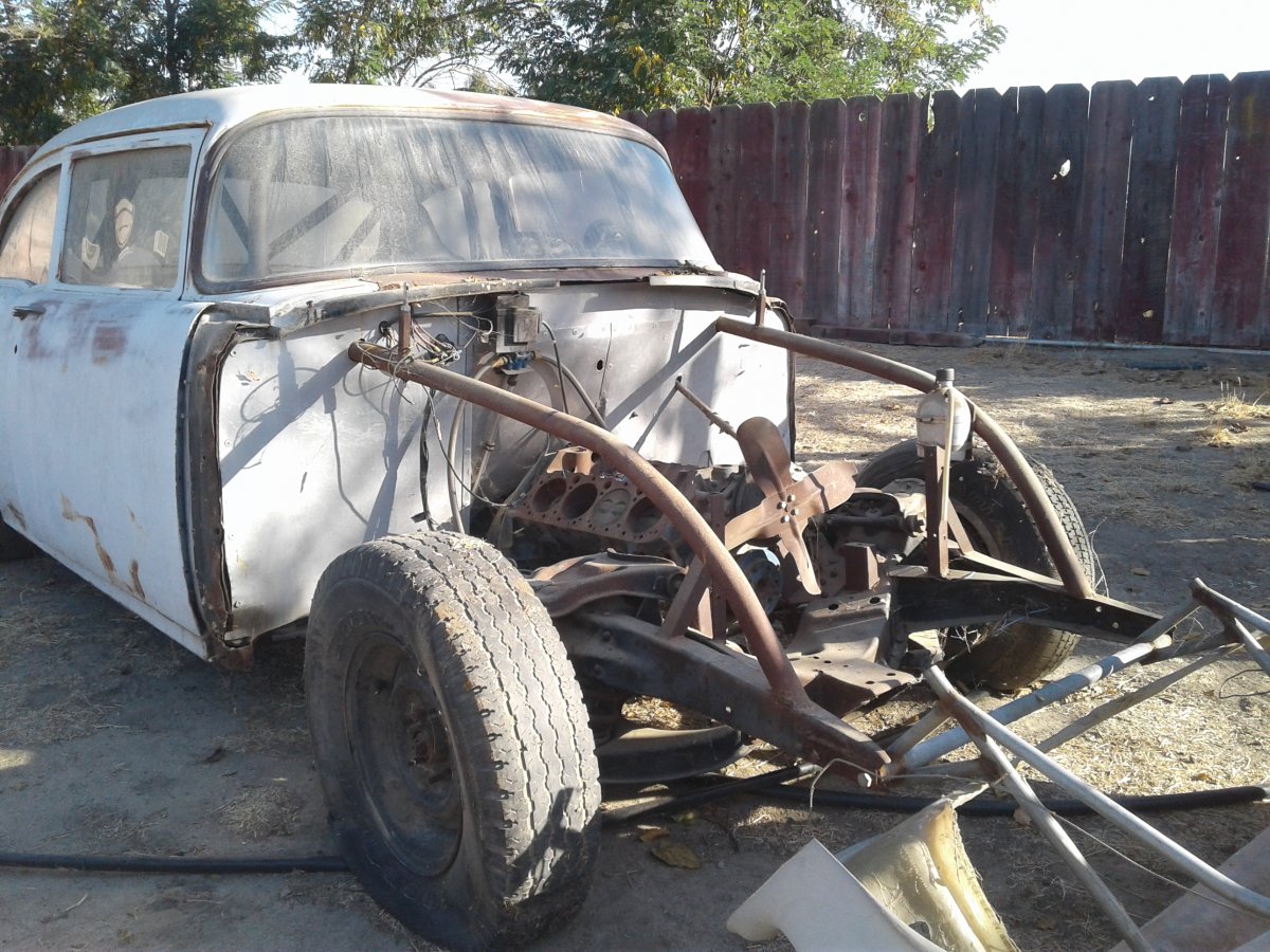

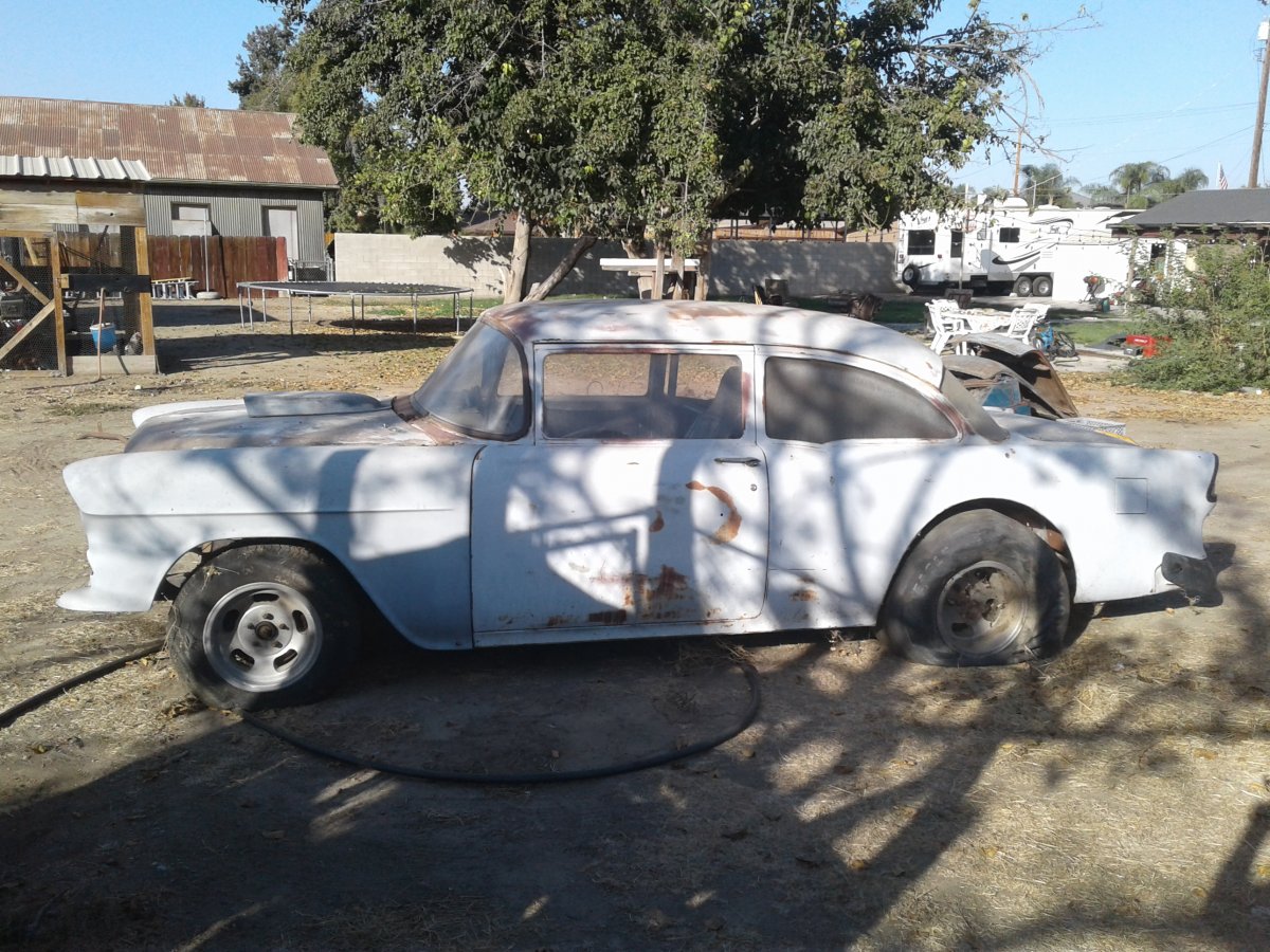

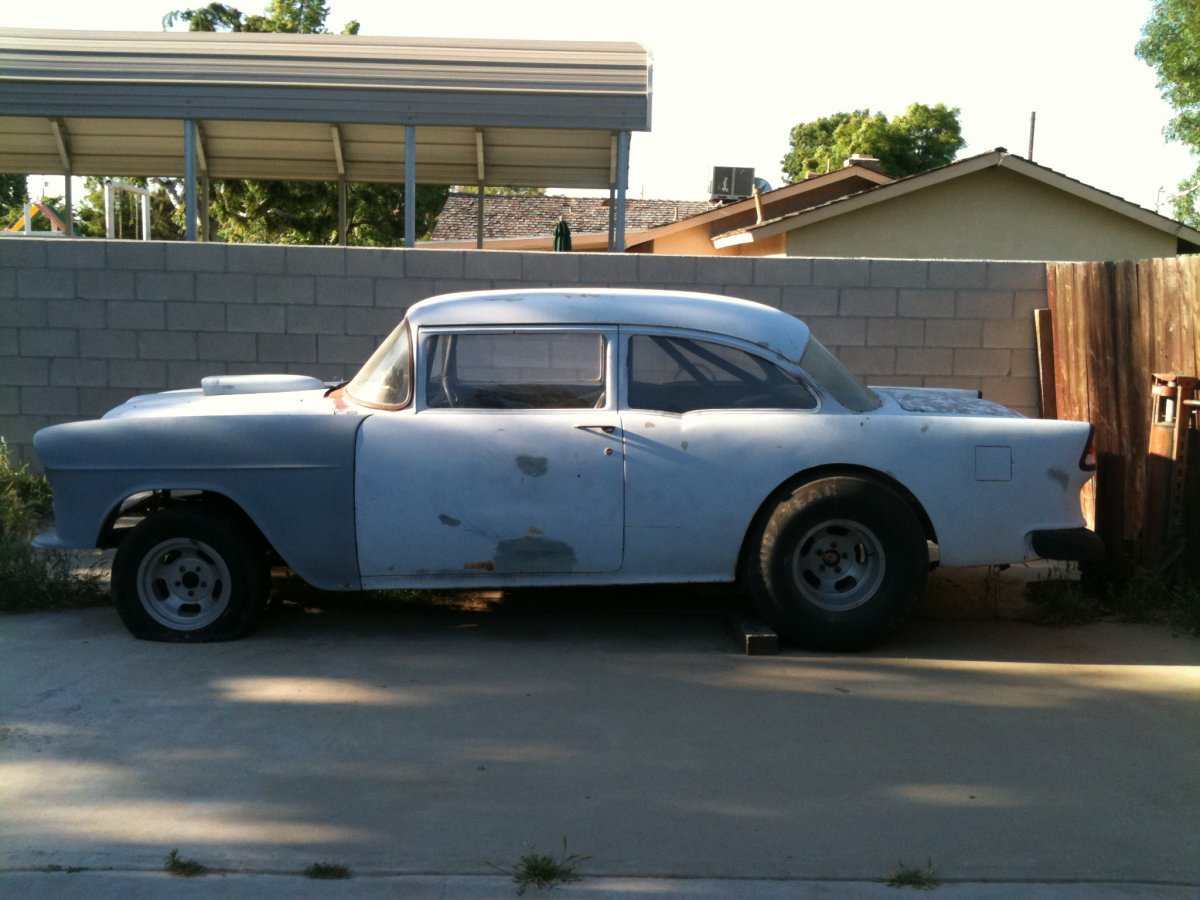

    Here is a few pictures of the 55' before I got it where it had been sitting for about 30 years. As you might imagine it took a lot of work to get it out of the old building. I think just trying to air up the tires took a few hours!!!
    If I remember right the Mopar A833 4spd was buried somewhere underneath the car! Now that was fun to try and move out of the way!!

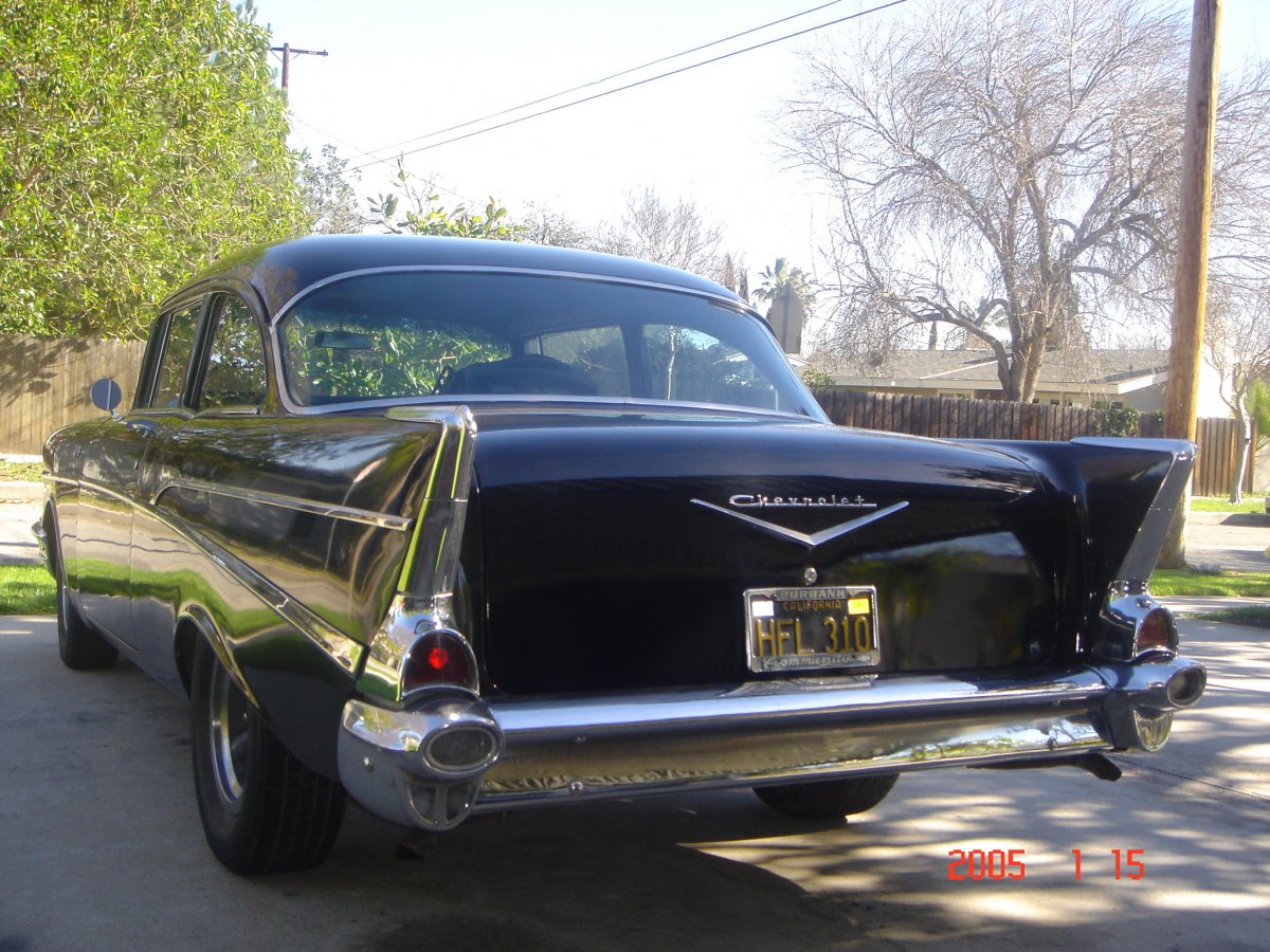

    Todd553, So there isn't too much on this car. I think it would fall under never quite got there but this is what I know. The car is an original 55' 6 cylinder stick Business Coupe from the San Fernando Valley. It was converted to a small block and raced at some point by Larry Ofria from of Valley Head Service in the San Fernado Valley. More than likely the car ran at Los Angeles County Race Way. (Larry currently or at least last I checked runs an A Gas white 57 Bel Air Hardtop in nostalgic racing) And last I heard he was unaware that his friend sold it because that was part of the deal so I hope he is not on here somewhere ;) Anyways, sometime in the 80's it was purchased by my buddy who wanted to upgrade from his 12 sec 57' 150 B Coupe and recreate the Tabasco 55'. This is when most of the Gasser modifications were made. By todays standards a lot of the modifications seem out of date but keep in mind this was done before the "traditional/period correct thing" had taken off and these were real drivers who's ultimate goal was to race and not just show.
    Fast forward to the 90's when I was a teenager I had offered to buy the car but was turned down. I then tried to buy this Gasser from a mutual friend which.....
    is a big block car that ran 9's back in the 70's here on the west coast. The original idea was to finish both cars as Tobacco and Chili Salsa as match race. Fast forward to 2010 I once again offered to buy either car as they were both sitting. I was initially more interested in the Gasser shown above because it has a title and was more street able but once again my buddy said no. I even offered to pay him what he paid for it...$1200 and that was a no go. I again asked my other friend if he would sale and as it was with LA County Raceway having just closed and nowhere to run he agreed. The bummer was that this car was not titled and had lost it's vin plate during it's "Gasserization." My goal was always to make it a race car but I still wanted to at least license and insure it which did not happen until today. With other projects and a few set backs with the engine the car had once again been put on the back burner for about 7 1/2 years.
    Thank you for the interest. I'll post more as I go.

    I'm not sure if the fiberglass front end will stay. It was pieced together from different front end parts. Whether I go steel or keep the fiberglass it will be a one piece flip front end. It just makes everything
    easier to get to.
    20171027_160016.jpg I'm not crazy about the fire wall. It is a bit crude but then again it is a race car right???? :)

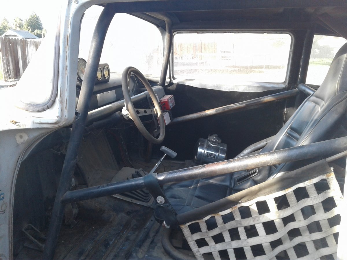

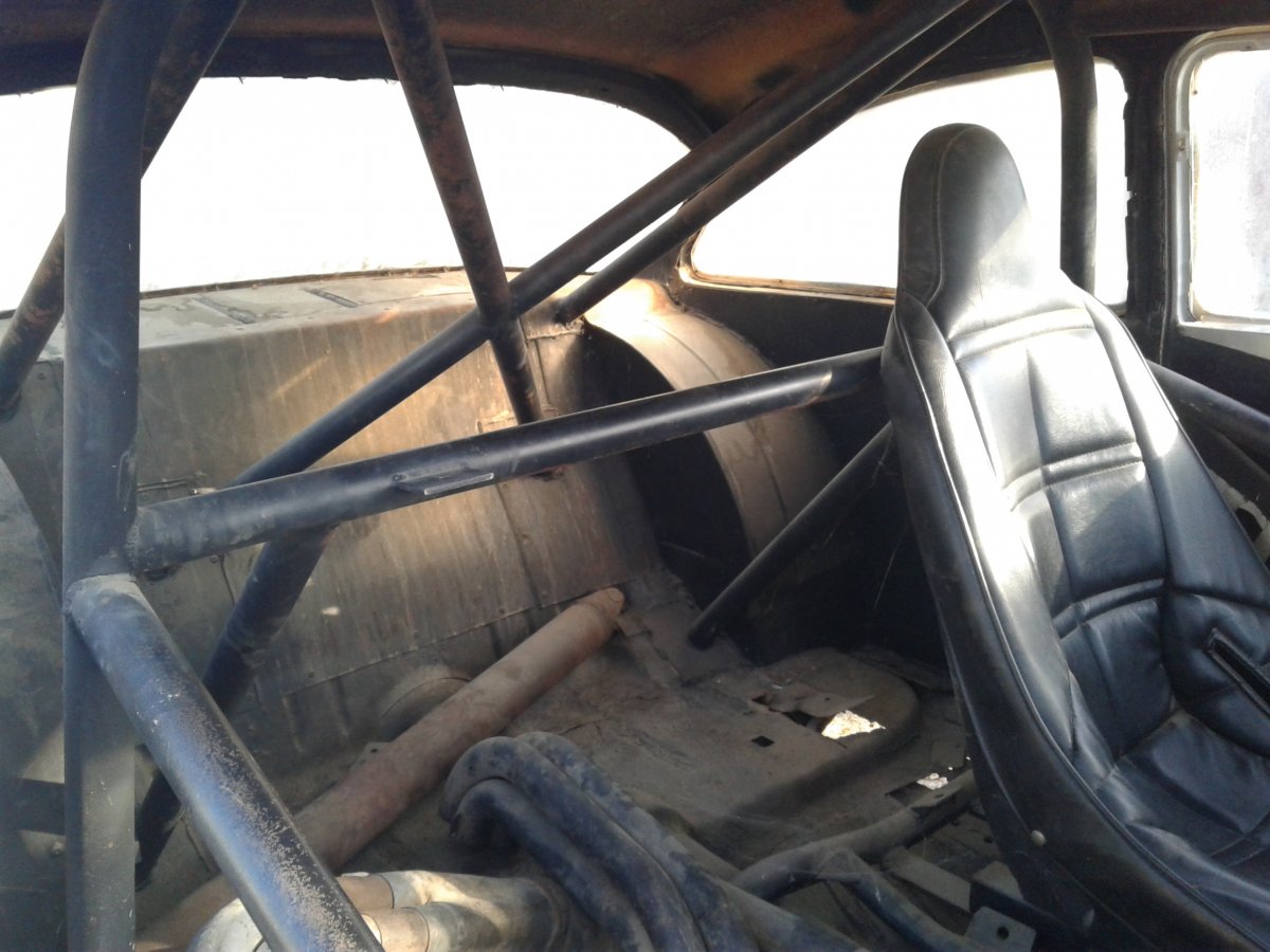

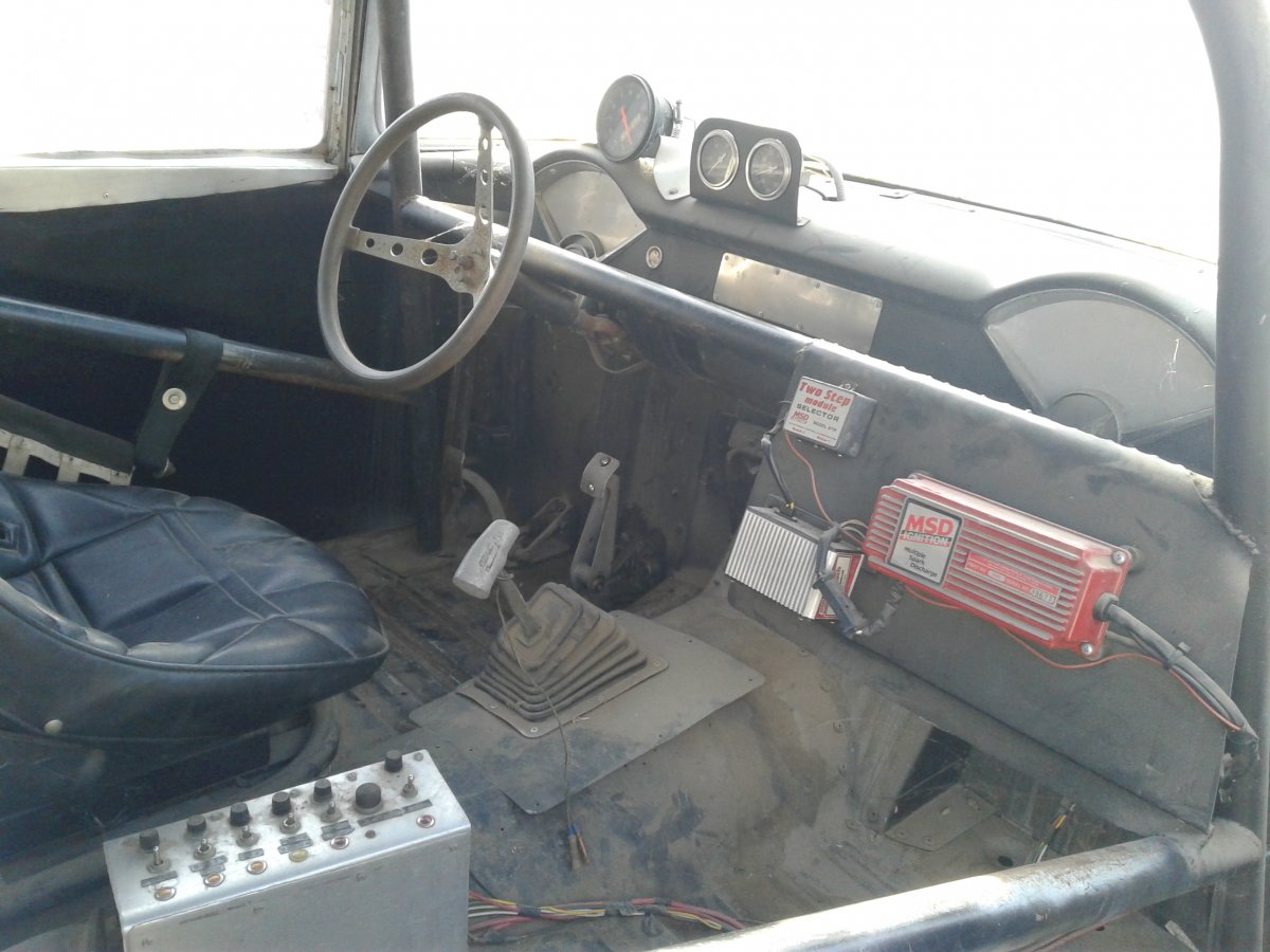

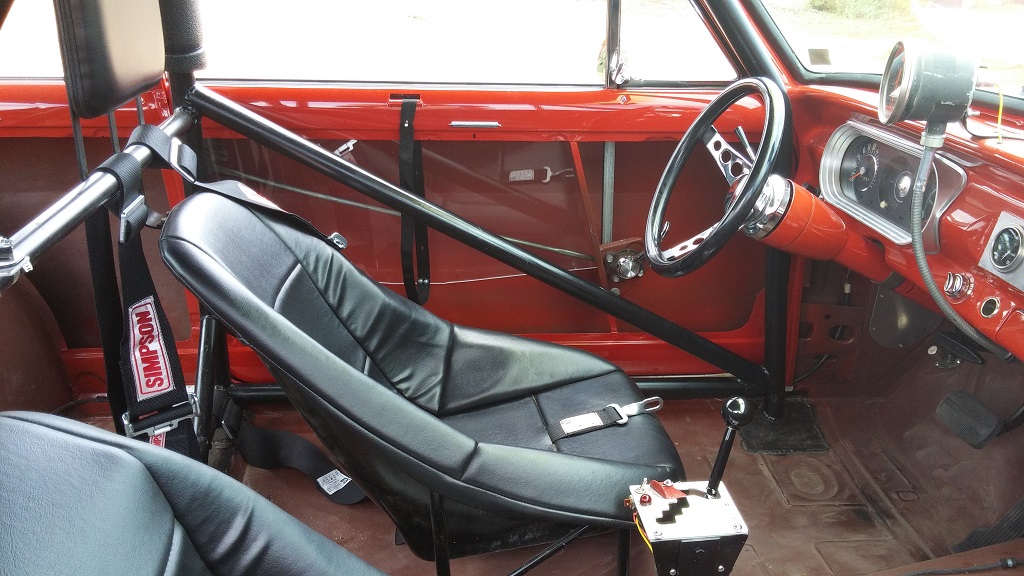

    Here is a few pics of the inside. I'm probably going to change a few things around. With the firewall set back and me being 6ft leg room is an issues. I mean, I know it is a gasser but I'm not sure I want the gas pedal over on the passenger side..... although I have considered it. :)
    I plan to make the side bars removable. Getting is not to bad, but getting out is another story.
    I'm not crazy about the steering having been relocated. I believe the reason was to make more room for the driver due to the outer part of the cage. Plus I think there is 3 u joints in the steering shaft and it just seems "weak" to me. While I still have the stock front suspension I'll probably convert it back to a stock steering shaft. However; then the steering wheel will be off center from the driver due to the seat location which is again part of the cage. You change one thing and there is a ripple effect!!!
    The MSD and timing control will go or at least be relocated.
    A little more roll cage than I would do but I think at this point the car was being built for a blown Big Block. Plus my friend was doing stock car racing then and I think he got carried away. :) I would love to move the entire driver's section back a few inches to make more room for the driver who is me :) but that would entail a lot of extra fabrication if not a new cage. Then again, what is the point if I don't fit in the car! We will see. 20171027_160234.jpg

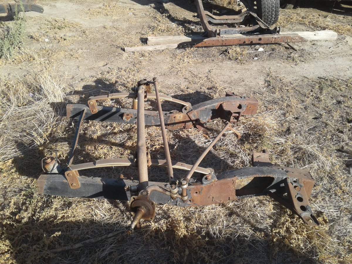

    The 55 came with this front end that came off a 60's 57 Nomad Gasser that sadly became a pro street car. This thing is pretty scary looking. I've pretty much just kept it around as a pattern if I ever decided to go straight axle. Currently that is not the plan.
    Butch M, fast30coupe and AHotRod like this.
  25. squirrel
    Joined: Sep 23, 2004
    Posts: 56,087
    squirrel
    It looks like the door bars are kind of high, at the forward end. Might see about just moving them, but be sure to follow the rules if you plan to run it at a sanctioned drag strip.
    Hopefully you can figure out how to fix everything, without having to totally rebuild the car
  26. 31hotrodguy
    Joined: Oct 29, 2013
    Posts: 2,698
    31hotrodguy
    In was thinking they were welded pretty high but then again I have never had a car that went fast enough to require them. The plan is be able to past tech so I'll have to find out if I can modify the cage and have it still pass inspection. If not I'll have to change a lot which means even more down time. This is all new territory for me.

    my door bar. Not a problem to get in and out, I've put a lot of miles on it. The NHRA rule specifies where your elbow is relative to the bar.
