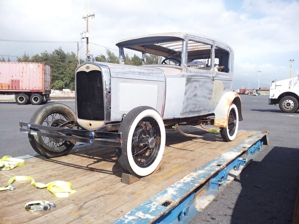

    Christmas in April...
    Picked up the Tudor @ the harbor Saturday!
    Ocean Crossing went well, U-Haul Tow Dolly worked great!
    Aloha

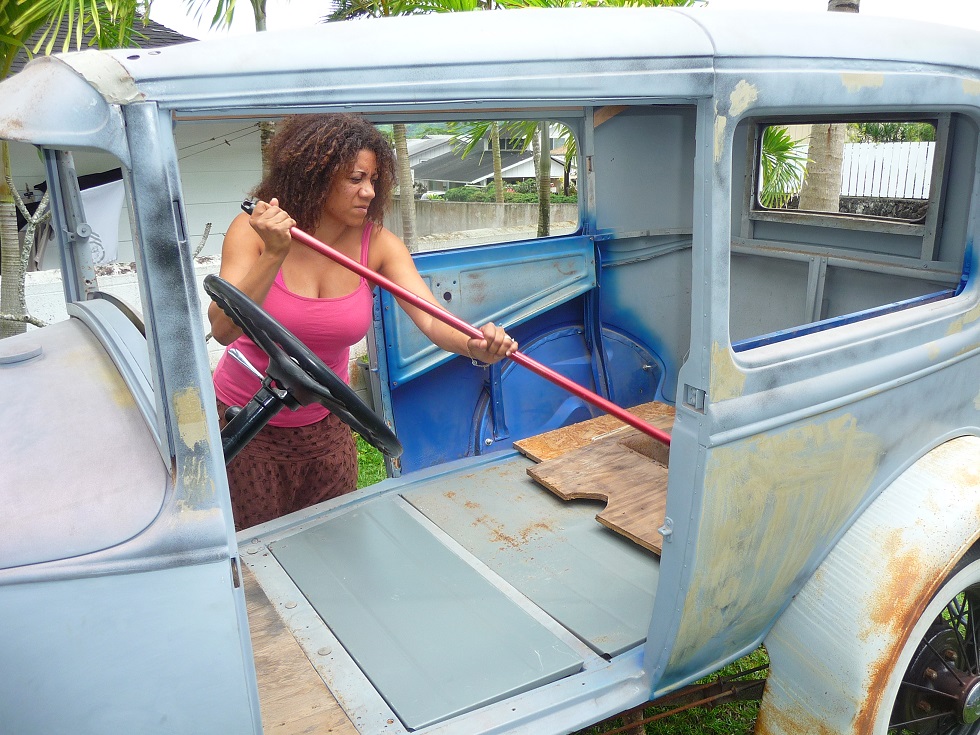

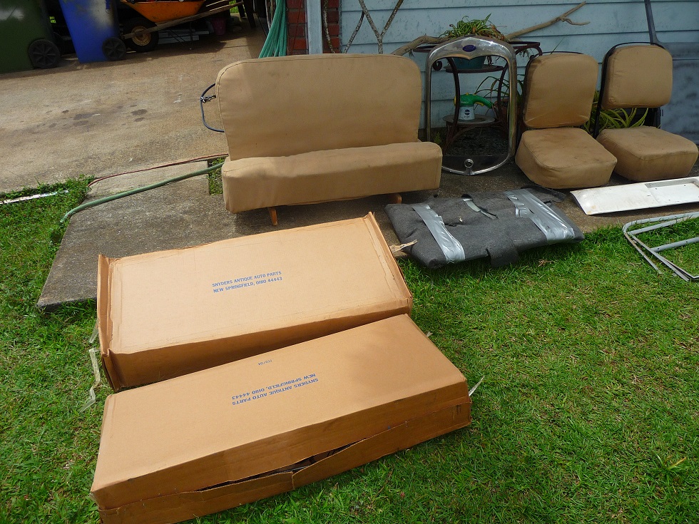

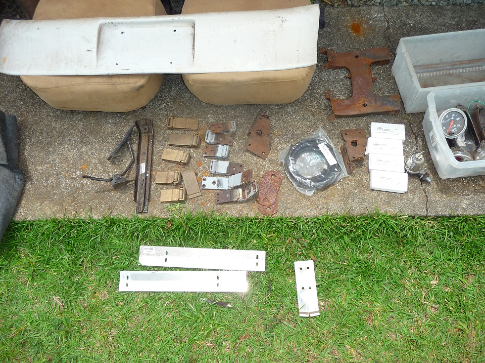

    Got a bunch of parts.
    New Steel floor pans,
    Steel Fire wall,
    Trim, felts, seals,
    Original glass (templates)
    New Rear seat frame,
    New Brass door hinges,
    Two grill shells (one for the Phaeton!)
    Dash, Coil
    etc,etc...Lotsa Stuff!
    Engine in very good condition!
    Merry X-mas to me!

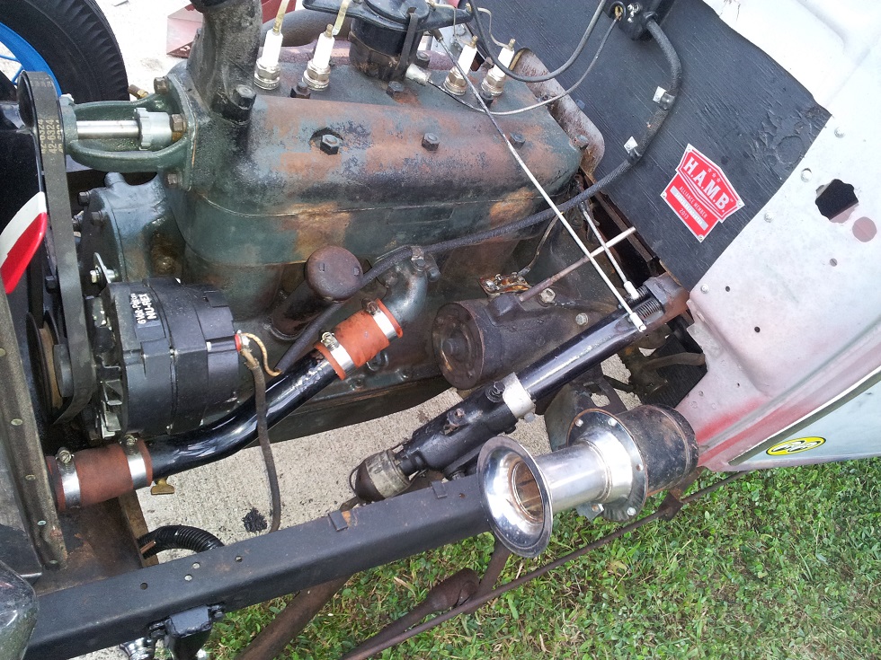

    Been trying to shim up the body.
    The radiator was much higher than the body...
    I took the fat rubber washers out under the radiator.
    And used a thin one from the shim kit.
    The body still sits high for the hood to line up!
    ...But it lines up! good enough for now!
    When i tried to adjust the radiator supports my radiator started leaking...
    I was to brutal with the wrench...No biggie it's fixed!
    ('Ol man showed me how to fix a radiator when i was around 18...came in handy finally!)

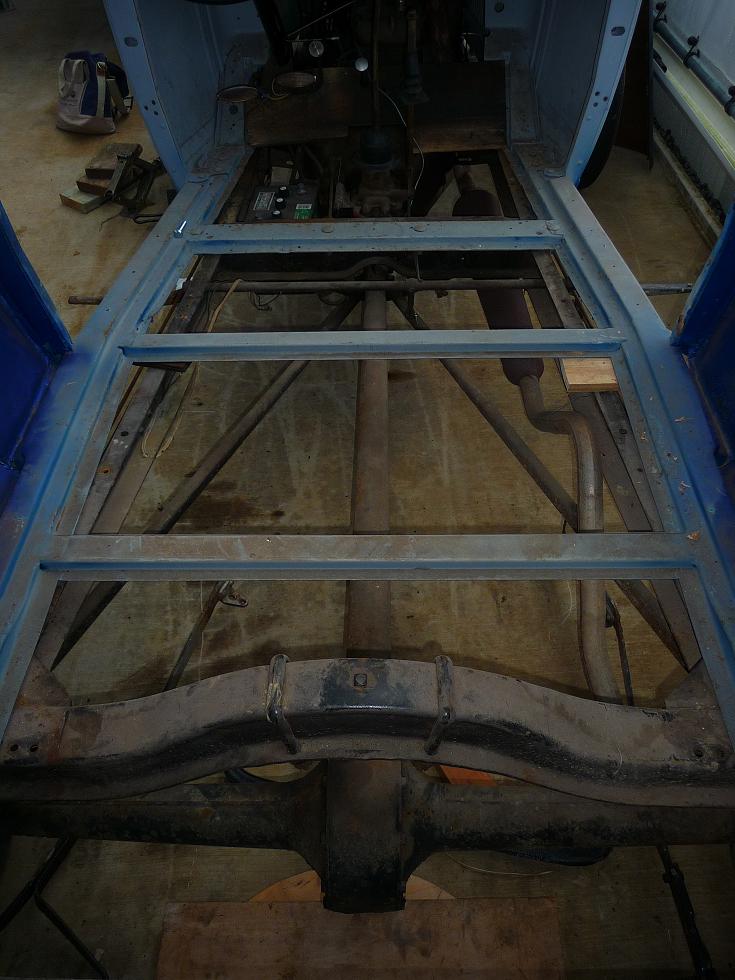

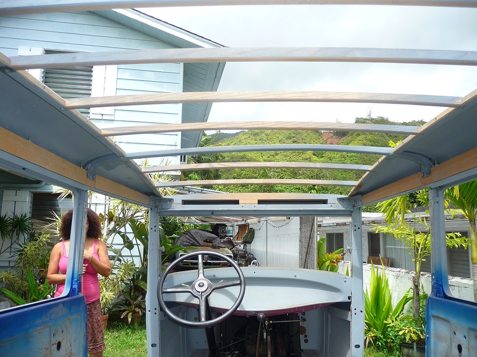

    Got the Chassis Wood kit.
    It comes with one big block under the first sub floor "cross member".
    2 blocks under the front cowl.
    2 smalle blocks at the rear frame rails.
    And 2 blocks for the middle sub floor "cross member"...
    BUT, there's three cross members total....
    So i made a set for the rear one.
    7 pieces total. Shouldn't it be 9 pieces?

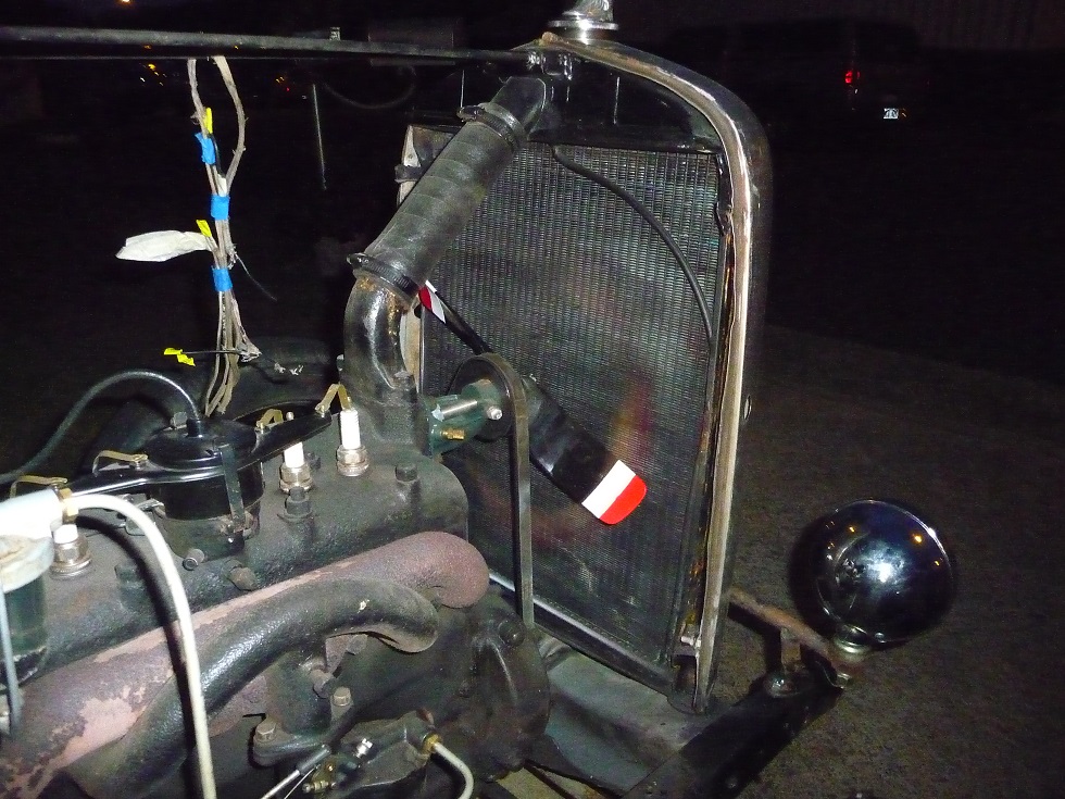

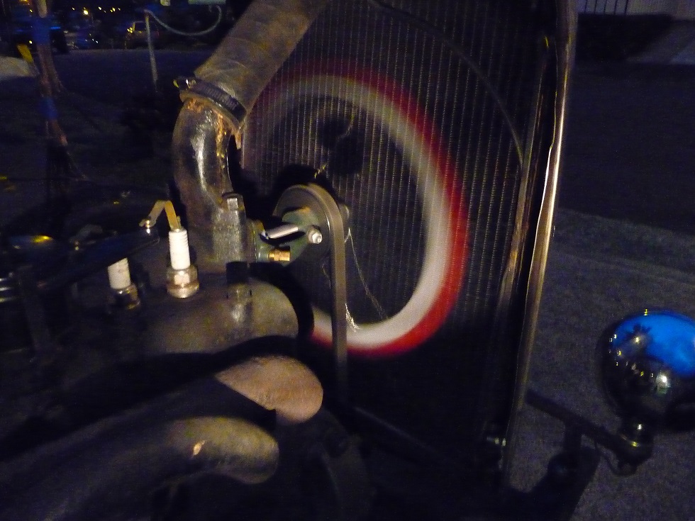

    Hooked up ALL the electrical..(One head light seal beam fried right away & the brake switch is toast)
    Put the windshield in tomorrow and cruise down to the local Car show.
    Painted the fan blades...It looks cool but I also know now why the painted the props on planes...black radiator / black fan...

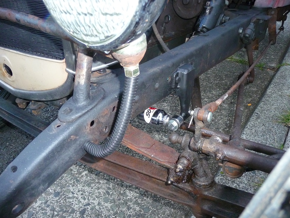

    Scored a SoCal Steering damper And a Corvair Steering box at the swap meet last Saturday.
    Widdled a small bracket for it.
    The car had a "death wobble" when we drove it on Maui...
    ...I replaced bolts, adjusted the steering box and the steering joints.
    Haven't had any problems since but I figured it wont hurt when you hit the top speed of 50+ mph.

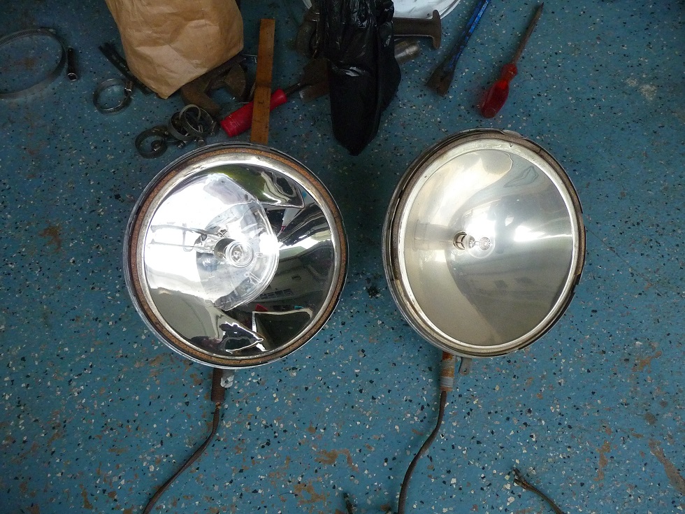

    Got my Essex Terraplane V-shaped headlights...cleaned up really nice!
    ...Nice weather, cruised up the North Shore...
    Too lazy to cook on the way home...got some Huli Huli!

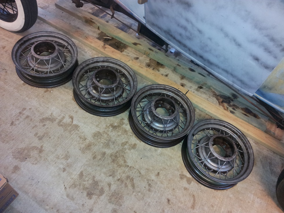

    New wheels / tires...
    1. made sure the wheels where straight
    2. paint stripper
    3. sand blast
    4. etching primer
    6. 64 Ford Blue
    Handles like a sports car...almost...
    Much better than the old dry 19's.
    New Shifter knob! Mahalo Lane!
