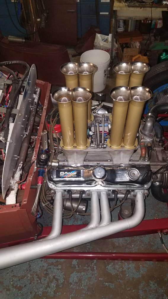

  4. 340HilbornDuster
    Joined: Nov 14, 2011
    Posts: 2,017
    340HilbornDuster

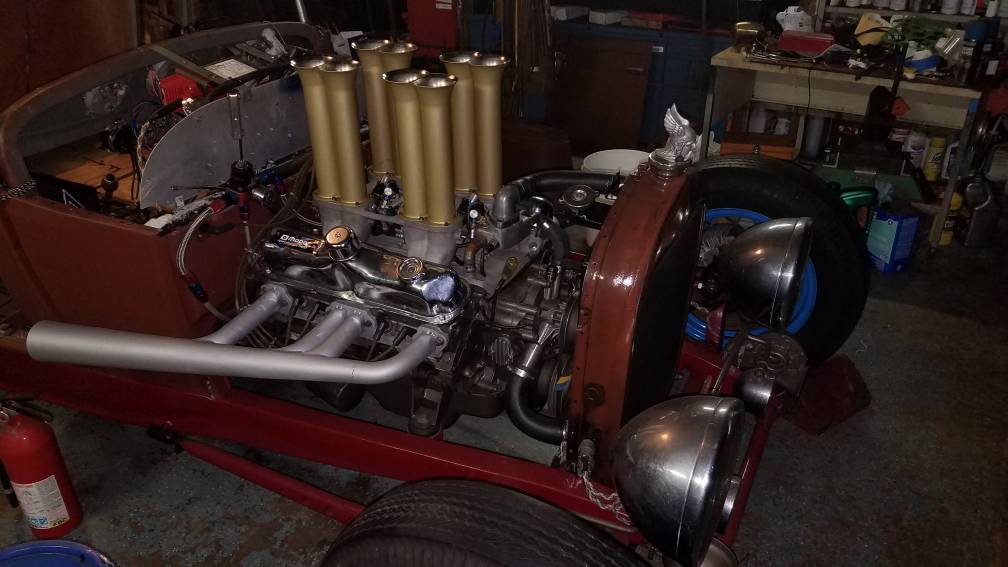

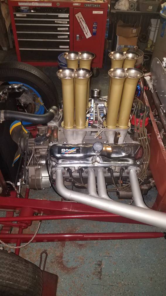

    Some Bling paint (to protect the metal) till i can afford / find a good chrome shop to have them re-chromed.
    CPU's landed today...fix up Ol' Smokey again...
    Bought Diodes @ Manfreds (Ind.Elec.) today! 20190114_190741.jpeg 20190114_190715.jpeg 20190114_190528.jpeg

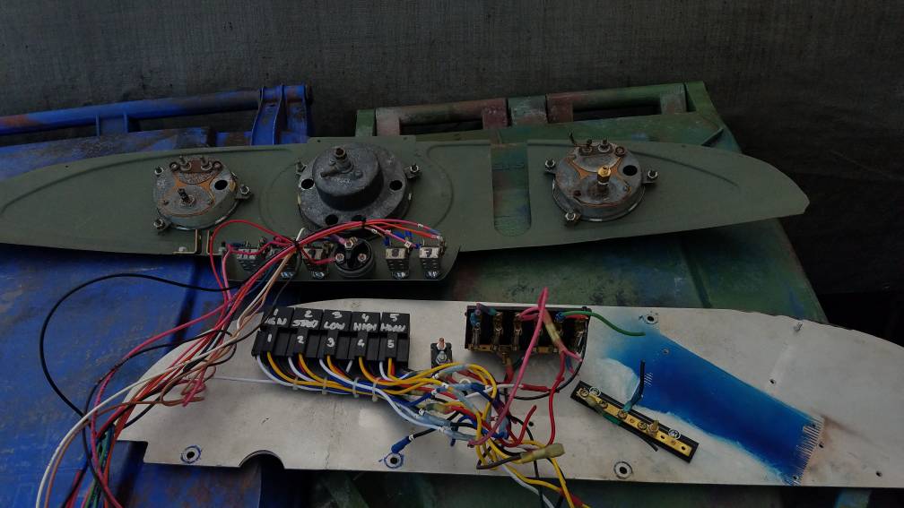

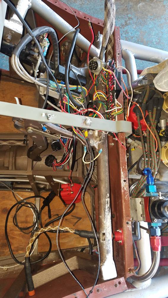

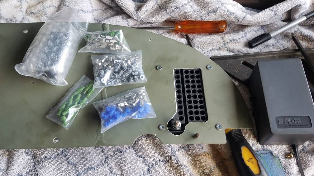

    WIRING:
    With the wiring gremlins I've had...
    I decided to take the Back Board and Dash out...
    Redo / clean up all the FU'd wiring, from redoing the relays 3x.
    Get rid of those Chinese Relays.
    New fuse block! glass fuses would probably have fallen out at first pot hole.
    Upgrade with some "electric check valves".
    Looking for a military quick connector with enough pins for the dash...
    Everything's so crammed in there it would help when trouble shooting in the future!
    Move Spark away from sensitive equipment.
    etc. etc. etc.
  8. 340HilbornDuster
    Posts: 2,017
    340HilbornDuster
    OT?......lesson learned....
    this is what happens when you rush it
    this thing was living in there...
    Didn't need to remove the body harness connector..but it works!

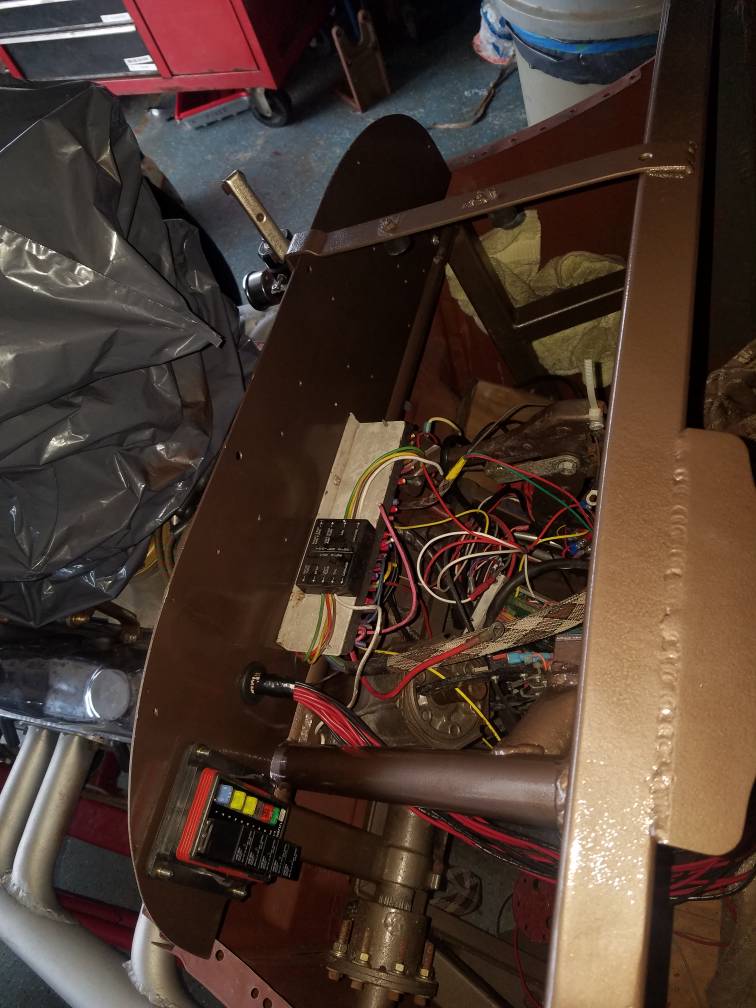

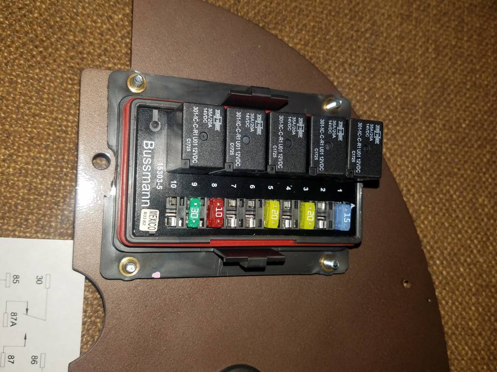

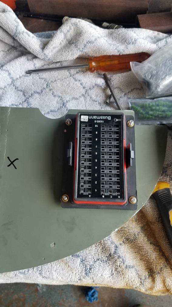

    New fuse / relay box.
    5 relays 10 fuses
    Hide some wires behind the board.
    Sent from my SM-G930T using The H.A.M.B. mobile app

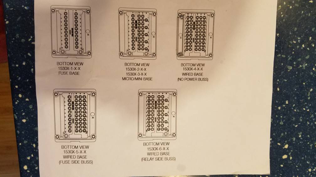

    Where did you get the fuse box ?
  11. 340HilbornDuster
    Posts: 2,017
    340HilbornDuster
    E-bay...
    Search for
    Bussmann RTMR 15303-5 waterproof fuse panel.
    There's a bunch of different versions....relays....research...!

  12. 340HilbornDuster
    Posts: 2,017
    340HilbornDuster
    different versions
    Up to 30 amp relays you can fit 5
  13. 1-SHOT
    Joined: Sep 23, 2014
    Posts: 2,873
    1-SHOT
    from Denton
    Thanks, Frank
  14. 340HilbornDuster
    Posts: 2,017
    340HilbornDuster
    It's a little pricey paid 90 bucks for mine with all the connectors and 5 30A relays.
    But is really compact and good quality

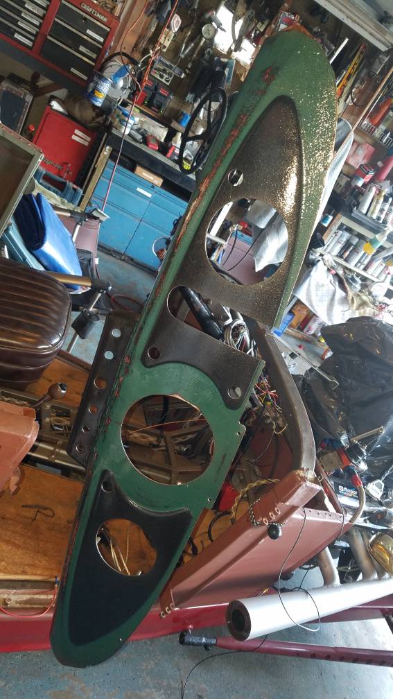

    Dash - Refresh paint.
    + Holes for indicator lights.

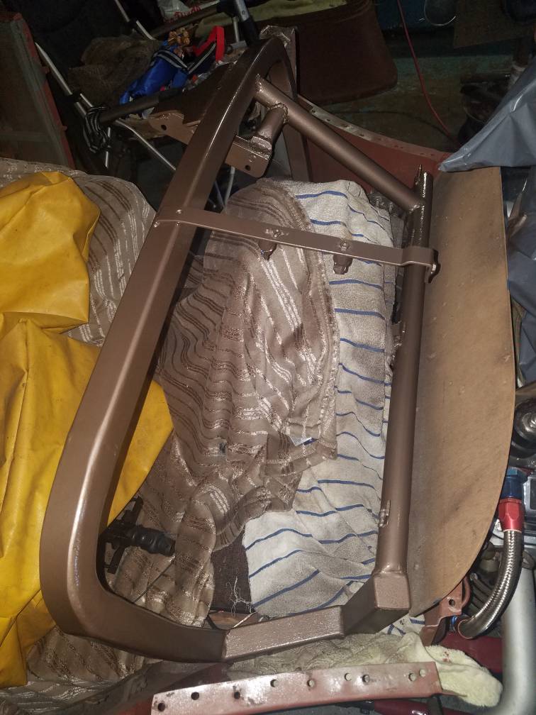

    Painted Dash / Cowl support & steering column...couldn't reach before...
    Soldered a piece of copper tubing to the horn wire...made a bushing from a screw driver handle.
    "Quick Remove Steering Wheel Horn Connector." 20190303_145154.jpeg 20190303_143858.jpeg 20190303_143933.jpeg

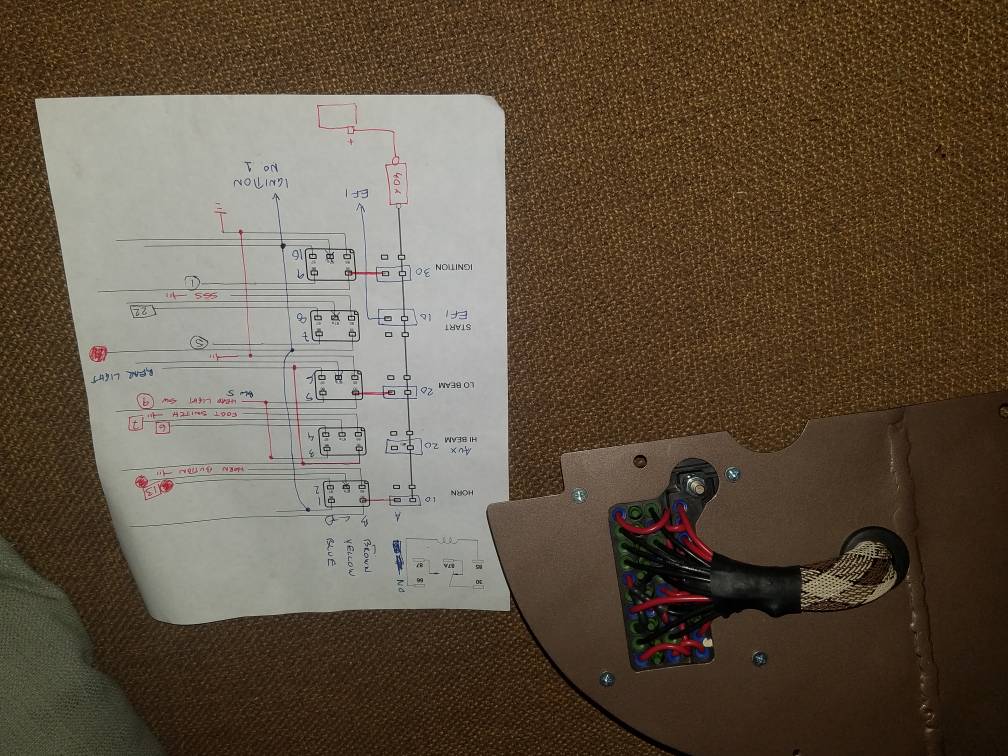

  23. 340HilbornDuster
    Posts: 2,017
    340HilbornDuster
    New fix required...
    Put the terminal strip on...
    Screws Facing DOWN!? Wasn't a problem when I attached the harness on the table
    Some moron used the bracket that was on it...PITA to terminate...upside down...!

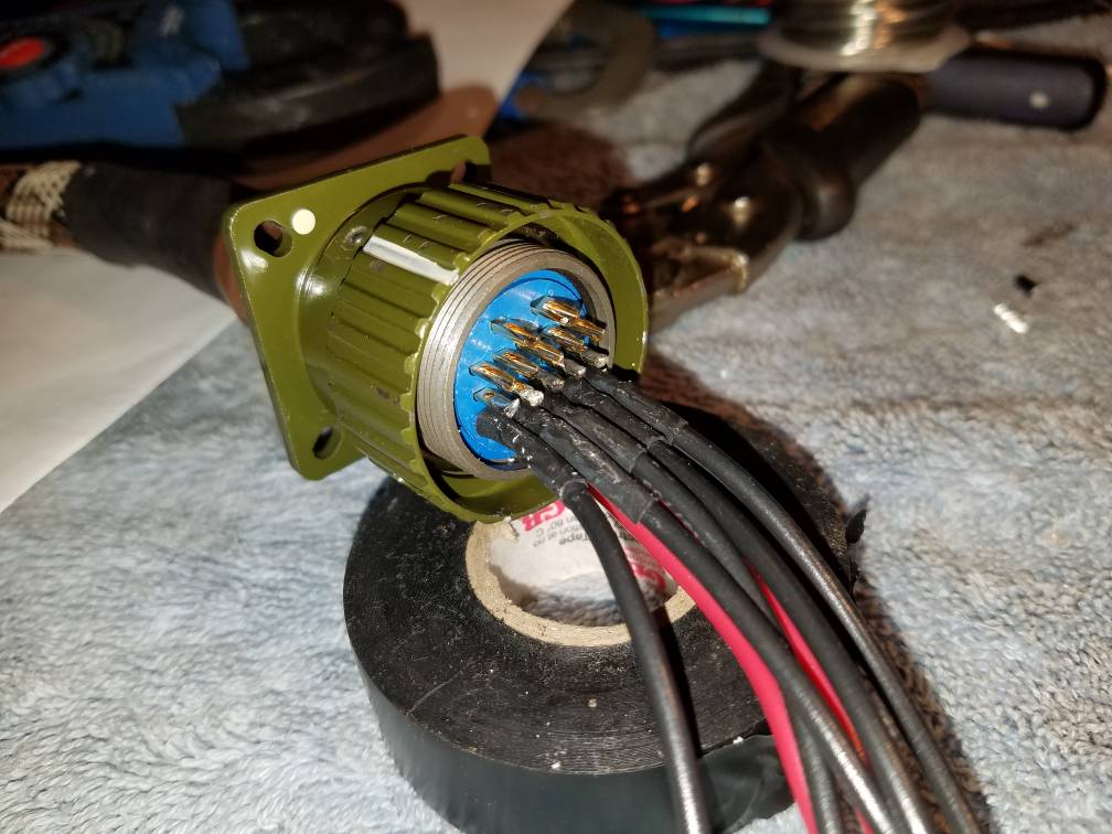

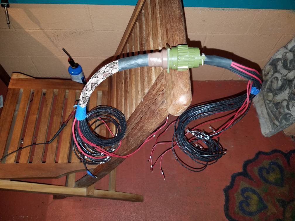

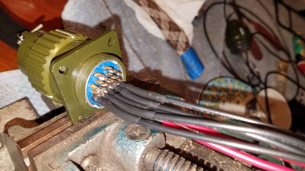

    Dash board quick connector...
    Testing the pins.
    Had to redo first connector 9-10 had some solder between 'em...argh! 20190313_185703.jpeg 20190313_201008.jpeg 20190313_203712.jpeg 20190314_180321.jpeg

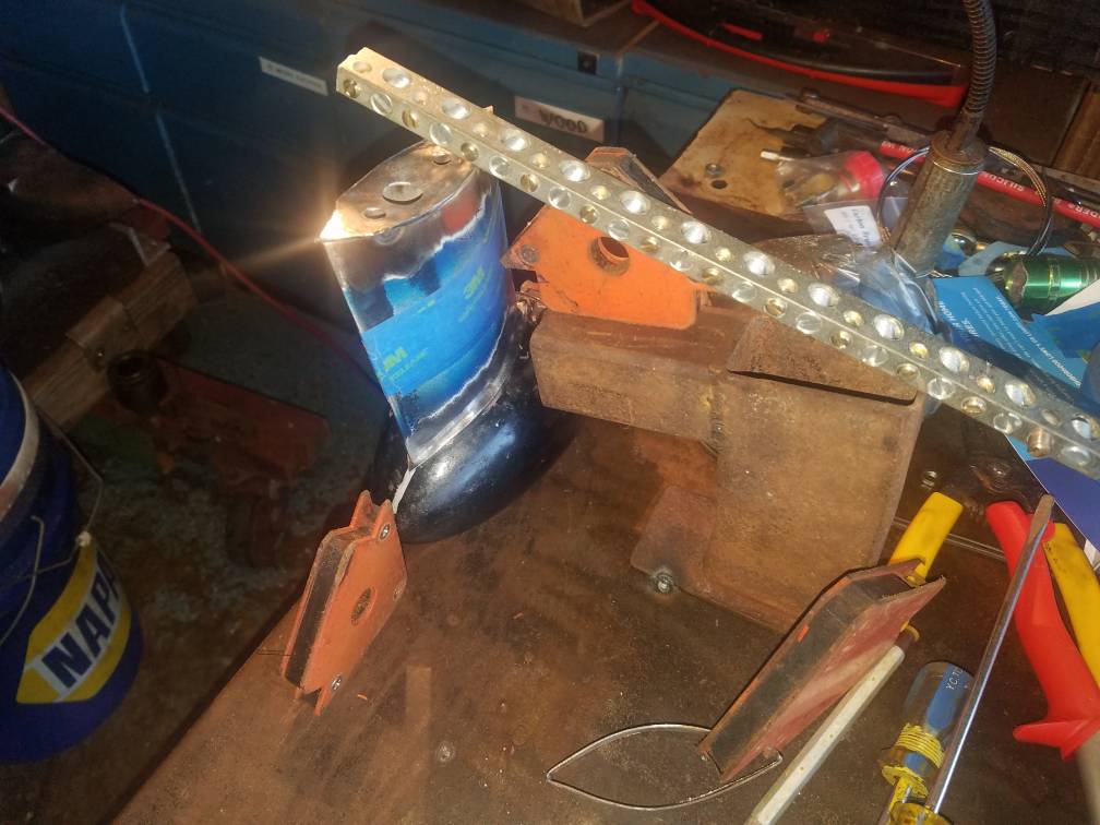

  26. 340HilbornDuster
    Posts: 2,017
    340HilbornDuster

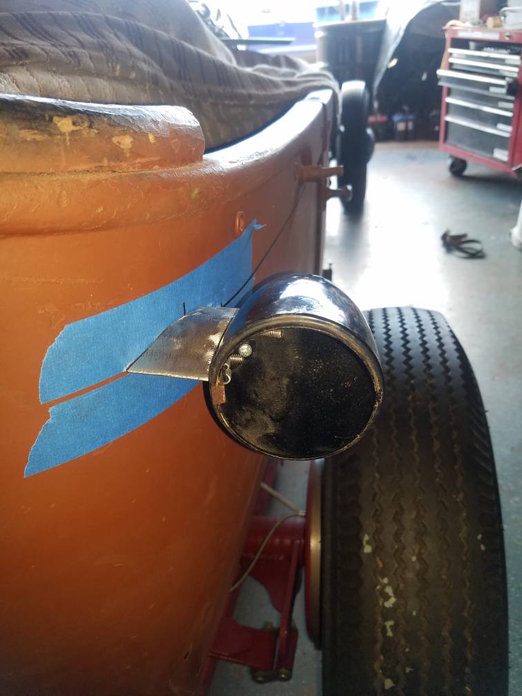

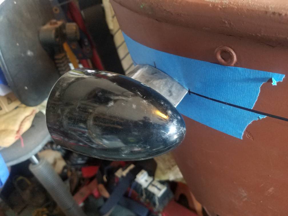

    Spent a day making these tiny little brackets... Now some paint so they don't rust...
    Kinda F1 inspired...lower radius is longer...creates down force at high speeds...................................................................................(I'm just kiddin!) 20190413_181704.jpeg 20190414_120727.jpeg 20190414_135634_002.jpeg 20190414_143733.jpeg 20190414_152315.jpeg 20190414_152331.jpeg 20190414_164151.jpeg

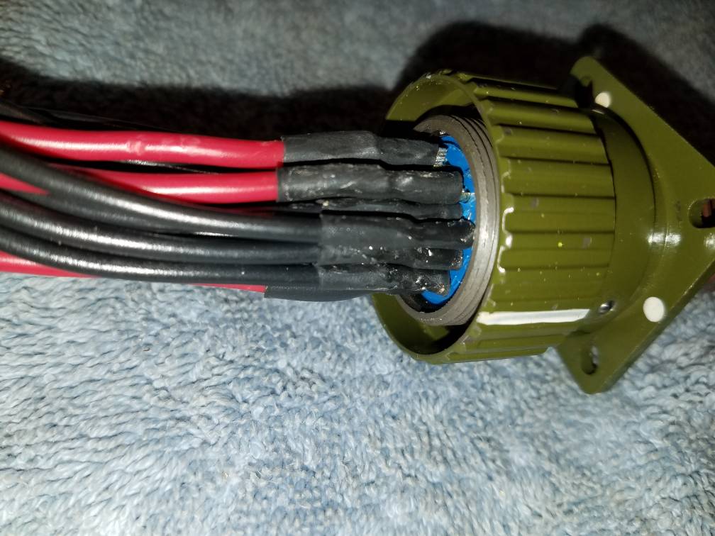

    Finished the other Dash connector last night..... Real PITA! 20190417_213054.jpeg

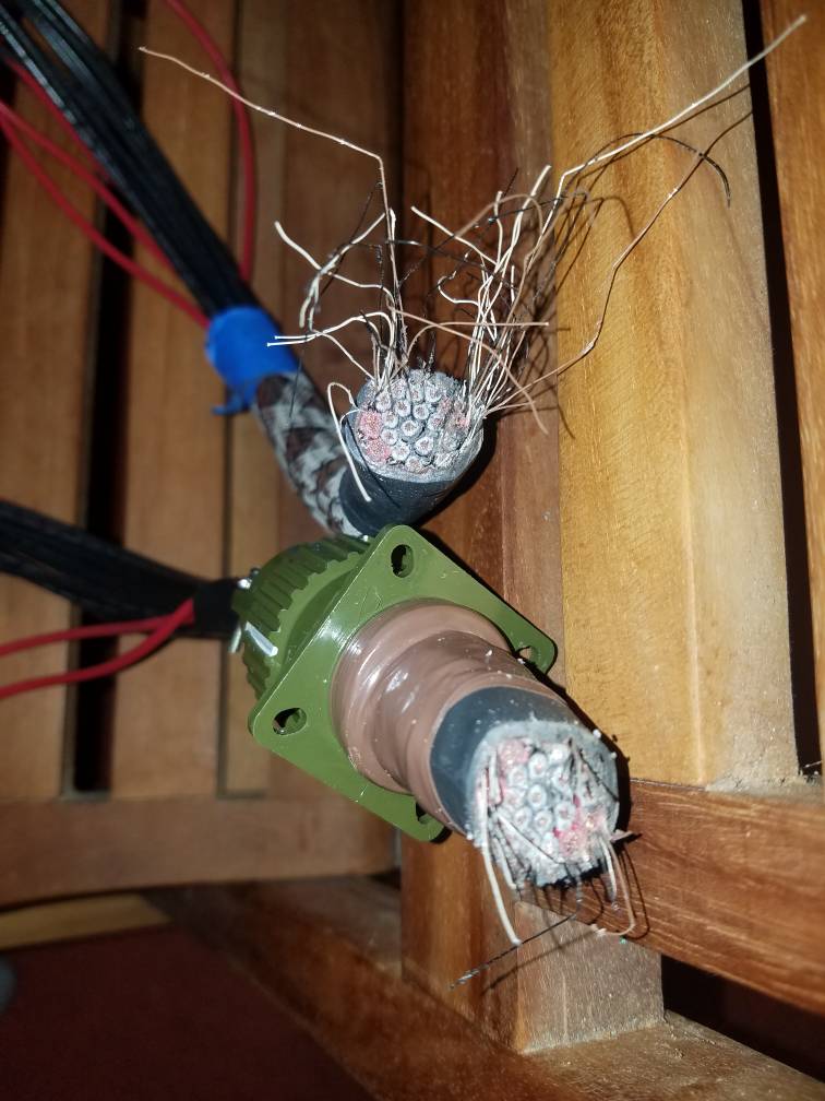

  30. 340HilbornDuster
    Posts: 2,017
    340HilbornDuster
    That IS Plug to Plug...(only One!)
    I ŦƱƈĶȜƉ ÜƤ the first female connector trying to de-solder and re-doing it...
    (I probably don't have the right Soldering Iron for this job...
    Had to hit it with a Propane torch to melt the solder...)
    PITA!..But it's done!...Onwards and Forwards!
