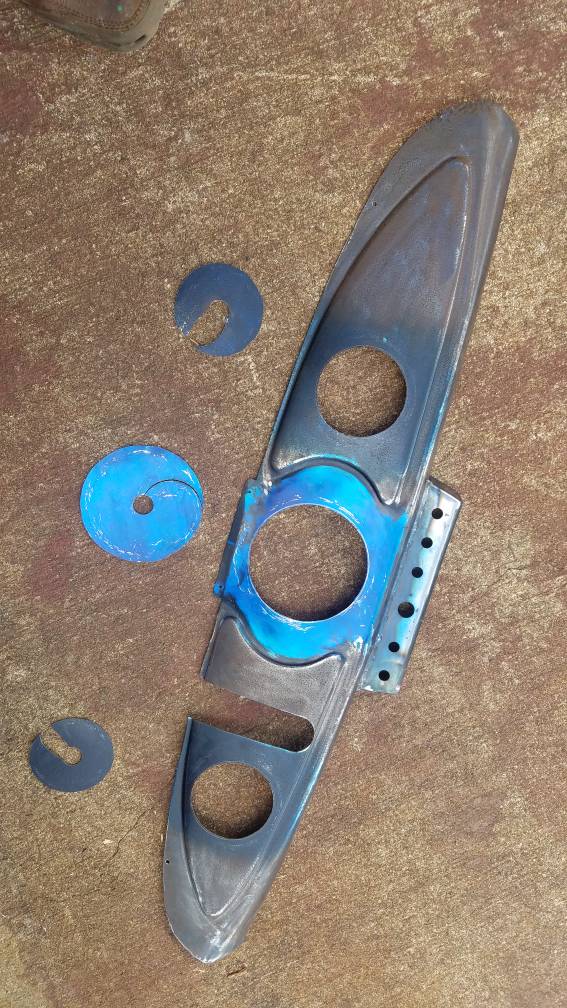

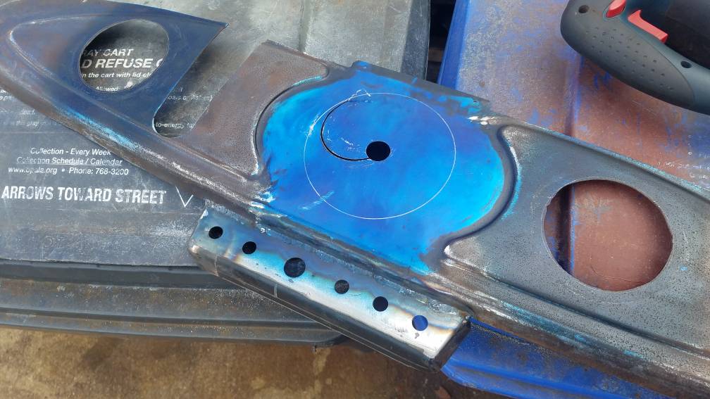

    Welded on the switch pod...

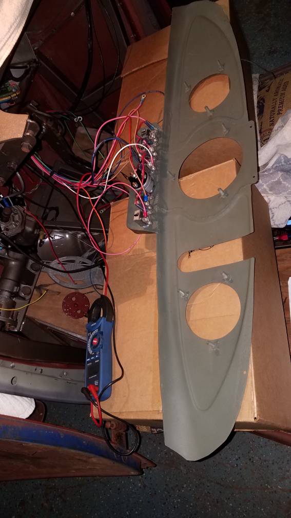

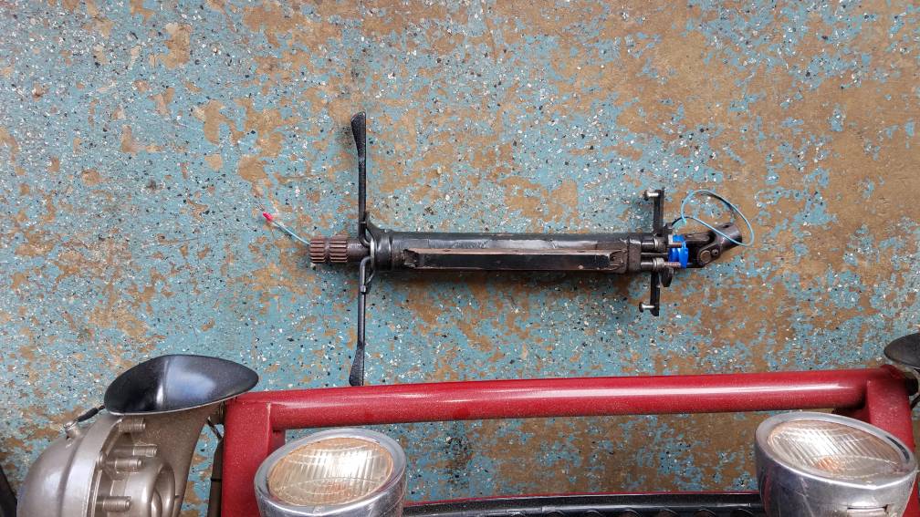

    Cut holes / welded bolts for gauges... 20180907_161434.jpeg 20180907_161811.jpeg 20180907_204434.jpeg 20180908_102426.jpeg

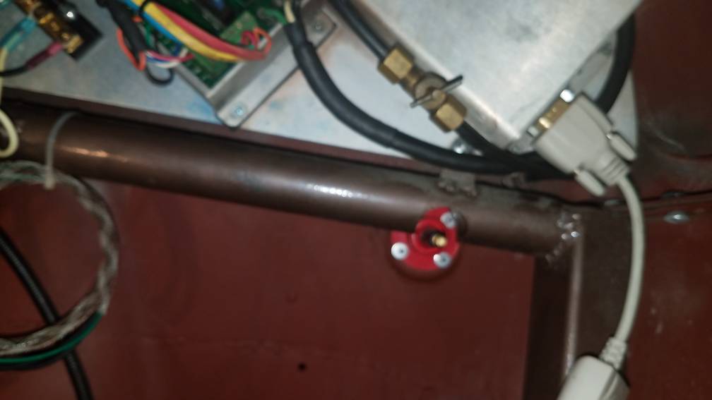

    340HilbornDuster

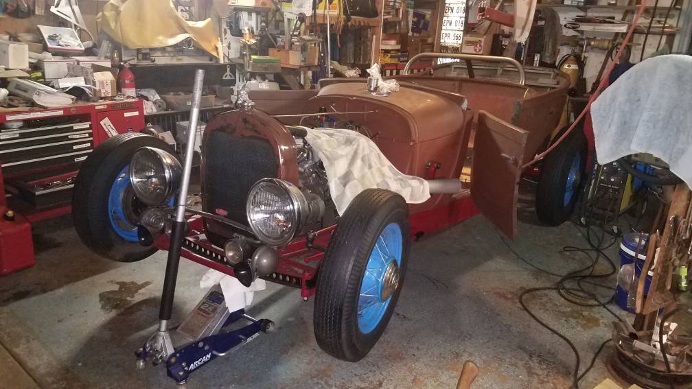

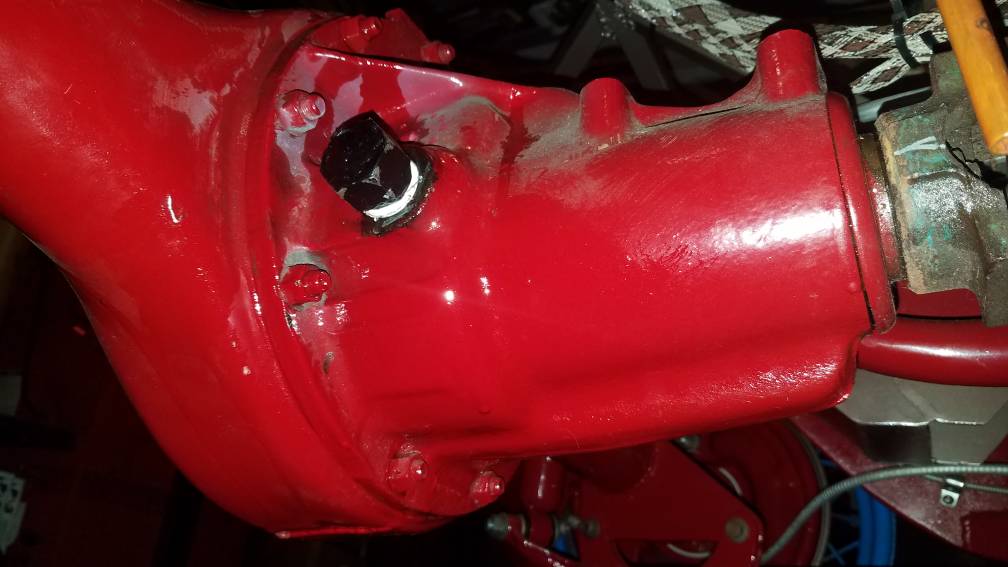

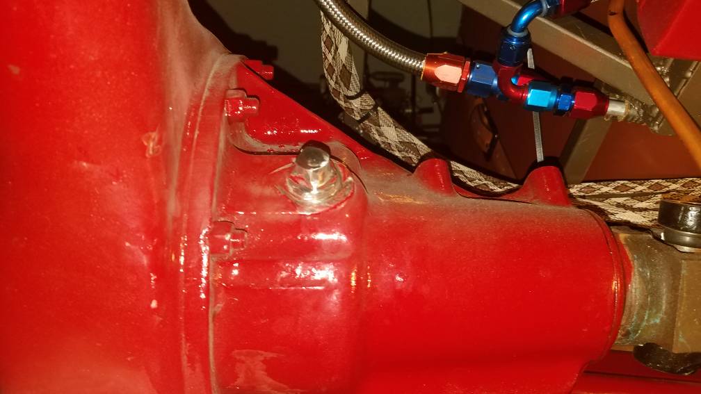

    No noise..yet!

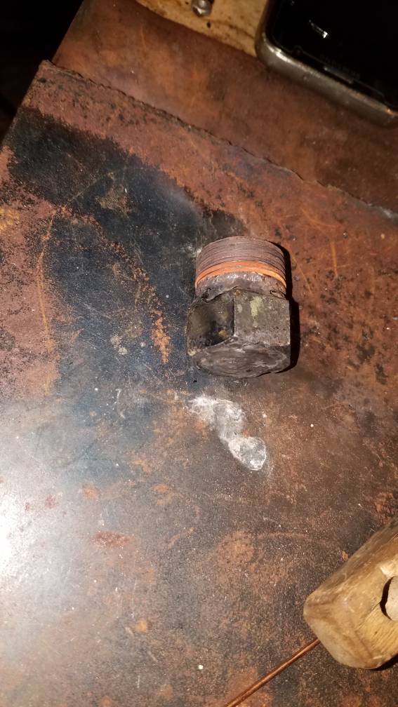

    Rear axle plug stuck / rounded.
    Welded a nut to it...
    Cause o stance...had lift up the front to get 2 quarts in there 20180912_181055.jpeg 20180912_203437.jpeg 20180912_213325.jpeg 20180912_213810.jpeg

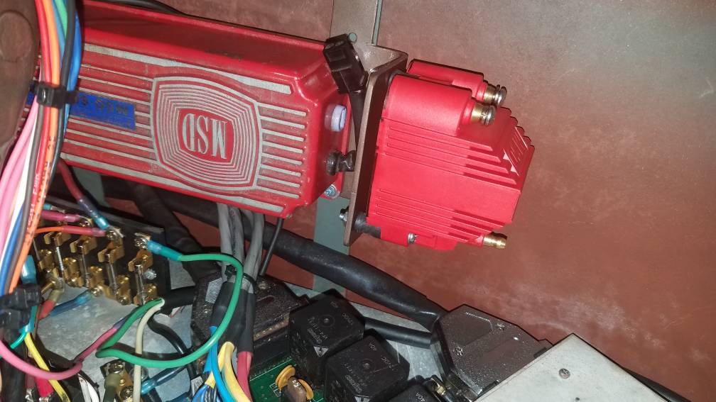

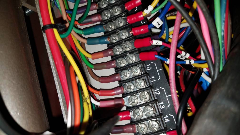

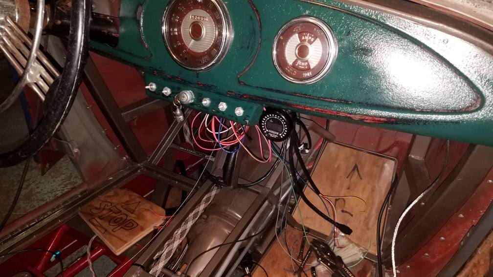

    Organized / labeled relays
    Shoulduv dunn this before i put the back dash in...!

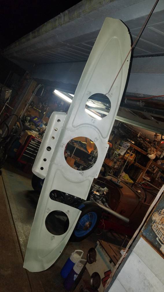

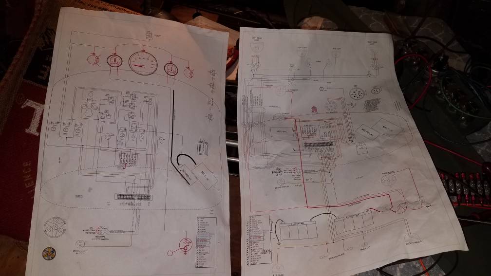

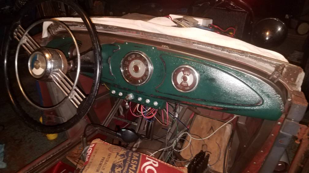

    Starting to make sense again...
    Back board ~ year ago...
    Drawings 20 + changes later...

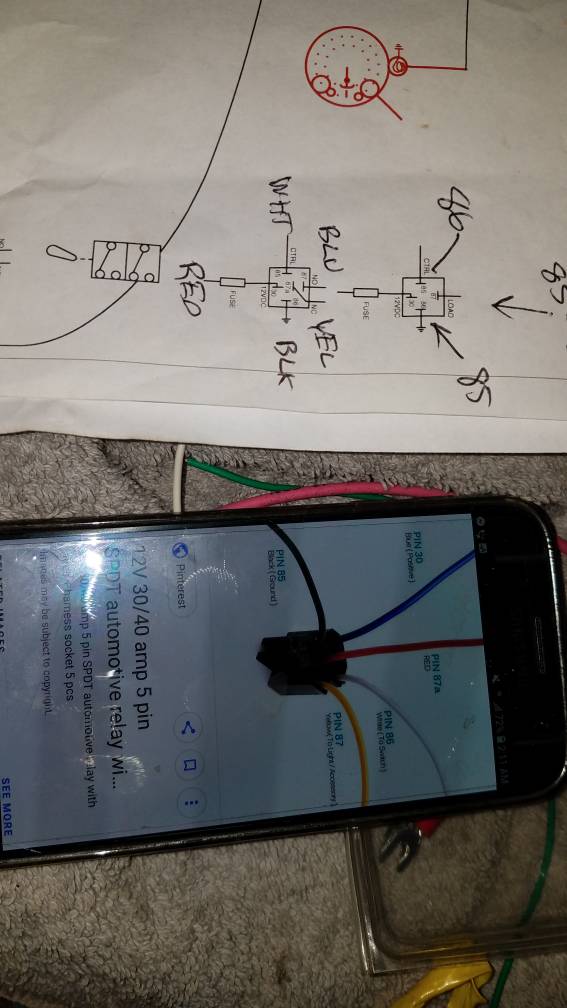

    340HilbornDuster
    It's past 2am...There's the f****** problem.
    E-bay site listed the colors wrong...!!

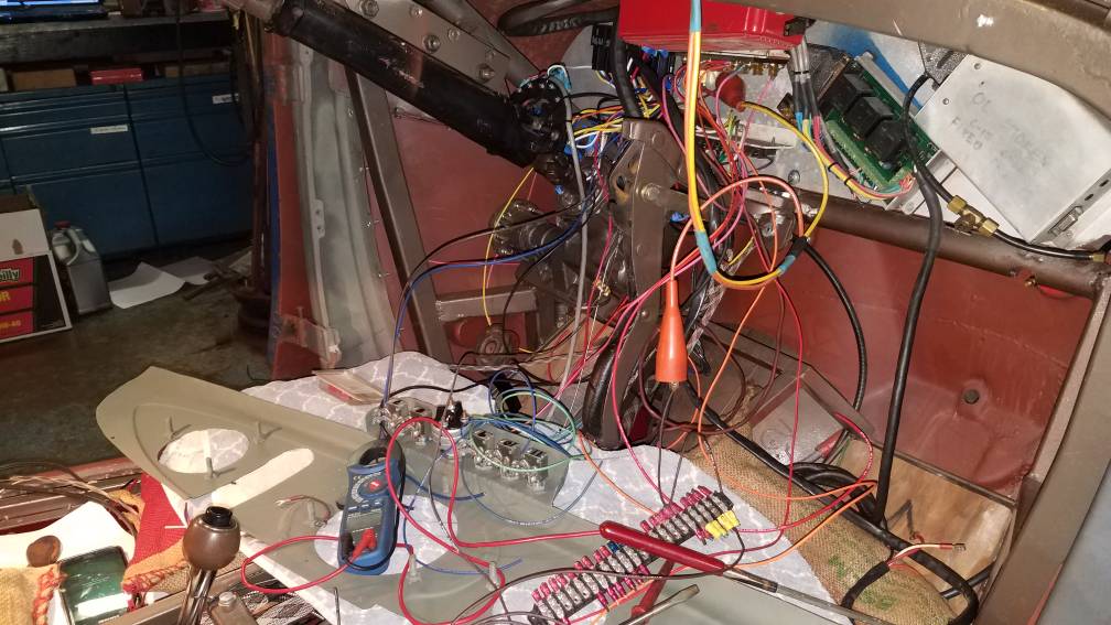

    Should have taken that sucker out long time ago... relay Fu fixed - back to finish wiring.
    Pic Behind that mess.... 20180915_105508.jpeg 20180915_105440.jpeg 20180914_224414.jpeg

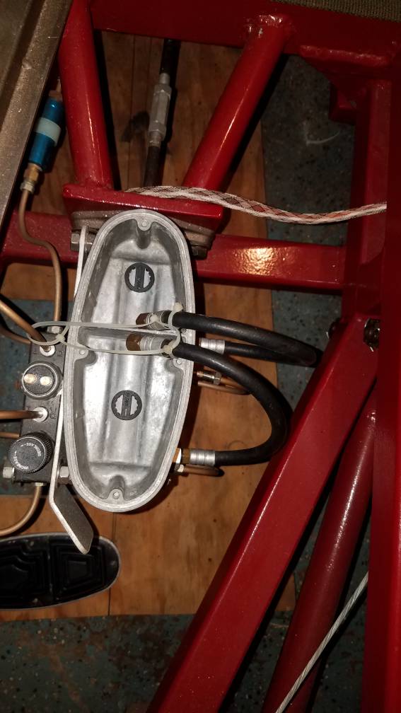

    Hilborn injector hoses to bench bleed the Master Cylinder....looks like the rear circuit is bad!!!...swap meet find...guy said it was re - built... 20180922_135430.jpeg

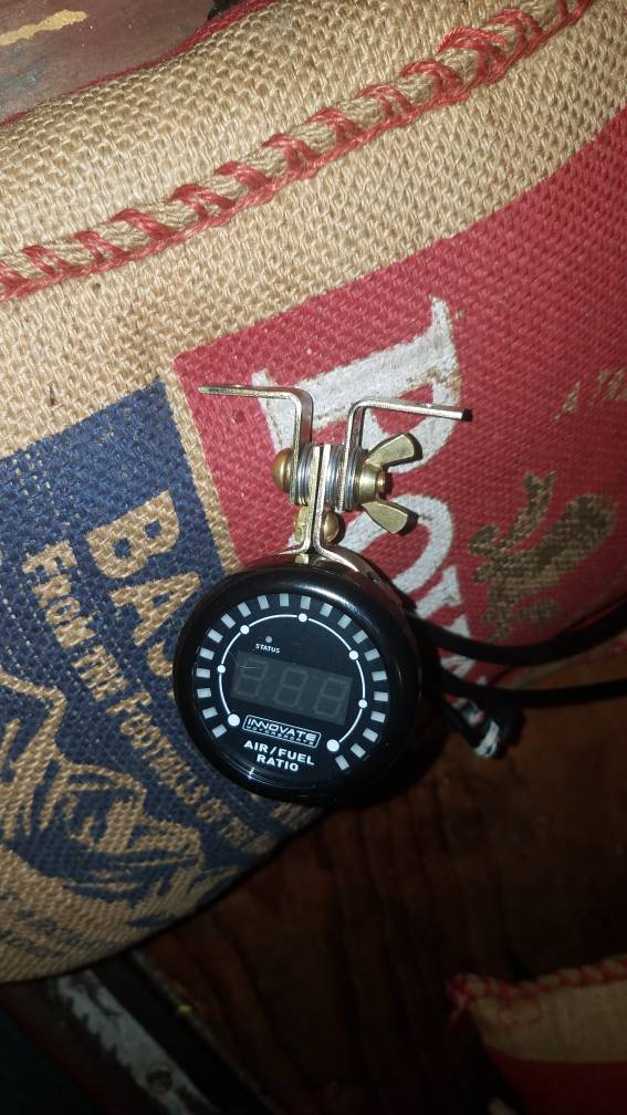

    Foldable O2 sensor bracket...doesn't match the dash look.... 20180923_201943.jpeg 20180923_202403.jpeg 20180923_202410.jpeg 20180923_202452.jpeg 20180923_202458.jpeg

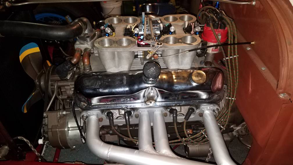

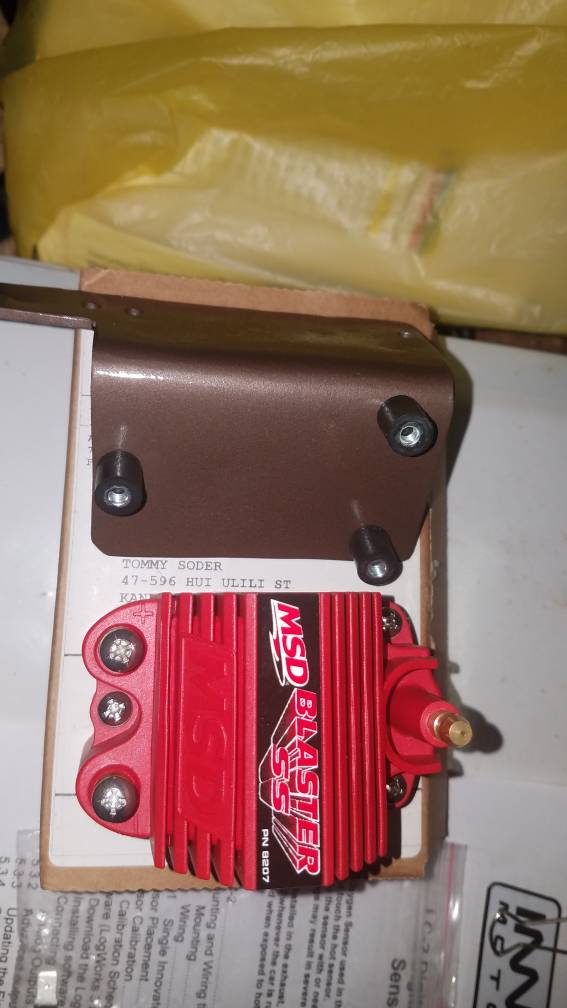

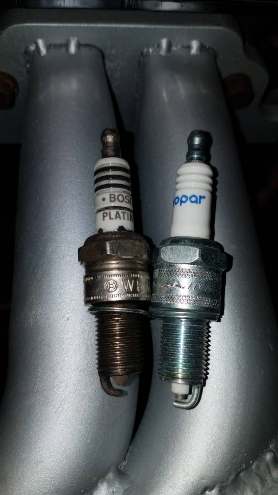

    Mopar plugs...not much more $ than Oh' Realy's.
    Slightly longer than Bosch & not that annoying screw on top...solid...
    Clean up wires a bit... 20180925_203227.jpeg 20180925_210452.jpeg 20180925_205710.jpeg 20180925_211929.jpeg

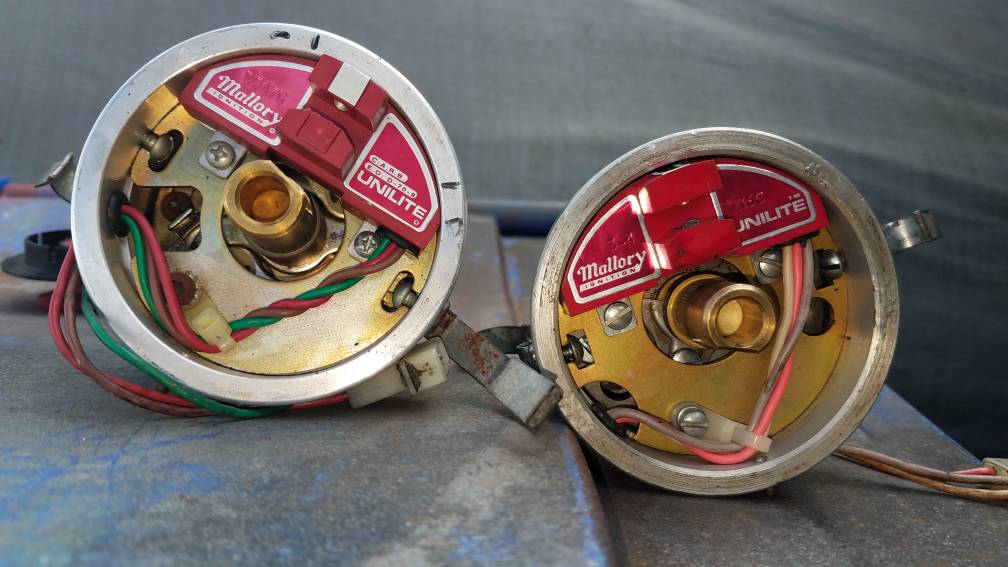

    Troubleshooting...
    Unilite's good!... tested in the Duster.
    Same model number different height? 20180929_154539.jpeg 20180929_154638.jpeg
