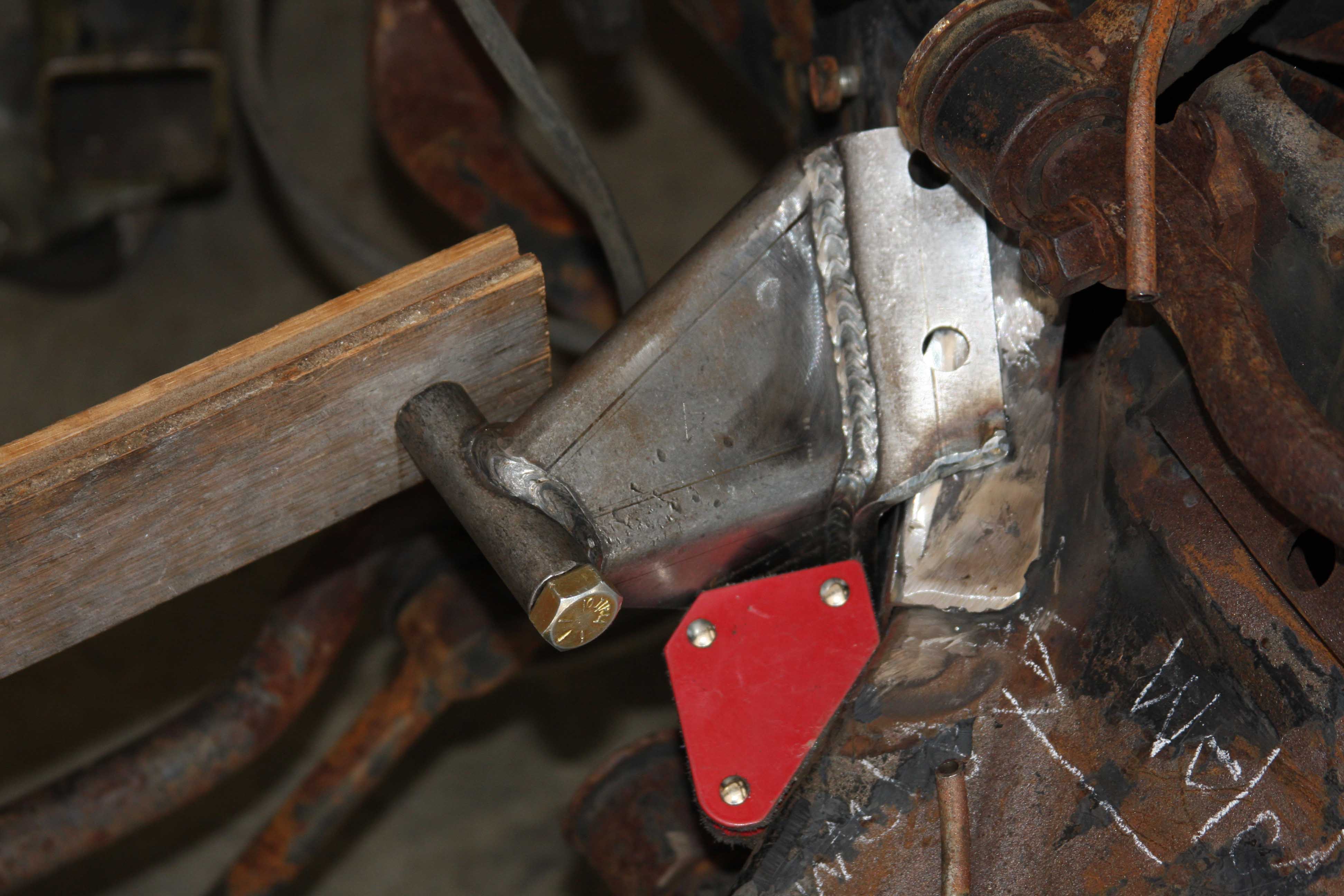

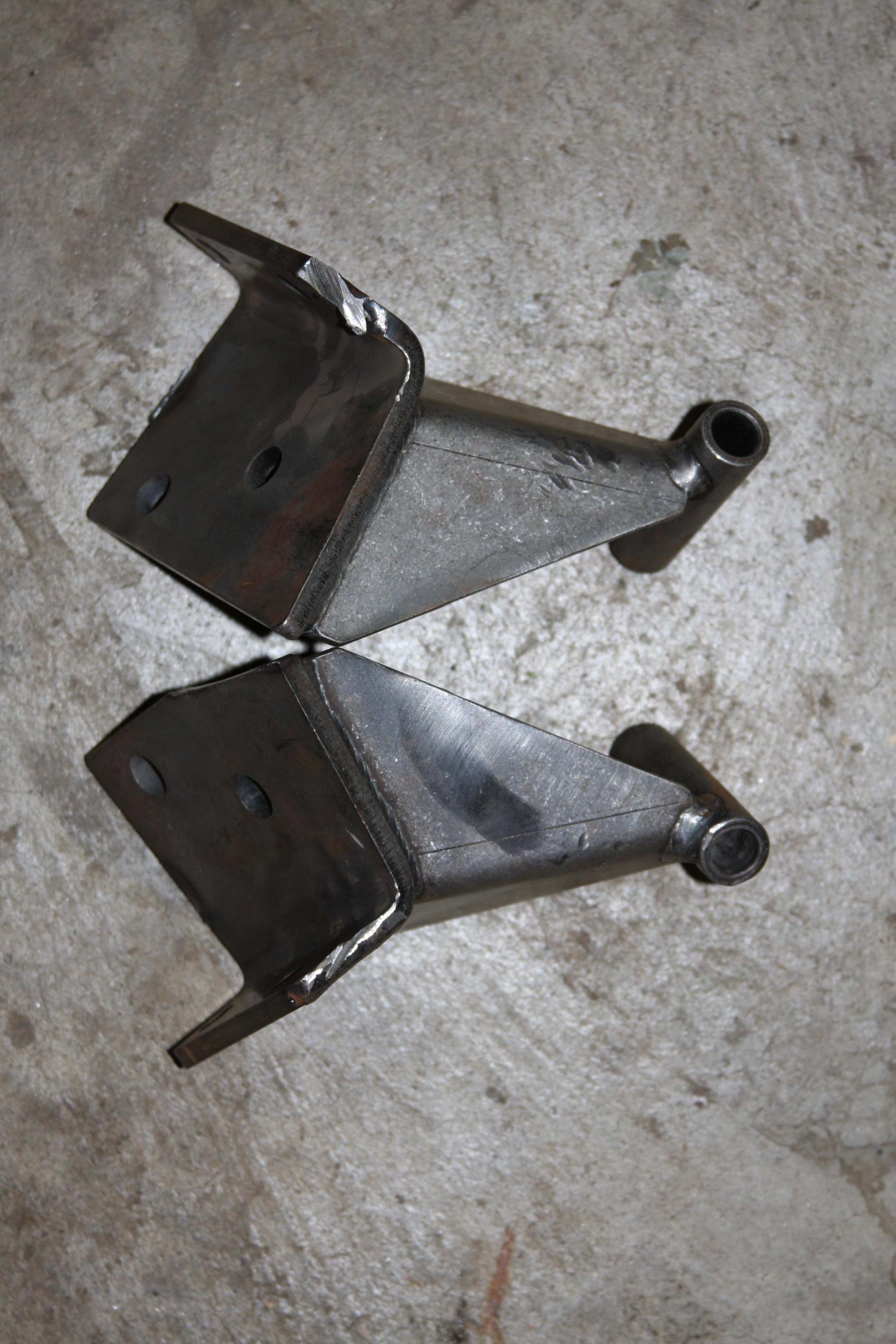

    Ordered some motor mounts for a V8 350 from JAMCO. seamless HEI type.
    They do not align right and do not sit flush against the frame as they suppose to. They are marked with the 4 on the mounts.
    One side fits flush against the frame but the other mount has a half inch gap between the frame and the flat face of the mount. which makes the motor of centered.
    Talked to JAMCO ( getting ahold of someone to talk to is a different story) and arrived 2 weeks late from original ship date
    they said those are the right ones.
    looking at the mounts side by side they have different angles on them.
    which to me seems like part of the problem.
    the instructions that came with it have nothing to do with the mounts. they say they are bolt on types if you dont want to weld. but useless really
    Any one have this problem??? or am i just doing something wrong
    ive have installed other mounts before and its a fairly easy project
    ps. the wood board in the pics is the correct spacing between the mounts for the motor

    its not an extra piece its the plate where the rounded bolt your talking about goes through. i cleaned it up so i could tack in the mounts. but since i havent been able to make them work they are still just mocked up.
    if i put them against the rounded bolt then the mounts will be to far apart. wider than the motor.
  6. what is that dimension?

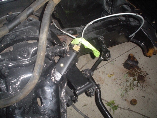

    here are mine installed

    Swap the two mounts from side-to-side leaving the board bolted in place. Will that change the angle for the better and still leave the distance correct?
    The mounts you have look like they're mounted backwards from the instruction picture.

    i tried that. it doesnt work. it throws off the angle completely. it turns the angle inward towards the engine

    I bought mine from speedway. There is really only one place the mounts fit on the frame. Will they sit flush if you put the where they are supposed to go in the manual?
