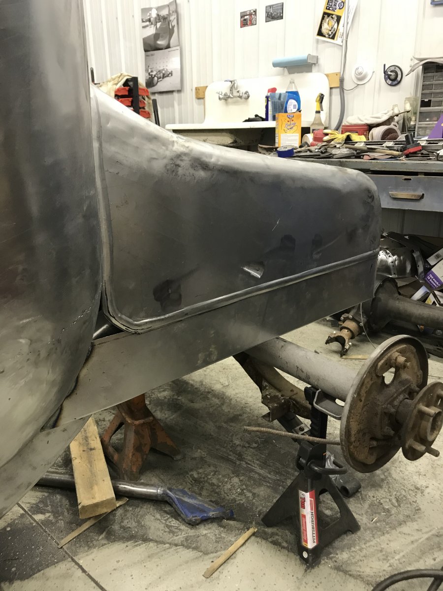

    Minimal progress but still progress. Finishing off around the top edge so the door and quarter panel upholstery tuck under the edge so no upholstery is seen from the top down. Seemed easy enough. Threw away the first 3 attempts and settled for the cut and paste method. The guys who make body filler need to eat too. E5F07552-CAAC-4AC8-ACE5-C54641862C40.jpeg 684BF3C9-6C7E-4AE3-B711-9C1B0536A530.jpeg 73641718-8A2E-42F0-ADD4-53F3BAB2ED84.jpeg

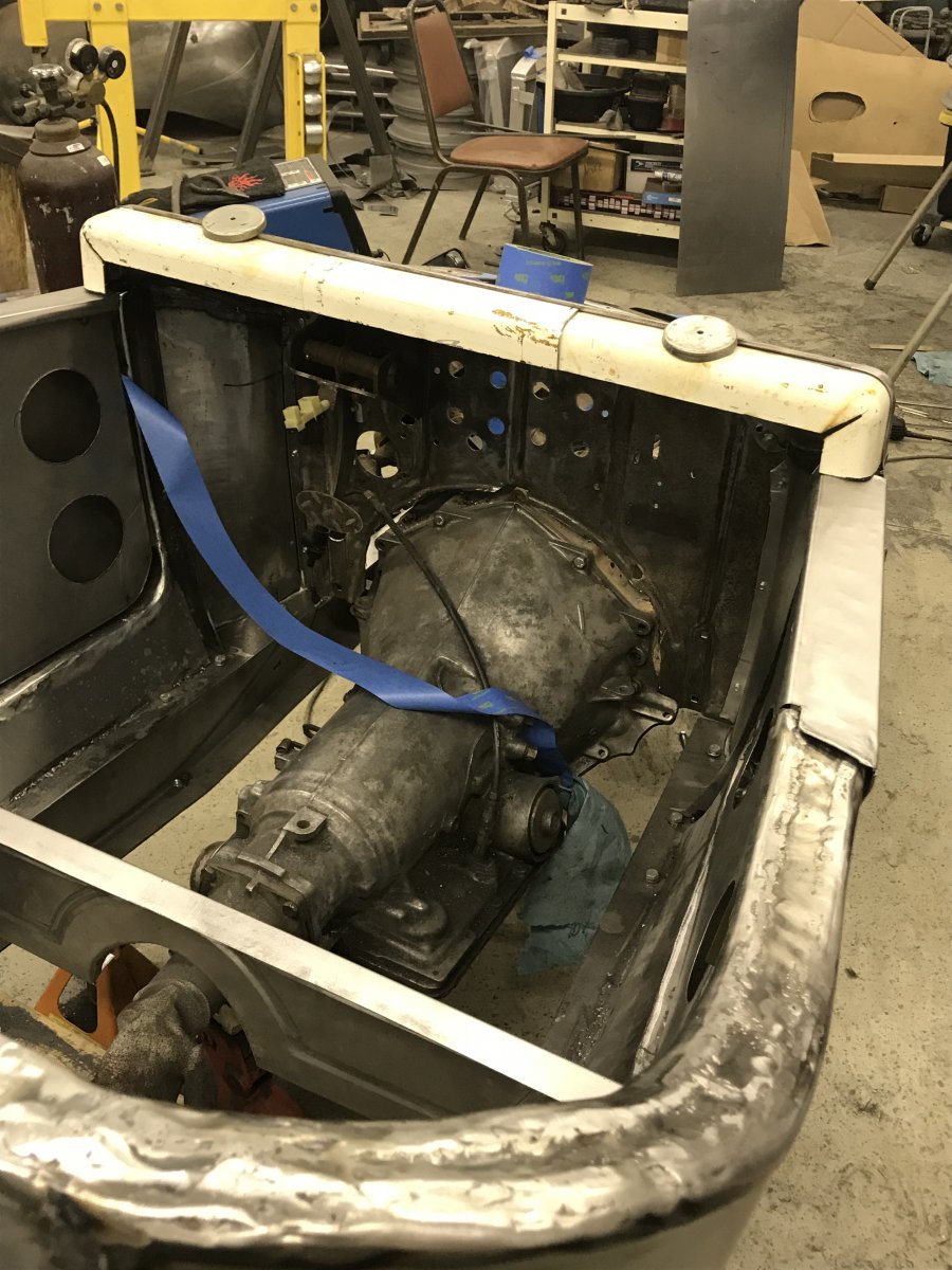

  3. justabeater37
    Joined: Jan 1, 2009
    Posts: 1,806

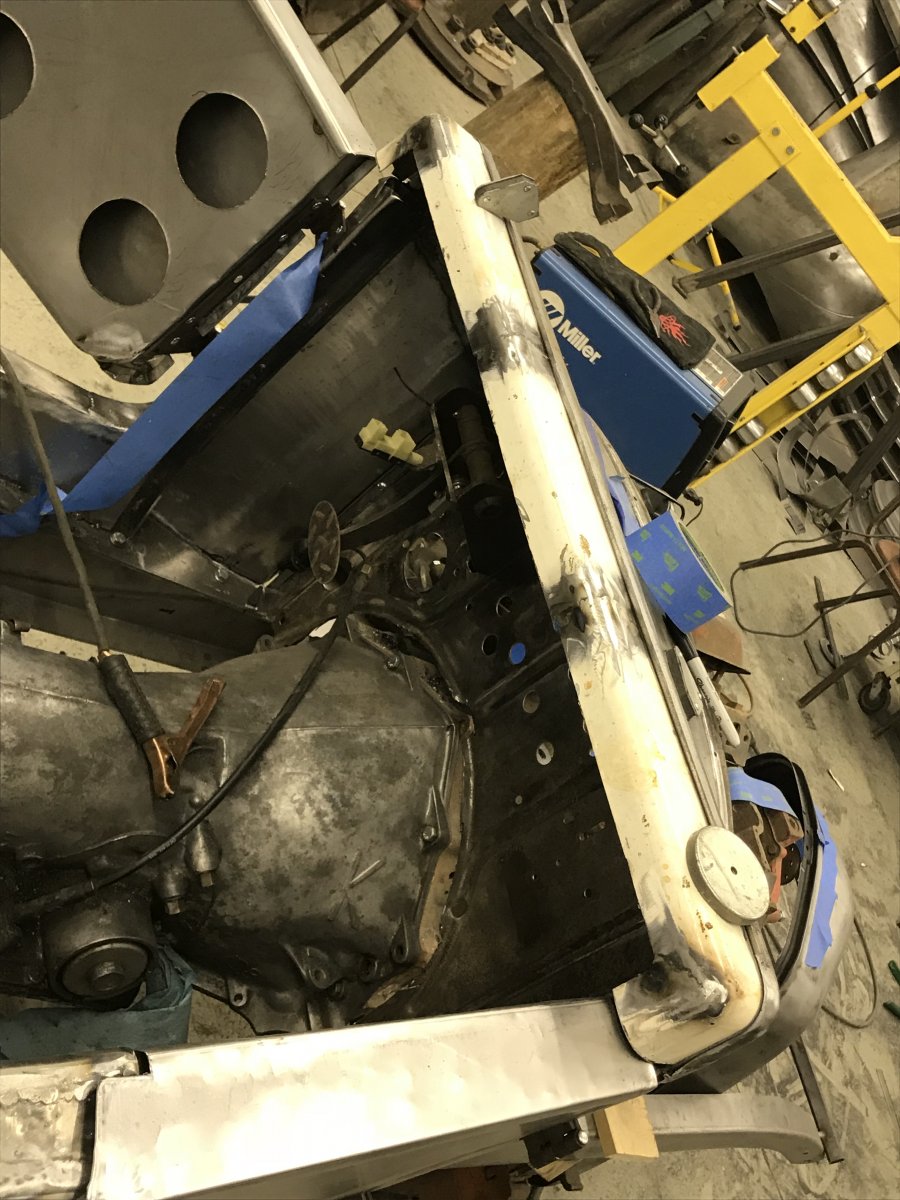

    justabeater37

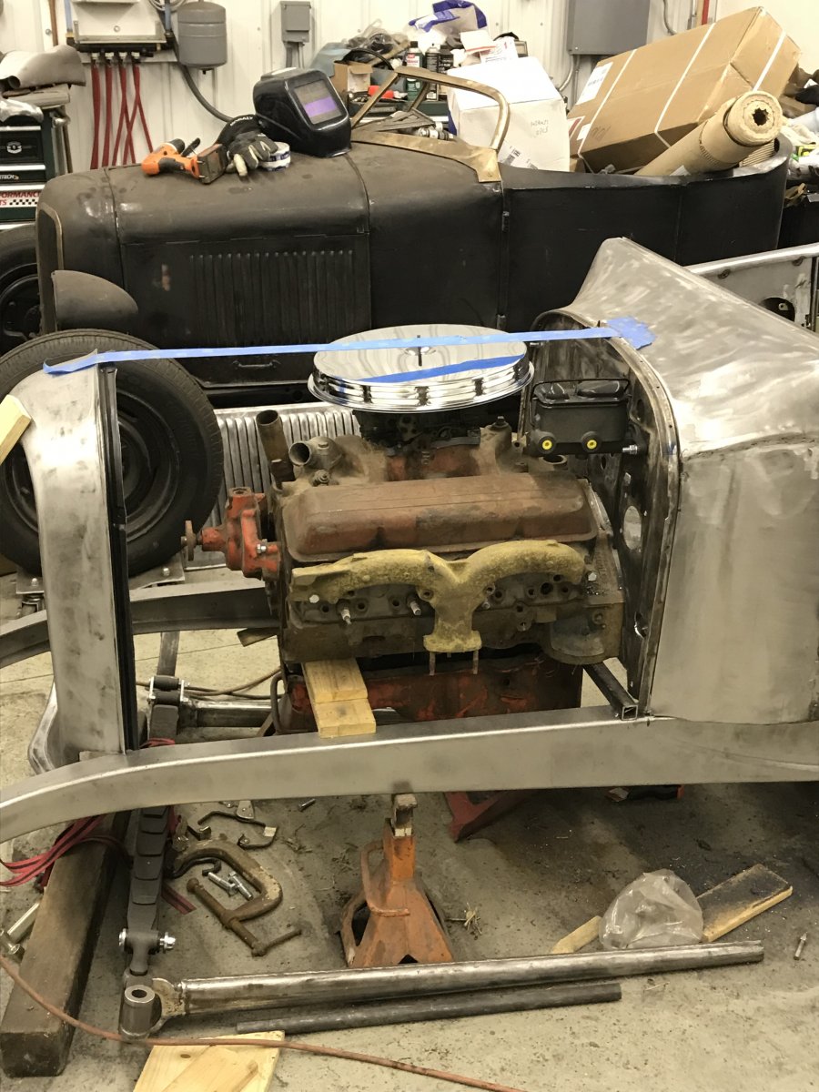

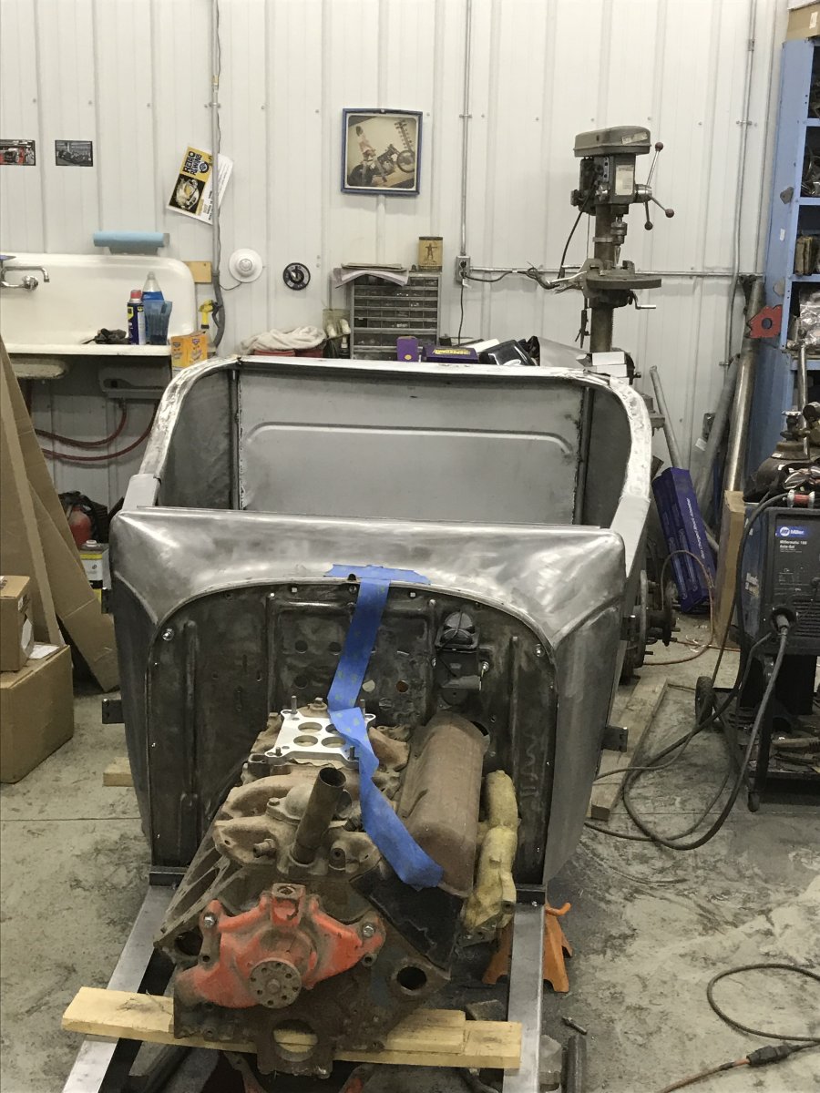

    D58297A6-89A8-44C1-B3D6-251FCB5DDF95.jpeg A19D4C9F-15F5-4519-AFE6-641AE5F0F641.jpeg Work continues. This is why we try to get all of the parts together first before making final decisions. Looks like the engine will need to set a little lower overall and a little more work n the rear. Work progresses on the rear body as well.

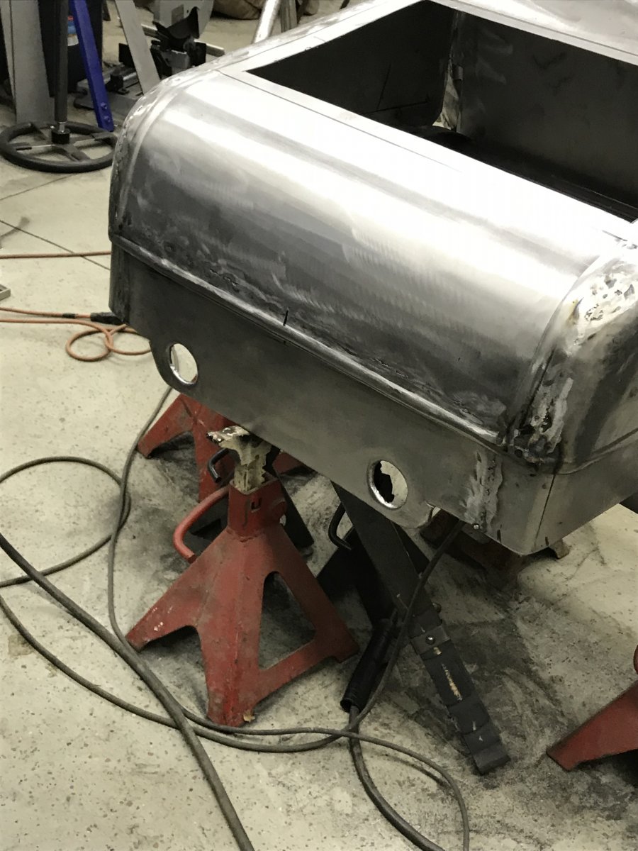

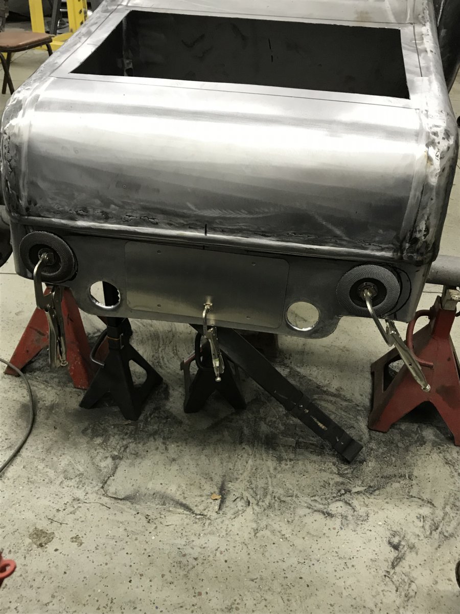

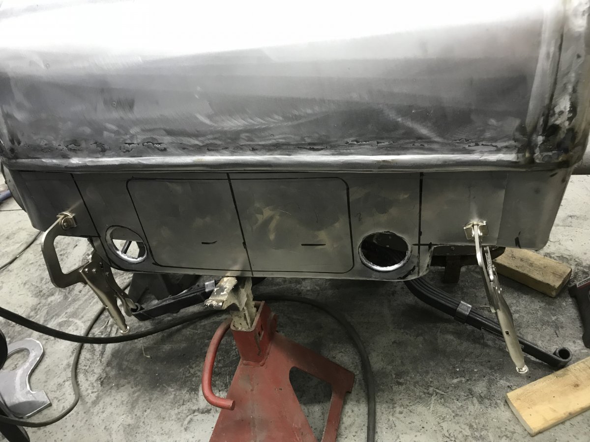

    Working on the rear a little tonight. Exit the exhaust through belled 59D9E626-247D-46B3-B66E-9ED040333DB8.jpeg 0510CD07-4A58-422A-9EBD-C38CD00097A7.jpeg holes near the license plate? Or no.

    Well a friend of mine talked me into hammering in the belled holes. So I guess that will how it will be. 6F6D88D7-2873-4425-AB5D-4B88EC81BD37.jpeg F781B5C0-A0E5-4D7D-BF64-DE82BCC5A0D1.jpeg

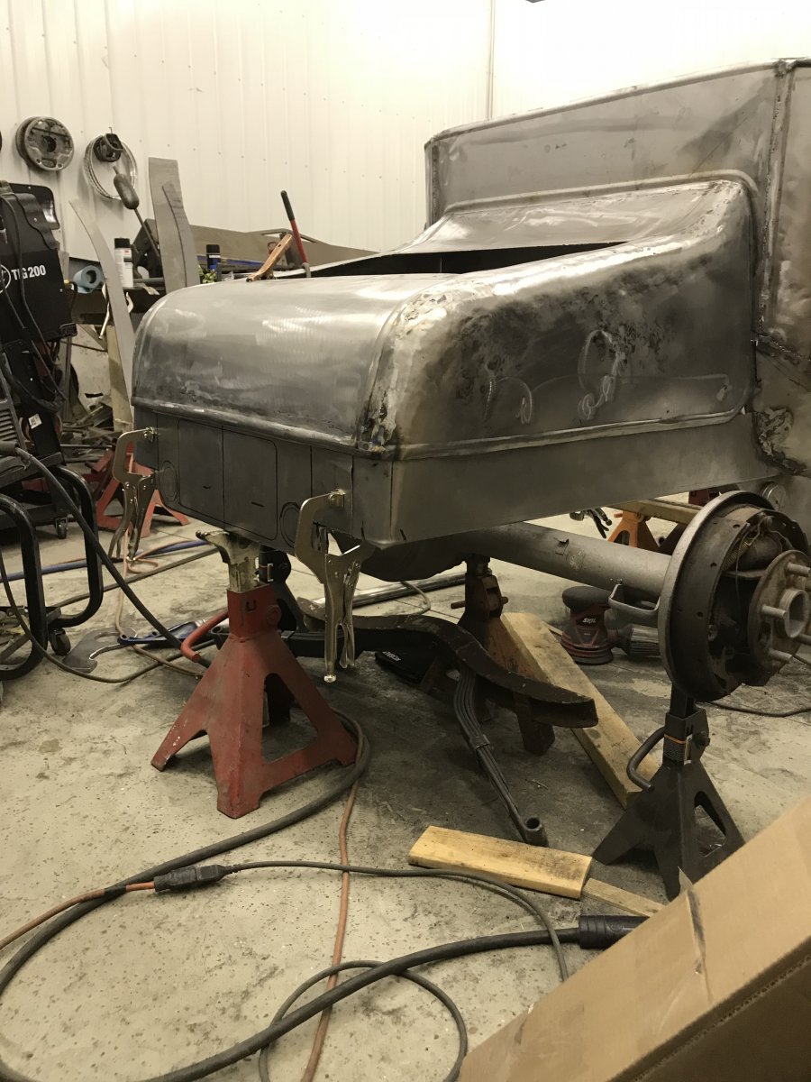

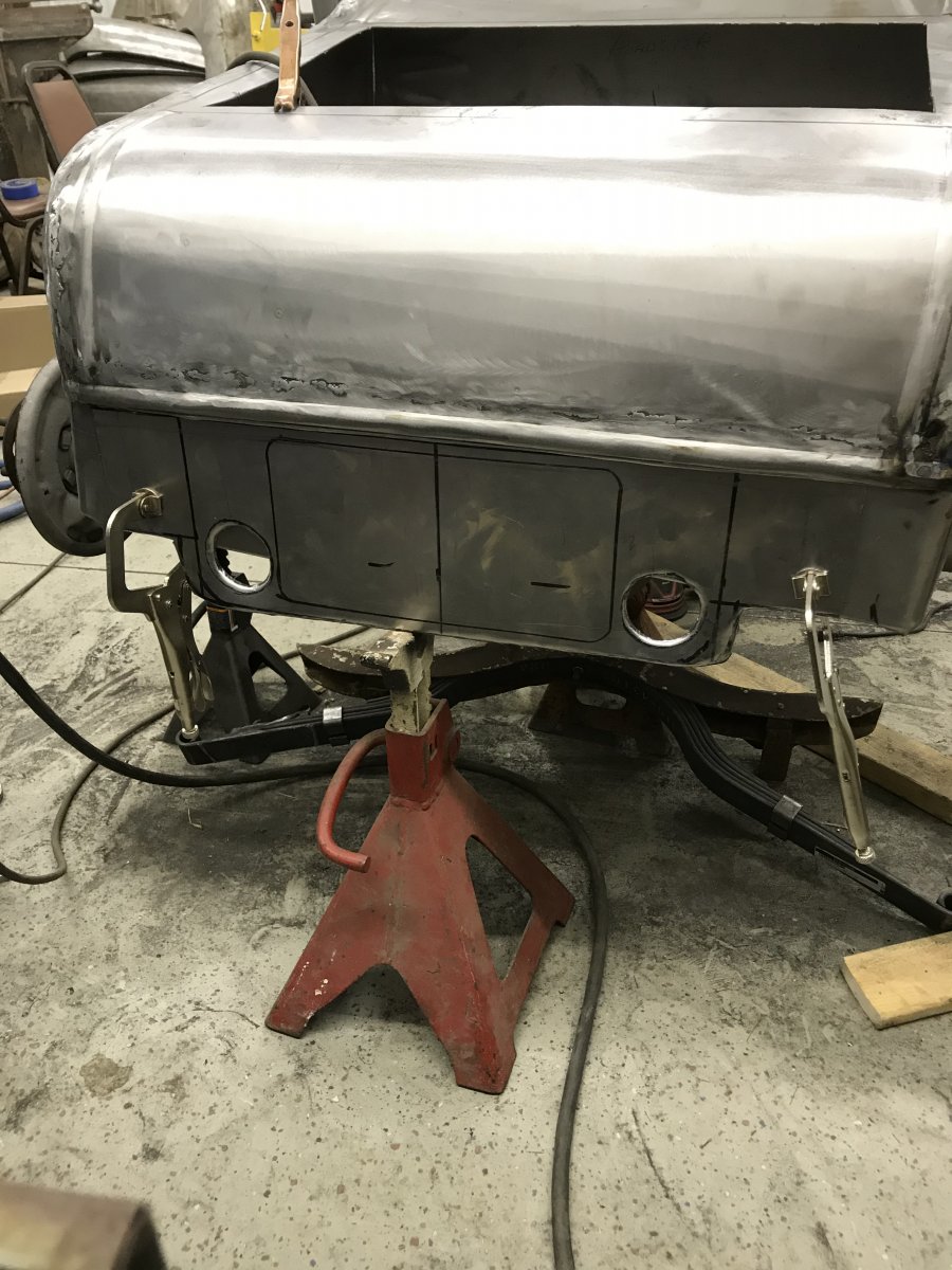

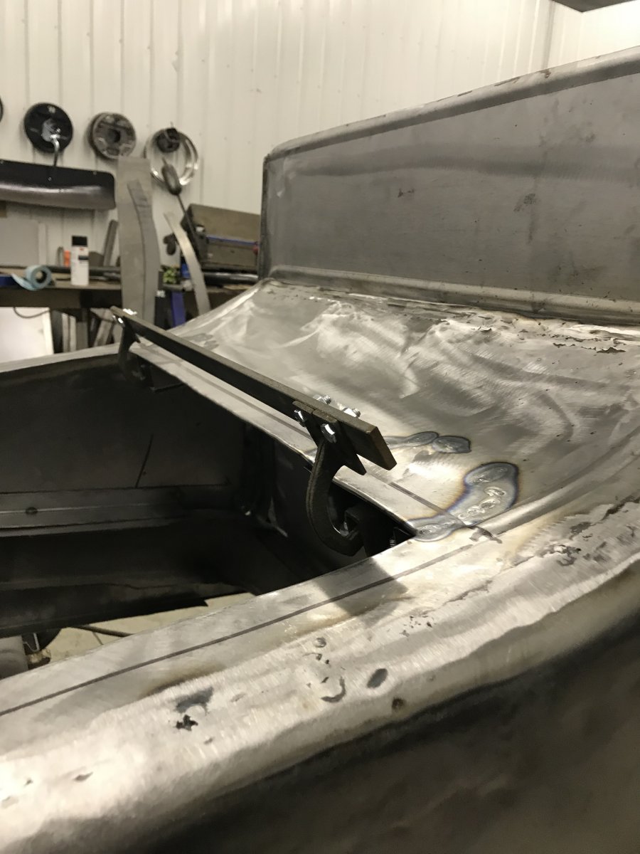

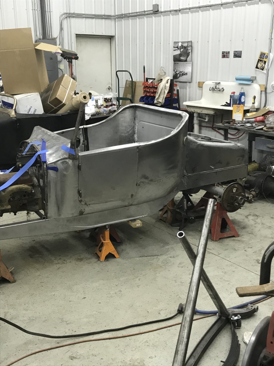

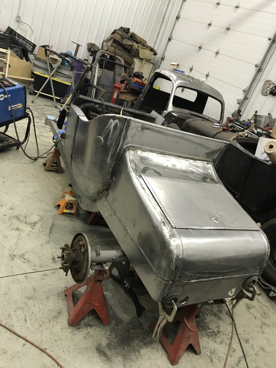

    justabeater37

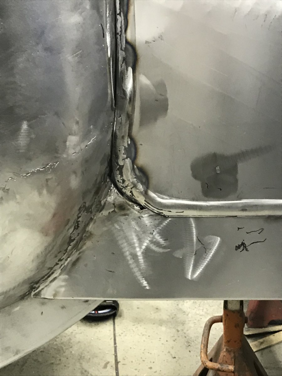

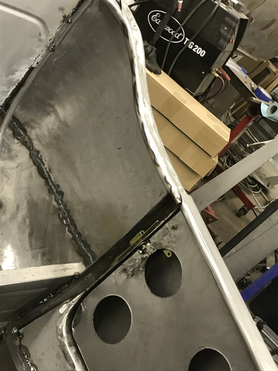

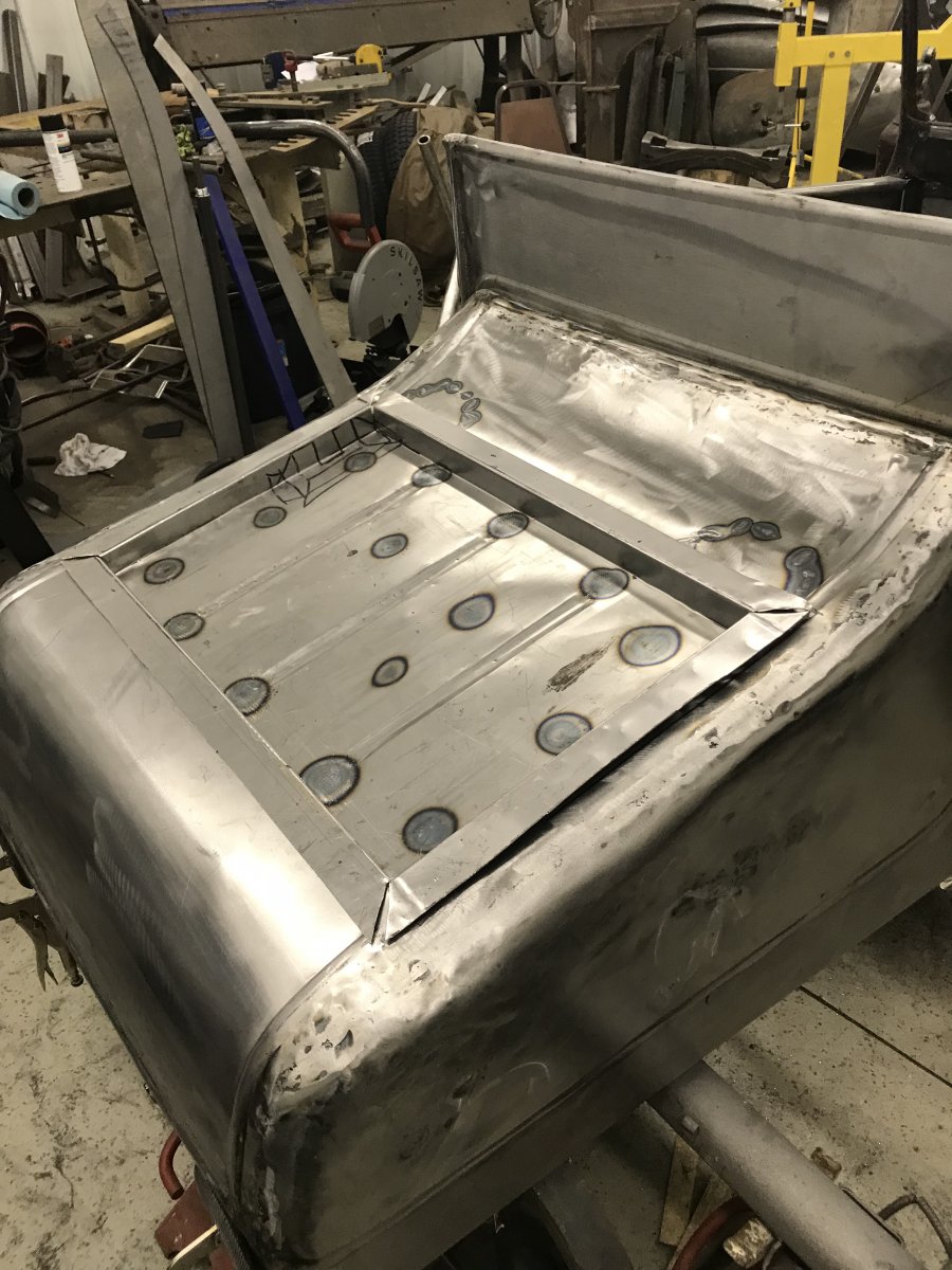

    Sometimes stupid little things to take way too long. Trying to get the Turtledeck fit tonight and the tail pan welded in. Need to keep pressing forward. 1FE8DF74-F0E1-406F-B156-ADDE8C66A07F.jpeg 8DFBB429-F31E-4DED-9830-1DC034B9CF83.jpeg 78A5E259-4CC8-479F-99F9-57B2C5CBE671.jpeg DC0771B2-31A4-4BC4-8904-D57C9F7DA0A4.jpeg

    justabeater37

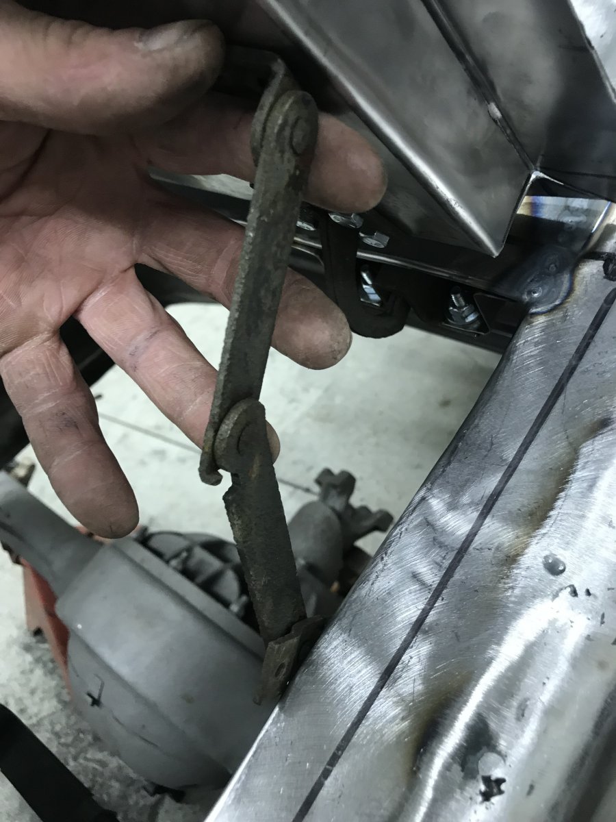

    Figuring out how to mount the trunk hinges kind of looks like a bad game of tic-tac-toe. 6CBA1564-9A6E-4CA8-92F4-6701E6559523.jpeg

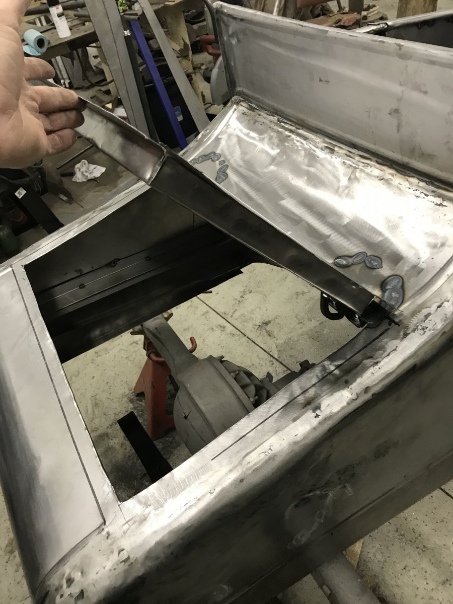

    justabeater37
    9D5E90BA-8FA9-438E-B250-C03DC440627B.jpeg One down. F8A315CC-56F1-404B-A24F-2B05D6DCE6E5.jpeg 2B2B7803-7D50-4D1D-A939-581912FD0A5C.jpeg

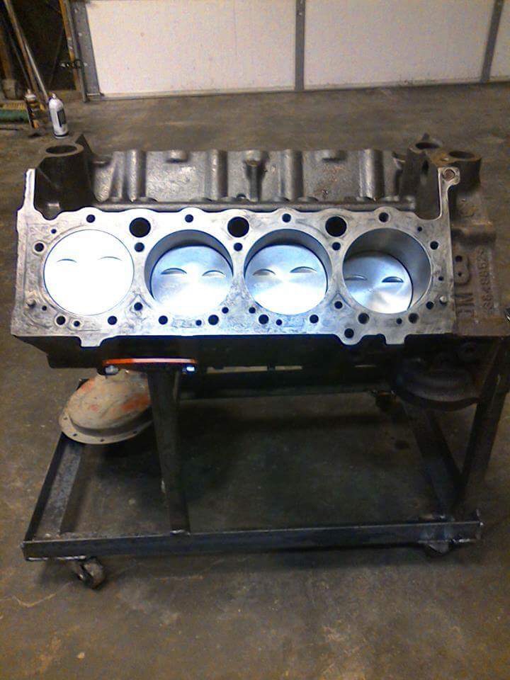

    63B09169-C740-4734-AC7F-1B12796109C2.jpeg 46AA7B03-BA68-4A88-9C19-88A6FFA5D402.jpeg 02E8622E-B8AD-4C69-B271-DABF2EDDDD40.png CBDAF965-E3B2-42B4-B0B6-2D4705CB3247.jpeg I also picked up a fresh 283 shortblock and started to assemble the collection of parts for the engine. I have a couple different offers to finish it up and will know which way it will go this week. One is an old friend I am using a favor with, the other is someone wants no to make a donation to the charity. Either way, the rams horn manifolds are heading out for powder coat tomorrow. I have a place donating all of the powder coating. So I guess wheels and suspension parts will get powder coat. I also ordered a heater and have an idea using a buggy blanket to keep warm for cold weather roadstering.

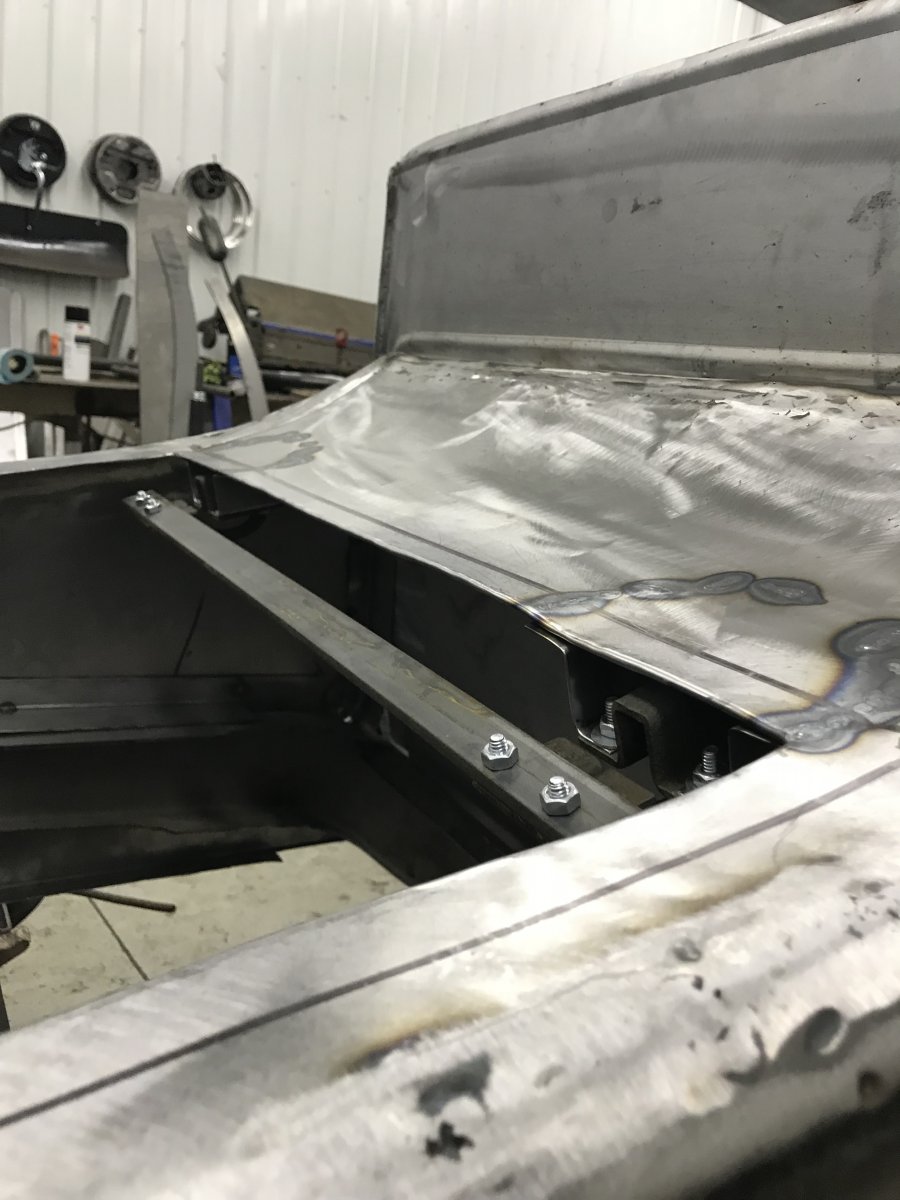

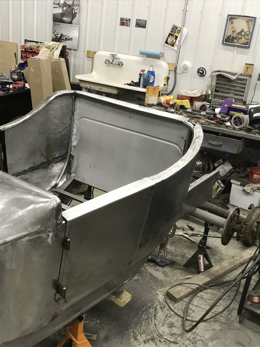

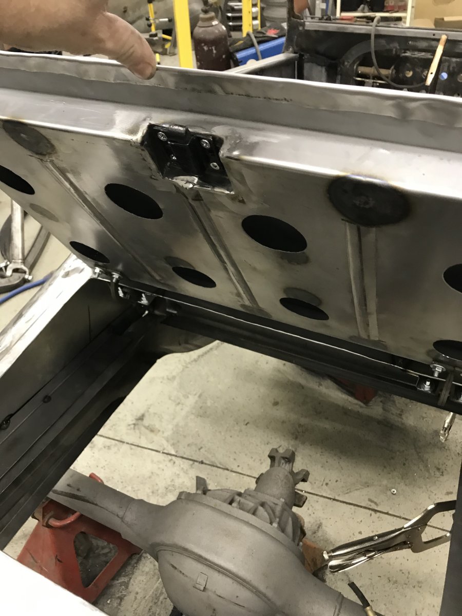

    justabeater37

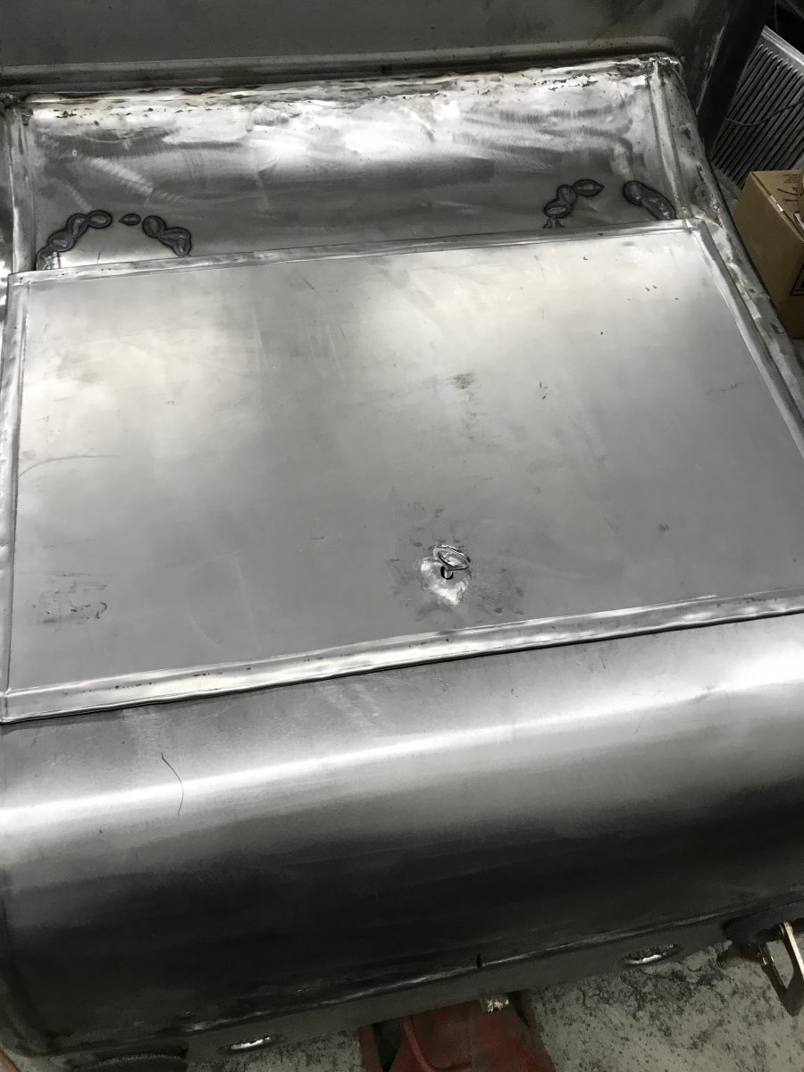

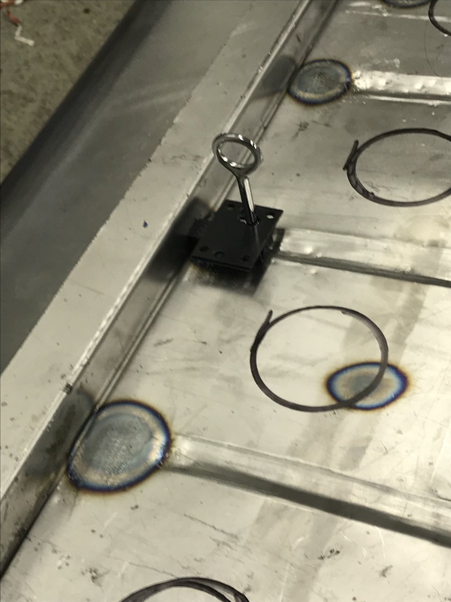

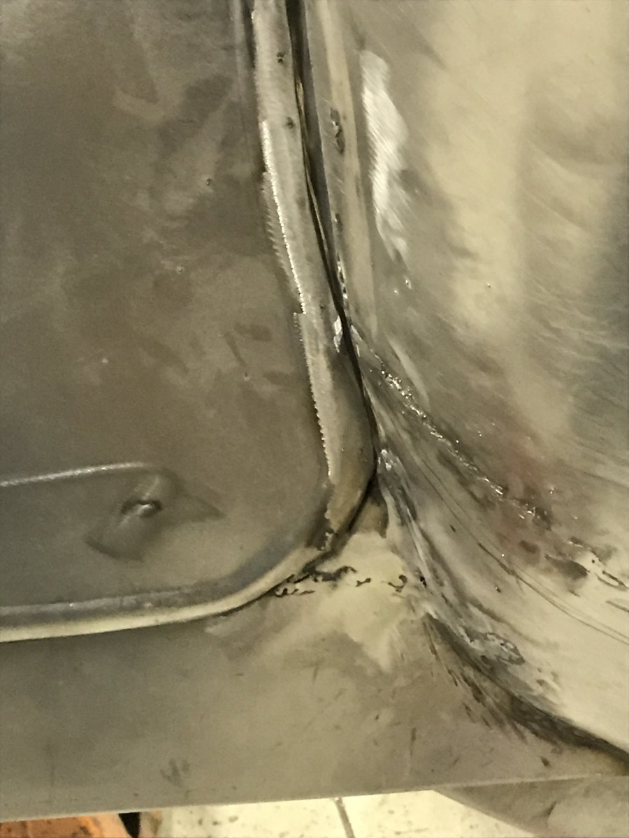

    A little progress on the trunklid. Forgot to prestretch my beads so took awhile to get the panel back to not having a twist. Oops. It’s not all gravy. The shop cat supervisor reminded me to slow down and not forget the latch. BC100ED0-8BFB-4FDF-93B4-4B9AC97780F7.jpeg 14D45366-8190-40AA-8091-0C9269D289A8.jpeg DFE8A35F-5513-4292-91C1-BF2689F90808.jpeg 9E3FF254-F248-41EC-9D59-E4E6325881D4.jpeg 70E3540F-B8EC-47FB-B18D-674679C459D5.jpeg 5CA75984-8B95-482B-A084-F9AF28814FAD.jpeg 2E76C6EE-741C-481A-8A00-AA7739B0A223.jpeg DE11FFB8-A1A1-4943-AC79-99093E6093B4.jpeg 05DE1996-3FDB-40C7-B3FC-6AD937E979B6.jpeg E3205892-E413-484B-8AC3-FD373C7531D7.jpeg 4EBADDCA-133C-4610-9D98-8725AAADF528.jpeg

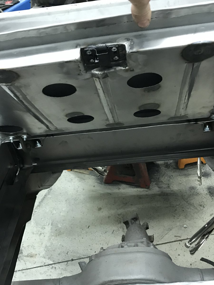

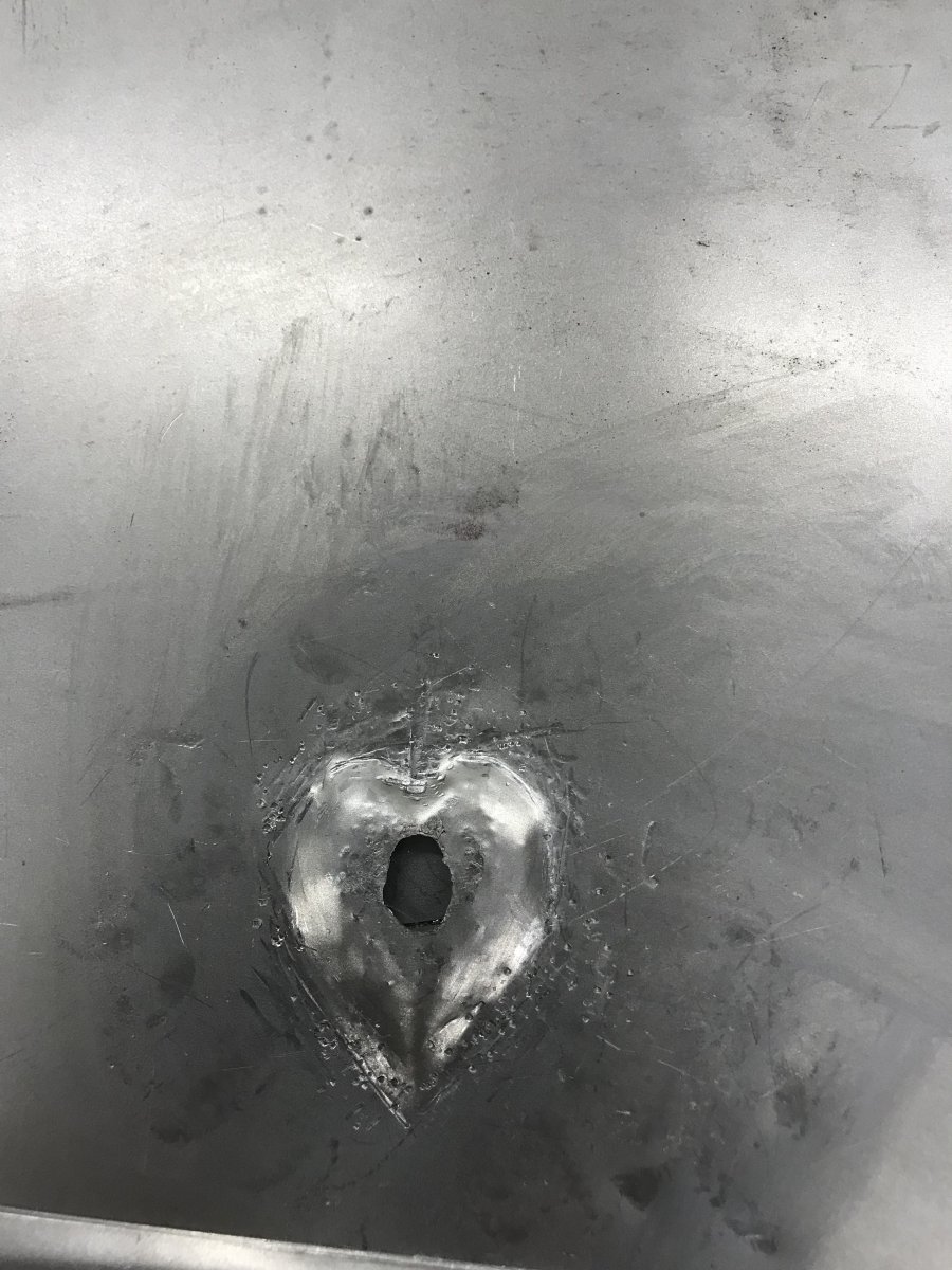

    Not perfect, but I am going to leave it that way as this car is for those with a less than perfect heart. 3A8EF2F3-5AAF-4E56-A948-0638FF5C4E77.jpeg
    Dannerr, Stogy, brEad and 5 others like this.

    I have a stock latch for you. if you can use it?
  25. justabeater37
    Joined: Jan 1, 2009
    Posts: 1,806
    justabeater37

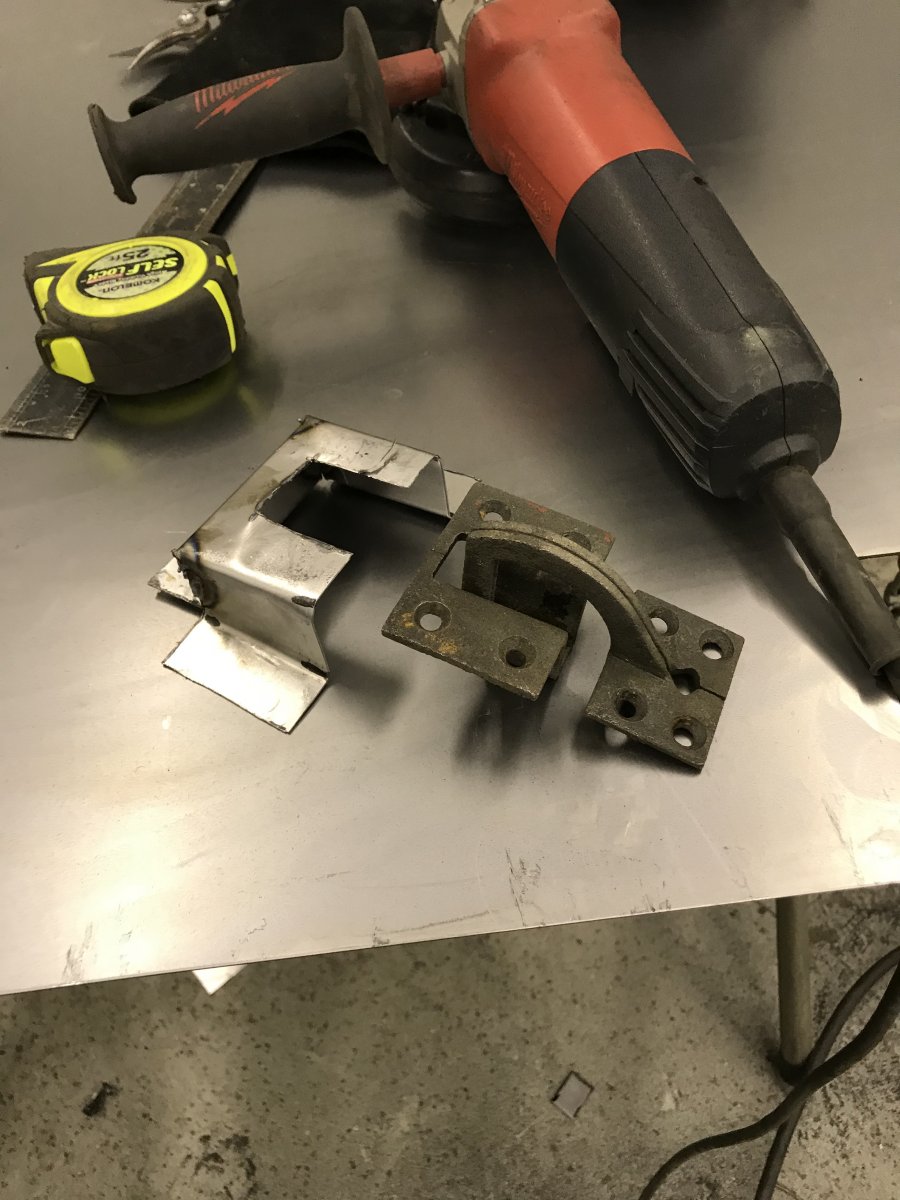

    Using new a 26-7 latch. I hope to get the lid done tonight.

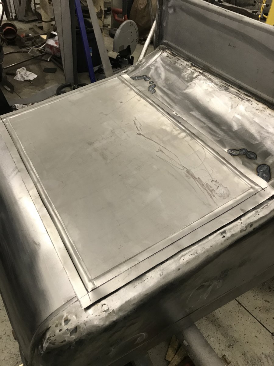

    Getting closer. Still needs a hammer massage and a mud bath, but slowly creeping closer. F737DDA8-FF86-43A3-B8BA-E731E0D471D5.jpeg FA5CA9CF-DC32-439A-83AB-97E47D079128.jpeg 27480A95-4779-4B7B-8684-02B863459AB6.jpeg F1E297B8-3462-45CF-8DB6-1B636341BD44.jpeg 26B4B0C8-5A71-4CD7-B7CE-D4935D473E42.jpeg

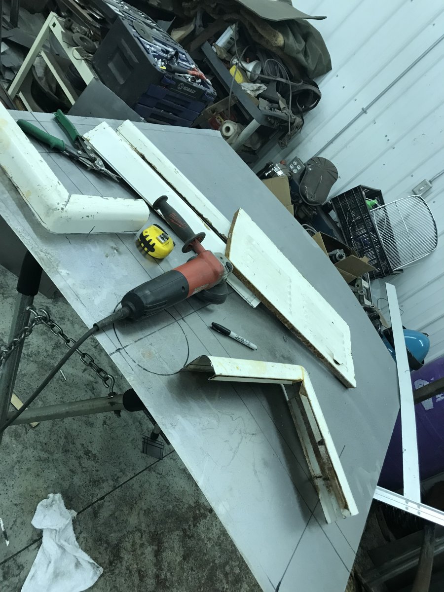

    justabeater37

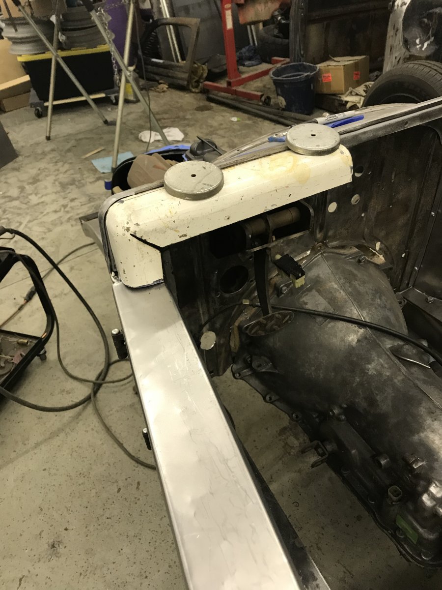

    142E0576-3484-4CB6-A32C-BFD1D6EB541D.jpeg 88B70B42-E9C2-4E34-B7A0-B66C0CB59411.jpeg D9E572B7-365B-4683-879F-FF788B4B9B74.jpeg A93A4872-70CF-4183-AB76-B055021F1AA9.jpeg And from the never throw anything away files, this was the furnace I took out of my house two years ago. I saved the curves and louvered sections of the shell before I scrapped the rest. Looks like a decent start to the dash.
