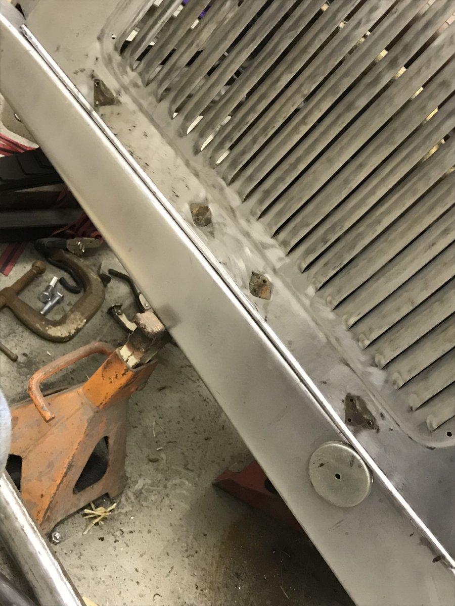

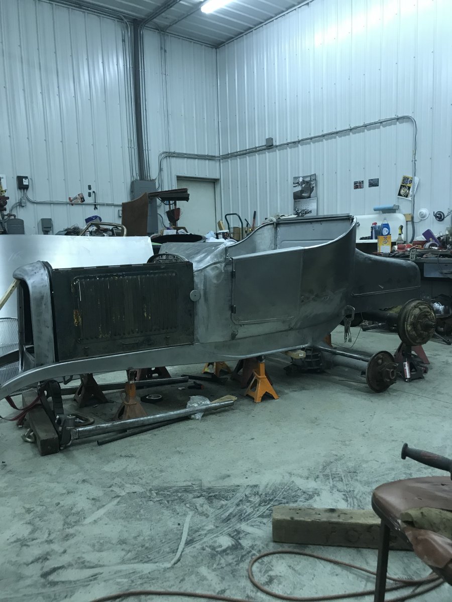

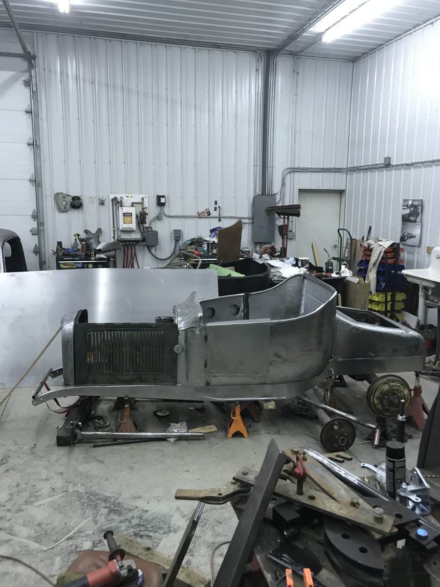

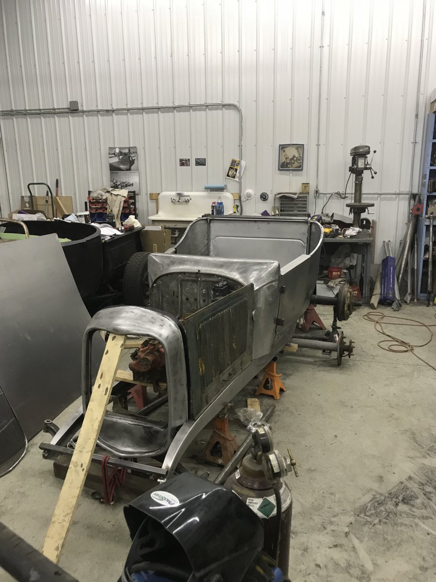

    And this is where it sits now. Done for the year. Time to take my wife out for supper since we didn’t go out yesterday for her birthday. 63EEB690-AB6D-4C52-9159-BBAA5B9D5CBF.jpeg 914AC181-FE92-4183-A8FA-CEC3F67EB0A7.jpeg FFD0E55B-2B30-432E-95E5-7C3696BEC68B.jpeg

    How are you bead rolling the panels after they are on the car? Great Work very impressive!

    It was the turtle deck. My son helped, I man handled. Had to add the bottom piece in the rear anyhow so rolled it before welding.

    Ahh that makes sense I was trying to figure out how you rolled that after welding I thought you invented a new tool. Happy New Years ! Hobo Jim

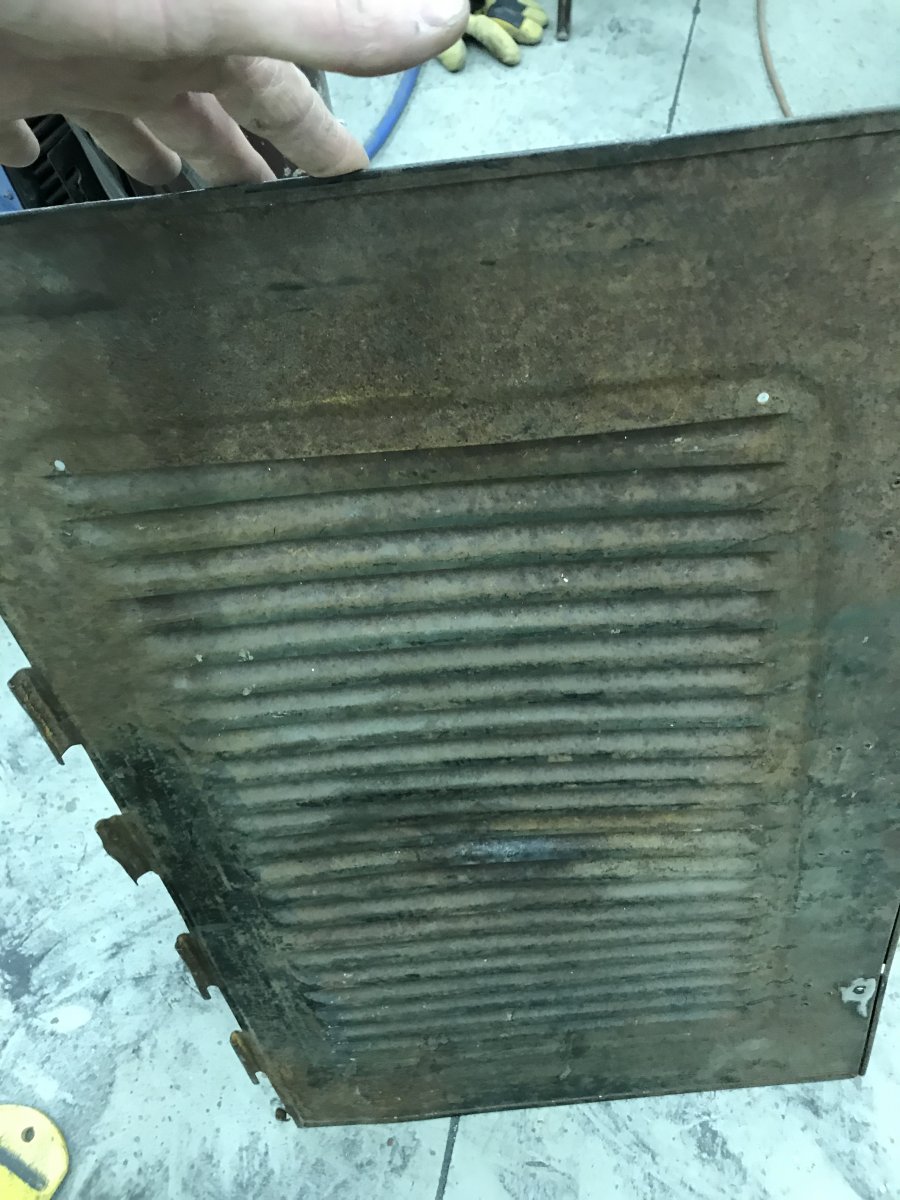

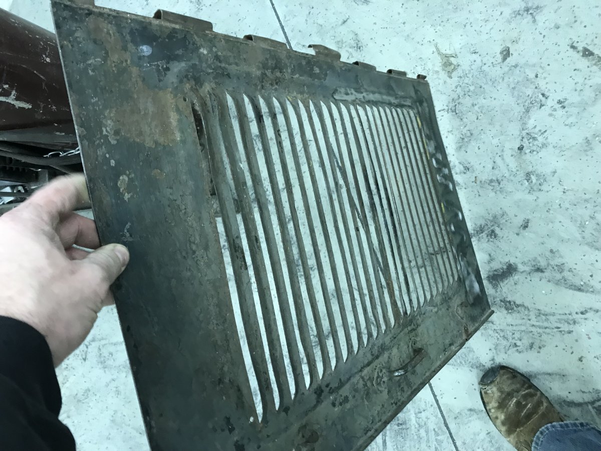

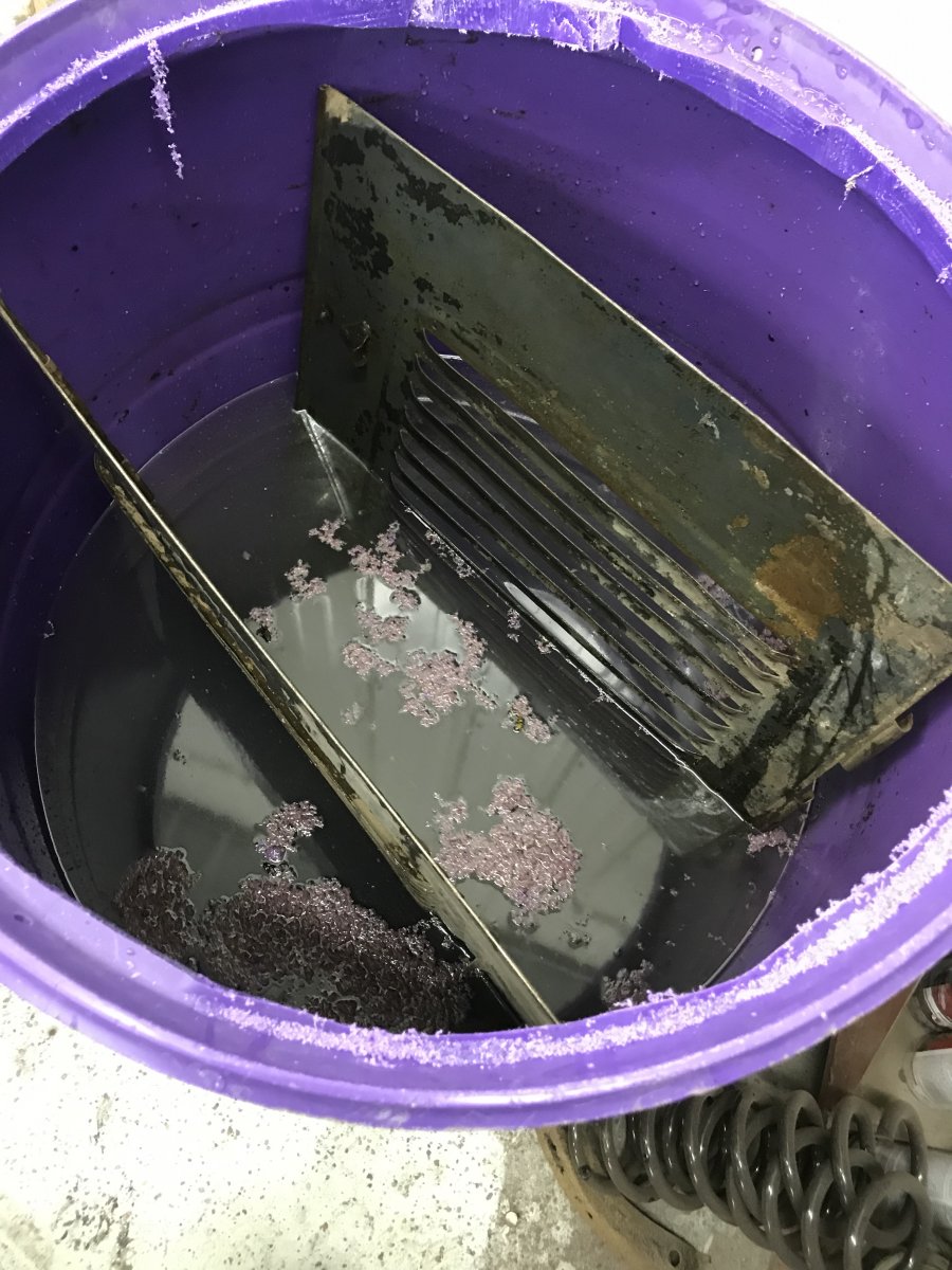

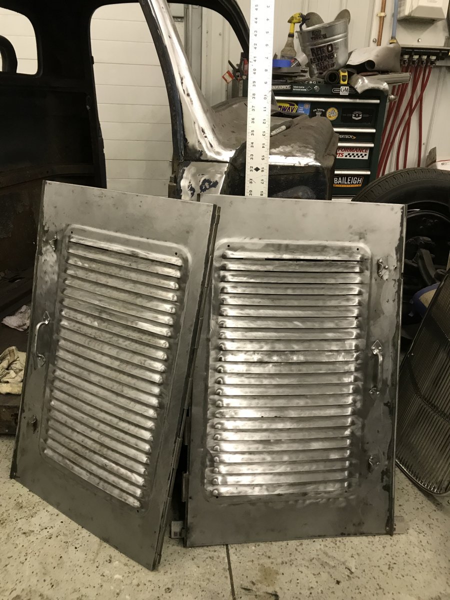

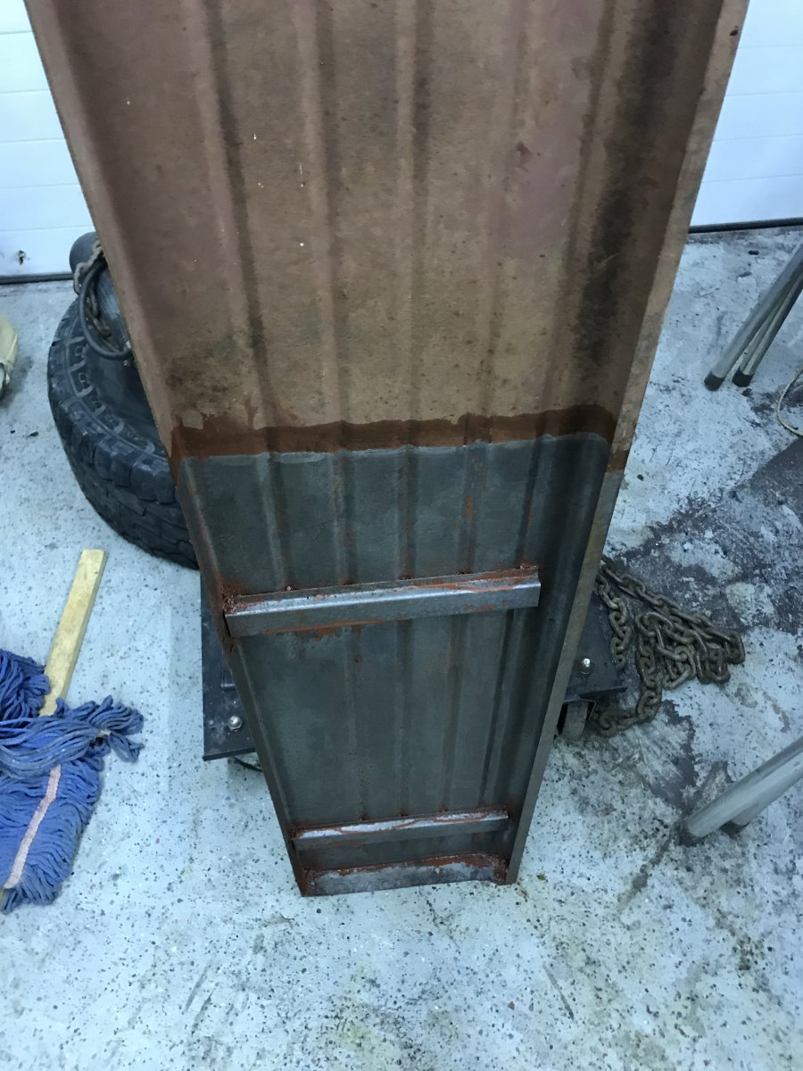

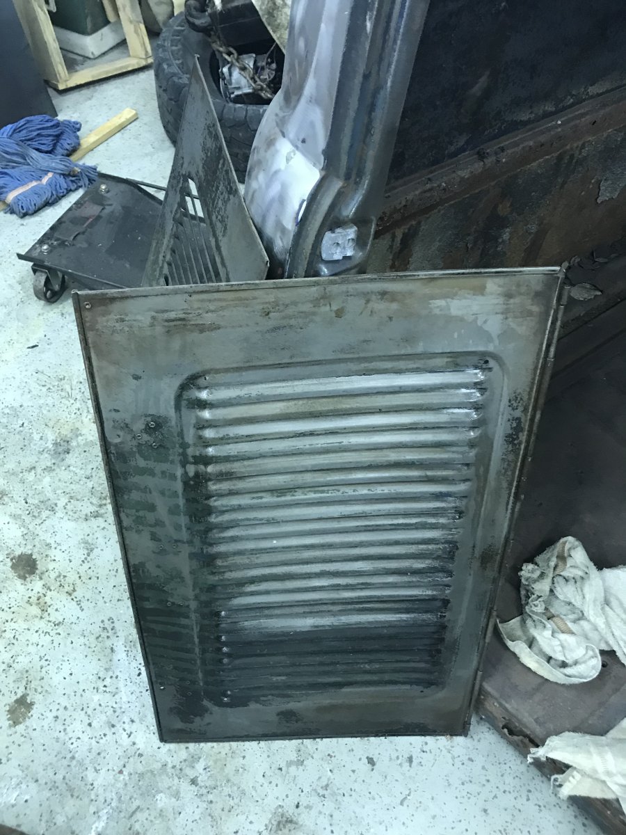

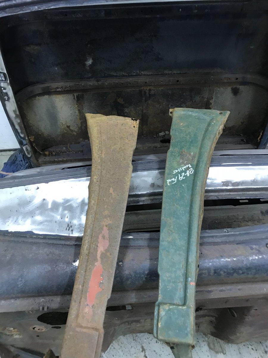

    New science experiment to clean up these hood sides. Citric acid. AB0D6D96-3D1A-4E4D-8A51-9B16C337CC72.jpeg A92AA679-F563-4584-B941-5CD6B40C1E6F.jpeg DCE138E8-4E99-4579-A2AD-2666725C9A01.jpeg A1B54DDC-79D7-45C3-8F70-CF7821B49422.jpeg DB7F2E8D-09B6-4D89-B324-D8C2D63E02E6.jpeg

  18. justabeater37
    Joined: Jan 1, 2009
    Posts: 890
    justabeater37
    from Iowa

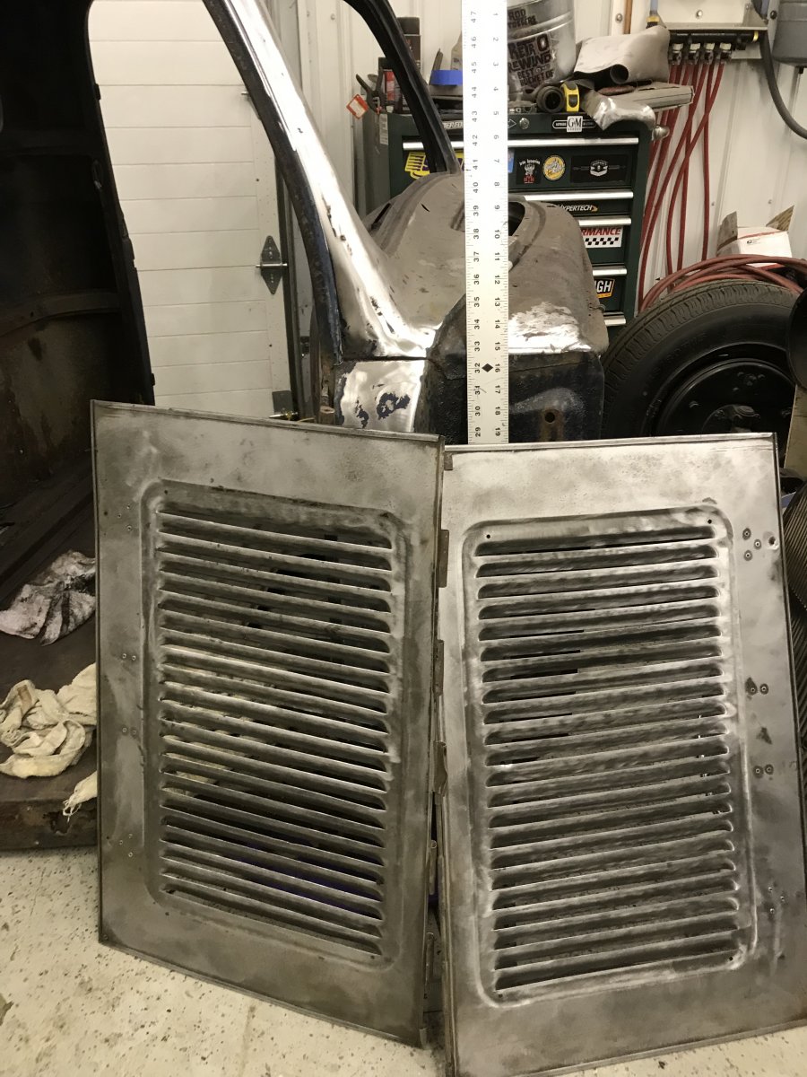

    It’s working. Should be good by tomorrow. I have to go back to the specialist for my foot on Wednesday. Hopefully I can be back on this thing full speed again. CEC47C34-6D1F-4C9B-9E37-5CF3965E36E8.jpeg 0363B016-0F3C-4668-8497-42471A08B16A.jpeg D99A4EAB-D441-46AB-8986-1DF0090E1A55.jpeg
    Stogy, Dannerr, tb33anda3rd and 6 others like this.
  19. Citric acid looks like it worked pretty well. Was thinking about using evaporust on some chassis parts. Might try that instead.
    Whereabouts in IA are you?

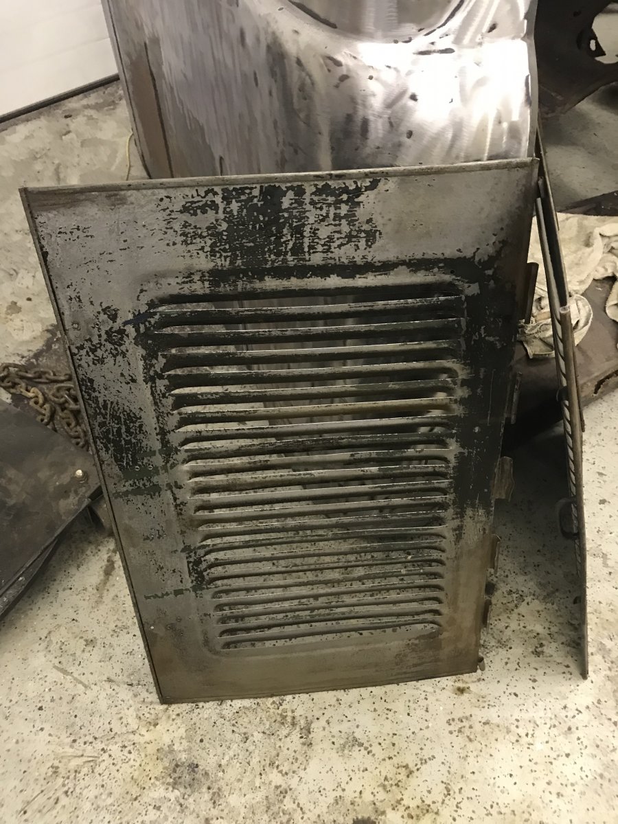

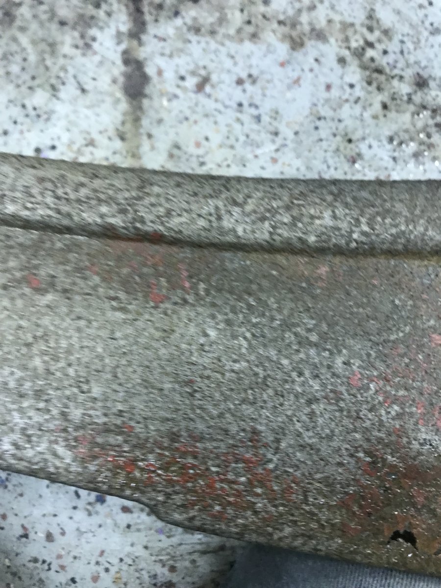

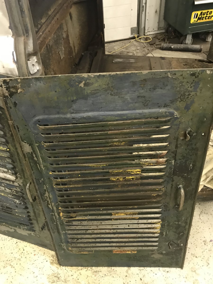

    Somebody asked about heavier rust on Facebook. It takes a little wire brushing but still works. I am about 10 miles east of Iowa City Roadsir 2F98A2A3-D026-4FC4-BDFC-14D1BF244C76.jpeg 1DD963E6-C231-4324-912C-25CA001F9F05.jpeg 255192F0-2591-4010-81E1-2FDA7939FE07.jpeg

    I have used citric acid for years.It works fine with the sheetmetal parts,but it destroys cast or forged pieces.I have used 5% mixture,let the piece sunk there 24 hrs,rinse it with water+brushing it with steel brush.After that an another 24 hrs again and some brushing and rinsing.If the piece is done,after the rinsing i have dried it with a heat gun.Without drying it will start to get some rust again.Usually that 48 hrs works,but it doesnt hurt anybody to let it be in there longer.If you can warm the citric acid somehow,it will be more effective when the acid is warmer.
    Keep up the good work!

    Indeed it may be weak but it is an acid. I wouldn't use it on anything that I feared hydrogen embrittlement. Better safe than sorry.

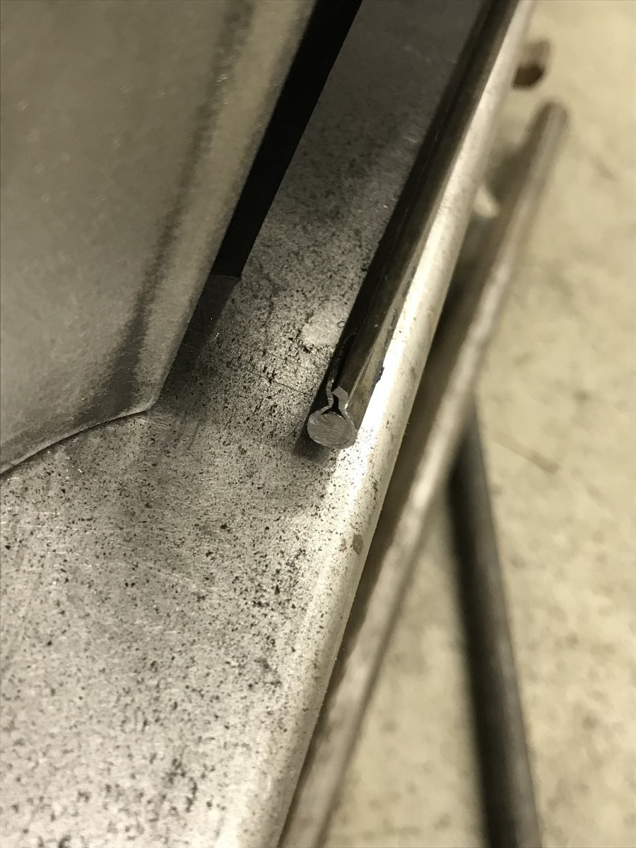

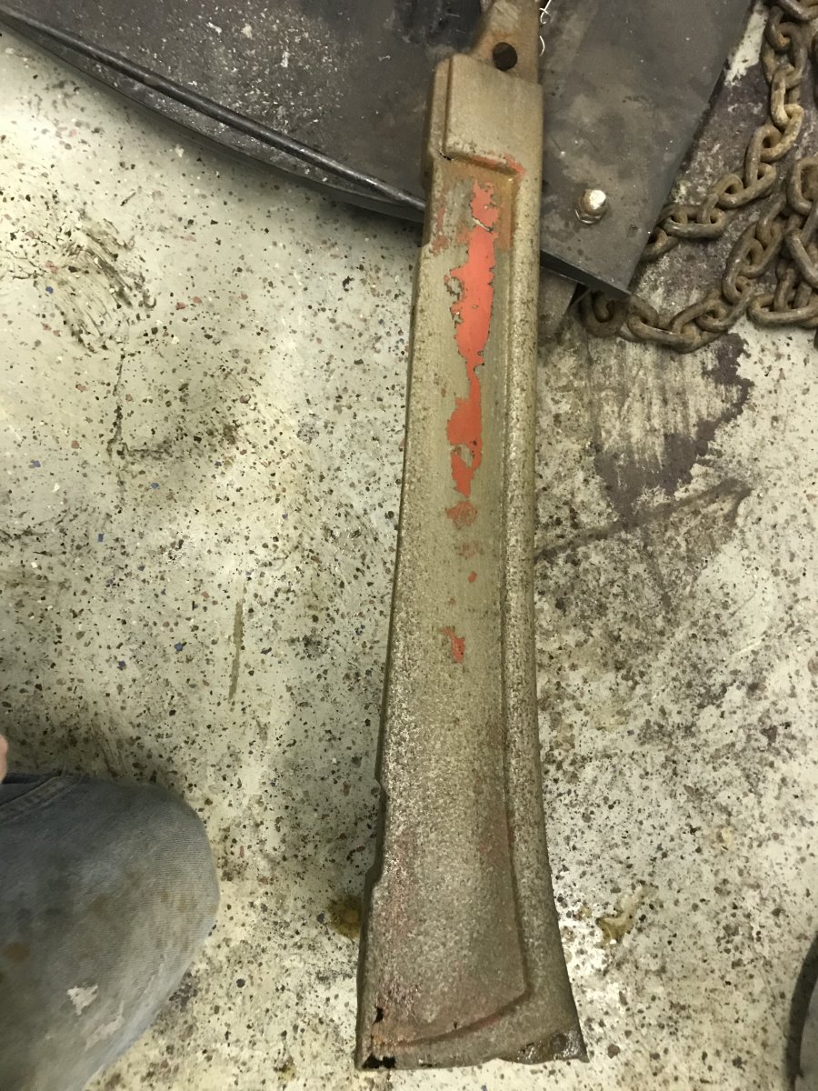

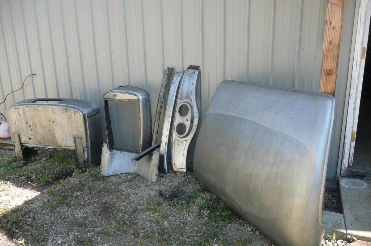

    Pulled the hood sides out and wire wheeled them with a drill. Ready to cut down hopefully tomorrow night. Doctor appointment for my foot tomorrow so fingers crossed that all is well with it and I can get back in high gear. Here is a running board that was left outside for years with only primer on it. Guess which end was in the barrel. C3822F8B-B780-4A3C-878C-9D553BEB8BC1.jpeg C91E2D45-5967-4F12-A40A-D77AED2E7286.jpeg 36DFF580-E6CF-4EA0-B201-1FC1F238EC99.jpeg

    Love that Citric acid - I used a 7% solution

    Well, the orthopedist cleared me to go ahead and do whatever I can tolerate. Spent 3 hours in the shop working on the hood sides. Unfortunately, my phone died, so no tutorial on wire edging them not using the bead roller. I will use the bead roller to finish them though after making a flat lower die. I also ran to town to buy a bunch of stuff before Chassis Engineering closes up shop for good, which sounds like end of this week, or early next week. I will likely be listing a bunch of stuff in the classifieds at a later date. I will try to get back to the pictures tomorrow.

  27. When you say 7% I assume that's by volume?
  28. justabeater37
    Joined: Jan 1, 2009
    Posts: 890
    justabeater37
    from Iowa
    I mixed mine 20 pounds of acid to 50 gallons of water. I don't remember what that ended up as percentage wise. I can try to find the chart again.

    Bottoms redone. Now to figure the tops out. 3A2F3399-34BB-4F65-8A8D-CCB34675030D.jpeg 96DEFF17-1285-4847-93FF-C3E669418EEB.jpeg 054B9A1A-142B-441F-9479-686AC926F504.jpeg
