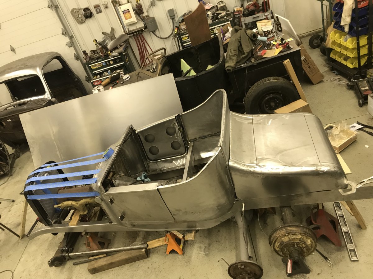

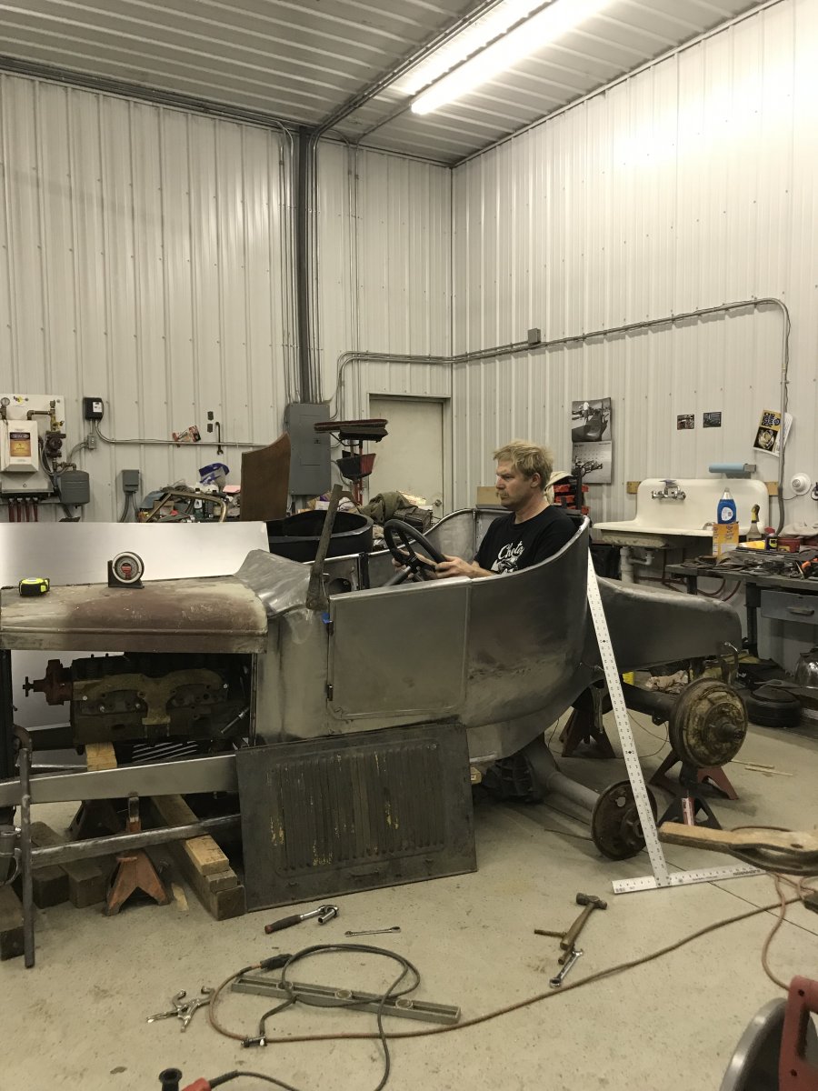

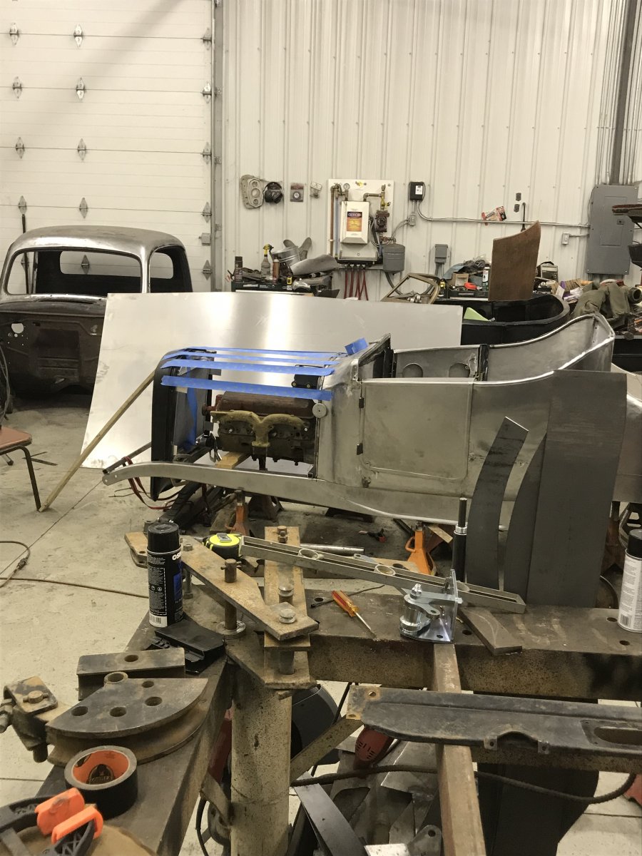

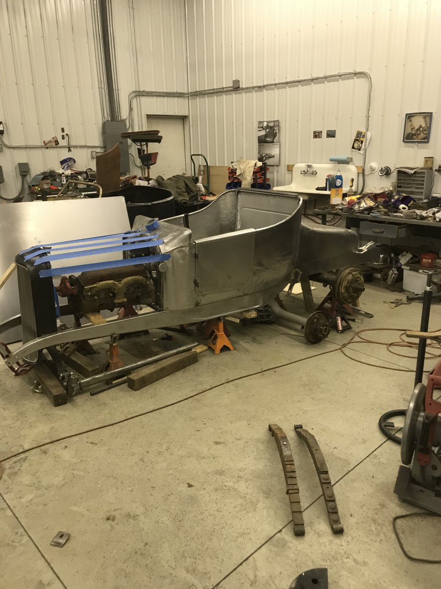

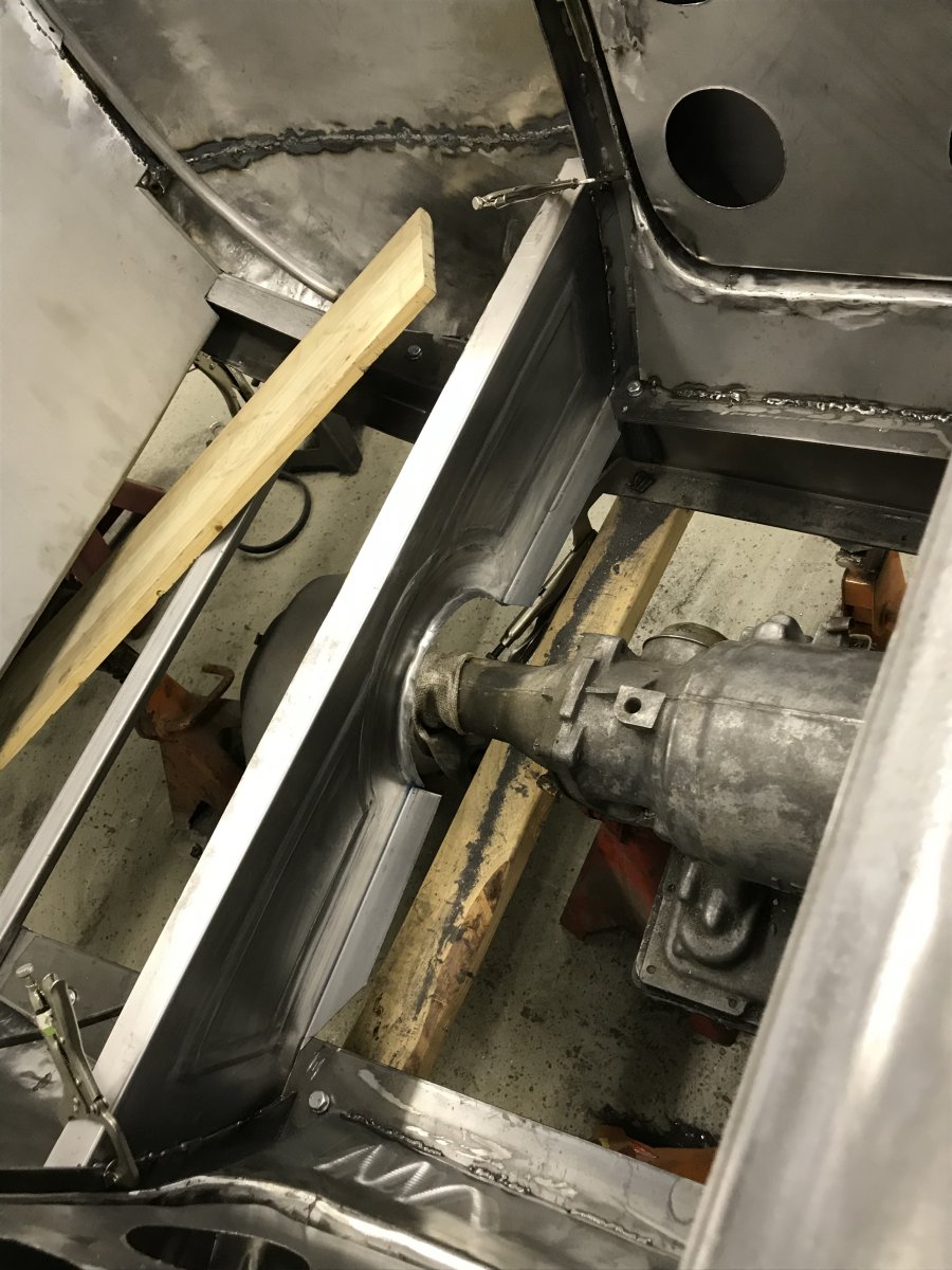

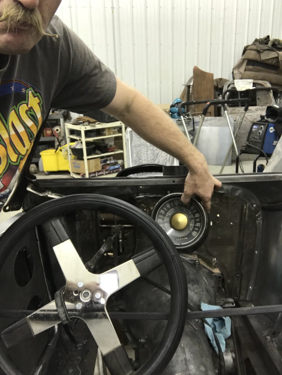

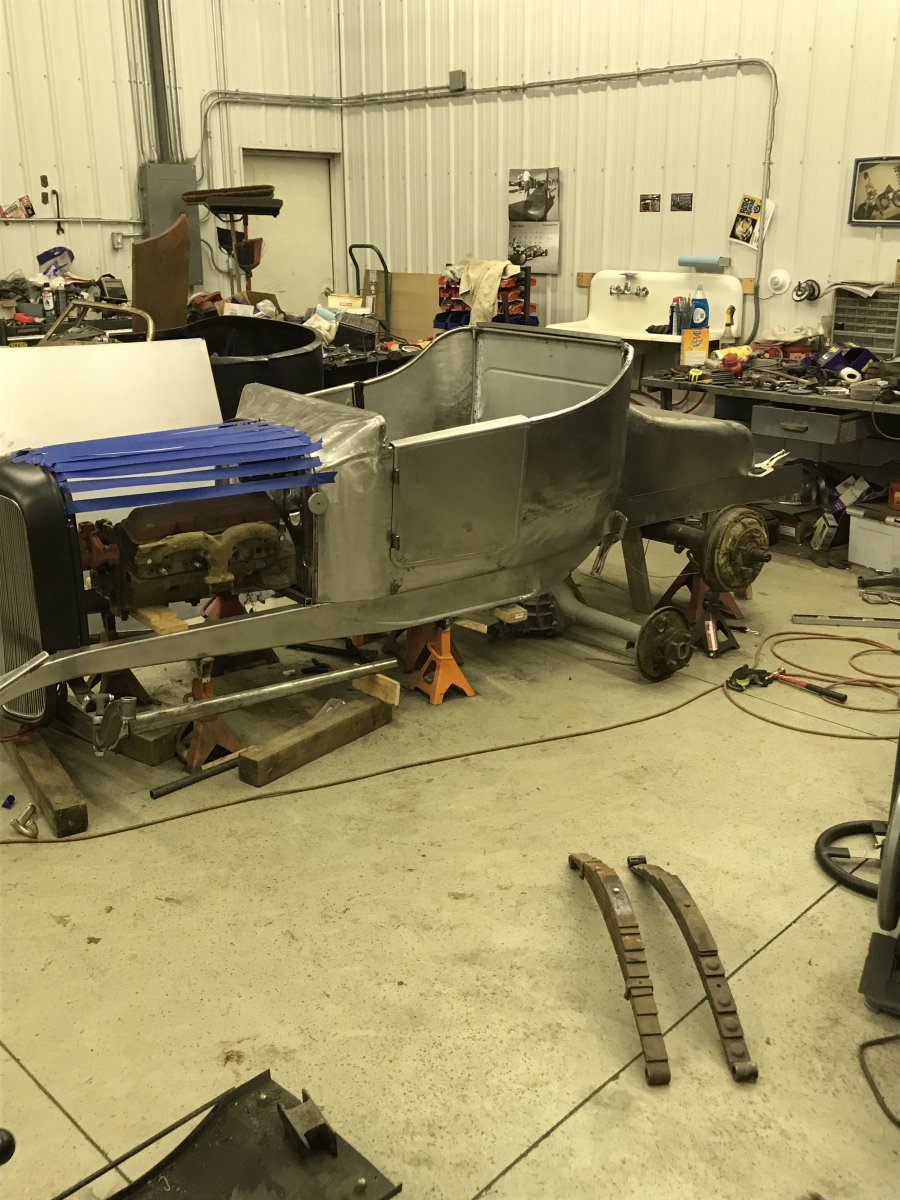

    Hate the firewall mounted master cylinder but there is just isn’t much room for anything in this thing. Remade the front of the seat pan to clear the trans. The engine/trans may be able to drop a little but not much. Lowered the grille a half inch as I found a shorter radiator. Maybe I can get the chassis a little more together this weekend. Also a picture of he approximate driving position. F3FFABDC-6BA0-45B3-AF18-1B031B5EE033.jpeg 47D44687-6F53-45F3-8181-DAB5FF7AE912.jpeg 5F1B7E04-34E1-4CF2-8044-A06BA2062BDB.jpeg F945D199-959B-43BA-AFD4-B38F44C6DFD0.jpeg C19F67EB-9D25-42DF-9FB2-81EA9978B42A.jpeg C4DCEC24-648F-44FA-B578-05834CE2F82D.jpeg

  3. Dick Stevens
    Joined: Aug 7, 2012
    Posts: 4,044
    Dick Stevens
    That grille shell does need to come down to look right, needs to be lower than the cowl! Great metal work and you want to make sure that doesn't detract from the rest of your hard work.

    It runs down hill to the shell now. The driving position picture has a model A hood laying on it just for a length reference that day. As I am building this roadster to ultimately give it away for charity, budget is a concern. I need to use as many off the shelf parts as possible and a custom radiator would dig deep into the budget.

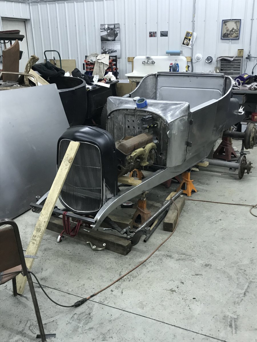

  5. justabeater37
    Joined: Jan 1, 2009
    Posts: 1,806
    justabeater37

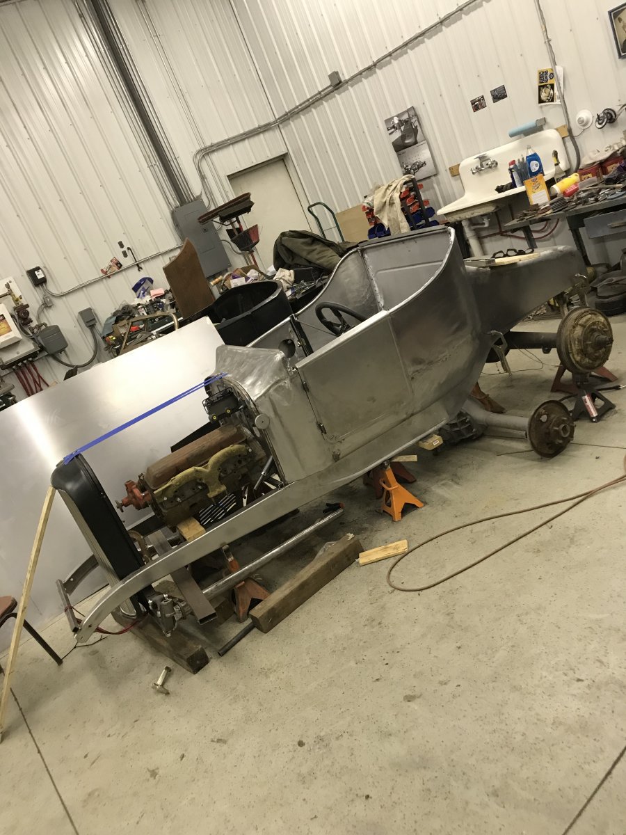

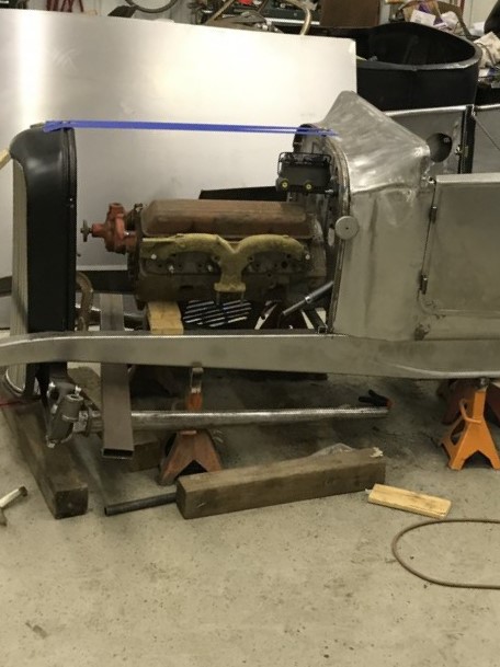

    This may be a better picture after lowering the grille. I may be able to take a little more out yet, and it definitely needs to get chopped. C3C04765-938E-4B48-B672-D8A67668F161.jpeg

    A few of the pictures I saved for inspiration. These kind of show how hard it is to get around the optical illusion of the hood line running uphill If I could find a radiator around 20” high that would fit the grille shell it would make life a lot easier. Any suggestions? Inexpesively . 5D41A477-FF8D-4EF3-81D5-C285A00E3B8F.png 9AF855C9-67FA-47AF-B13F-E5101A7B0BA1.png 4BB3B7DF-73C4-44BD-9EEF-BBAA7E5DAEAC.png

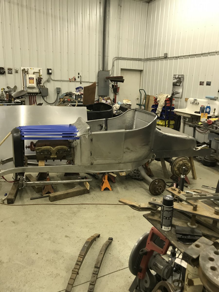

    Long day at work and I didn’t feel like messing with it much tonight. So I just bent up the pieces for under the turtle deck to start fitting them and taping up the hood line a little better. The grille is actually 3/4” lower than the cowl. I think the angle on the doors magnifies the running uphill look. Ride height will be 2” lower than where it’s at right now. That’s as low as my jack stands would let me mock everything up. The banjo needs to make way for the 8”. If I was keeping this car, the banjo would stay. BBE5431C-C920-446D-BFF6-311623AD50AD.jpeg 31DB0703-09FC-4664-A37B-AC078EE455DE.jpeg A8DE217F-506F-4436-89AC-33BE70C95210.jpeg 63848DC6-78B9-4493-B18F-2544F80D96BC.jpeg
  12. Dick Stevens
    Joined: Aug 7, 2012
    Posts: 4,044
    Dick Stevens
    Good on you for doing this for charity, that definitely affects decisions on parts usage for financial reasons! To my eyes it looks like the grille shell would look better if it was at least another inch lower, but I fully understand why you are doing it the way you are doing it.

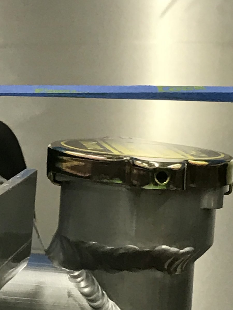

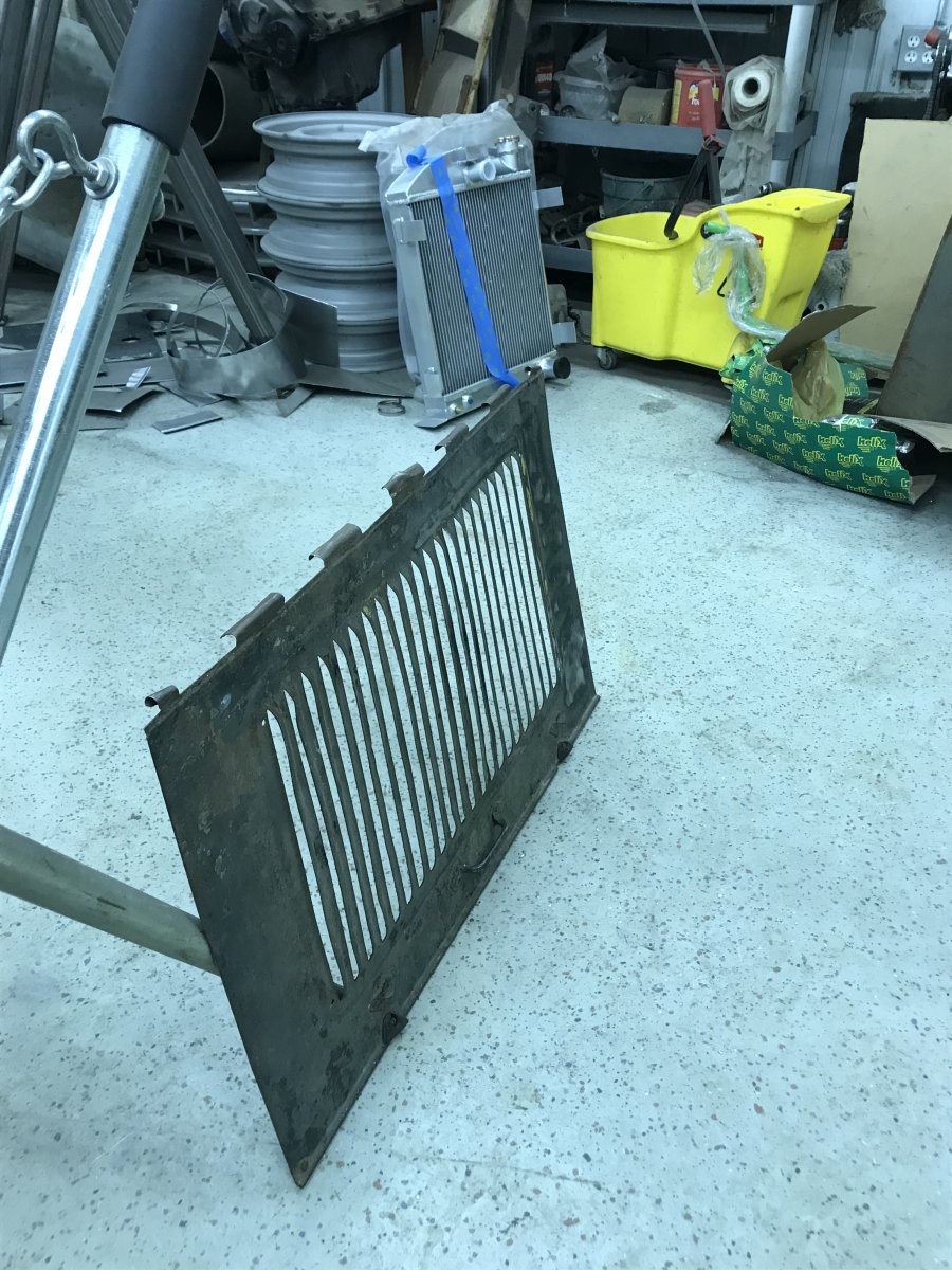

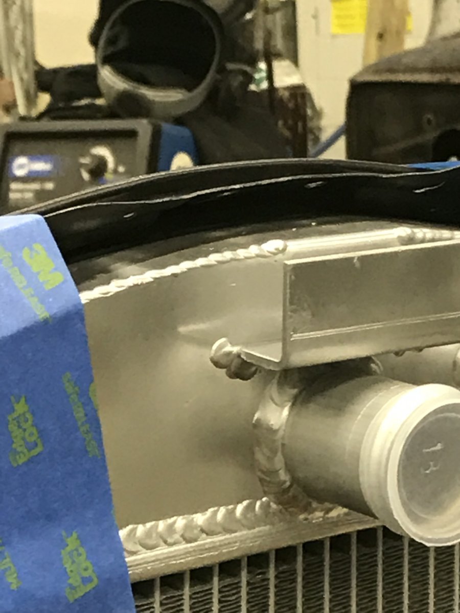

    Here is the end of the story on the grille placement. This is the shortest radiator I could find. There is no more I can do to lower it anymore. I have modified the crossmember as much as I can to get the radiator as low as possible. There just isn’t anymore room short of a custom radiator. 0140CBA5-FA9B-43DA-8CDA-52870FB8DE46.jpeg 47D3A7B6-2CAC-4FC3-8DB6-98CA22324E2B.jpeg DE64ACB4-8AE4-4491-8C8D-34B8F939883C.jpeg 76E9211A-5E9A-40B8-93A5-10A94DF9BD99.jpeg 676A12C3-8E8E-404D-980C-B20C26E17247.jpeg

    4 1/2” out of the grille makes much better proportions on the T. Cheated and used a Speedway insert already chopped saves time 5A6FCD50-396D-420C-A898-85396B041C16.jpeg 6E6B2DBB-1848-4C43-9CAF-875018109B01.jpeg

    I was searching EBAY looking for small radiator for my Dad's Modified project. Check out some of the tuner cars Fabbed aluminum radiators.....As an example the Acura/Civic 50mm (3 core radiator). Overall height is 18.1 inches, width and 14.7. The three core is only $65....A lot less for a 2 core. Inlet/outlet are correct for SBC. If the motor is mild it might be enough...

    All I could find were 1 1/4 hoses. I will keep looking but likely going to run the radiator I have as it’s here and paid for Thanks for the tip for future reference.

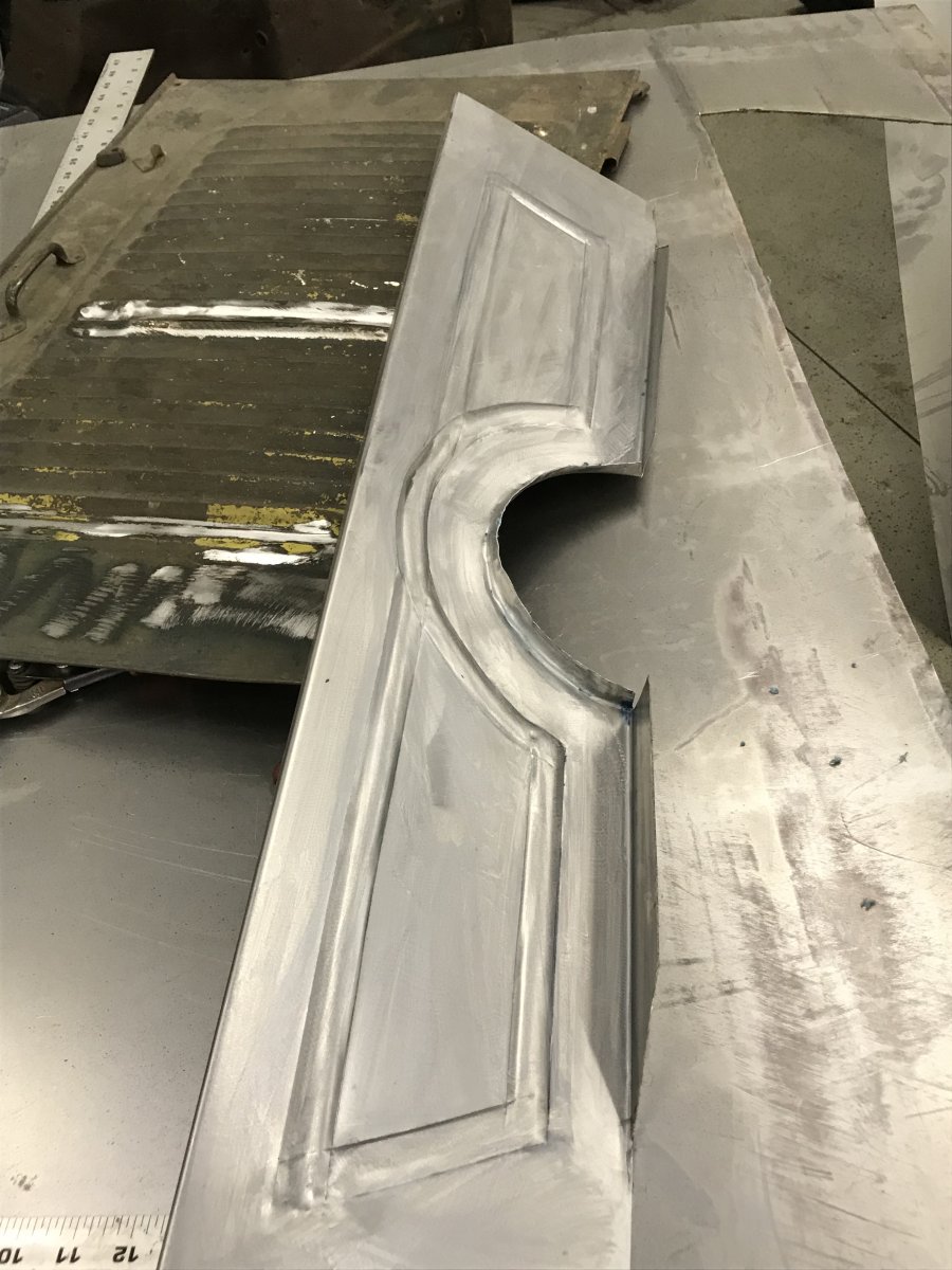

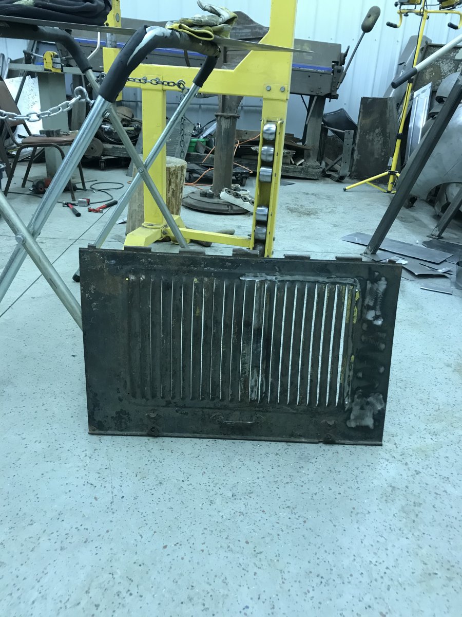

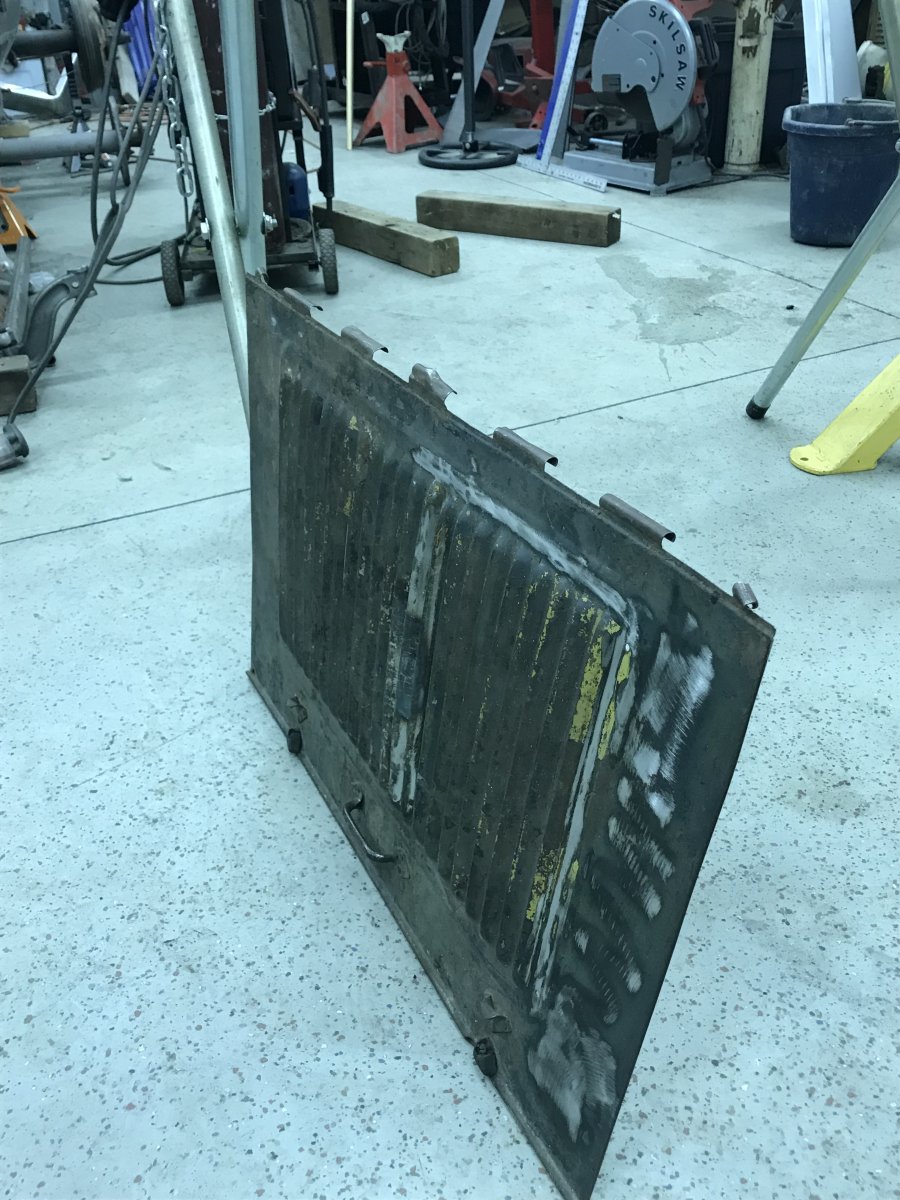

    I forgot the before pictures, but spent a little time today straightening some model A hood louvers to cut down for hood sides. Not perfect, but way cheaper than another set of hood sides. EBC5A1EC-1AD1-4445-B281-B26C71DE1E5D.jpeg 759BA8A1-103F-4959-8D4B-A7D43066B48C.jpeg A766E01F-0AB2-4267-9BBE-9BAEE4E03883.jpeg

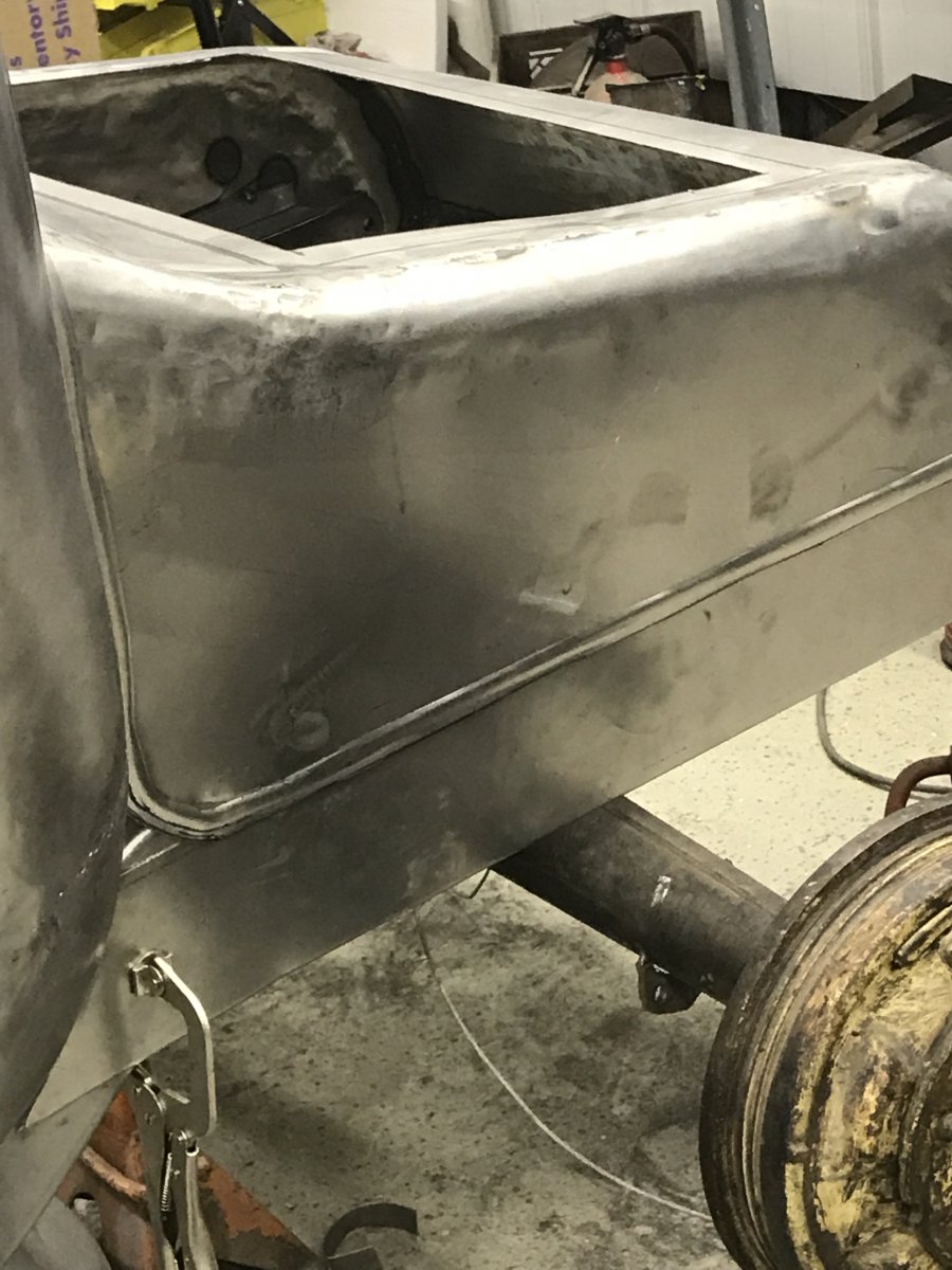

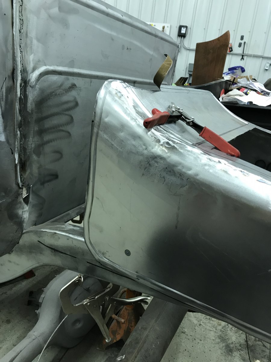

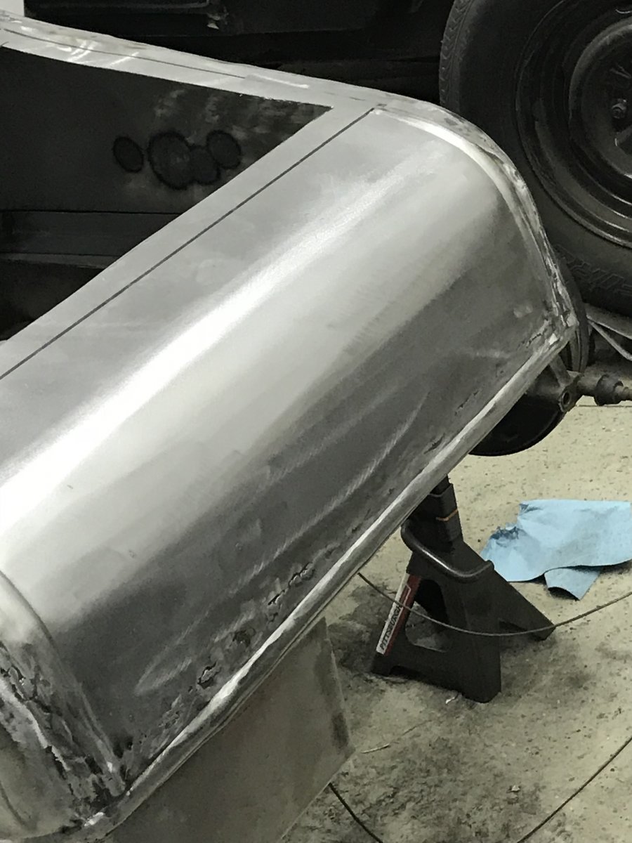

    Also spent some time rolling a bead around the turtle deck like was stock. Now I have to fix the rest. F4C7995C-5ABF-49A6-859E-3684A48A5A9B.jpeg

    Not much for progress but finished up getting the bead around the Turtledeck B5203E7A-7BD9-408F-9FE9-3B4BAC358886.jpeg 7AF2D0FB-56B1-4977-9C02-2A17C39E0938.jpeg . I wish I would’ve decided to do this in the beginning instead of after the fact. The fiberglass body did not have that bead, but if it’s going to be steel it may as will be closer to stock right?

    Thanks, I need to get my welding skills better so I can end up with a nicer end product. I am thinking of taking some classes next year to try to figure out the errors in my ways.
