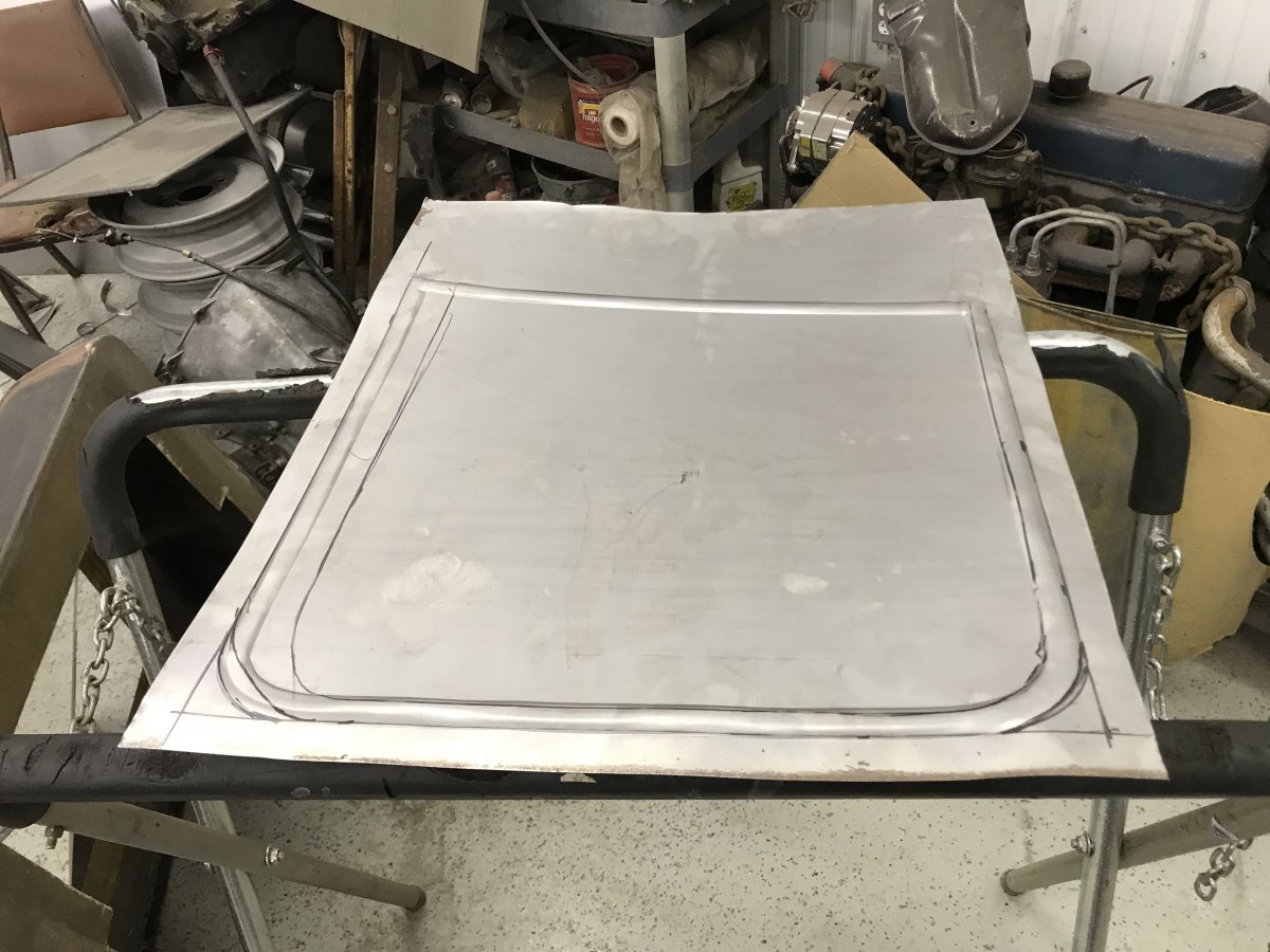

  1. Man, you work a lot quicker than I do. Is the back panel from Howells? I've been debating buying one myself to save time making it since it is available and already has the beads in it. $75 isn't too bad if it fits and looks like it fits pretty well.

    It came from Ecklers/Macs via eBay as I had a coupon.

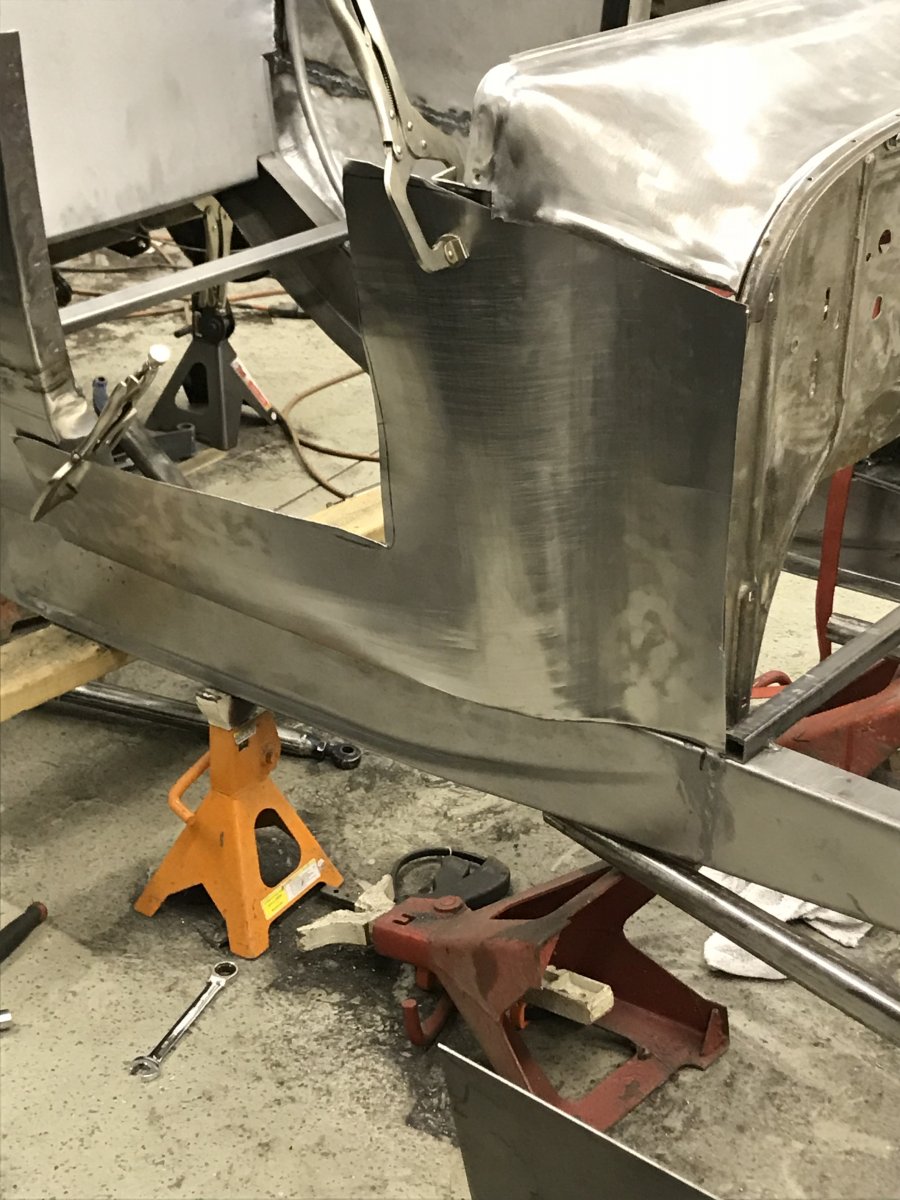

    It would have been one of the easier panels to make though. These cowl sides are beating me up. I think I was trying to hard to get them done and got in a hurry. I may just start over if I can’t get them sorted out.

  4. That is a tough piece. I wimped out and bought a repop driver side panel and cut off the cowl side area. It needs a decent amount of work but it helped tremendously. I found a really nice original piece for the passenger side on eBay a couple years ago. BTW, if you can use the false door section from that panel, it's yours. May just knock out the rear panel here then I could form the bead by hand if need be.

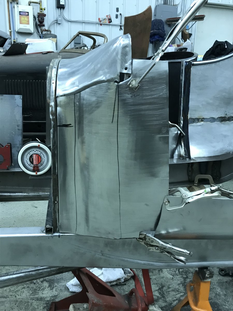

    10D9AF04-672B-40DC-A61A-3E1D7F3B3776.jpeg C0B179B3-4E11-4F66-9374-F644034710C9.jpeg C6F32CE4-064F-4EB9-81DE-FBD88F80A521.jpeg Slow progress is better than no progress. Have to make the rocker panel a separate piece and fix the spot where I cut too much off, but oh well. On to the other side.

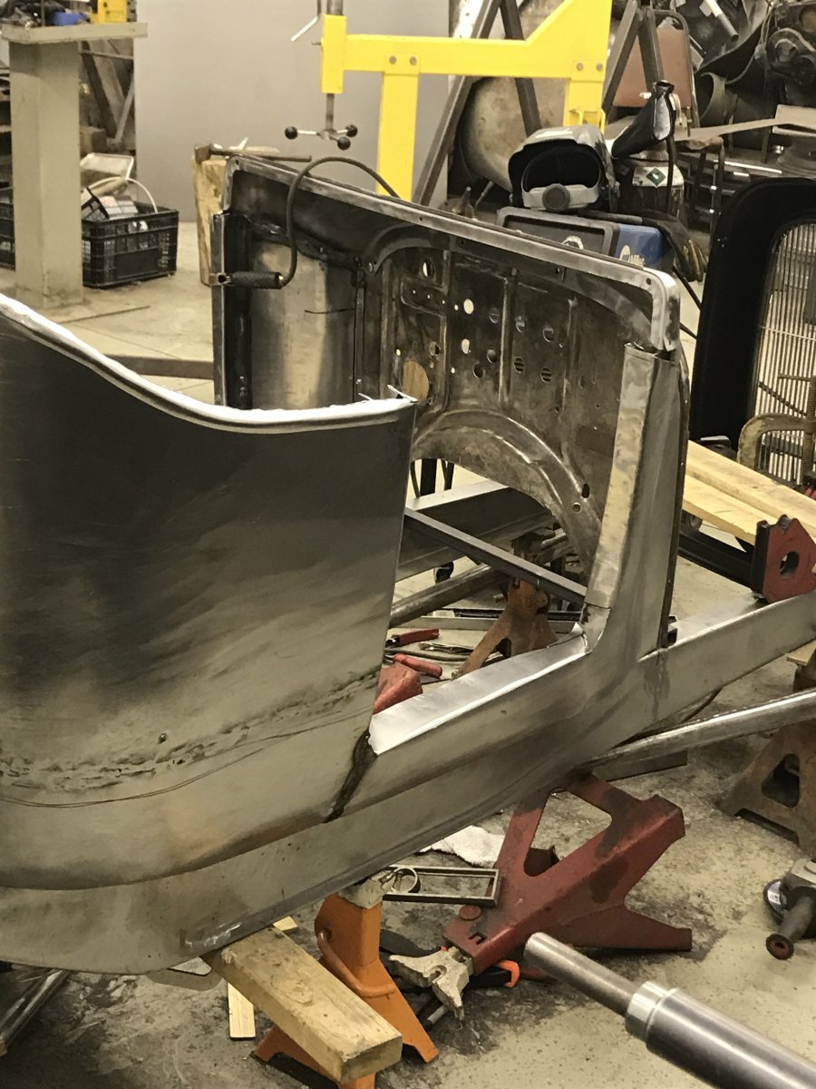

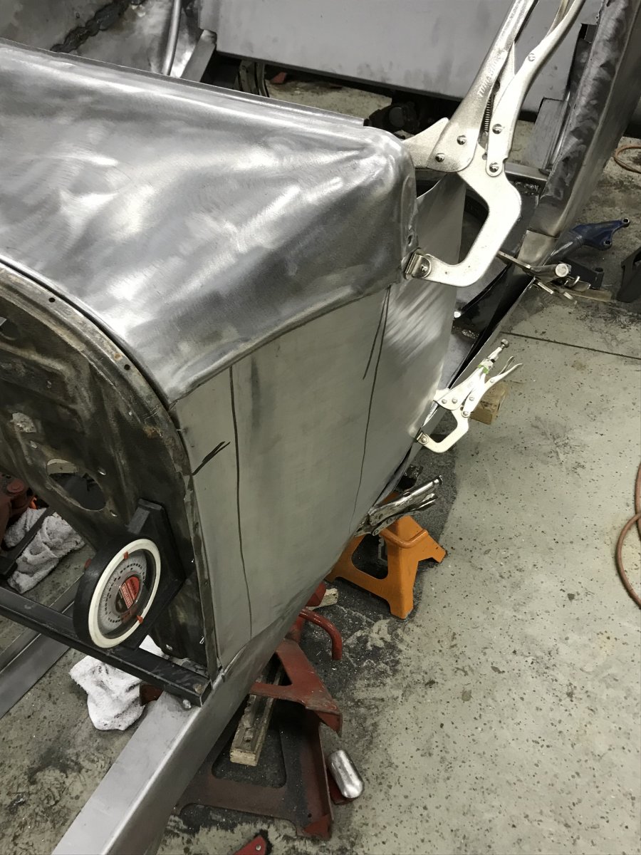

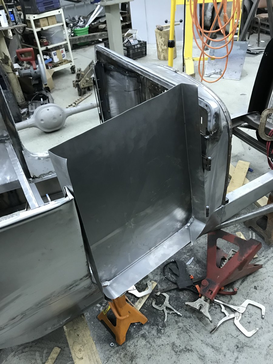

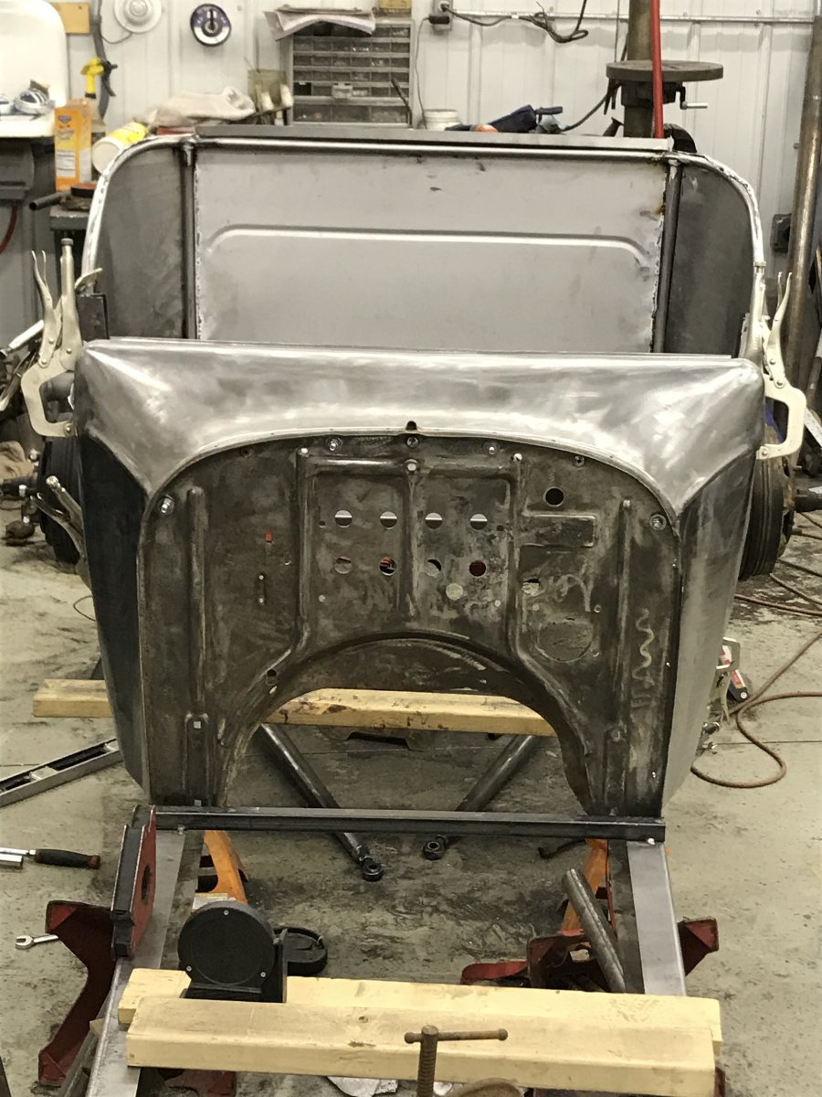

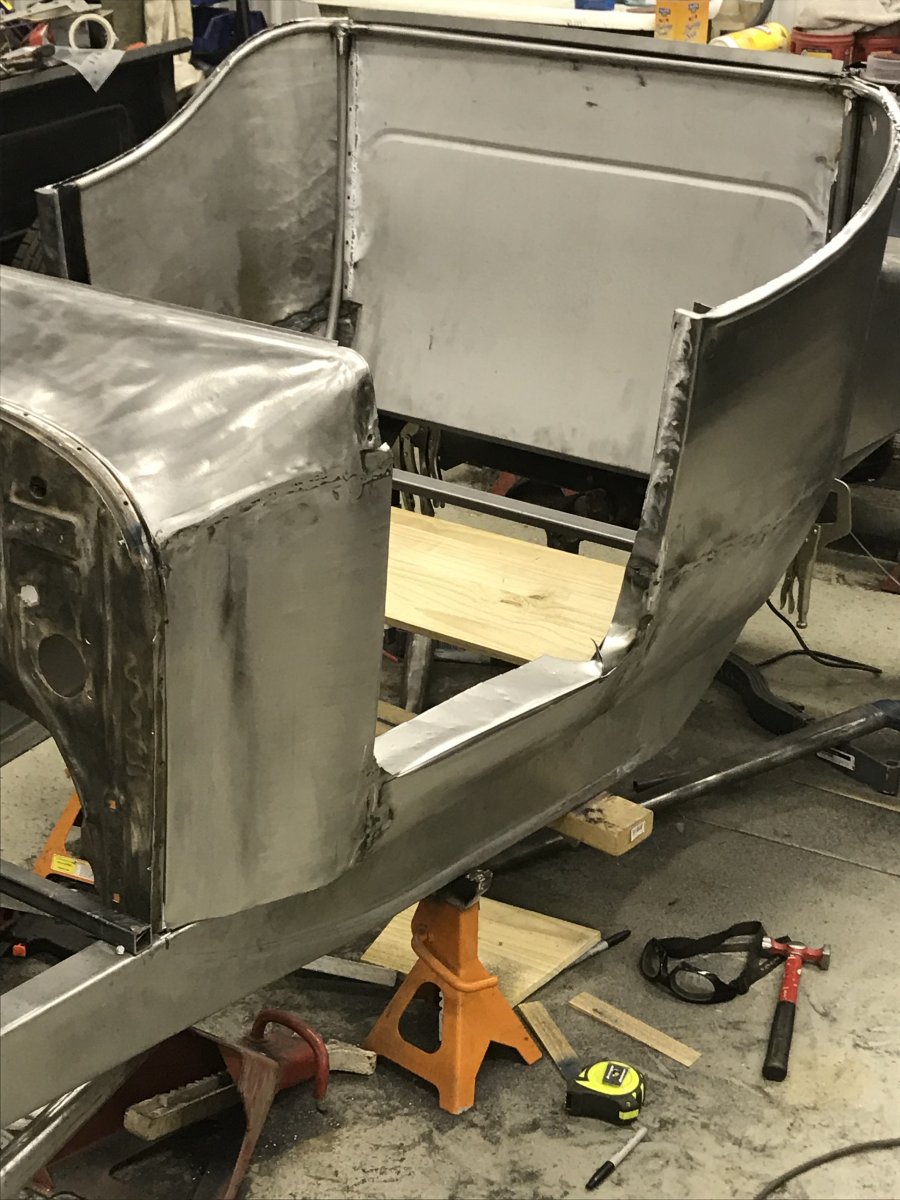

    And some days it’s just dumb luck. I made two panels for the driver side still not happy with the second one being as it had to be two pieces. And then come out this evening and within a half hour the passenger side fell into place.Now mind you, I still have to fold the flange at the firewall and finish the shape there. But for a half hour I’ll take this panel. C5CC5C25-3B61-484C-A58B-B6442090BD21.jpeg 32F62EA6-8967-4211-AB32-4789B1E860CC.jpeg

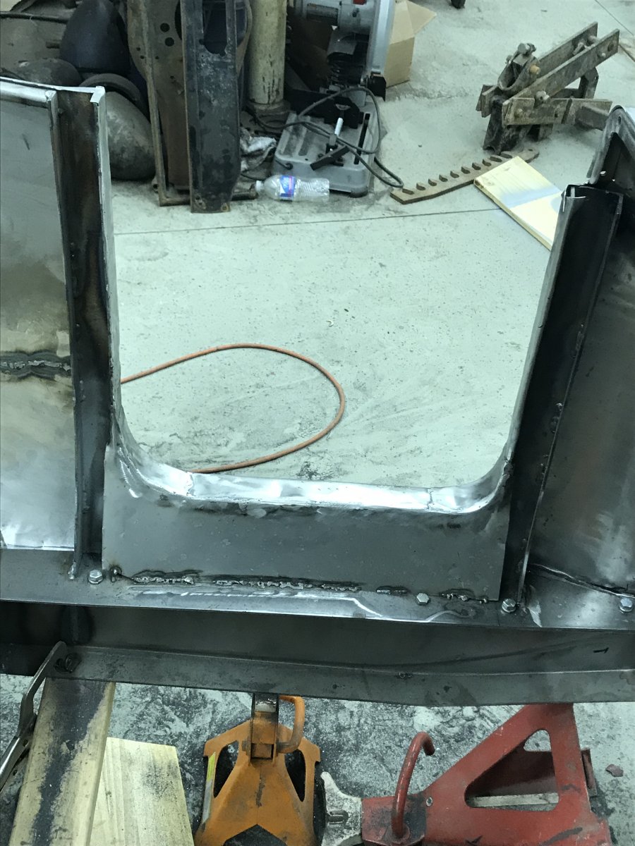

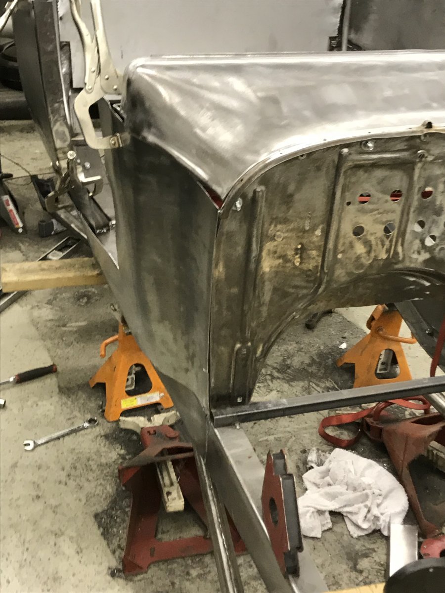

    E556B8CC-B6E2-404D-A197-4127AC34BEBB.jpeg And where I ended the night.

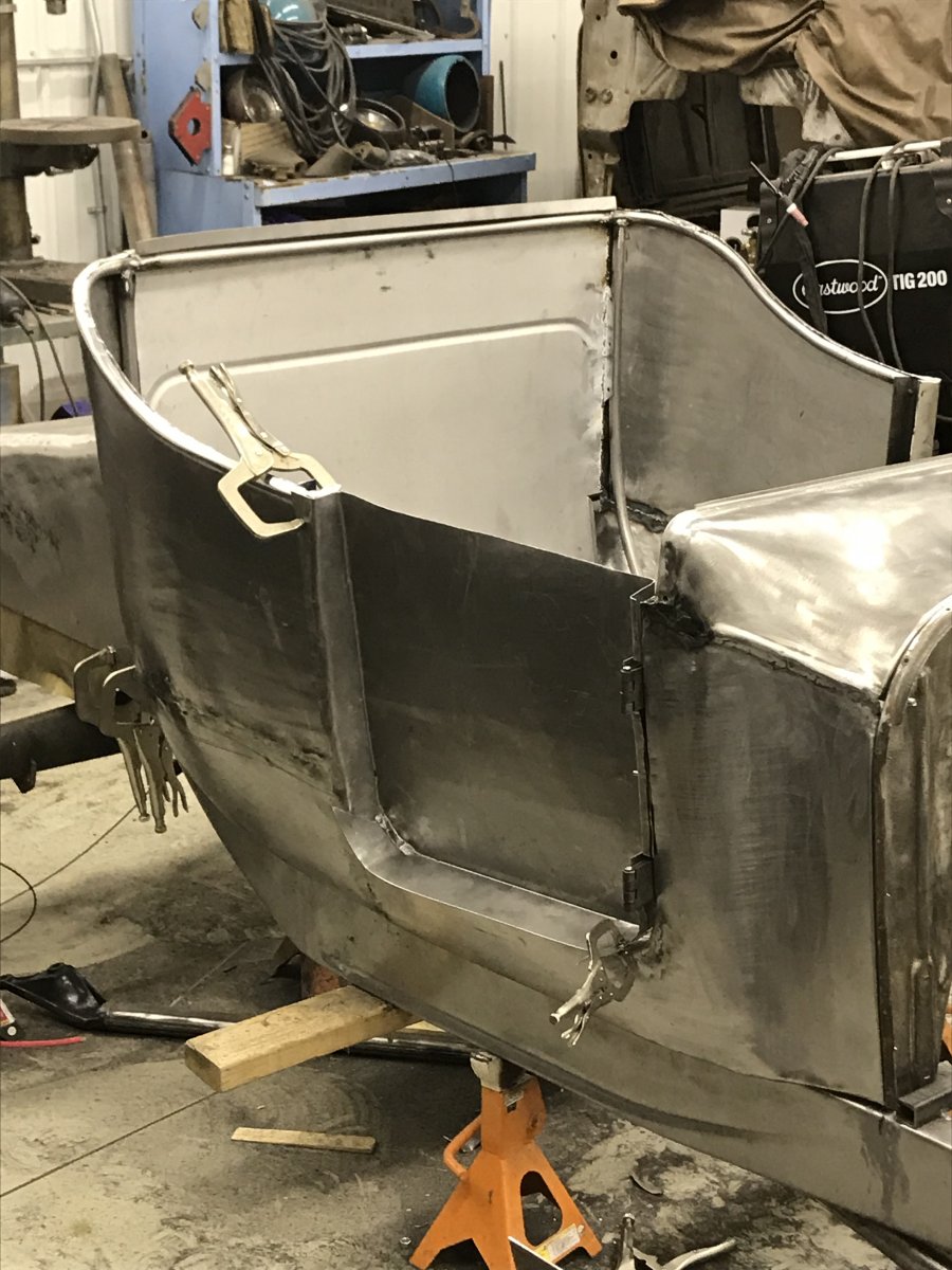

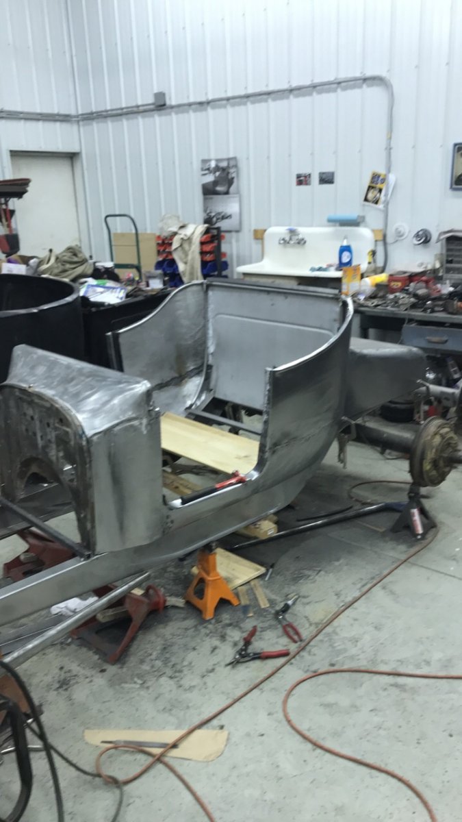

    Made a little progress. Work thinks I need to work 8 hours a day. I only signed on for six. Kind of limiting my shop time lately. 1067121B-997A-4640-AB71-ED251CF24007.jpeg 8FC81816-642F-4374-9BDA-5524D7EB8810.jpeg C3364FC5-E7A3-4DDB-A1A9-FC7636E755F8.jpeg E739D4F8-F577-41E8-BEB2-FE81F6E58ED7.jpeg DA5108D8-3672-4ACF-8EF8-D74952FB1DF3.jpeg

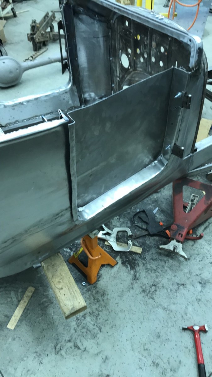

    A little progress on the jambs to get ready to build doors. Going with mini bear claw latches for a secure closure. Hope to be on the doors this Sunday. 155625AA-E3C0-4CA8-817B-4F8B94379895.jpeg AD6183BC-39B7-45DA-A17F-C00758571707.jpeg 22CE0150-639D-4F7A-A7AC-DAC35C5E5EF9.jpeg

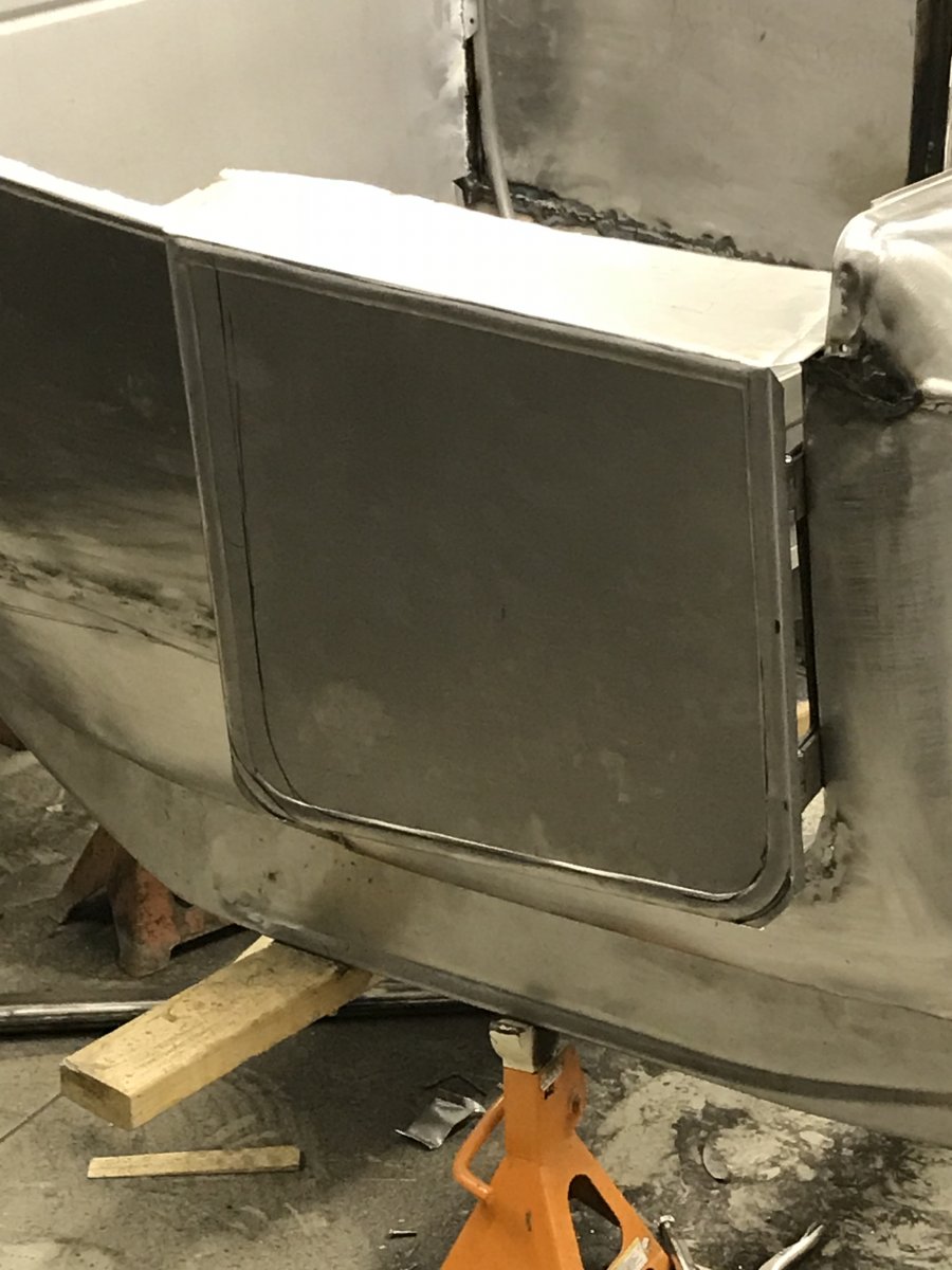

    Made a little progress on the passenger door today. There needs to be more hours in the day. I only got about 5 hours in the shop today. Finished welding the rockers, made a heel board for the seat to tie the bucket together good and solid before starting the doors. 43602AC8-A146-4C2F-B571-4C93F2519540.jpeg 306B8FB7-9906-4510-969B-913F9DC8CC84.jpeg EFD526C4-E75E-42D7-9956-B411641F8F4D.jpeg 4C3CDD82-3F79-415F-9C49-A7DE963C9DEA.jpeg

    Need to get the latch in, then time to make these two into a door 4C6BBA92-8EDB-48E3-B3B0-066EC72555D0.jpeg 69C402FE-781C-4760-8307-D977A599F6F8.jpeg 484A8769-CBA9-464F-92A5-AF03F2D4266D.jpeg D5690A7A-44E5-4F47-883C-A900FEE70966.jpeg 508A3C1B-F435-403C-820F-7F4396049063.jpeg
