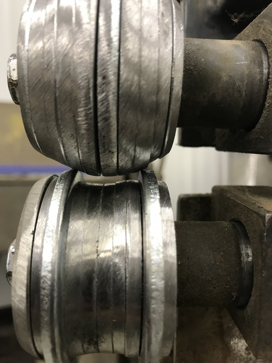

    The bead roller die. Ha. It has some 7/8,3/4 and 5/8 washers. All I did was reamed the smaller washers out to the larger diameter to fit the shaft. Then I jerryrigged it up onto the drillpress. Ground to perfection with angle grinder while spinning in the drillpress. Not exactly OSHA approved, but functional

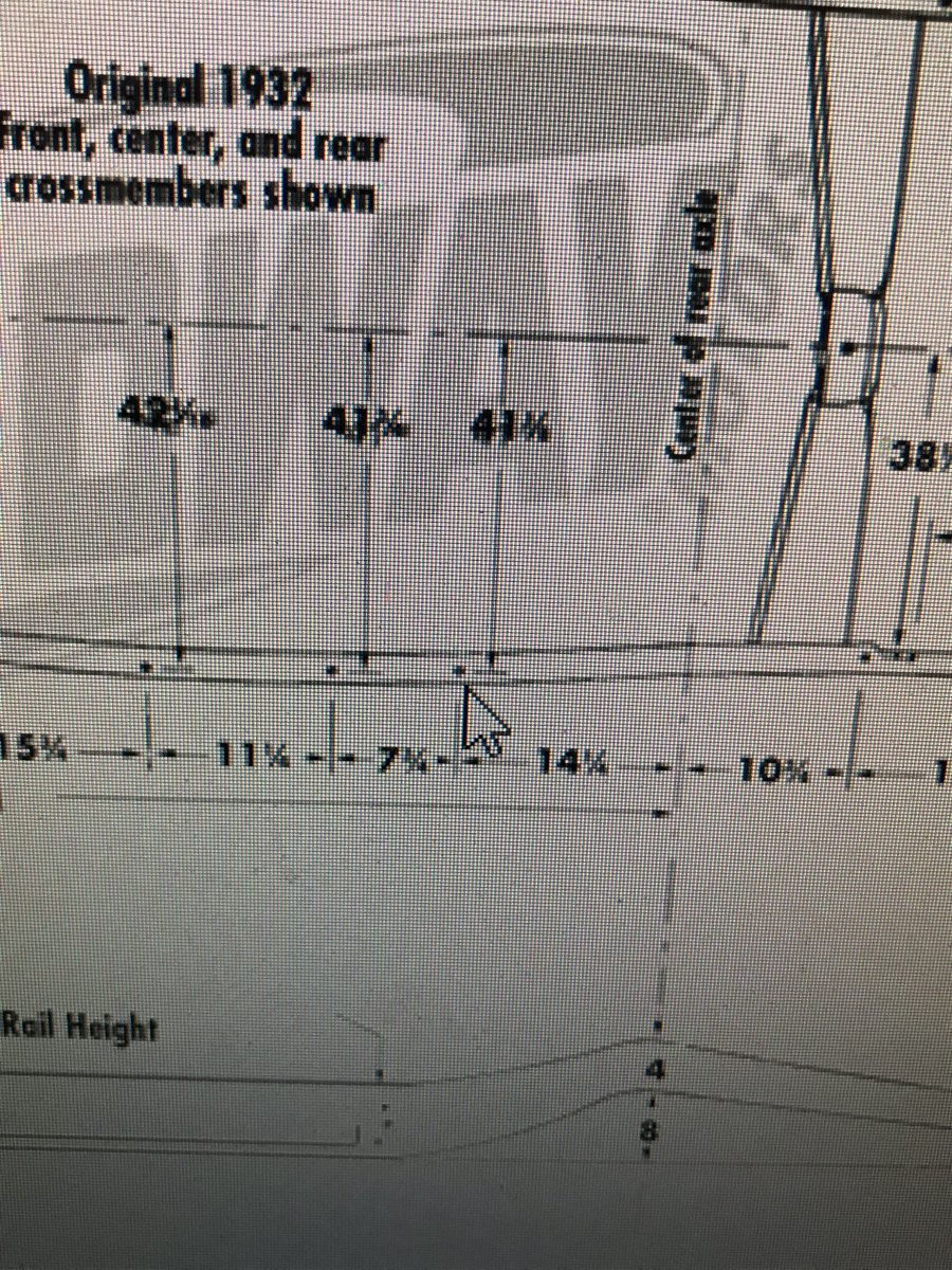

    The frame is 22 1/4” out of the middle, 1” v notch marked 3-4”ahead of the rear body mount hole in the kick up. Rear horns pulled in with relief cut at front of turtle deck, rails laid out to 27 1/4” at the firewall which puts about 20 1/2” between them at the front crossmember.

    108E6D9A-333B-431D-AFD4-59C92E93C24F.jpeg Steal away. 3/4 x .065wall is what I used. It can be bent with a conduit bender or over your knee. And the rear kick up in the frame is just a V notch 1" on the top rail measured from 3-4" in front of the rear body hole on the kick up of the 32 rails.

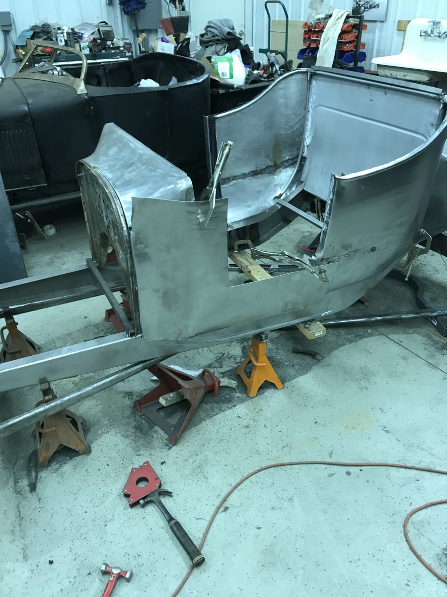

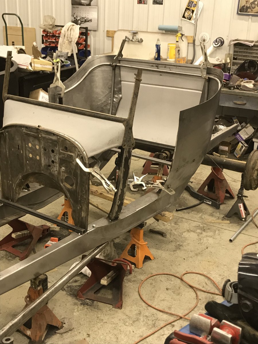

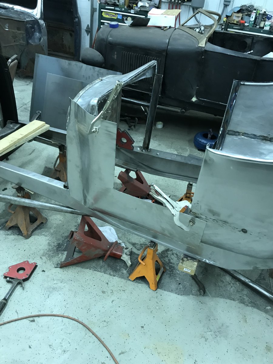

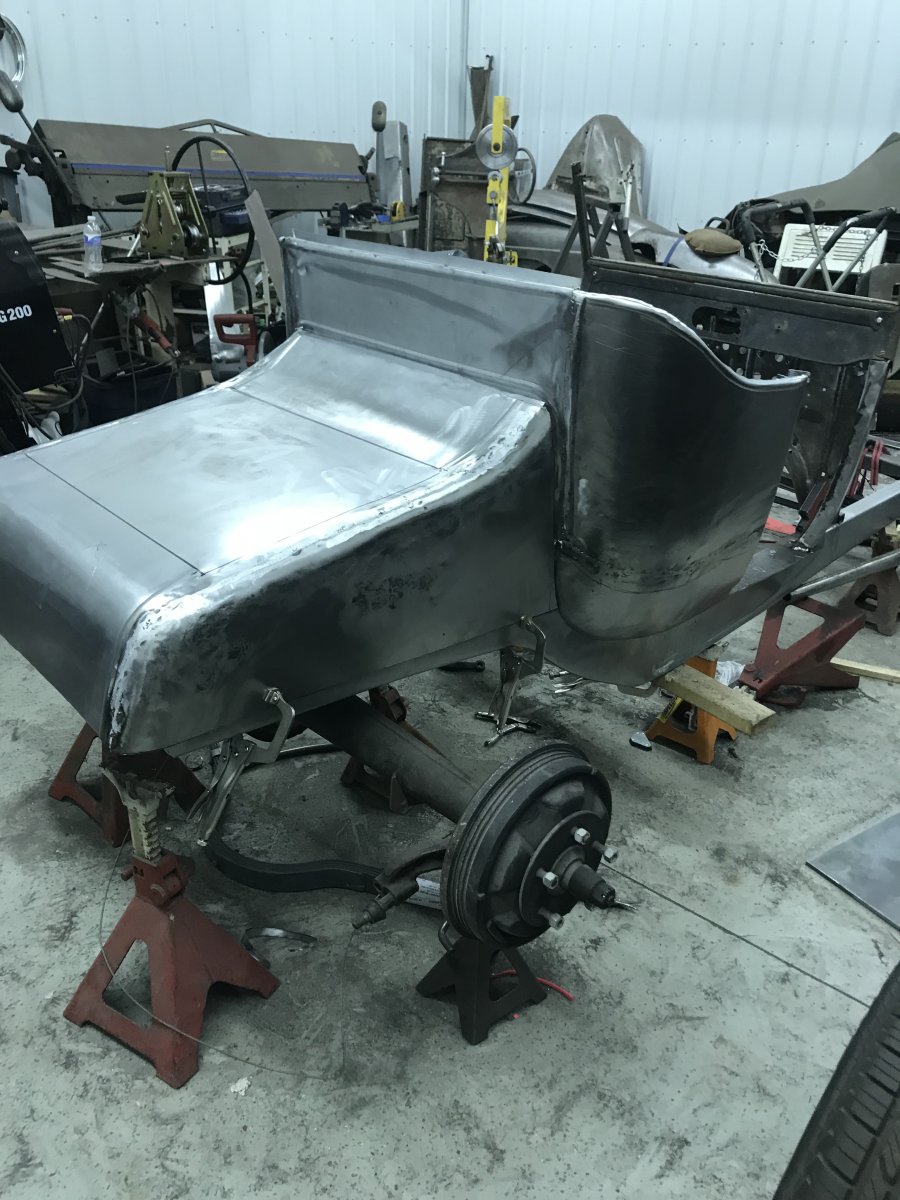

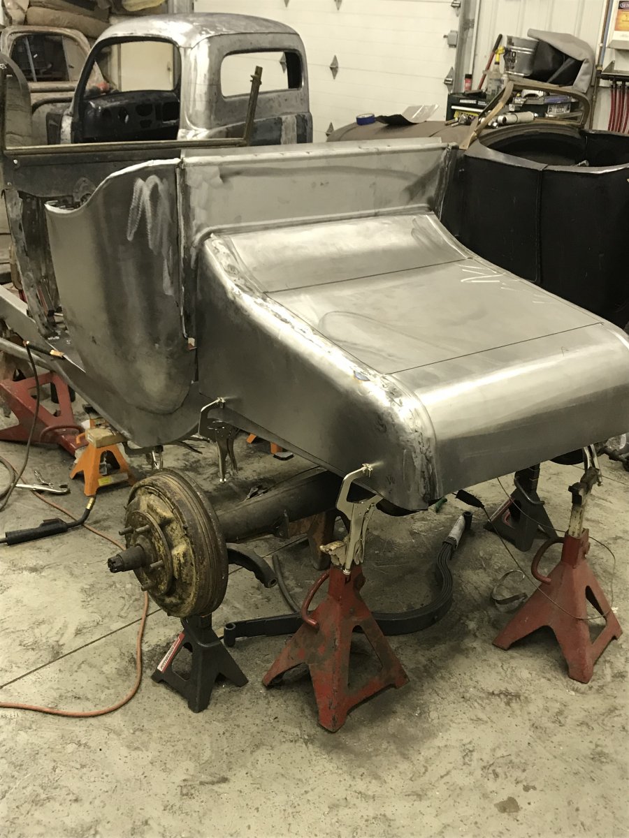

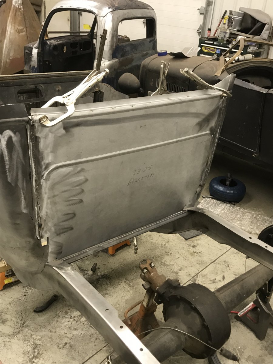

    So after moving the door posts, a little head scratching, rolling a few beads, and some welding, here is where today ended 544522EB-5E4D-4F98-A68C-B9DA7A33DA0F.jpeg 173C16D8-0FF0-436D-AF28-F9EAD9ED2EB3.jpeg E9FD2725-9B39-45C0-9E01-29B616A232E5.jpeg

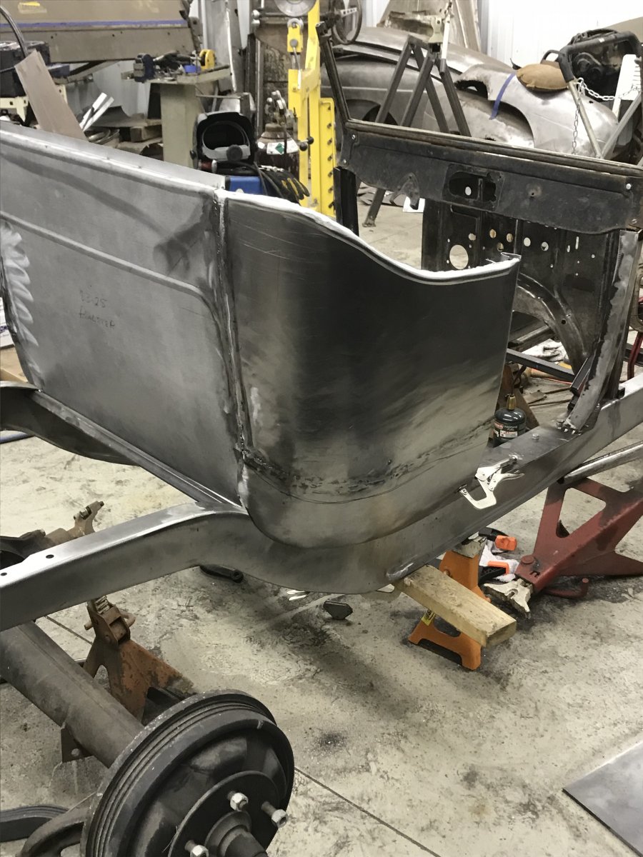

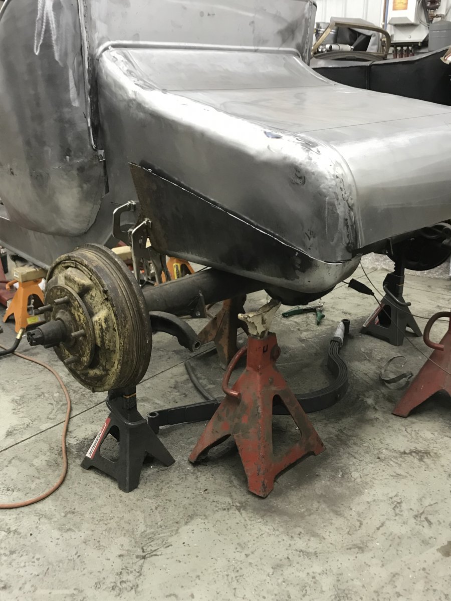

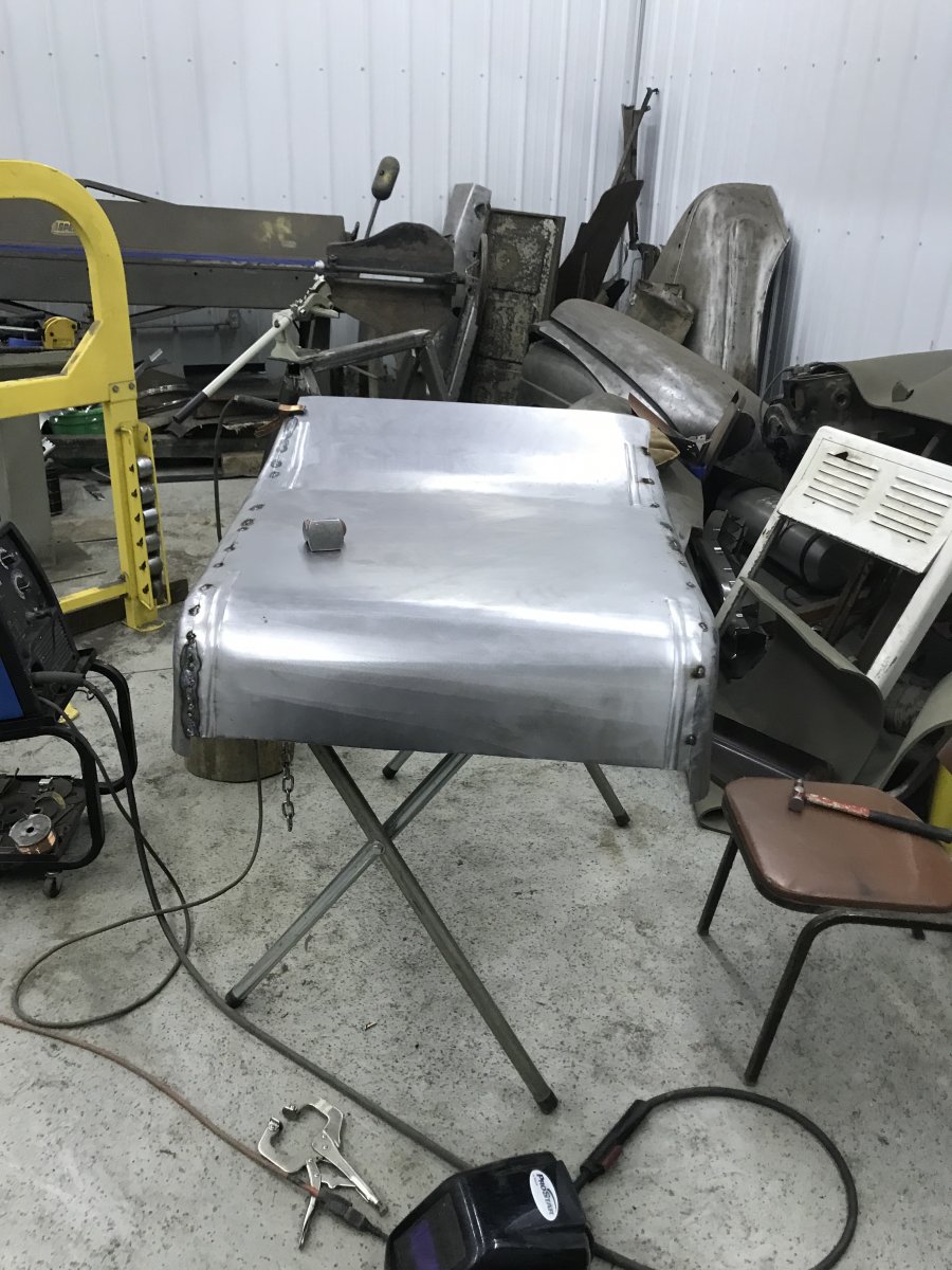

    Ok I lied. A little more work to the turtle deck. 781F75C3-30C0-44F1-9410-47EB60C08B8B.jpeg 67C9DAA6-1AC3-4499-BD50-C13ECFB4465E.jpeg 8B6F617D-AB6E-4D19-928D-1818177A8B48.jpeg

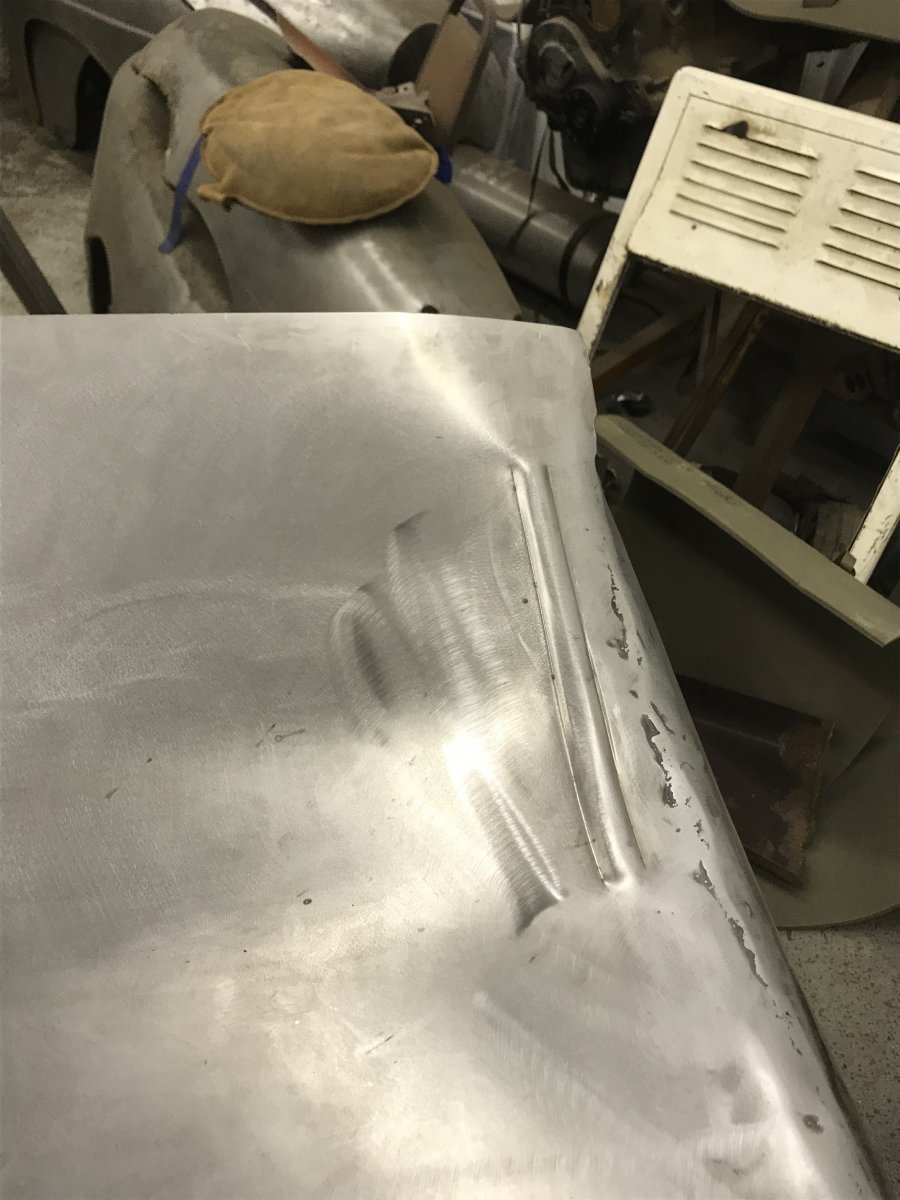

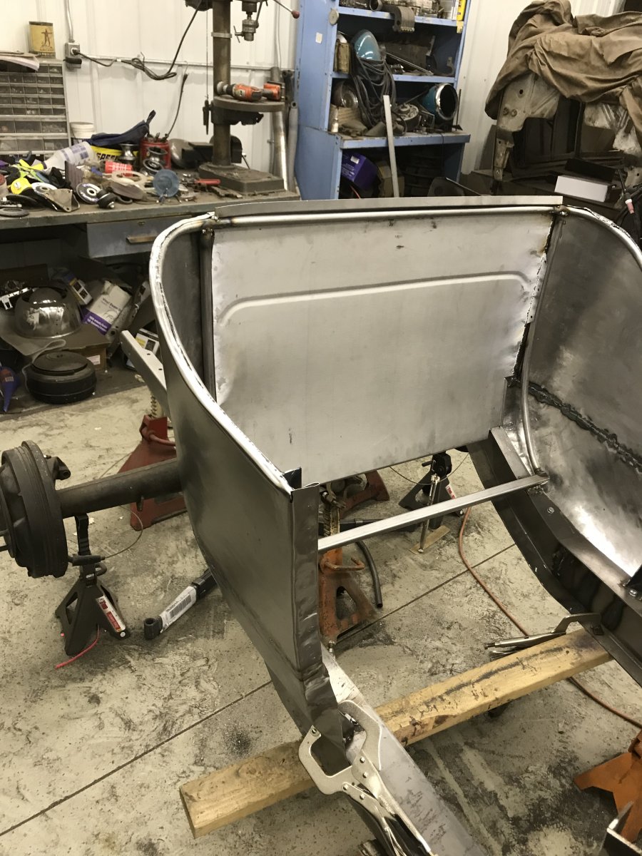

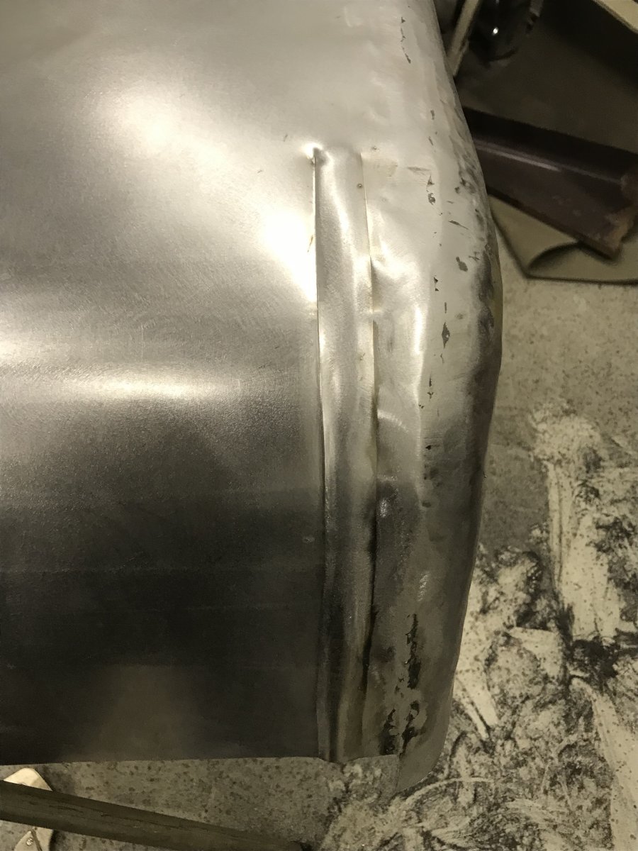

    D72578EB-0300-42E4-A5B6-4B11276D30F4.jpeg FE24BD25-9AA5-43C1-918B-5D7467AE56F1.jpeg Kind of embarrassing that this is all that I got done this weekend. Too much running around chasing parts fixing daily drivers and farm trucks to give much time in the shop. Got to make another parts run tomorrow but I have the next couple of days off of work. This part is turning out to be harder than I thought it would be.

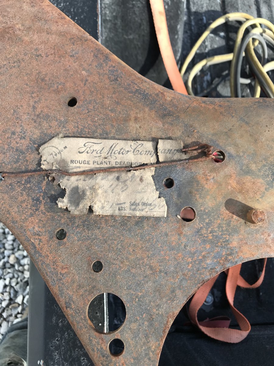

    But on the parts run note, when was the last time you bought any 6D7284E4-6E32-4539-B377-2F2603AEFC88.jpeg 32 Ford parts that have never been installed? Still has the tag from the Rouge on it.
