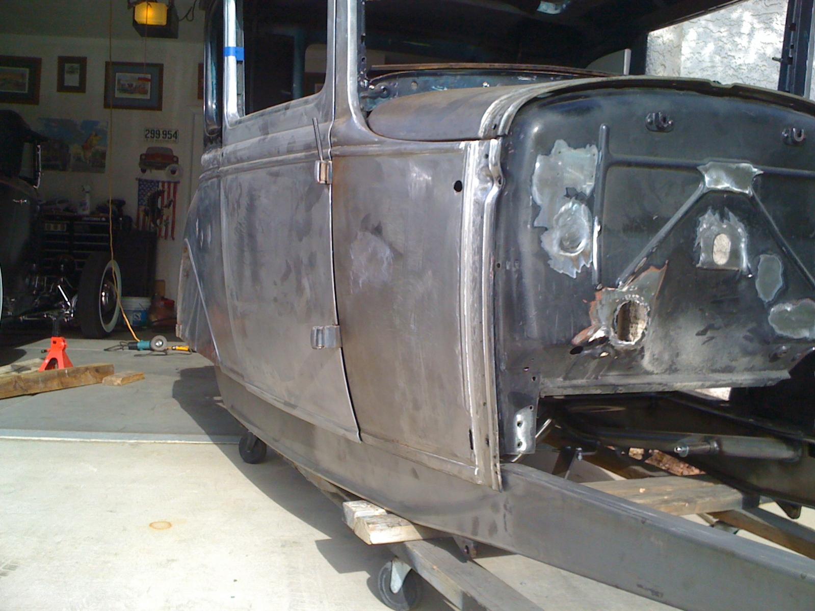

    [​IMG]Are the cowl bottoms cut and a stock subrails still in place? I like the look of the one inch or so channel. :)

    In the first photo the lower portion of the firewall foot is removed by drilling the rivets and the second shows it replaced to fit the channel. The sub rails are still in place but the "C" portion of the sub rail has been removed allowing the body to sit the inch or so lower on the frame.

    I kinda did the same thing on mine. I moved all the crossrails up even with the side subrails. Then I split the front body mounts and raised them up to bring the body down an inch or so. I took the two angle braces in front off first, and then put them back on when the other work was completed.
    You can see in the last photo where it still has the portion of the mount sticking down where it used to be. As soon as I turn the body over to weld I will finish the underside.

    [​IMG]A Little more inspiration
    Here is mine

    That small channel makes a big difference in the overall look when putting an A body on a 32 frame. Keeps it from looking like the body will slide off the frame if you take a corner too fast.
    My project is alot like billthx138's with 2" chopped radiator and full height shell cut at bottom. Channel is the same also but I sloped up the bottom cowl patch panels to compliment the frame reveal.

    This also is an awesome looking car, loving the bare metal look and the stance is perfect also, how much chop is on the body, looks like 3"??

    Its a 4 inch chop with the visor welded and filled.
