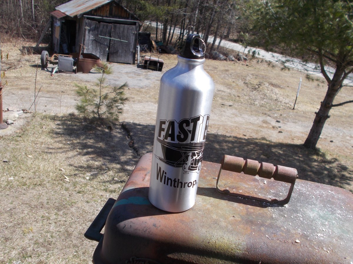

    Going on a '30 sportster,
    got the thermos [no glass] for xmas,
    just bought a OHV 4cyl. so future engine bay pix probably won't happen...

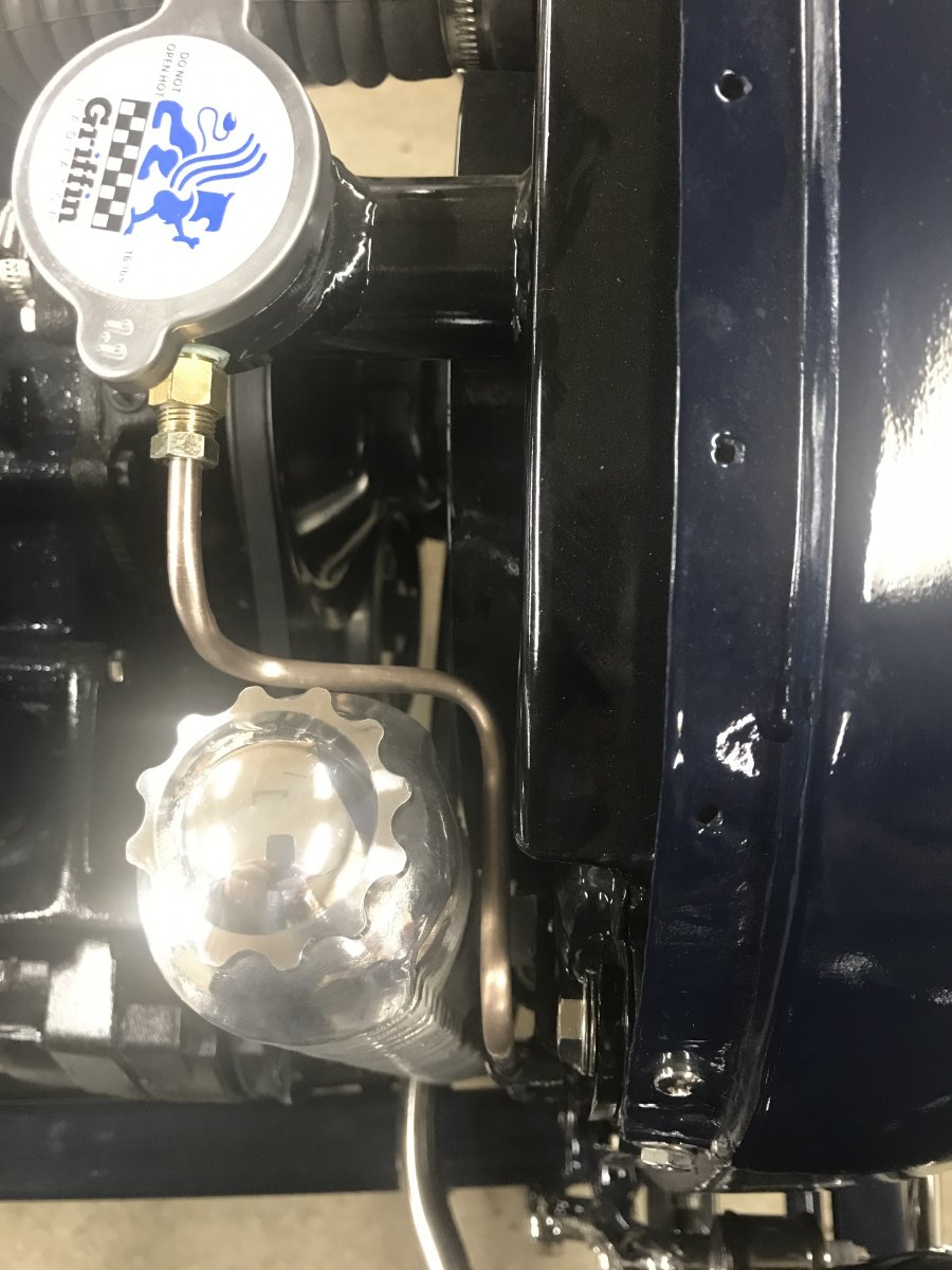

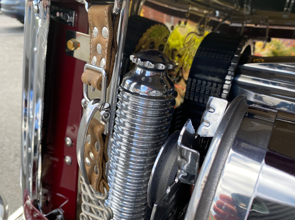

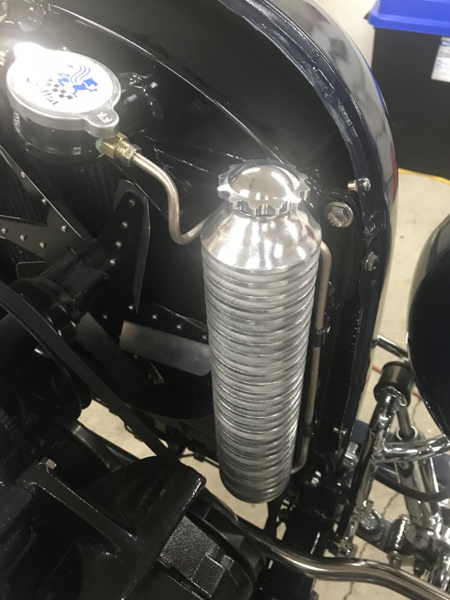

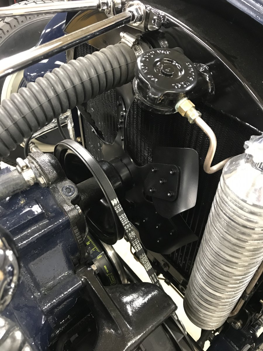

    Mine. Store bought (sorry) OTB Gear, mounted to the fan shroud and connected from the bottom via a polished SS line that you can see running up alongside the bottle. Ribbed for her pleasure.

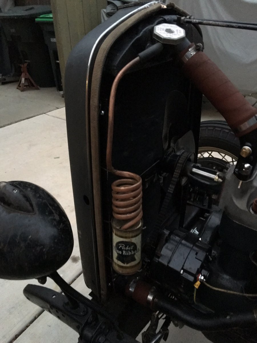

  12. I always thought a beer can was cool...……….before I was old enough to buy it.

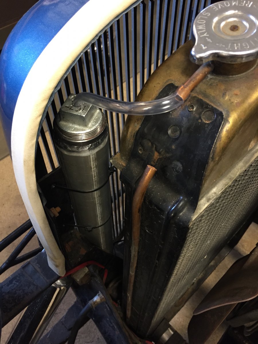

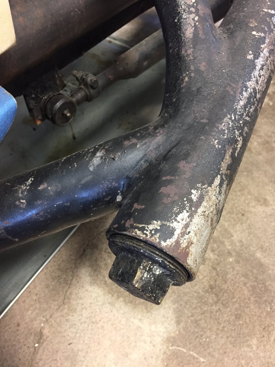

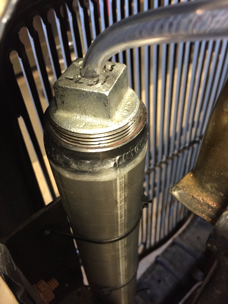

  13. I made this one out of some exhaust tubing and some iron plumbing fittings. It was for a survivor hot rod and I took my cues from the lakes plugs already on the car. I ended up welding a bracket and bolting it to the rad support but I seem to only have pics with the temporary zip ties in place. The clear thing was also replaced with black .
    catdad49, VANDENPLAS, adam401 and 2 others like this.

    Those stainless/aluminum water bottles are in just about every yard sale for under a buck most of the time and some of them are pretty good size. Not hard to give a brushed finish to or just paint the same color as the surroundings so they fade into the background and don't bring attention to themselves.

    That one Cactus1 did sure looks spot on cool. A piece of exhaust pipe and a couple of freeze plugs the right size might work quite well too.

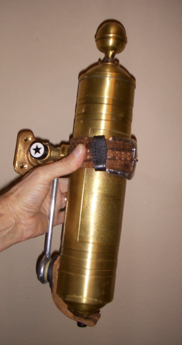

  18. Antique, brass fire extinguisher gutted and plumbed for reserve and overflow, plus dipstick.

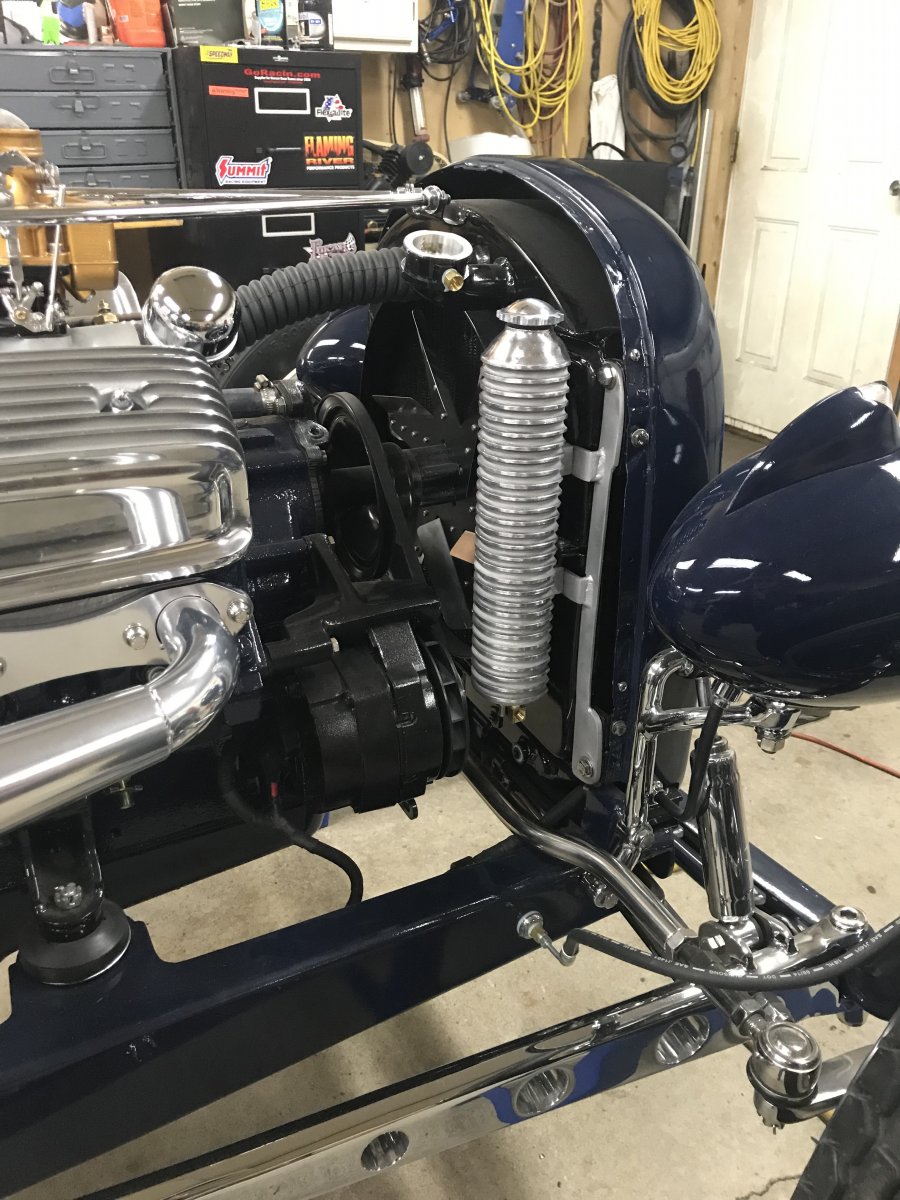

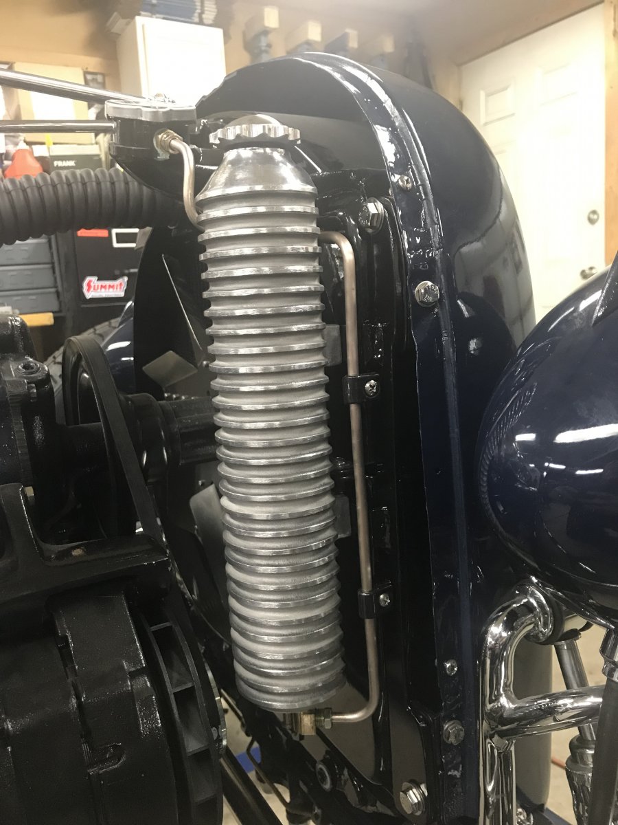

    OTB gear, ordered in pieces as a raw casting and shortened for the reduced height of my 26 T RPU radiator. :cool:

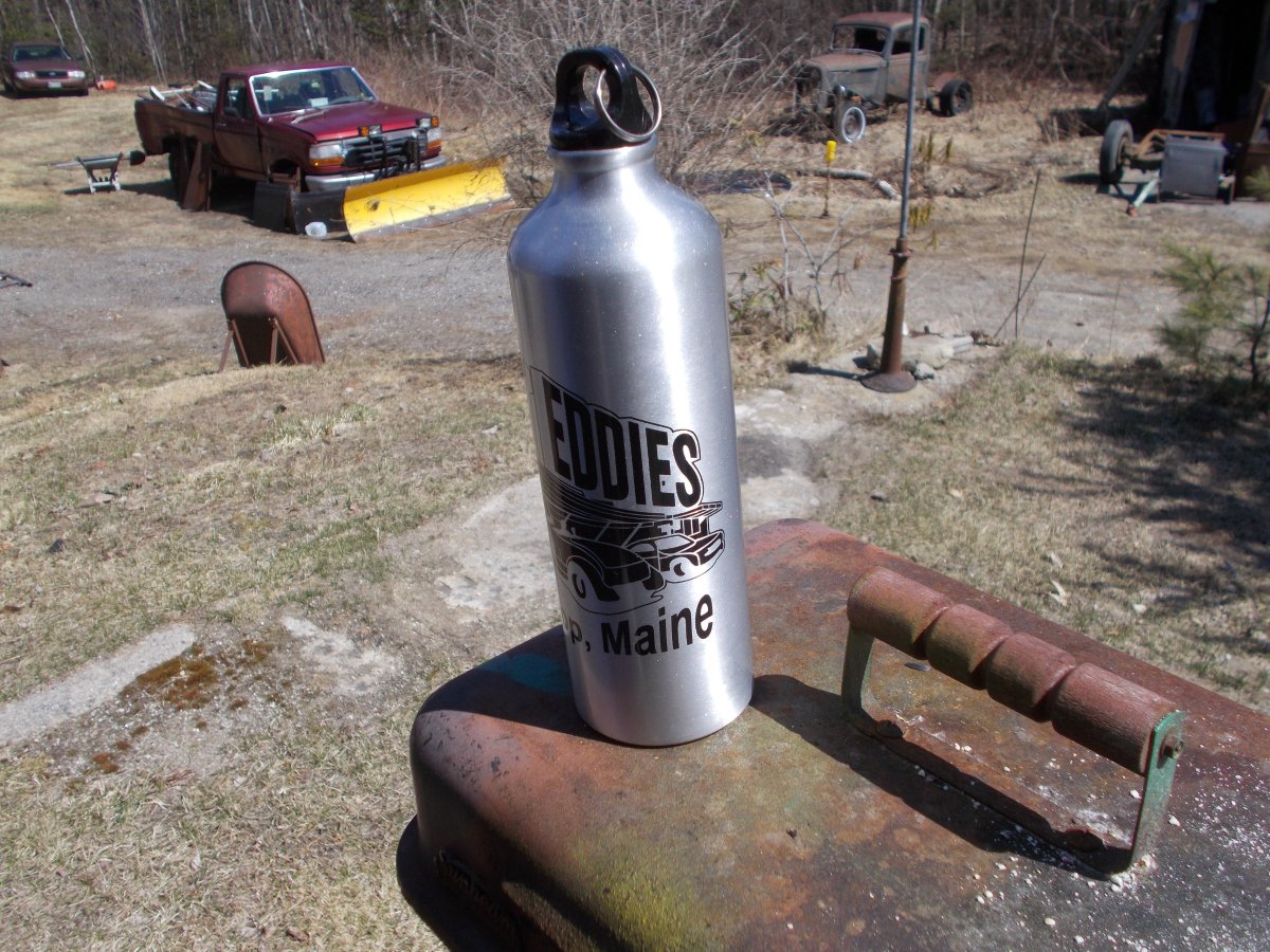

  27. My car had an ugly plastic "schnapps" bottle, that I replaced with an aluminum water bottle... 20190604_155025.jpg 0321191517.jpg
