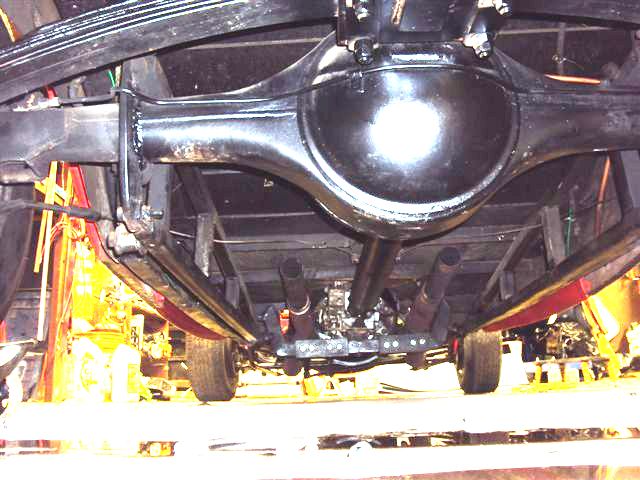

    Found this post during search, can you help me ID this rear end? The PO said it was Olds.
    Thanks.....

    Housing is 53 7/8" flange-2-flange

    Looks like '57-64 Olds/Pontiac. The pumpkin looks perfectly round and not oblong from the pic. The two ribs tells me that the pumpkin itself would be '57-8. Not sure about the housing. I don't see any perches.
    BUT you PM'd me and said it has 16-spline axles. That would be '54-6 or so. Something's not right. Plus the yoke doesn't look to me like '57-64. Perhaps my computer screen is making the pumpkin look perfectly round when it's not??
    Post some side views so I can see a side view of the rib that blends into the pinion part of the casting. Maybe I can tell from that.

    I picked up a 57 poncho rear a little while ago that has the same yoke on it as the one pictured. I've never seen one like that myself..
    The guy i got it from is a friend and told me they pulled it from the car themselves..I believed they knew the difference between a 57 pontiac and olds :)..but if that one if from an old's maybe mine is as well..
    I'm stumped too.. when i go to use this thing i'm going to have to figure out what to use as a yoke.

    Not sure about years but GM used u-joints with caps that match that flat style flange.

    The rear end in post 7 is a 56-earlier rear. It should have 10 spline axles.
    The larger 57-64 rear was actually available in later 56 models due to Nascar and the dual quad engine. Here's the best pic I can come up with for now, look at how round the carrier is.
