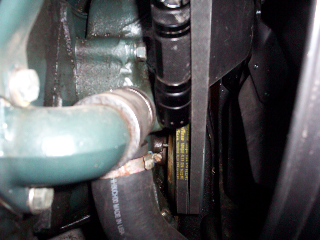

    How are you going to run a bypass hose from the cover to the intake water crossover?
    The front hole that would normally mate up to the backside of the cover I tapped for 1/4 npt and had an elbow initially and put in a 3/8 npt adapter to 1/4 npt with a matching barbed elbow fitting same as on intake on the cover. I had an extra hole on the water crossover and ended up with a 1/2 bypass hose to the cover.
  21. swe64
    Joined: Nov 22, 2010
    Posts: 415
    swe64
    do you mean it will not work without an connection from intake to cover.i plugged it and if it no go i can make a t cuplling on tempgauge hole or a hose to rear of right head there is a hose outlet maby good to transport heat from rear of engine.
    do you have a picture of our engine in your tread?
  22. 55chieftain
    Joined: May 29, 2007
    Posts: 2,188
    55chieftain
    This is how it ended up. I had to remove the factory pipe in the cover to make room for the alternator. It should have a working bypass installed, it allows coolant circulation before the thermostat opens up.
    There is another flat spot on the water crossover on the passenger side that could be opened up, but you've already put the engine together. You wouldn't want the metal from cutting getting into the cooling system.
    A t coupling probably wouldn't look the best, especially after the work you've done to clean and paint your engine up nice.
    The heater nipple on the rr head is designed to be used for the heater core. Not as a return for the bypass.

    i understand now what you mean .im not sure but on waterpump cover the outlet is supposed to go to heater core i mean that you have pressure on that fitting this got me thingking now i dont care if i have a t on line i have to get heater online.if i get a t with small pipe to the inlet on heater core and let it bleed to pump cover true return of heater core and return of heatercore goes to intake crossover.i will make this so the battery tray cover the 2 t cuplings on back of engine where the battey is and one t on water crossover.i did a paper drawing this morning and seems to work on paper.
  26. 55chieftain
    Posts: 2,188
    55chieftain
    The one outlet on the cover goes to the water crossover on the intake. The heater nipple in the rr head goes to the heater core. The return would have been in the lower hose or like my 55 on the radiator.

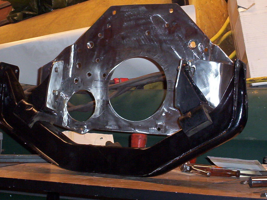

    welded first 2peces on adaptor plate and think i can use stock mid mount adding a some more metal

    adapterplate to th 700 ready for paint and i had a request for pic on 1957 timing mark so i put pic of my 347 in my pontiac safari
