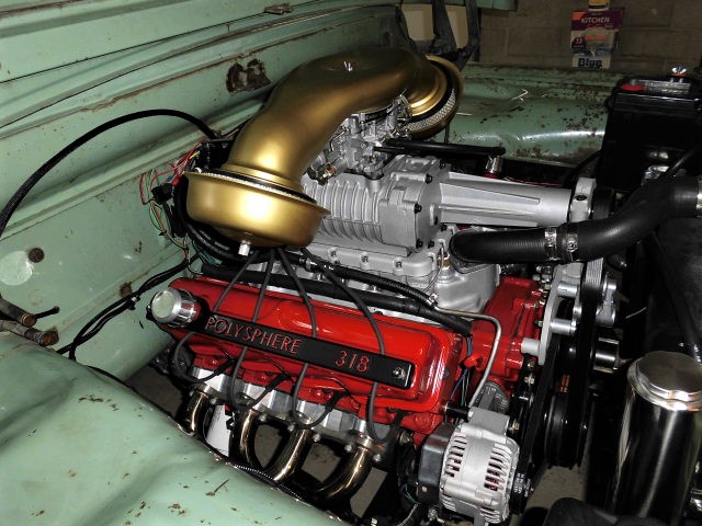

    Previously I also was given a junk 2x2 manifold and just happen to have a sweet little roots type blower from a Lightning pickup. A friend had put several of these on Baby Hemis and Flat Heads. So guess what I'm thinking.
    Talk about a funky setup. Well sometimes plans have to be adjusted,.... re the Hemi. I'll "get on" with that story in the next posting.

    The blower subject is getting a little ahead of sequence I planned for this thread. But here's a little teaser :D Did this about 4 years ago anticipating building the Poly motor. Img_4595.jpg

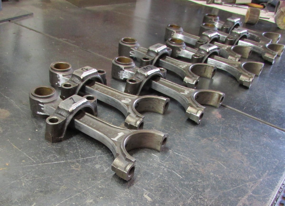

    A whole lotta years ago I had a thing for Baby Hemis,....even before I had a car to put one in. At the time folks were giving them away or selling dirt cheap. Mostly via swap meets I acquired several motors, Polys and Hemis,....241s, 270s, 315s a few miscellaneous heads and parts, and a complete stock bore D500. That's the basis of my "stash" which I now enjoy re-discovering.
    So,....the 270 Poly went in the trash and I retrieved the stock bore 270 from my "collection". That block has recently been boiled, Magna-Fluxed and bored for the .040 over pistons from the original engine. I have it back now so's I can fuss with detailing, deburring and chasing threads, before returning it to the shop for cam bearing, "facing" and another round of boiling and cleaning.

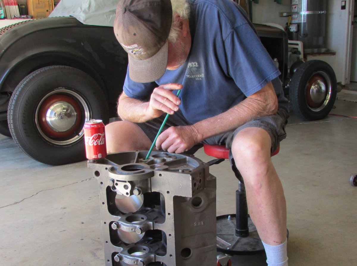

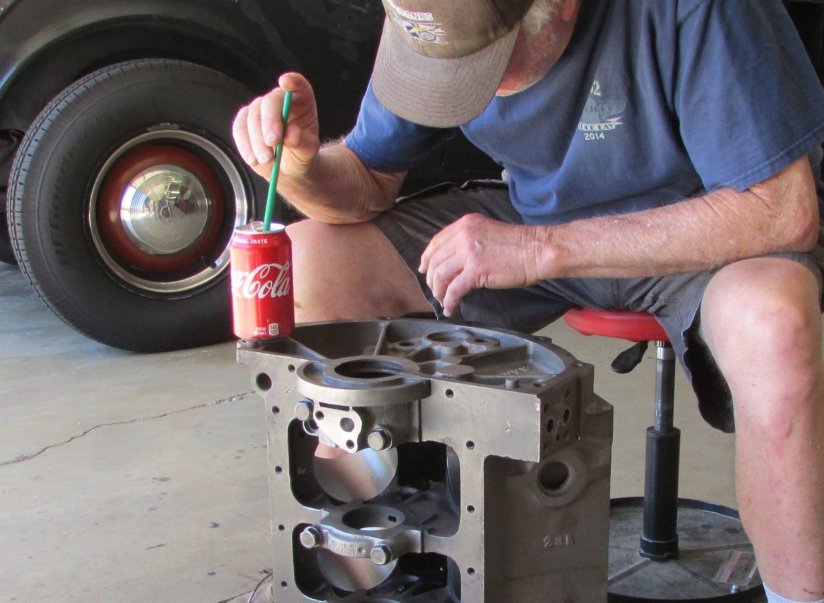

    In the process I discovered that the "secret oil galley plug" had not been removed. It was frozen so badly I was unable to break it loose, even with an impact wrench. Experienced advise was, Coca Cola, 1/2 teaspoon over night should do it.
    Didn't work,...so the machine shop will drill and tap if required.
    The original crank has been Magna-Fluxed and ground .010" under.

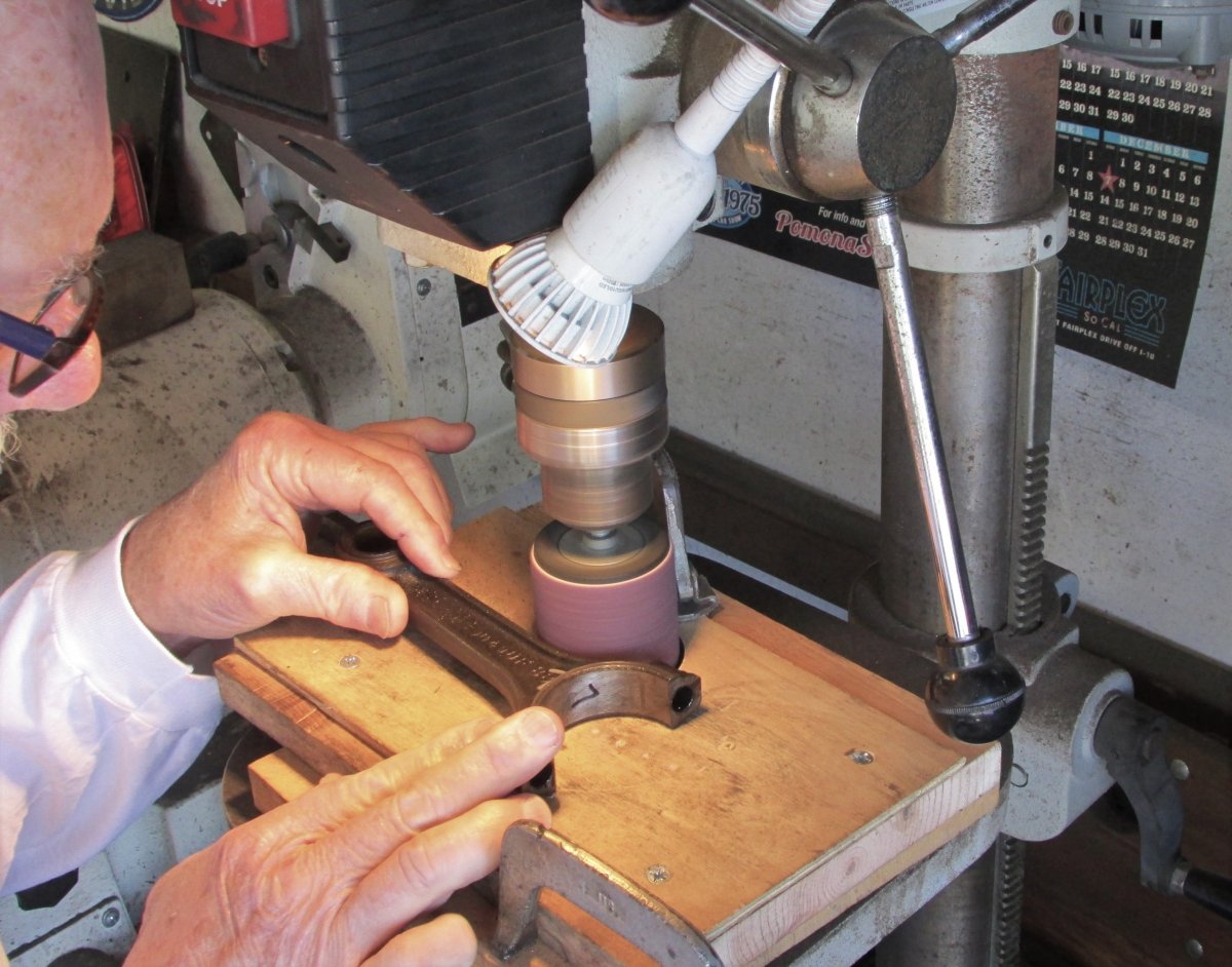

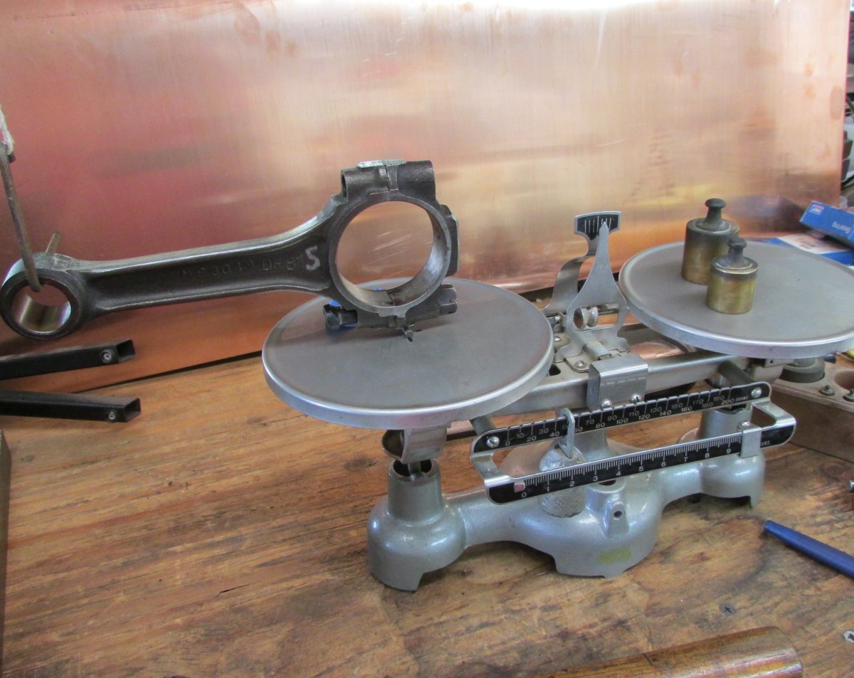

    Also, I polished the rods and did a rough balance before sending the rotating assembly off to a real balance shop.

    The internal galley plug can be a pita at times and I have had to drill them out on several occasions...but I only drill as large as the 5/16 square drive (maybe a little bigger) so that the sq drive remains available. The drilling process usually creates enough heat to help break the bond as well to reduce the hoop tension. Use a good quality sq plug socket.

    I'm sure that you know but just in case a 3/8 extension milled to 5/16 works well.
    Atwater Mike, loudbang and Hnstray like this.
  29. 423E4CA5-65E6-4FDD-8C60-AEDE0D3FD4FF.jpeg 0FFF87BB-9129-4E75-BB69-7805757BB6C0.jpeg This is the socket I purchased,,,,it worked a miracle.
    The plug came loose instantly with this,,,,no problem .
    Tommy
