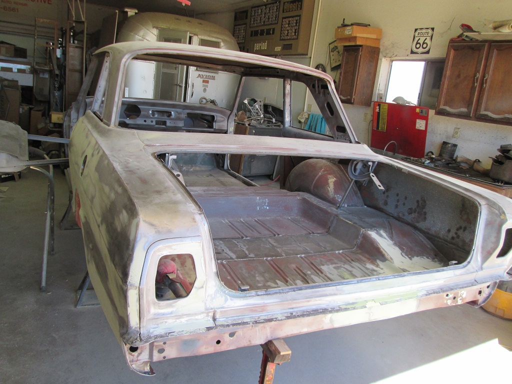

    thanks! The rear wheel wells are radiused, tires may or may not stick out depending on what I end up running.
    Been working under the floor all week. Slow, but it's getting there. I added some braces to tie the front of the rocker to the front of the frame. nothing fancy, just bent up some 16 gauge sheet.

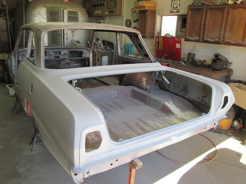

  12. squirrel
    Joined: Sep 23, 2004
    Posts: 56,088
    squirrel
    I used acrylic lacquer primer. It should get nice and "used" looking in short order...remember, I'm trying to build a 4 year old race car!

    been doing some other stuff, but back to work on the bondo. I got lots of help with the quarters...I'm on my own for finishing the rest of it, so progress will be a bit slower.
    1Nimrod and els like this.

    squirrel
    I'm probably going to use a urethane primer on the outside of the body. I have to decide soon, I'm about ready to put something on it.

    ...and so much easier to prevent dry spots, by knowing what you're doing. I learned a lot painting the Suburban, but there's always so much more to learn.
    Shot a little bit of urethane primer on the back of the body.
