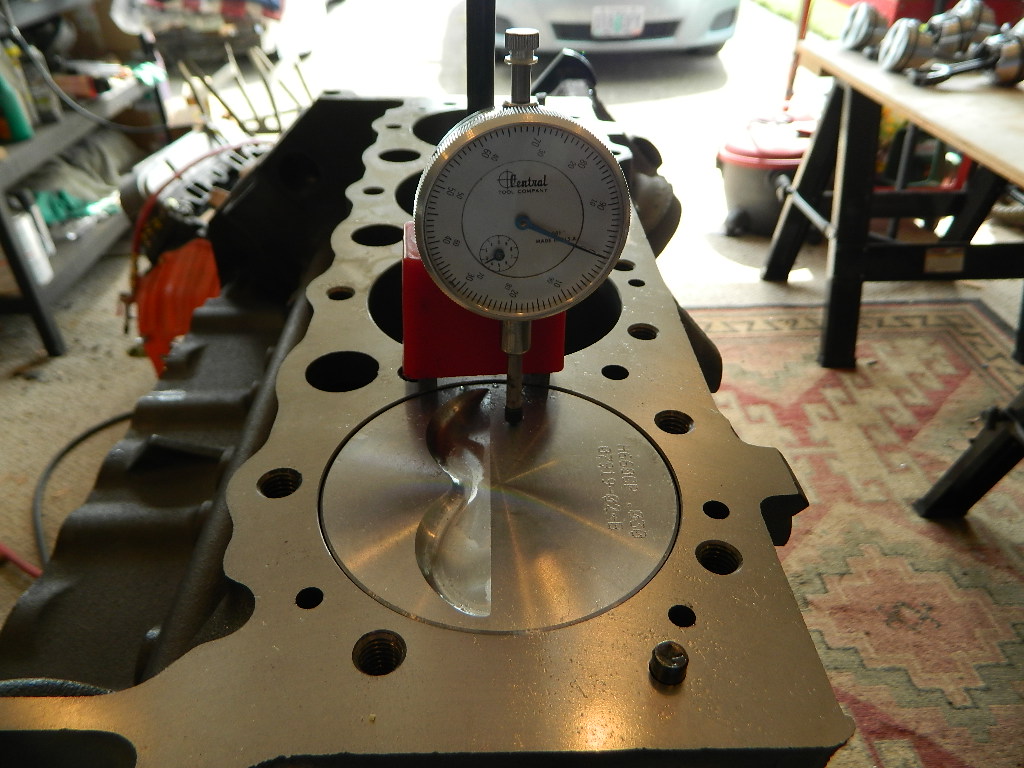

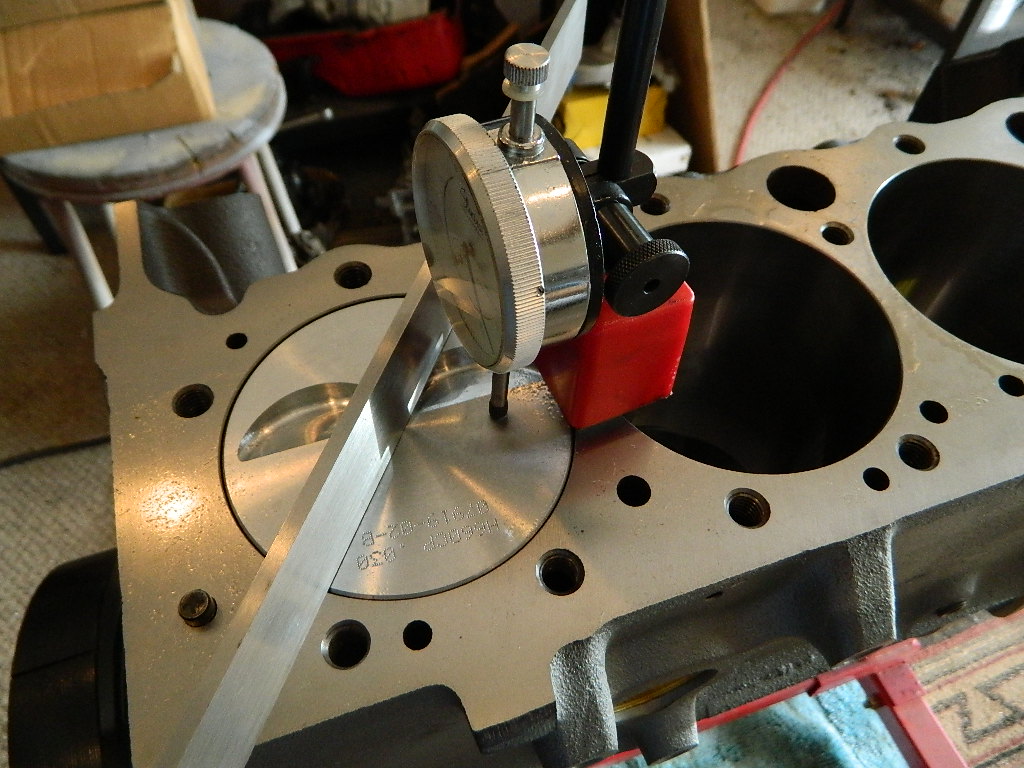

  1. I put new flat top pistons in the 4 corners of my '64 327 block today, only had enough wrist pin keepers on hand to do 4 so I did the corners. This block has been tanked, bored 030 over and decked. It is very clean and is going together on an engine stand. The crank is a '67 with standard uncut journals. Rods are full floating Scat, also new.
    1 piston measures .007 and the others are .016 and 2 at .017 down. The two at 007 and 016 are on the same journal and the 2 at 017 are on the same journal at the opposite end of the block.
    I used a dial indicator on each piston to arrive at their tdc and a straight edge with feeler gauge to get my readings.
    How much variance should I expect from one to the other? What's acceptable? School me on how I should be measuring this please if my method is unsound.

    Where are you touching the piston for your depth measurement ?
    Pistons WILL rock in the wrist pin, giving widely varied "in the hole" numbers.
    You need to add some tape to the skirt, top and bottom to keep the piston from rocking in the bore. Even if you have only .003" or .004" piston to wall gap, it will still show up when measuring the depth.

  15. Thank you all. Here is what I'm working with so I am not getting the reading from exactly the center of the piston but I am getting it from above the wrist pin and not an outside edge. I don't have a straddle type holder. This is a street motor and in fact the pistons all have their rings on while I'm doing this. Measuring the depth was mostly an afterthought or curiosity after putting them in. I will take the .007 assembly out today and move it to at least one other hole for comparison.

    If you move the indicator to a point farthest away from the piston pin and rock the piston you will barely see the dial move.
