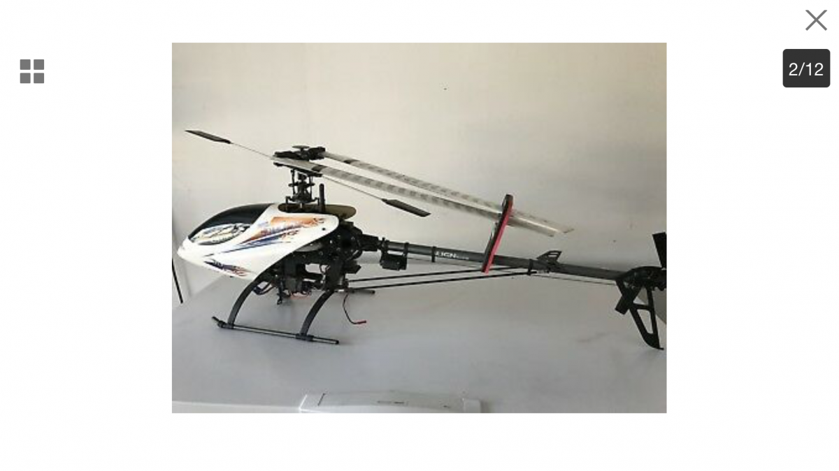

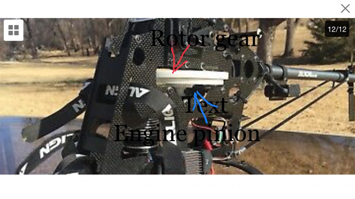

  12. A toy Remote control helicopter
    90BC92B3-CCFB-4BFC-A621-A22A8B151487.png D16185A1-5CBE-41EA-B06B-B202D090F9B4.jpeg
    600n ^^
    Wow, I thought you might have to go a lot further to get something
    Johnny Gee likes this.
