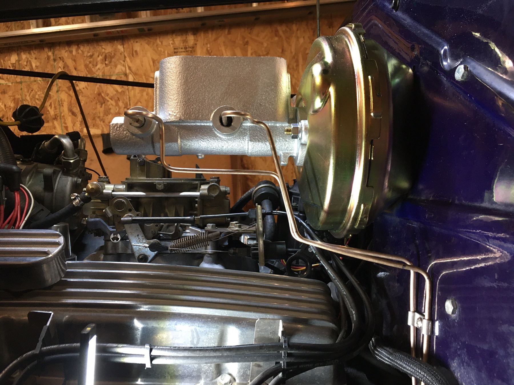

    Have to re-run my upper brake lines to a firewall mounted master. Looking for nice looking ideas to borrow inspiration from.

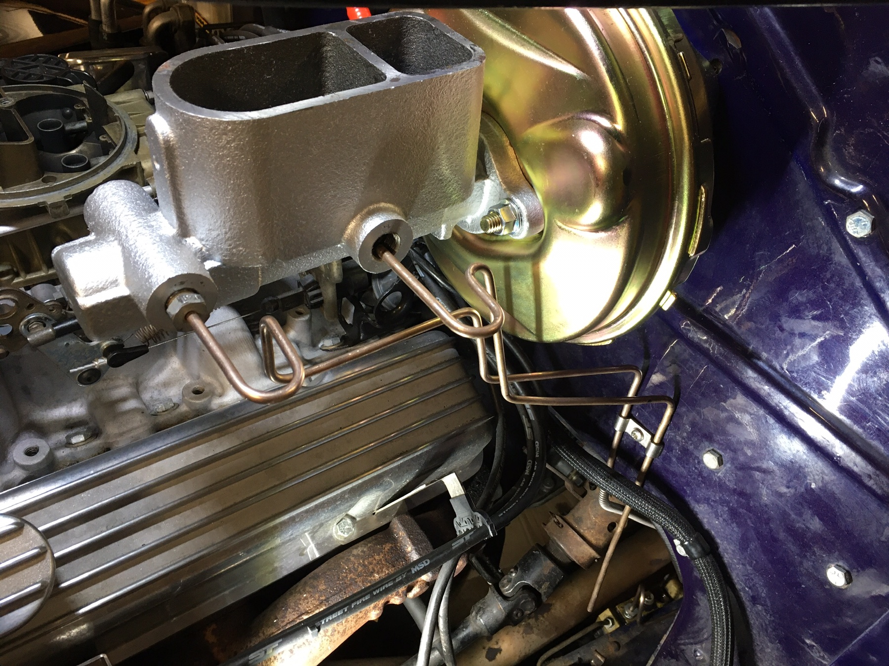

    New booster is a couple inches shorter than old booster. I have them run this way now
    but having them kinda hanging out in space, they’re kinda in the way getting at the valve cover, carb, etc.. Thunking since I need to re-run them anyway, maybe trying to tuck them up under the master more. Follow the firewall over toward the centre, then come up along the bottom and front of the booster, under the master, then pop out in a loop to the fittings.
    Bunch of extra bends, will be something of a pain to get them to run parallel through a half dozen corners.
    Just looking for other ideas.

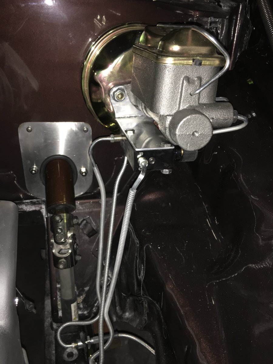

    The mock up is copper wire, plumbing copper scraps left over from an ice maker I don’t have, and masking tape.
    The real lines are NiCop.

  19. David Gersic
    Joined: Feb 15, 2015
    Posts: 2,734
    David Gersic
    from DeKalb, IL
    [​IMG][​IMG]
    Front is done. Rear is mocked up using scrap. Hoping to get the rear bent up tomorrow, so I can bleed them.

    My suggestion would be to come up on the other side of the booster .............or come up where you are at and then run them under the booster along the firewall. Then come from the motor side of the booster and come out from under the master cylinder with a 180 degree upward bend. That way the tubes don't look like an afterthought hanging out in the air. If you want the vibration coil (1 turn ?), it might be visually hidden somewhat by the booster/master cylinder as it comes off the firewall. Hope I described this sufficiently.
    Edit: Actually, after looking at the picture of the master cylinder again, it looks like your connections could be made on the other side of it and conceal the tubes even more.

  24. David Gersic
    Posts: 2,734
    David Gersic
    from DeKalb, IL
    No room on the other side. I’d have to pull the engine and transmission to get back there.
    There are no fittings on the far side to connect to.
    I was trying to come up under the booster and go around it, but couldn’t get that to work out either. Steering shaft is in the way there.
