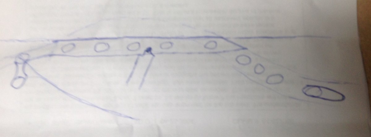

  4. ...make an angle that follows your frame rails, install it a little above the frame and lay your oak boards crossways, that'd look really slick.
