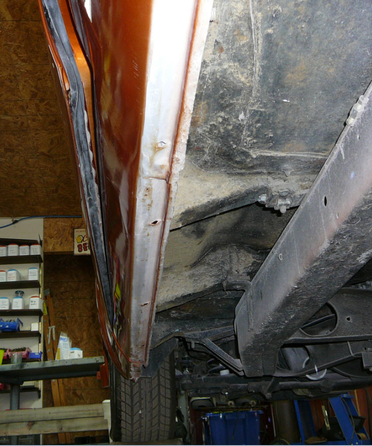

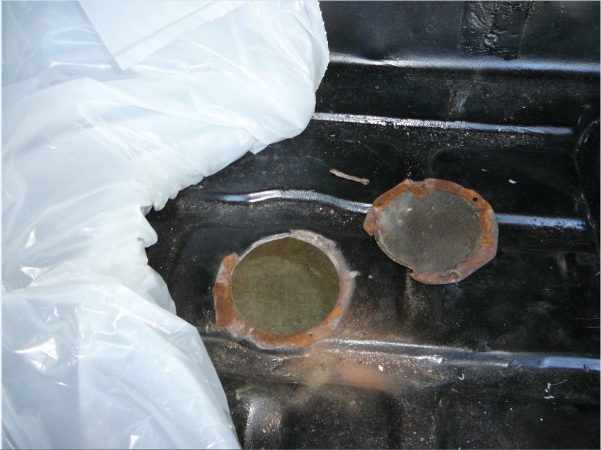

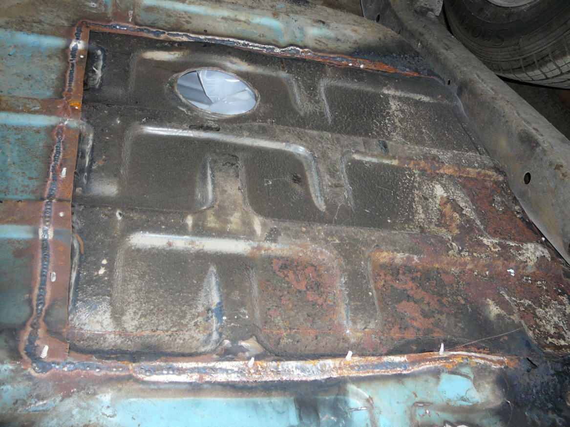

    Some more eye candy as I dig into it all
    Agreement stated - Sandblast and repair trunk patch panel
    Painted over rust on the top side, now showing its face. And the bottom he did nothing. I have since removed all the rust from the welded areas and seam sealed the overlap and undercoated it to stop the rust there.
    Showing where there is no paint on the bottom edge of the car on either side. Well, there is a little bit of overspray if that counts. awesome

    Nope, not needed. That's a $12K+ proposition and in real time, throwing good money after bad. EVERYTHING is fixable. There's no way that the whole car will "shed it's skin" going down the road due to the lack of personal attention. It wouldn't look as good as it does now if that were the case. The only thing that can't be repaired is the OP's perception of the car, as he's the one familiar with every square inch of it. We're not. ctfortner, as hard as it is to remove yourself from the whole gig that's exactly what you need to do. Take a realistic look at it with your pals, remove the family ties to the car, get dirty and make it as right as it can be. In the end you'll feel like you got a $20K job for 1/3 the price, and you'll smile so big over your personal investment in labor/effort that you may need to turn your head just to finish the grin. Once done, all the bad taste will have gone the way of the dinosaur, and you can start a new chapter in the family's old Ford. In the meantime you can try to force a bit of a refund for your trouble, and it may help cover your new mat'l costs. You just need to trust me on that score. Get off this topic and get to work on your car. Just sayin...
  28. I don't think that would be necessary. Overall it looks good and the problem areas can be fixed and spotted in. Body shops do that sort of thing everyday. I think some people get mentally constipated and can't get past the underlying questions, but repairs will work out if you work smart.
    I don't know why some body shops do that, but I have seen numerous paint jobs that end at the bottom of the vertical surfaces, instead of going all the way to the pinch welds on the rockers and the fender edges! That can easily be spotted in well.
    Keep us posted on how the repairs come out.
    ~Alden
  29. I don't know why some body shops do that, but I have seen numerous paint jobs that end at the bottom of the vertical surfaces, instead of going all the way to the pinch welds on the rockers and the fender edges!
    Lazy !
    Unless you jack it up, put on plenty high stands and remove the tires in the paint booth, you can't get your gun in there. When its that high you need a ladder to paint the deck lid and hood. It should be done when as a cut in when everything else is being cut in but its usually not high enough then either. so unless someone makes a deliberate effort to pant solid to the pinch weld it doesn't get done right.
  30. s55mercury66
    Joined: Jul 6, 2009
    Posts: 3,722
    s55mercury66
    from SW Wyoming
    Yes, no paint on the bottom of the rockers or around wheel openings is just lame and lazy. Even if you don't jack the car up to reach there, I would turn my air cap sideways and make sure I covered the rockers. Good grief Charlie Brown, that has always been one of my pet peeves, a nice looking paint job with no paint on the first areas to rust! Usually followed by that famous quote "Nobody looks there anyway" GRRRRRRRRRR!
