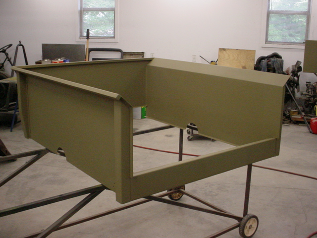

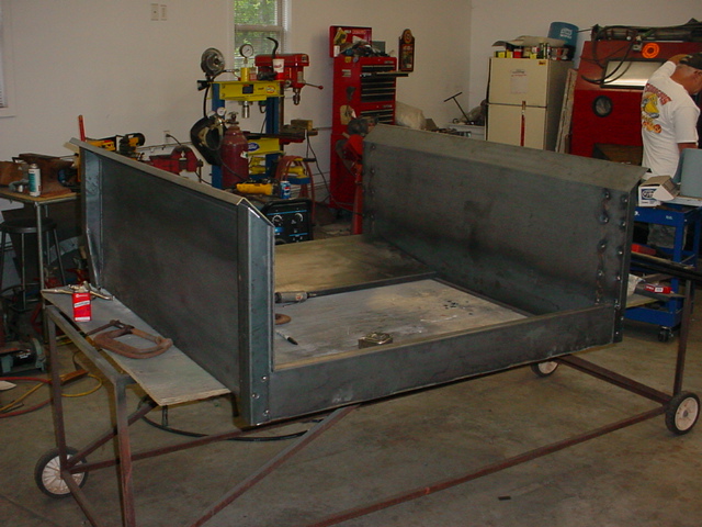

  4. We built a 1" square tubing roll around frame to support the bed while we were painting and I have a piece of plywood that I can use to make a table when the need arises. HRP
