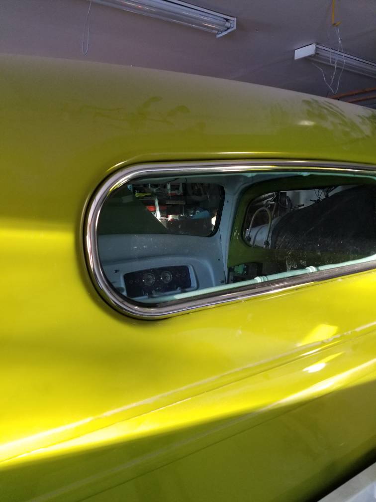

    seb fontana likes this.

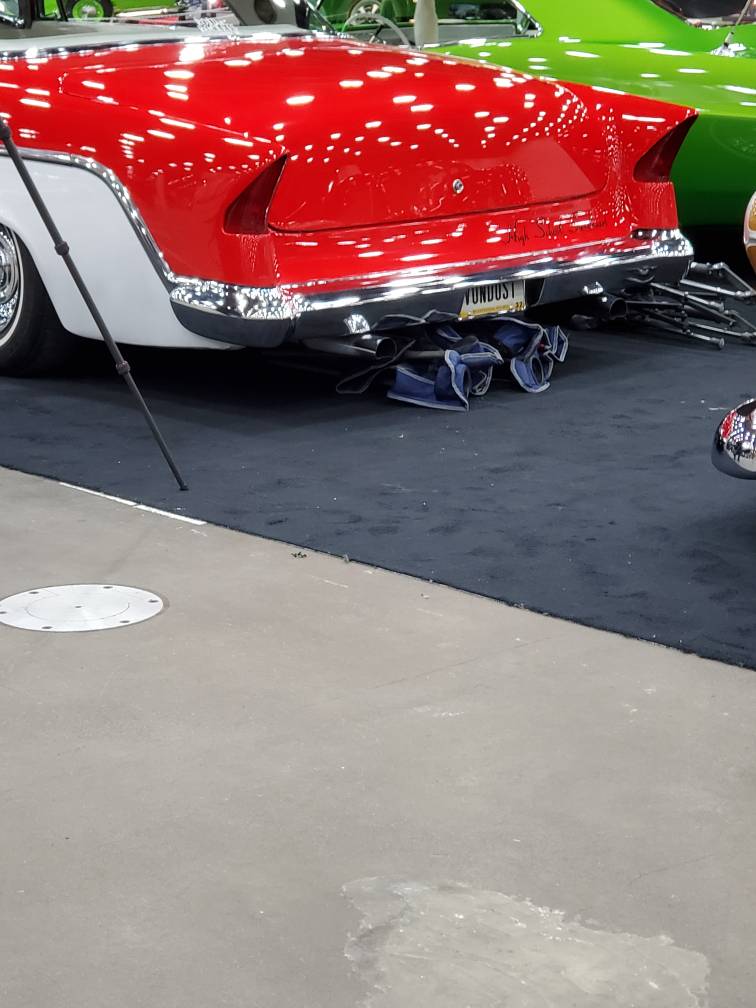

    Here's a couple of pictures of a (sorry, OT) car I took recently. I actually thought it was chrome plated, till I asked the owner!

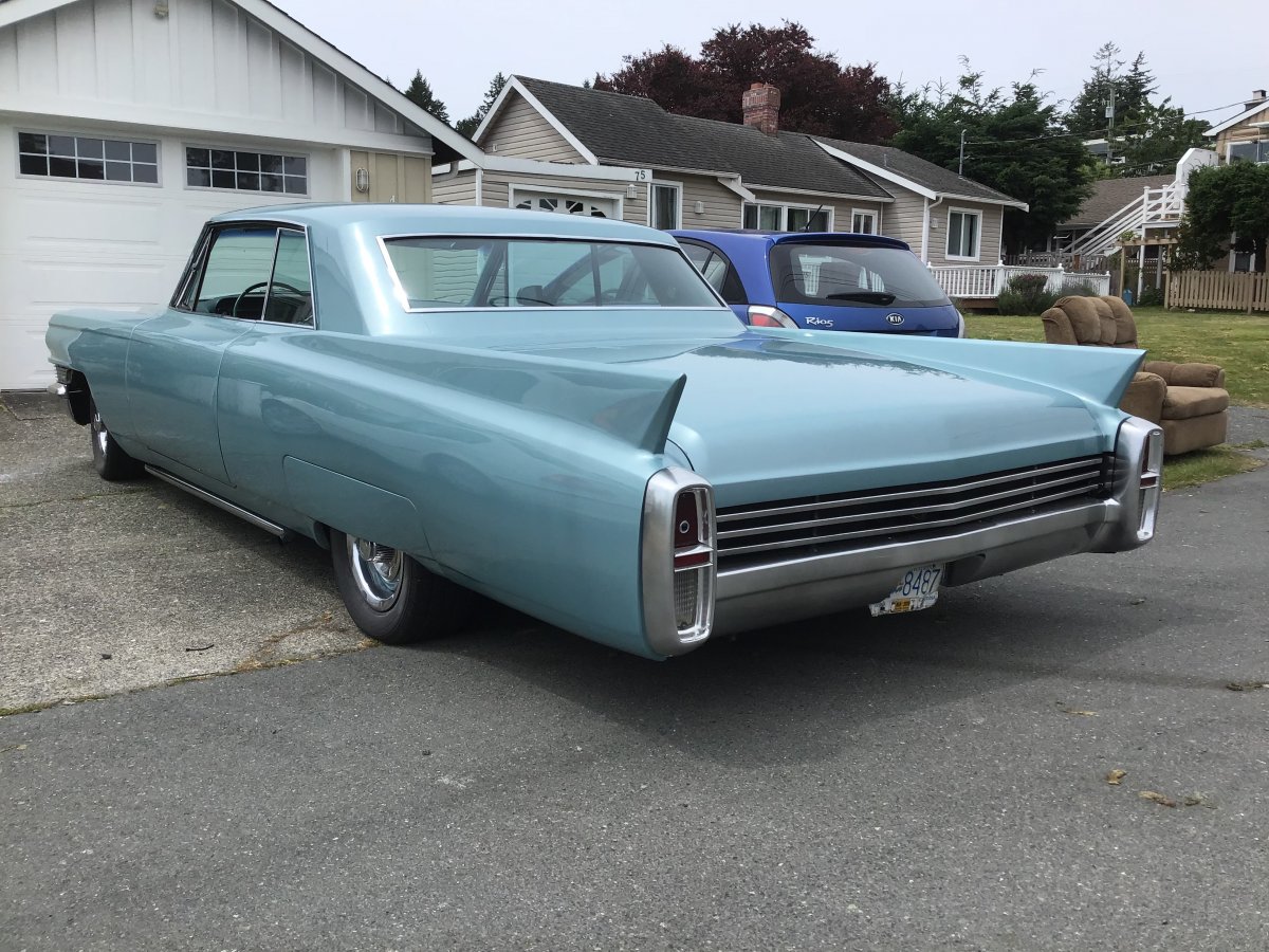

    I bought this car for not much money 25 years ago . Had 2 little kids just bought a house and absolutely no money. I traded , begged ,borrowed and scraped this ride together over a 2 year period.
    25 years ago I was quoted 1500.00 for the front end chrome and 1500.00 for the rear end chrome - might as well been a million dollars.
    They had rusty scabs and road rash so I sandblasted them - applied zinc chromate primer and high build primer. I prepped them an applied Alsa Corp mirachrome paint. It was supposed to look exactly like chrome but it actually looks just like polished aluminum.
    The point is I have other cars now with lots of expensive chrome - but my wife and now adult kids have had more fun driving this old bomb around to car stuff for 25 years .
    Sometimes it’s about getting it on the road with what you can afford.
