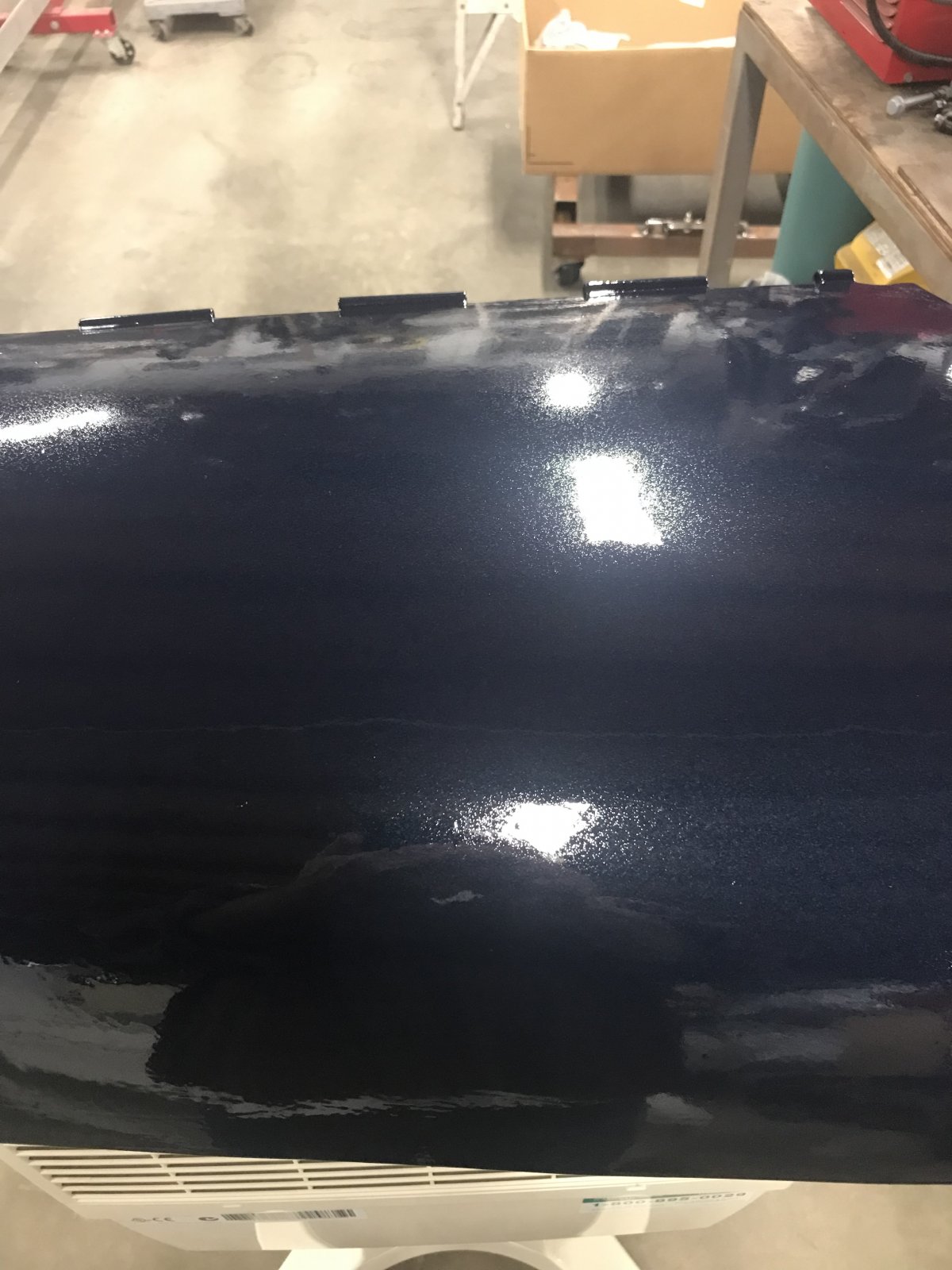

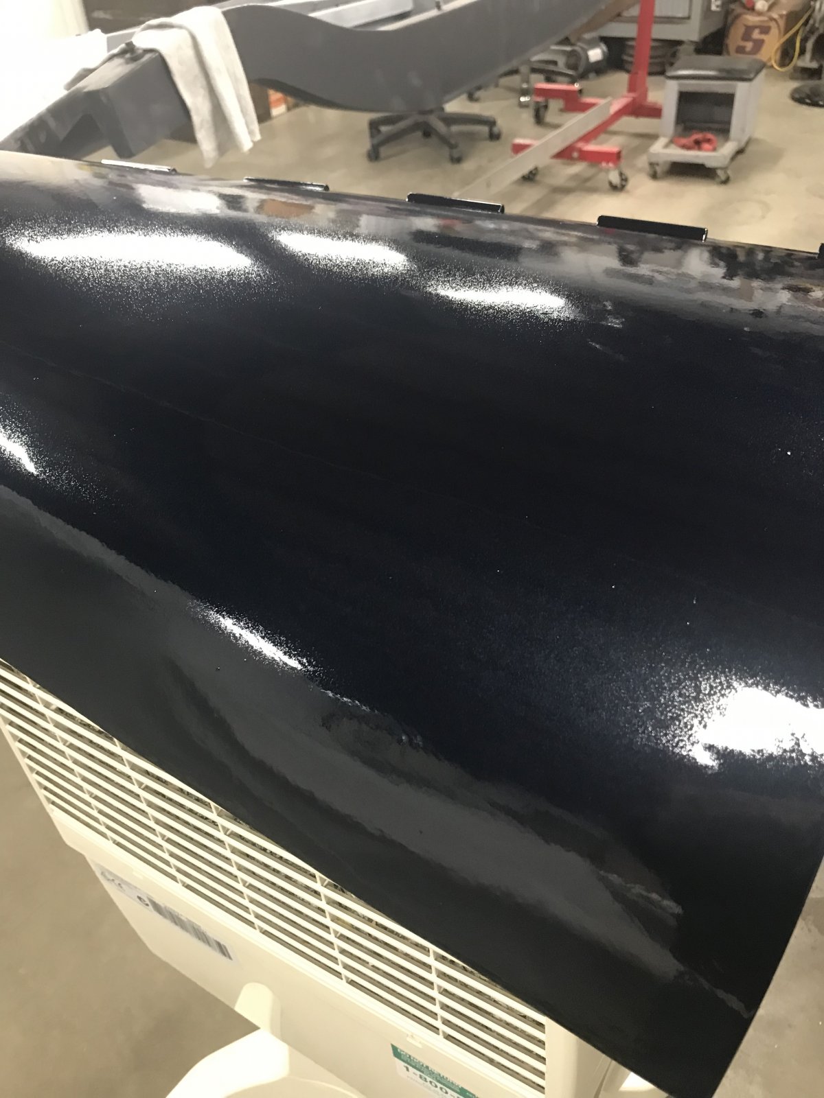

    I’m about to paint the frame for my ‘29 highboy. I ordered some acrylic enamel from TCP Global, mid-sixties Corvette Daytona Blue metallic. I have a Model A hood that came with my coupe that I’m not going to use and it already has been stripped and primed with light gray DTM primer. I thought it would make for a good color test to be sure that I like the color. The temperature was in the high 60s, clear skies, average humidity although it had rained a little the day before. The hood was not primed with high build and I didn’t apply sealer like I plan to when I shoot the frame. It was just a color test.
    I mixed the components per the info on the TCP website. I applied it with my Turbine system and the gun that came with it using the 1.3 tip. I put on three coats using different directions so that the metallic would lay out evenly.
    Looking at the photos you can see thousands of tiny spots that appeared a few hours into the drying time - that’s not metallic, it’s on the surface. Any ideas?

  2. The light reflection makes it kind of hard to see. Does it look like mini fisheyes?
  3. have you ever used the turbine system before? The one time i used one it seemed to heat the air up and cause it to flash much faster than normal. That being said it, looks just like the way my first time using the turbine paint system looked...like some of the paint had dried in the air, and gave it a rough granular looking finish. Never used the turbine crap again, and went back to spray guns and my compressor, and have never had another issue with it.
    fauj, Hollywood-East and alanp561 like this.
  4. What speed catalyst did you use? Turbines produce hot air which is not good for painting. If you have a short hose from the turbine to the gun that heat gets transferred to the paint. The paint probably dried before it had time to lay flat and off gas so you ended up with a sever case of solvent pop or it just sprayed very dry giving a granular texture.

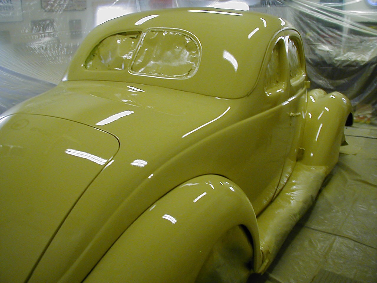

    Had that very effect on a solid color with that acrylic enamel paint. I also used a gloss hardener provided by TCP.
    I was able to color sand 90% of it out and buff. Looked great! It gave it a perfect effect that was far from a basecoat and clearcoat.
    The pic was right after paint. I too didn’t notice it until it setup.

    The tiny spots appeared after it sat for a couple hours, initially it looked great. I used the hardener that was recommended by the gentleman on the phone when I ordered the paint, I told him that the temperature would be high eighties-low nineties because I had planned on painting it in the early summer. Our summer was 100+ so the temperature is just now getting back to habitable.
  8. It is solvent pop then. Did you tell him you were using a turbine? Again the air you are spraying the paint with is hot with a turbine so it speeds up the dry time of the paint immensely. The surface started curing before the solvents were able to escape so they pushed though the top already curing surface of your paint and left thousands of tiny bubbles.

    millersgarage
    it looks like solvent pop.
    Top layer dried before releasing the solvents of the fist coats. Sometimes caused by to short of flash time between coats.
    The turbine systems work fine, but you have to adjust the mixture for them. Slower reducer and a little over reduced
    And there is no easy fix, going to have to sand it down and respray. Wet sanding will only cut open the bubbles and leave thousands of little white spots
